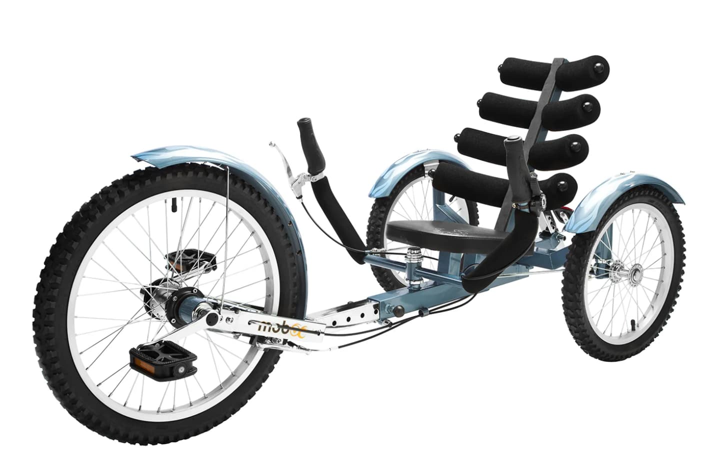

Alternatively the Nimbus Drift Trike Disk Hub, or Madazz Trikes Freewheeling Pedal Hub (both are square taper). These are identical in design, and although they’re not quite as good as the JR, plenty of riders use them with no issue. Hardcore riders do have a habit of splitting the hub shell in two though, especially when riding with long cranks, so be careful!
There are other options, but are generally not recommended for a variety of reasons - see the hubs section below.

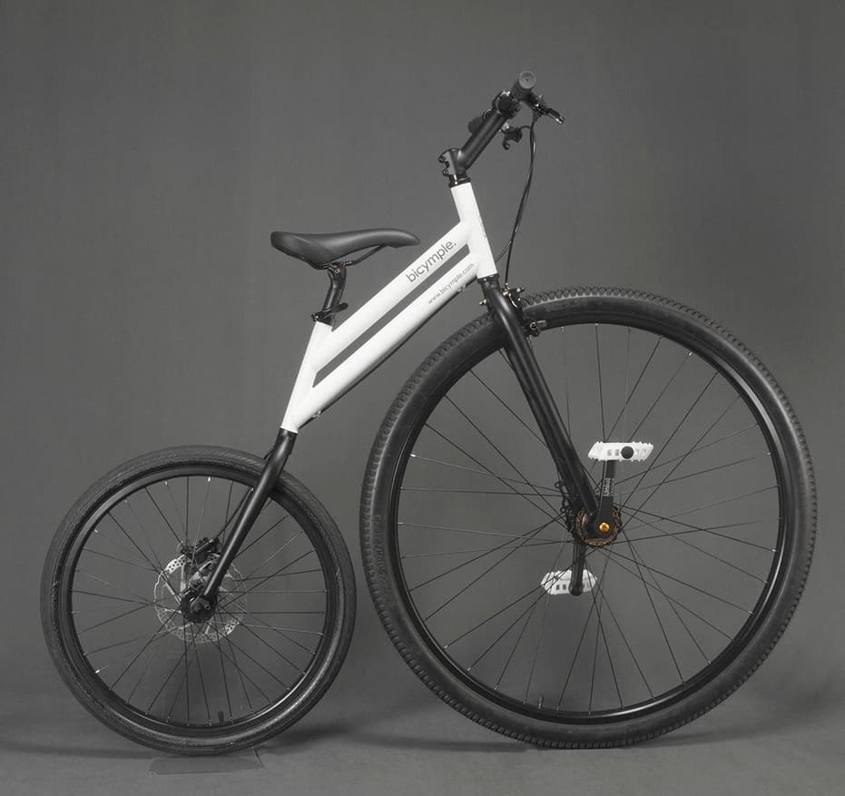

Unusual bicycle hubs:
Bicymple 1:1 ISIS Freewheel Hub
Internals
Summary
The first available ISIS 1:1 freewheel hub.
ISIS spindle
100mm bearing spacing with standard 22x42x12 bearings.
24 points of engagement.
This hub has been weighed at approximately 590g (incl. bearings, without bolts), 639g (incl. bearings, incl. 12mm bolts).
Availability
None direct from Bicymple - we bought them all.
Bicymple are investigating the manufacture of more, or they very occasionally appear for sale second hand.
Usage
This hub can be used as a straight swap in any internal disk unicycle frame without modification or bearing shims. Normal ISIS unicycle cranks can be used, but crank spacers are essential to stop the hub from coming apart during riding.
So far a handful of riders have these hubs with reports that aside from the ISIS cranks and smaller Q-factor, there’s very little difference in feel from the JR P-Hub (see below).
Issues
The hubs use M15x1 axle bolts, that although they conform to the ISIS spec, are an uncommon size on unicycles (we normally use M12x1).
ISIS crank spacers are essential. There are two bearings press-fit into the hub shell which although may stay in place initially, require the use of crank spacers to ensure they don’t come out of the hub.

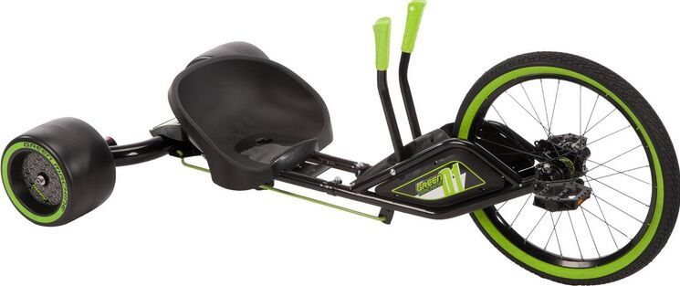

Drift Trike Hubs:
Nimbus/Madazz/High Roller Drift Trike Hub
Summary
This hub has 100mm bearing spacing, with a square taper axle, and optionally a standard 6 bolt disk brake mount. It comes in black (Nimbus/Madazz/High Roller) or Orange (Madazz only).
UDC listed a weight of 618g.
The High Roller hub appears to be only available without a disk, and in a 32 hole variant.
Availability
Limited
The Nimbus hubs are no longer in production - some stores still have stock.
Usage
This hub used to be commonly used for building freewheel unicycles due to its reasonable availability from unicycle.com and other suppliers. It also has close enough hub flange dimensions to be used interchangeably in stock Nimbus/KH wheelsets without requiring new spokes.
To use this in a frame designed for ISIS hubs with 42mm bearing holders, you require 1mm shims, or replacement bearings (17x42x12)
Issues
  • The clutch in this hub has only 18 points of engagement, which can mean that a moderate amount of pedaling is required before engagement.

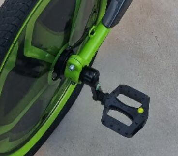

JR Drift Trikes P-Hub
Internals:
Summary
This hub has 100mm bearing spacing, with a square taper axle, and a standard 6 bolt disc brake mount. It comes in black or purple.
This hub has been weighed at 690g.
Availability
Limited
JR no longer exists as a company so stock is very limited, sometimes available from some resellers.
Usage
This hub has commonly been used for building freewheel unicycles due to its general superiority over the aforementioned Nimbus/Madazz/High Roller hub. It has close enough flange dimensions to be used interchangeably in stock Nimbus/KH wheelsets without requiring new spokes.
To use this in a frame designed for ISIS hubs with 42mm bearing holders, you require 1mm shims, or replacement bearings (17x42x12).
Issues
  • The clutch in this hub has only 24 points of engagement, which although better than other hubs, can mean that a moderate amount of pedaling is required before engagement.
  • The hub flanges are very close together, which means that larger wheels especially have limited strength compared to a standard unicycle wheel. So far this has not been an issue even on wheels up to 32" (ridden on road), but is something to bear in mind.

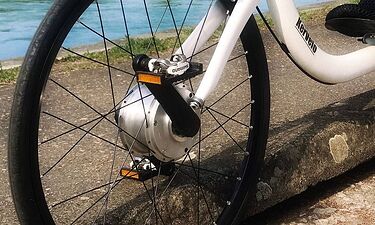

MC² Transformer Bike
This is an interesting bike that first appeared in 2014 as a crowdfunding campaign, went on to full production, then the company went quiet more recently.
Most interesting to us unicyclists is the front wheel, complete with a two speed geared freewheeling hub.
The bearing spacing is unknown, but it’s presumed to be close to 100mm, and it appears to use standard 17x40x12 square taper axle bearings.
The shifting appears to work by means of a free-spinning planetary gear set (for 1:1), with an outer ring gear that’s locked in place to go to the high gear (1:3). In the prototypes this locking mechanism was a secondary disk brake, but the finished products appear to possibly use some kind of drum brake or enclosed disk arrangement.
With some imagination, one can see how this same idea could be used to create a freewheeling/fixed hub complete with hand controlled shifter. If there is enough modulation in the “gear changer” then this could potentially be used as a rudimentary CVT, or at least allow you to slowly change gear rather than jump from 1:1 to the slightly insane seeming 1:3.
The gear change is demonstrated in this video: https://www.youtube.com/watch?v=3H0yx-0o22Y
https://web.archive.org/web/20201112022624/https://www.mc2bike.com/store/p11/MC²\_DRIVING_WHEELSET.html (website seen working still in July 2021, dead in 2022)

Bicymple
Another front wheel drive bicycle that went into production, using either a freewheeling Schlumpf 2 speed hub, or their own custom made ISIS 1:1 freewheel hubs.
https://shop.bicymple.com/products/bicymple-penny-farthing (Website working April 2026)
Mobo Shift
A front wheel drive recumbent trike with a “shiftable” freewheeling mechanism.
The wheelset at least can be purchased as a spare part.
Shift front wheelset
Huffy Green Machine
These trikes were pulled apart to create some of the earliest (and cheapest) freewheeling unicycles as they were a moderately successful kids toy, which parents quickly realise they don’t have space for once the kids have lost interest. They’re not actually a very good drift trike.
Some of these trikes have a back-pedal-brake direct drive hub, which can be put into a unicycle with some frame adjustment, bearing shims and bolts to hold the reaction arm. The back-pedal-brake engagement is very slow as stock which makes riding such a unicycle almost impossible. It may be possible to tighten this up.
@mowcius has one of these built into a unicycle - ping him for more info.
You can tell whether the trike has the back pedal brake by the lack of a hand brake, and a black reaction arm visible on the left side of the front wheel - visible here:

Great work, @mowcius! Let me contribute something related to the JR P-hub: disc side nut is right-hand threaded, non-disc side nut is left-hand threaded. (I just needed that haha)

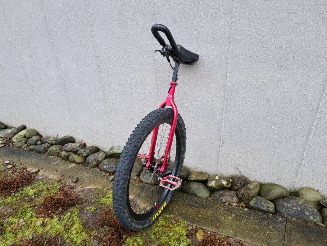

Today, I converted my 26" freewheel muni, which I had been using for more than 3 years, to 29"! First ride went pretty well, the 29er fits my local terrain very well (trails with lots of roots and mud, dirt roads in between). I kept the 125 mm cranks.

Bicymple sells some:
The Bicymple Play has a “Single-speed, Freewheeling bicymple Proprietary” hub.
The Bicymple Penny Farthing has a “Proprietary Schlumpf hub, 2-Speed, Freewheeling”.
