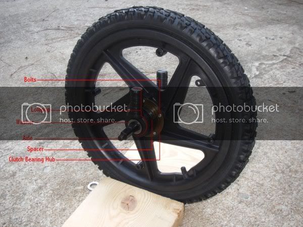

Front wheel assembly with cranks removed.

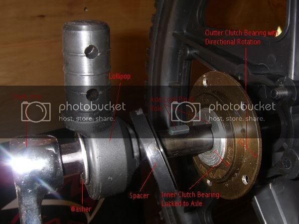

There are also little C-clamps in front of the washers that you must remove to disassemble the wheel.
Once the C-clamps are removed, the washers, lollipops, spacers and axle should all be free, fully exposing the clutch bearing hub and axle lock pin. Be careful not to lose the axle lock pin when removing the axle. It will fall out.

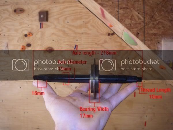

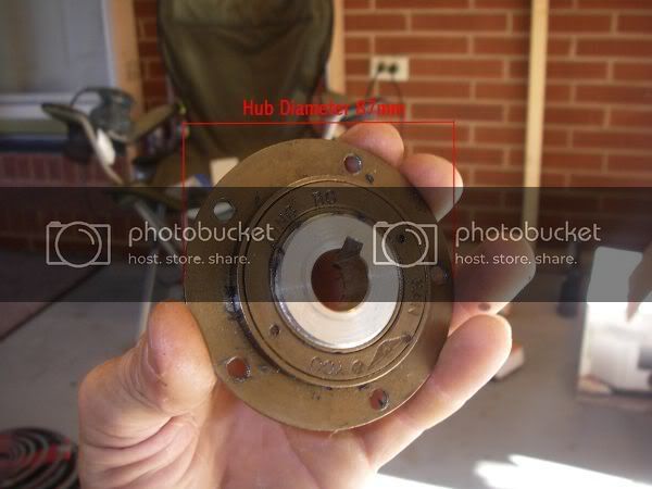

The Clutch Bearing Hub is held in place by 5, #5, hex bolts. Once those are removed your ready build your own freewheel.
All measurements are approximate within a mm or so.
What I’m planing on doing, is drilling spoke holes in 2 of these and connecting them a large spacer to form a hub.
