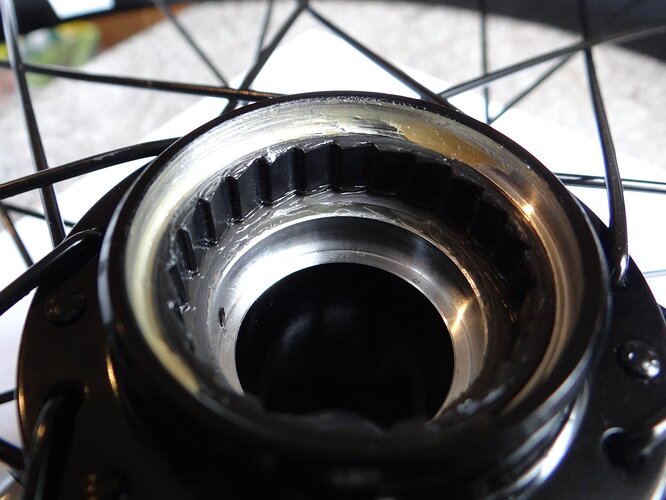

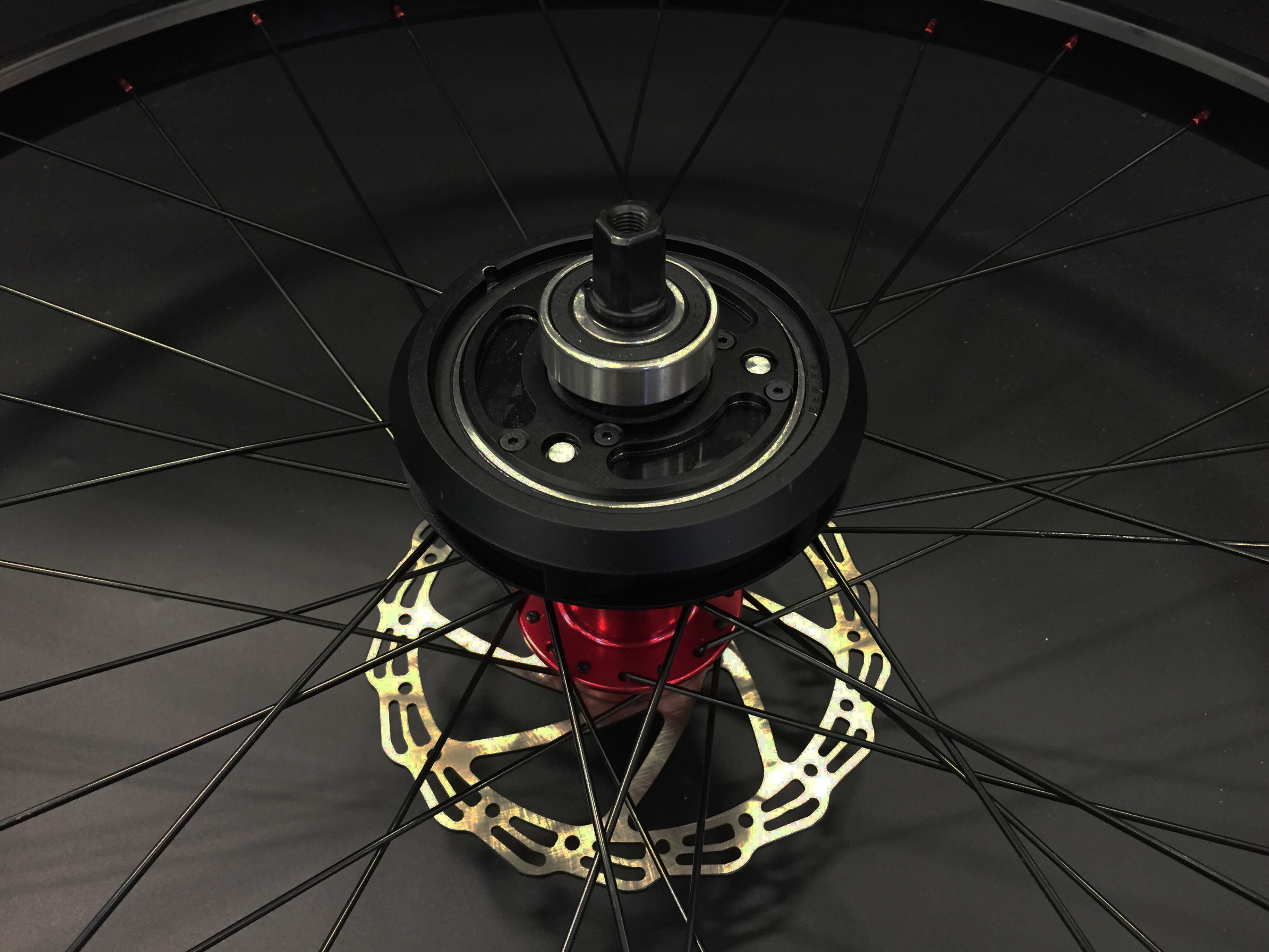

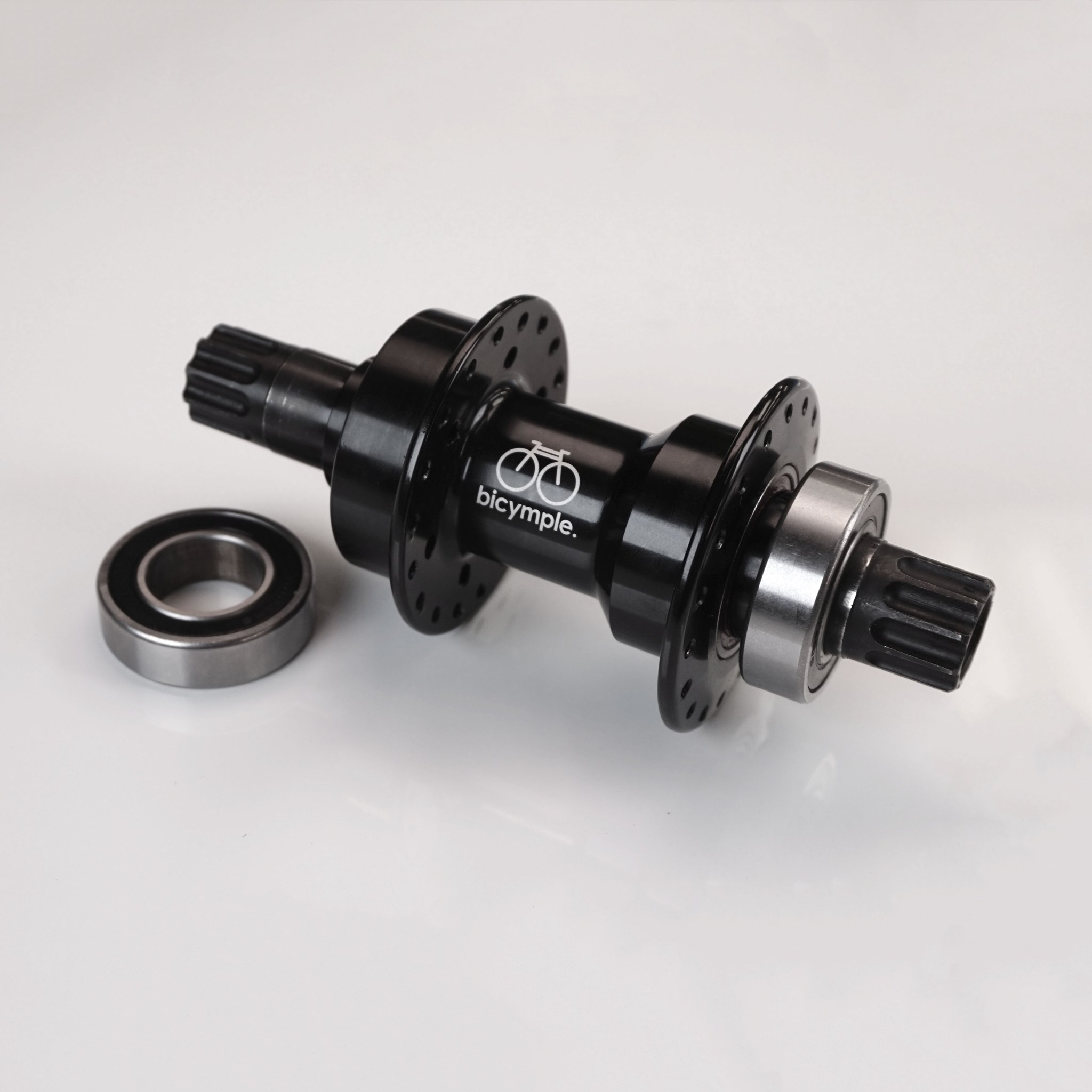

Bicymple 1:1 ISIS Freewheel Hub
Internals
Summary
The first available ISIS 1:1 freewheel hub.
ISIS spindle
100mm bearing spacing with standard 22x42x12 bearings.
24 points of engagement.
This hub has been weighed at approximately 590g (incl. bearings, without bolts), 639g (incl. bearings, incl. 12mm bolts).
Availability
None direct from Bicymple - we bought them all.
Bicymple are investigating the manufacture of more, or they very occasionally appear for sale second hand.
Usage
This hub can be used as a straight swap in any internal disk unicycle frame without modification or bearing shims. Normal ISIS unicycle cranks can be used, but crank spacers are essential to stop the hub from coming apart during riding.
So far a handful of riders have these hubs with reports that aside from the ISIS cranks and smaller Q-factor, there’s very little difference in feel from the JR P-Hub (see below).
Issues
The hubs use M15x1 axle bolts, that although they conform to the ISIS spec, are an uncommon size on unicycles (we normally use M12x1).
ISIS crank spacers are essential. There are two bearings press-fit into the hub shell which although may stay in place initially, require the use of crank spacers to ensure they don’t come out of the hub.

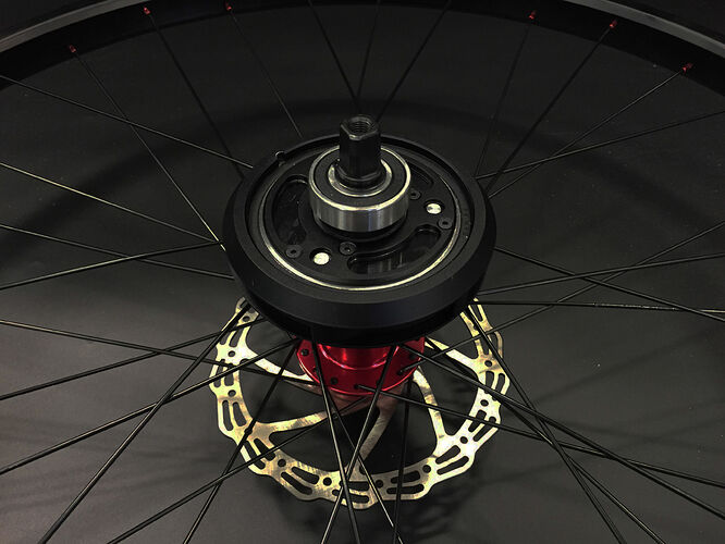

To maintain the clutch on this hub, the clutch side sealed bearing must be removed from the hub. This is a press fit so it may not be trivial to do. The axle pushes out towards the clutch side - pressing/hitting the disk side of the axle should make it fall out of the clutch side of the hub.

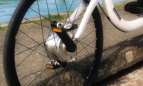

Schlumpf/bicymple 2 speed Freewheel Hub
Summary
This is a freewheeling variant of the Schlumpf square taper geared hub.

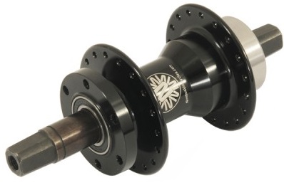

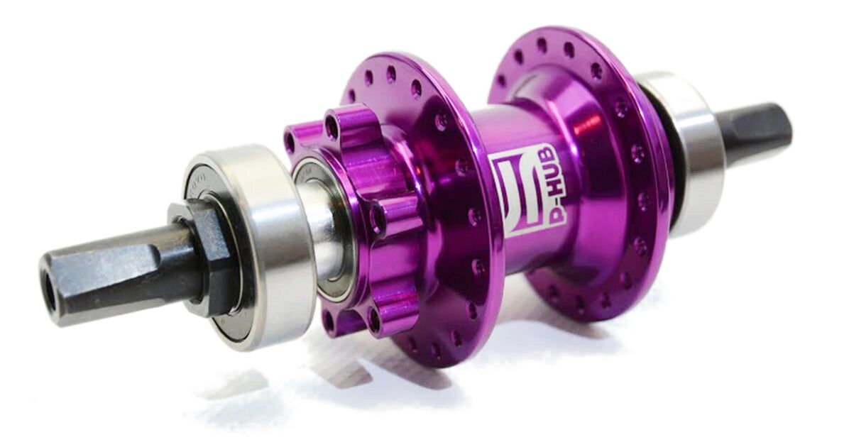

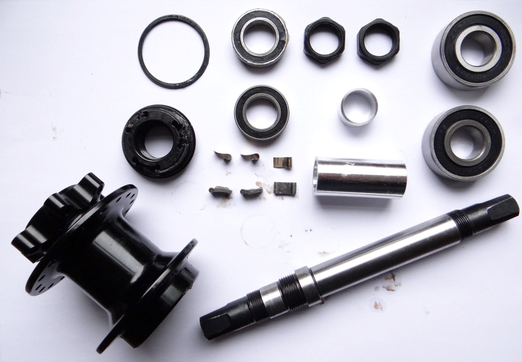

Nimbus/Madazz Drift Trike Hub
Summary
This hub has 100mm bearing spacing, with a square taper axle, and optionally a standard 6 bolt disk brake mount. It comes in black (Nimbus/Madazz) or Orange (Madazz only).
UDC lists a weight of 618g.
Availability
Limited
The Nimbus hubs are no longer in production - some stores still have stock.
Usage
This hub used to be commonly used for building freewheel unicycles due to its reasonable availability from unicycle.com and other suppliers. It also has close enough hub flange dimensions to be used interchangeably in stock Nimbus/KH wheelsets without requiring new spokes.
To use this in a frame designed for ISIS hubs with 42mm bearing holders, you require 1mm shims, or replacement bearings (17x42x12)
Issues
  • The clutch in this hub has only 18 points of engagement, which can mean that a moderate amount of pedaling is required before engagement.
  • The hub shell is not very thick, and under hard pedaling has been known to crack in half on numerous occasions. Therefore this hub is not generally recommended for use off-road, especially with long cranks and uphill usage.
  • The axle is square taper which means a limited number of strong cranks are available and it may not hold up very well over time, especially off-road. This has however not yet been an issue - the hub shell cracks first!
Maintenance
  • Bearings don’t last forever - they should be always coated in a light coat of oil or grease to reduce surface corrosion, and they may need replacing every few years depending on riding conditions and distance.
    To remove the bearings, both circlips must be removed. Circlip pliers are highly recommended to avoid damage.
  • The hub should ideally be checked for wear, and cleaned and re-greased regularly to ensure a long and reliable life. This should probably be done every 500-1000 miles with the amount of abuse that unicycling can give to these hubs that were not designed for it. To do this, the non-clutch (disk) side circlip is removed, and the axle can then be lightly knocked out from that side.
    To re-install, spin the axle in the freewheel direction while re-inserting and the pawls should automatically retract and slide into the hub shell, then reinstall the circlip.
  • UDC UK now sells replacement pawls for this hub.

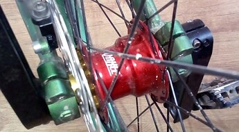

JR Drift Trikes P-Hub
Internals:
Summary
This hub has 100mm bearing spacing, with a square taper axle, and a standard 6 bolt disc brake mount. It comes in black or purple.
This hub has been weighed at 690g.
Availability
Limited
This hub is as far as I know no longer in production. Stock is limited.
Usage
This hub has commonly been used for building freewheel unicycles due to its general superiority over the aforementioned Nimbus/Madazz hub, although the Bicymple hub is expected to be a superior choice in the future. It has close enough flange dimensions to be used interchangeably in stock Nimbus/KH wheelsets without requiring new spokes.
To use this in a frame designed for ISIS hubs with 42mm bearing holders, you require 1mm shims, or replacement bearings (17x42x12).
Issues
  • The clutch in this hub has only 24 points of engagement, which although better than other hubs, can mean that a moderate amount of pedaling is required before engagement.
  • The hub flanges are very close together, which means that larger wheels especially have limited strength compared to a standard unicycle wheel. So far this has not been an issue even on wheels up to 32" (ridden on road), but is something to bear in mind.

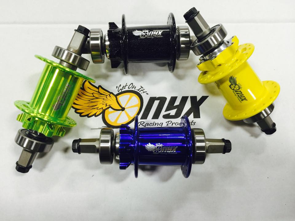

Onyx Racing Drift Trike Hub
Summary
Onyx Racing makes Sprag Clutch bicycle hubs, and briefly made a short run of square taper drift trike hubs with sprag clutches.
Presumed to be 100mm spacing and standard 17x40x12 bearings for square taper hubs.
Expensive when available ~$500, and unavailable without a new order with MOQ of likely >5 units
Availability
None
No longer in production, never seen second hand.
They apparently could make us ISIS ones, but they’d come in at >$700 with a MOQ of 10 units.

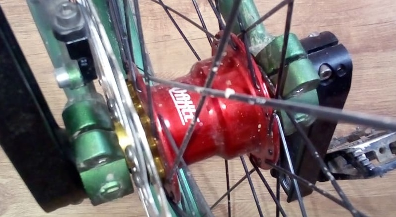

@aws has made his own ISIS freewheel hub with two sprag clutch bearings:

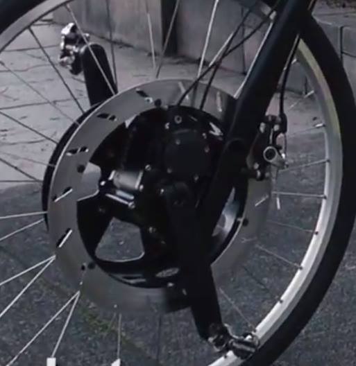

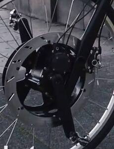

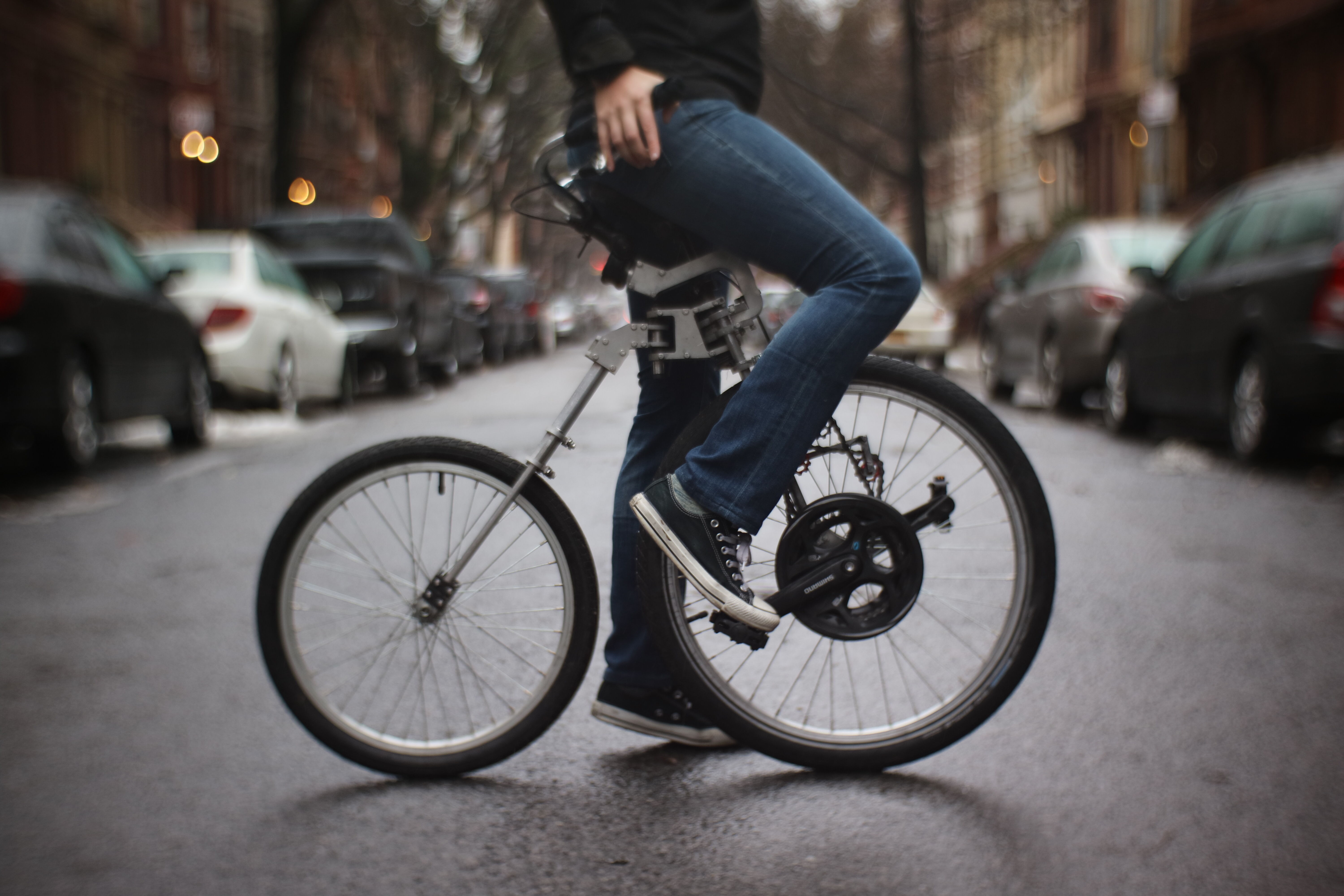

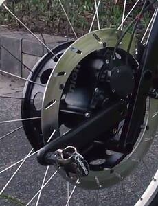

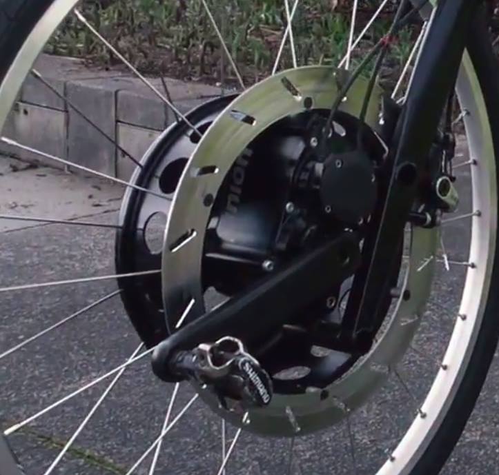

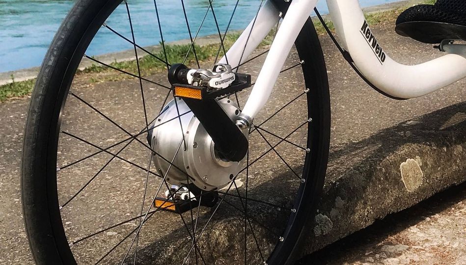

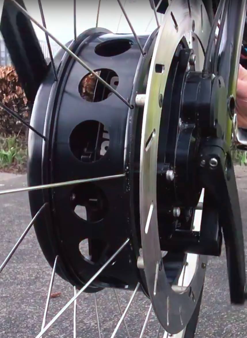

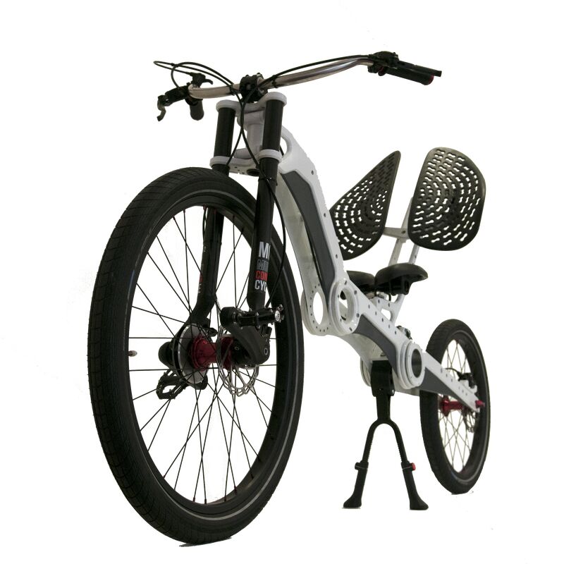

MC² Transformer Bike
This is an interesting bike that first appeared in 2014 as a crowdfunding campaign, went on to full production, then the company went quiet more recently.
Most interesting to us unicyclists is the front wheel, complete with a two speed geared freewheeling hub.
The bearing spacing is unknown, but it’s presumed to be close to 100mm, and it appears to use standard 17x40x12 square taper axle bearings.
The shifting appears to work by means of a free-spinning planetary gear set (for 1:1), with an outer ring gear that’s locked in place to go to the high gear (1:3). In the prototypes this locking mechanism was a secondary disk brake, but the finished products appear to possibly use some kind of drum brake or enclosed disk arrangement.
With some imagination, one can see how this same idea could be used to create a freewheeling/fixed hub complete with hand controlled shifter. If there is enough modulation in the “gear changer” then this could potentially be used as a rudimentary CVT, or at least allow you to slowly change gear rather than jump from 1:1 to the slightly insane seeming 1:3.
The gear change is demonstrated in this video: https://www.youtube.com/watch?v=3H0yx-0o22Y

Bellcycle
This is another crowd-funded product that went on to full production, but it was only ever sold as a kit of parts.
It utilizes an extra wide square taper axle complete with chain drive in a similar manner to some DIY geared unicycles but with a freewheeling sprocket connected to the driving wheel.
http://bellcycles.com/ (website working Jan 2021)
Kervelo Bicycle Hub
This was a hub designed for a recumbent bicycle by the company Kervelo.
It consisted of a Pinion P-line gearbox with single sided mount and a huge custom cage hub and wheel surrounding it.
This never looked like it would be the strongest design around, but it was a fascinating concept and it presumably worked on a recumbent!
It used ISIS cranks, would have been at least 2.7KG (the weight of a Pinion gearbox), and due to the single sided mount, almost certainly not strong or stiff enough to ride as part of a unicycle.
Kervelo kernel-hub
Following the apparent success of their previous hub prototype with a Pinion gearbox, Kervelo then went on to create the Kernel Hub, a 6/12 speed internally geared hub complete with ISIS cranks and pretty normal looking spacing, but with a somewhat unusual looking mounting setup.
Sadly despite apparently going into production, this disappeared as fast as it appeared and it never seems to have actually been sold.
https://www.kervelo.com/transmissions/gearhub-kernel-hub/ (web-page no longer exists - 2021)
Bicymple
Another front wheel drive bicycle that went into production, using either a freewheeling Schlumpf 2 speed hub, or their own custom made ISIS 1:1 freewheel hubs.
https://shop.bicymple.com/products/bicymple-penny-farthing (Website working Jun 2021)
