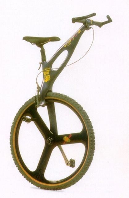

If it was in fact a real uni, it was a one off (and I’m 99.9% sure it’s just photoshop).

The UNIPSYCHO lefty unicycle seems to be related to UNIPSYCHO: A Documentary about a unicyclist football player.
There are some unicycles in the documentary but not the lefty with “UNIPSYCHO” on the handlebar/frame as in the image.
I’d guess it is photoshopped image or a nonworking model for a couple reasons, 1. There seems to be no other photos of it and 2. The pedals look to be about 200mm long and would be well in the pedal strike area. Also has a bicycle saddle, weird brake cable/handle and the wheel spoke and left crank arm do not seem to be in line.

You’re right with the saddle. That doesn’t look like a uni-seat and is quite the give away. The cable that dangles like that I could sort of understand. On my unis, the cable is also quite long so I have to loop it around the frame a few times.

  • This thread shows a picture of a “real” lefty unicycle (by accident)
  • In this thread of the German subforum there were several design concepts made and discussed, how this could be realised. It ends with a picture of a realised unicycle.
