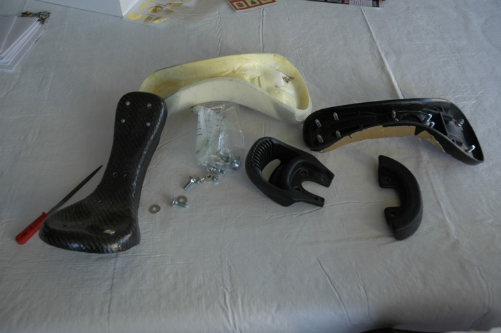

So I got a KH cf base for christmas and am about to drill it and such. Its alot of money so encouragement and advice would be helpful. Hope i dont mess it up and will post progress as i get farther it should be awsome. I know there is a search function for advice on this i just want to do it anyway and post my progress. Off to start working.
Okay so now, since i started this morning, i have drilled all of the holes and filed one of them so the carraige bolts will fit correctly. So now im halfway to finishing the bumper. 1/9th of the way there!

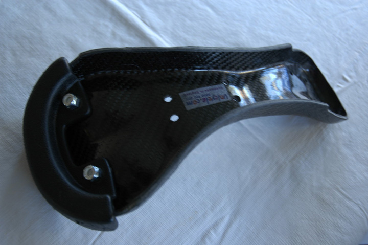

Okay I had already started the second hole and now im done with the bumper! Its a little crooked i know but it works and fits well enough. so now im 2/9ths done. two down seven to go. I probably wont finish it tonight since i have to go to work in 2 hours.

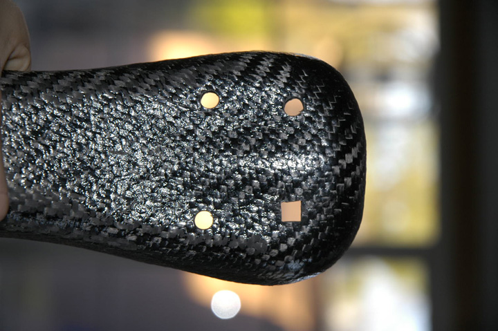

so timbob and I have been in disagreement. after drilling the holes are you supposed to file the holes to be square or just pound the carraige bolts in?
7/10

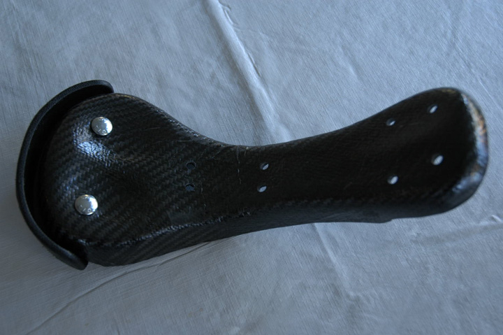

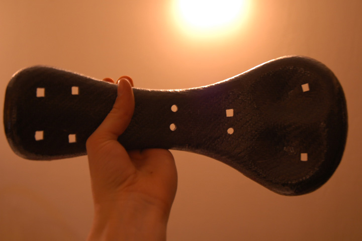

Anyway, I finished the other one so im 7/10ths of the way done. Im going to sleep now since its almost 11:00 now. Ill try to finish it early tomorrow morning or something. Heres the pic and i take them and type all of this because after filing for that long i need a quick break. See you tomorrow morning.
Oh yeah its a bad picture but its too dark to get a better one that shows the holes
Looks good. Keep in mind that filing a hole square can actually move the hole a little bit. You want to make sure that you don’t accidentally move a hole so far that it no longer fits the seatpost.
Best way to proceed is to file one hole square. Put all four bolts in and make sure they still line up with the holes in the seatpost. File the next hole square. Put all four bolts back in and make sure they still line up with the holes in the seatpost. Repeat for the remaining holes doing one hole at a time.
If the holes aren’t lining up you can take advantage of the fact that you can move the holes while filing them square. If things are further off you can turn the square into a rectangle and still be all good. You only need two or three sides of the square (or rectangle) to be flat and in contact with the shoulders of the carriage bolt to keep the bolt from spinning. So there is actually plenty of fudge room if the holes drift a little bit off while filing them. It’s no big deal. I had to make a couple of rectangular holes (slots) in my CF seat to keep the seatpost holes lined up with the seatpost.
This is a good tip which I may need to use. I bought my CF base and paid the vender to pre-drill and pre-file. Well, the pre-drilling was off, almost so much that I couldn’t assemble the thing. If I ever take it apart again, which I will, I’ll try this method of fudging.
Thanks. Yeah im filing one at a time and then making sure they still line up. If one hole needs moving i file that direction first and while filing i check to make sure im not drifting. The handle and bumper fit so far although it was extremely hard to take off the handle afterwards.

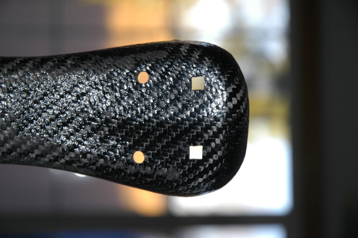

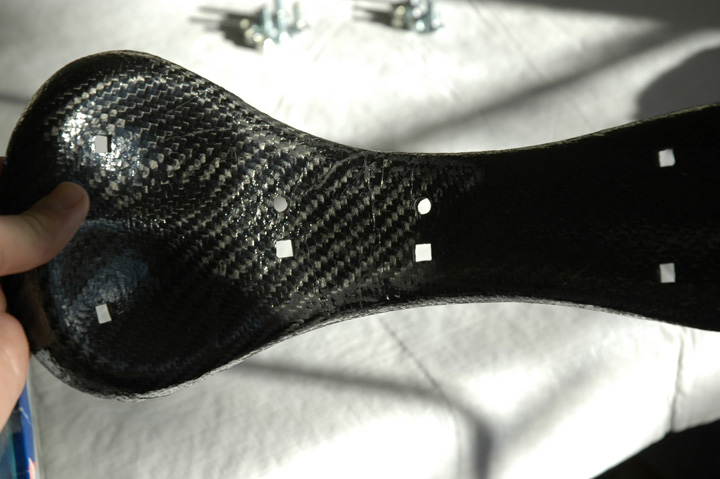

So im now 8/10ths of the way there. Its going pretty good but i need to go to the store to get the washers and last bolt and nut.![]()
Heres the pic so far i need to go get the stuff now.

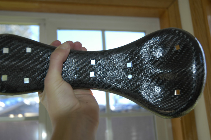

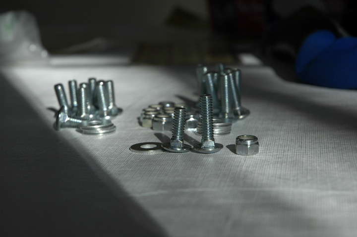

Well that took a while but now i have all the bolts, nuts and washers i will need. I bought 1/4 diameter and 3/4 length but they might not be long enough so i also bought 1 inch long ones. now i will file the last two holes and then i can put it together.
