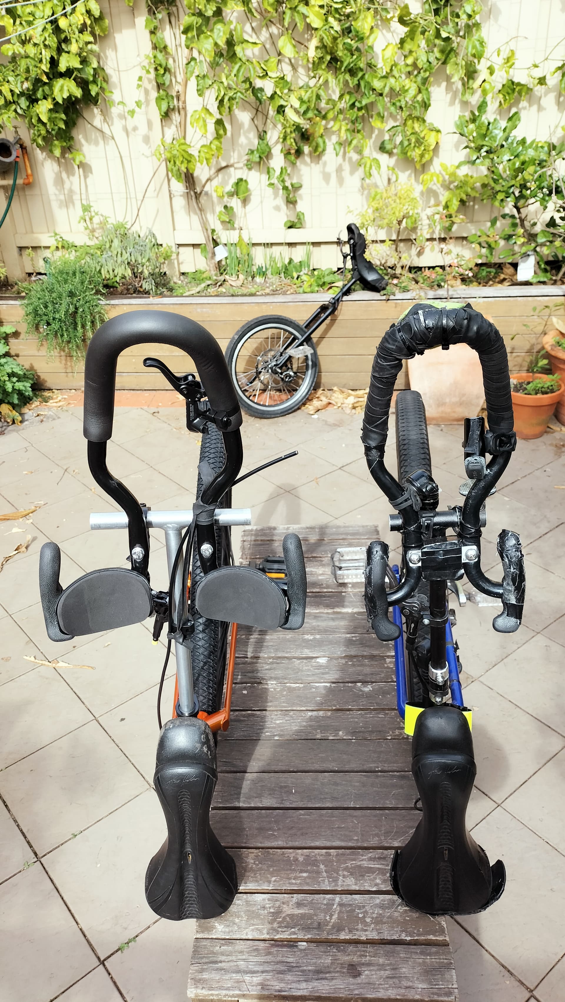

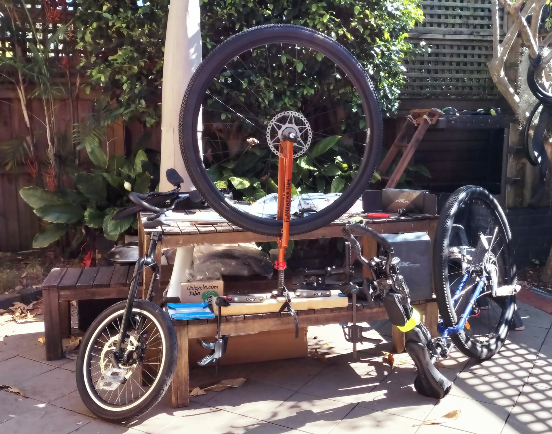

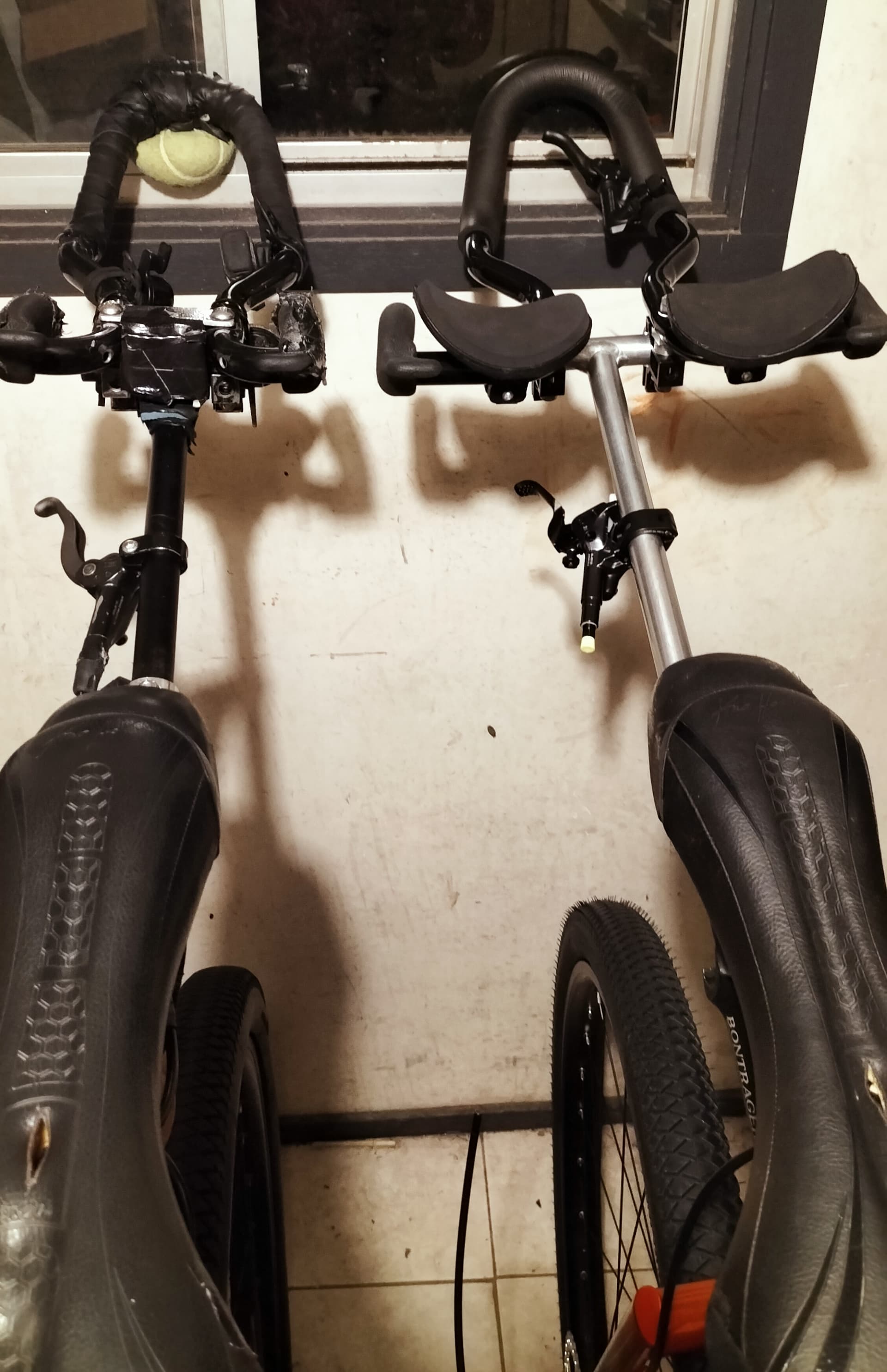

G36 assembly, might have all the bits…finally… :crossed_fingers:
Installing cranks and Aero bars with with 2 brake levers.
Trusty KH36
KH29 converted to 20" Freewheel. No seat 'cause I’m using the seat post for the G36 assembly stand.
Why do <ou have 2 brake levers on your uni? Is one not enough?
I want to have access to brakes while staying in “aero” position. I usually ride in this position, mainly to keep weight off my butt… With Sit-bones in contact with the back part of seat.

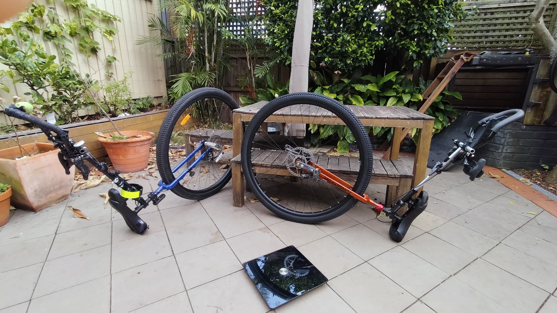

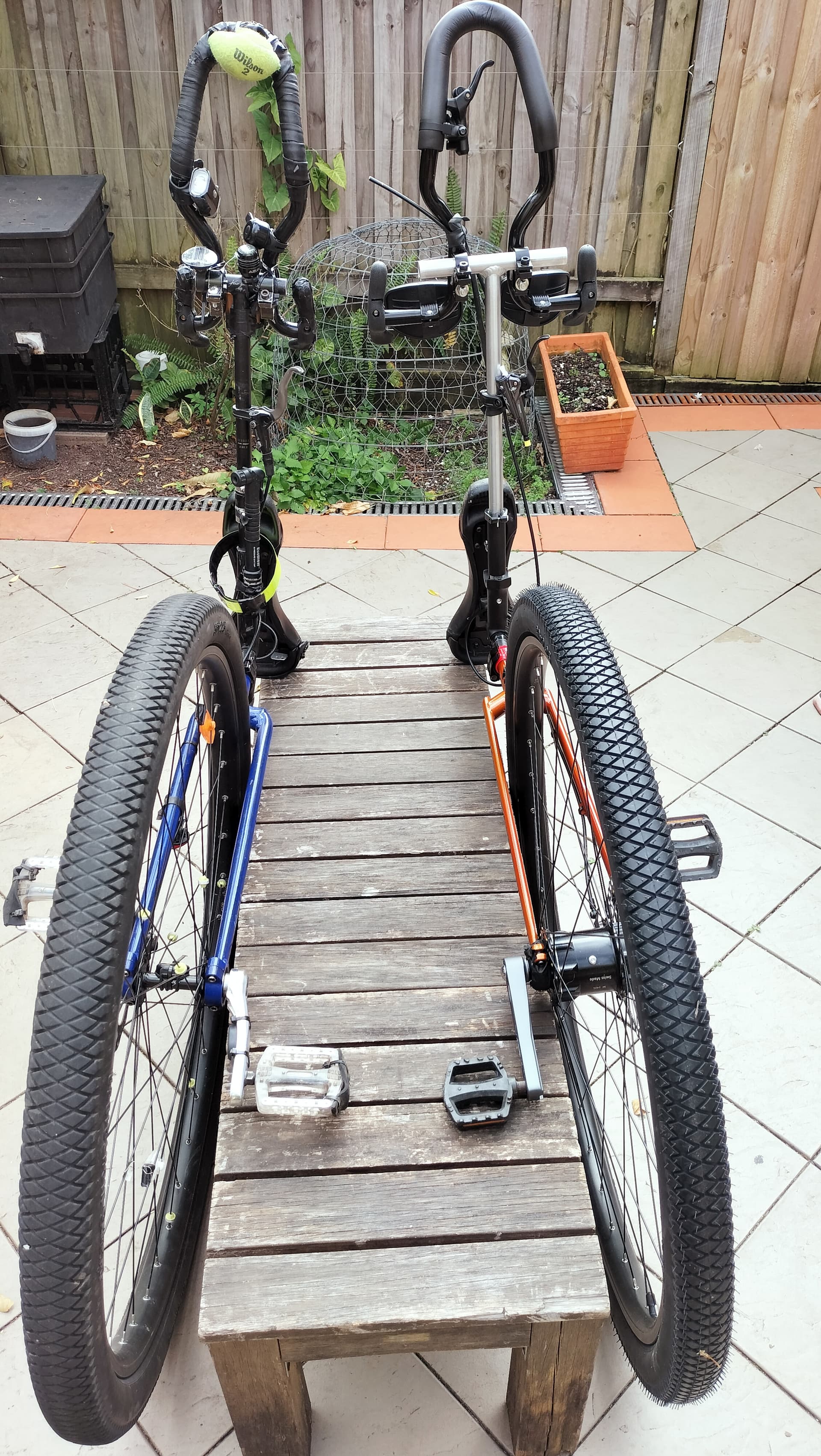

See below KH36 and G36 side by side
I still need to connect the hydraulic hose for the Shimano XT brake set and the GRX secondary in-line sub brake lever
KH 36 (with Nightrider tyre 36"x2.25") 9.8kg
G36 (with Nightrider lite 36"x 2.25") 10.1kg

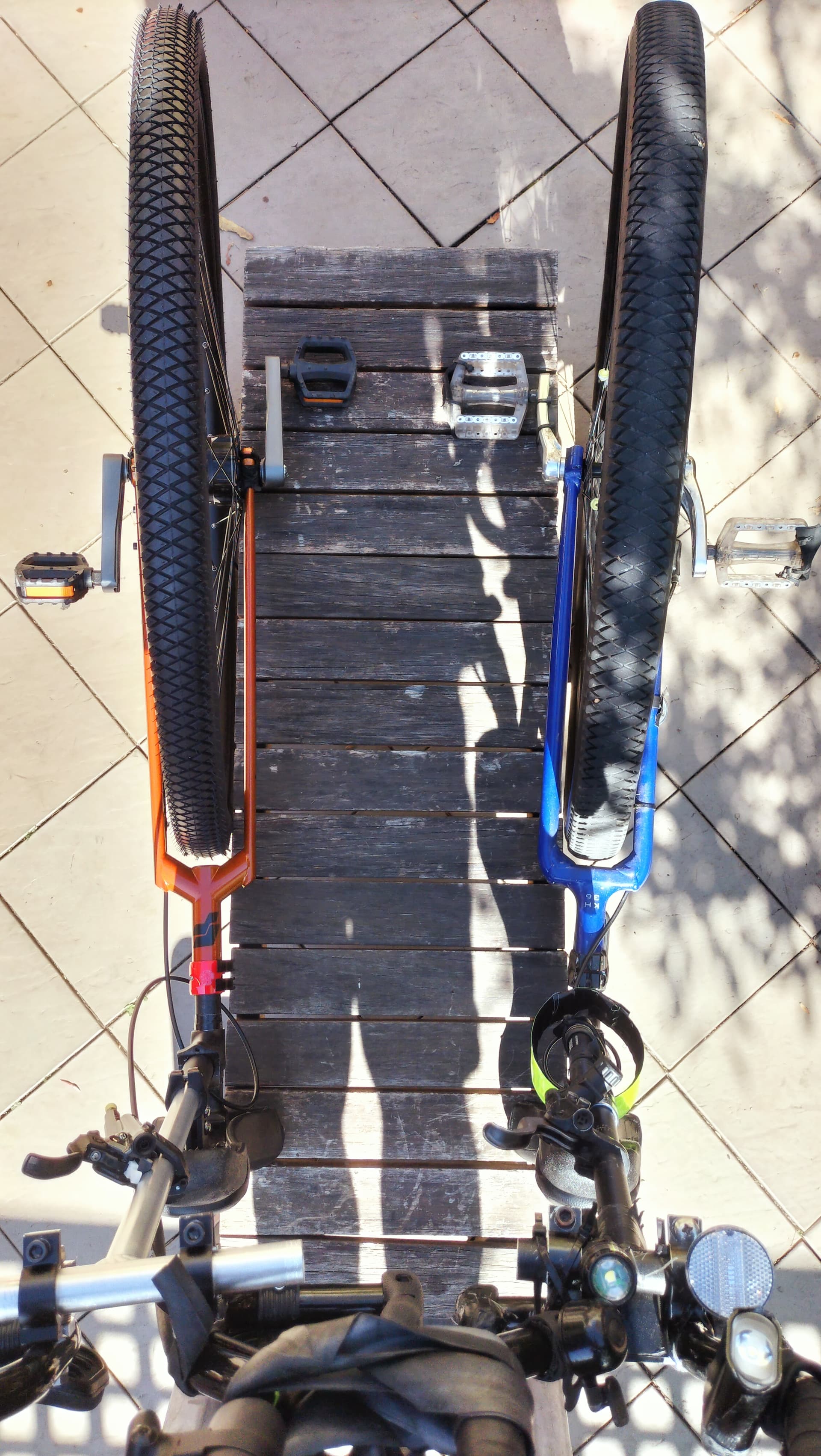

Time for an updated picture of my favorite uni sizes 36" and 29".

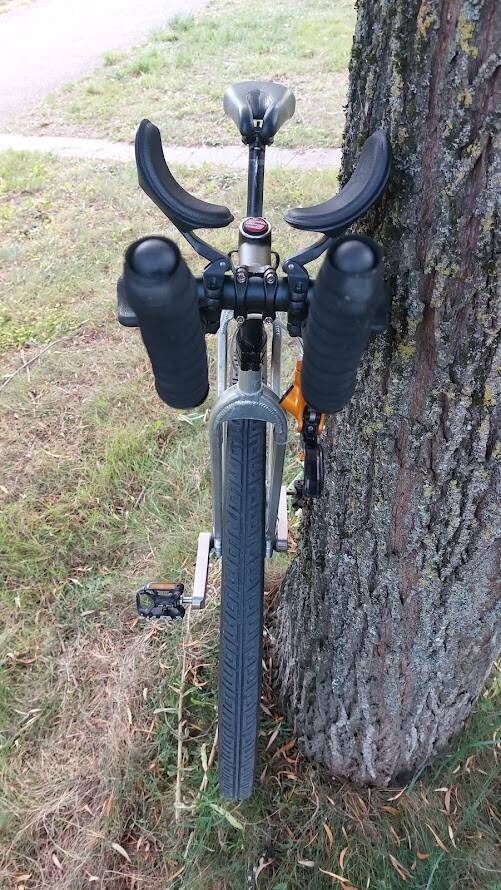

I keep tweaking my setups and this is the latest iteration. Latest change yesterday is the new simple handlebar on the 36" (replacing the previous M4O handle saddle hack). Really like the look of the handlebar on the 36" as the mount also replaces the seat post clamp for a very clean look.
36" is with 127mm KH Spirit cranks and 29" is with 114mm Nimbus Venture cranks. Seems to be a good fit for my current skill level. I’ve tried shorter on both uni sizes without any change to my average speeds.
A few closeups of the handlebars from different angles are available here.

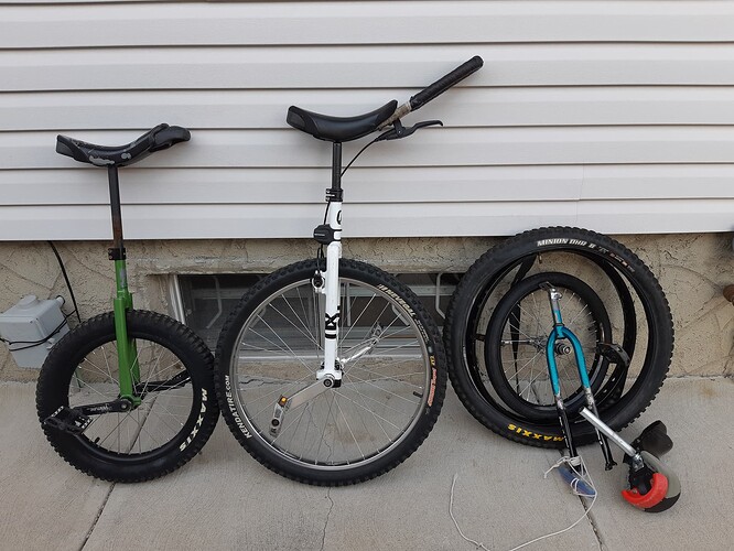

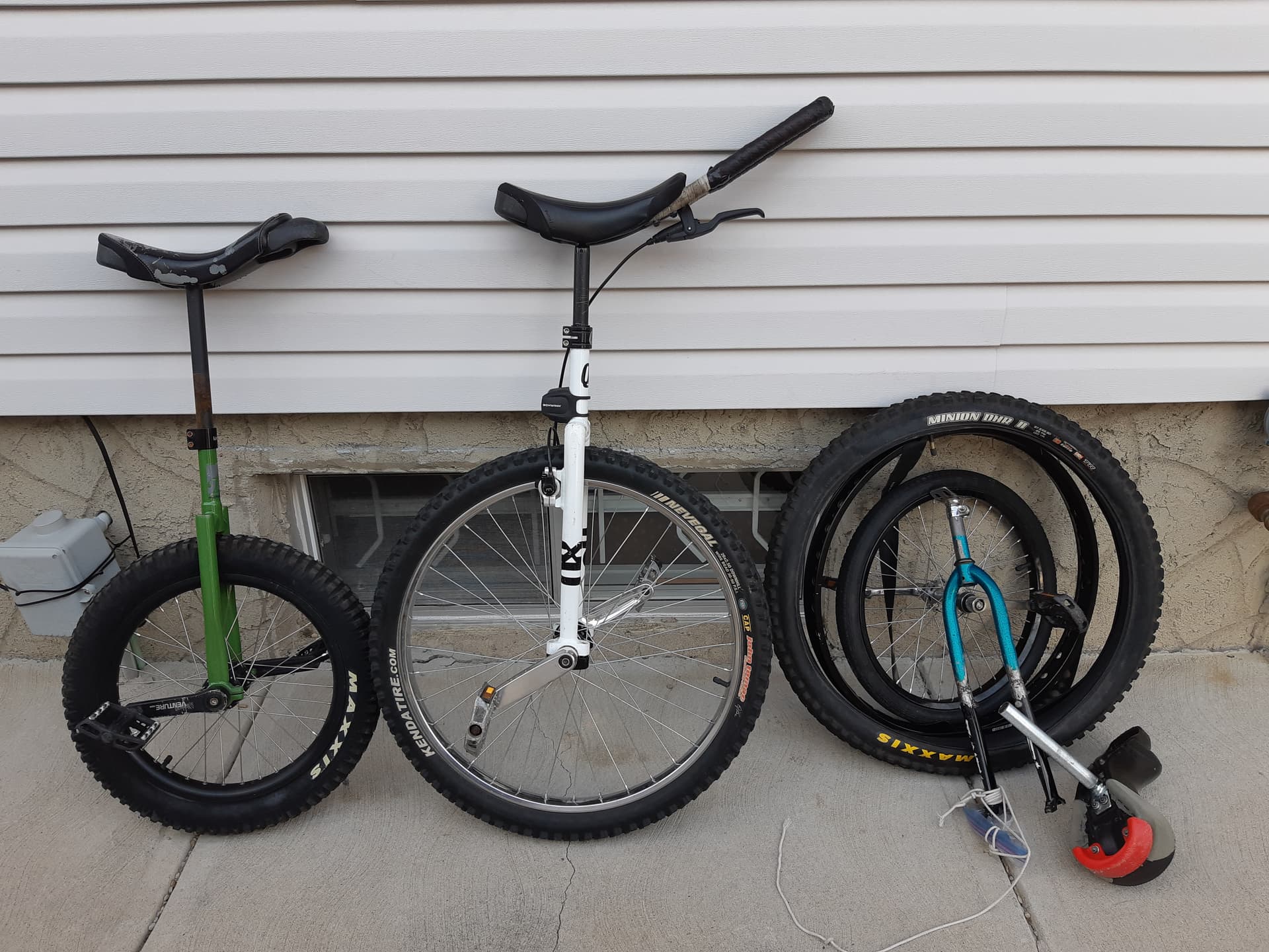

So, I just bought this 20" Nimbus on the left locally from a man whose son had given up. Got a great price on it. I plan to use it to work on my technical skills. The middle one is my go to steed, I commute to work (6km, 10km, or 12km depending on how I feel and how much time i have left myself) and do longer rides with it. The unicycle(s) is a work in progress. I need to find some spokes in the garage and some time to lace up a 27.5" wheel from the old 20" wheel you see. It is a kind of garbage setup, as the frame is a home made mashup of a 20" unicylce frame that I welded to some front forks from one of my garbage winter bikes. The biggest issue would be that it is using the old cotterless hub/crank system and the frame is heavy and not necessarrily the straightest. Ha ha.
Oh, yes, I need to remove the brake cable and install a longer one. I cut it before I did the hanlde upgrade … so I cut it too short ha ha.

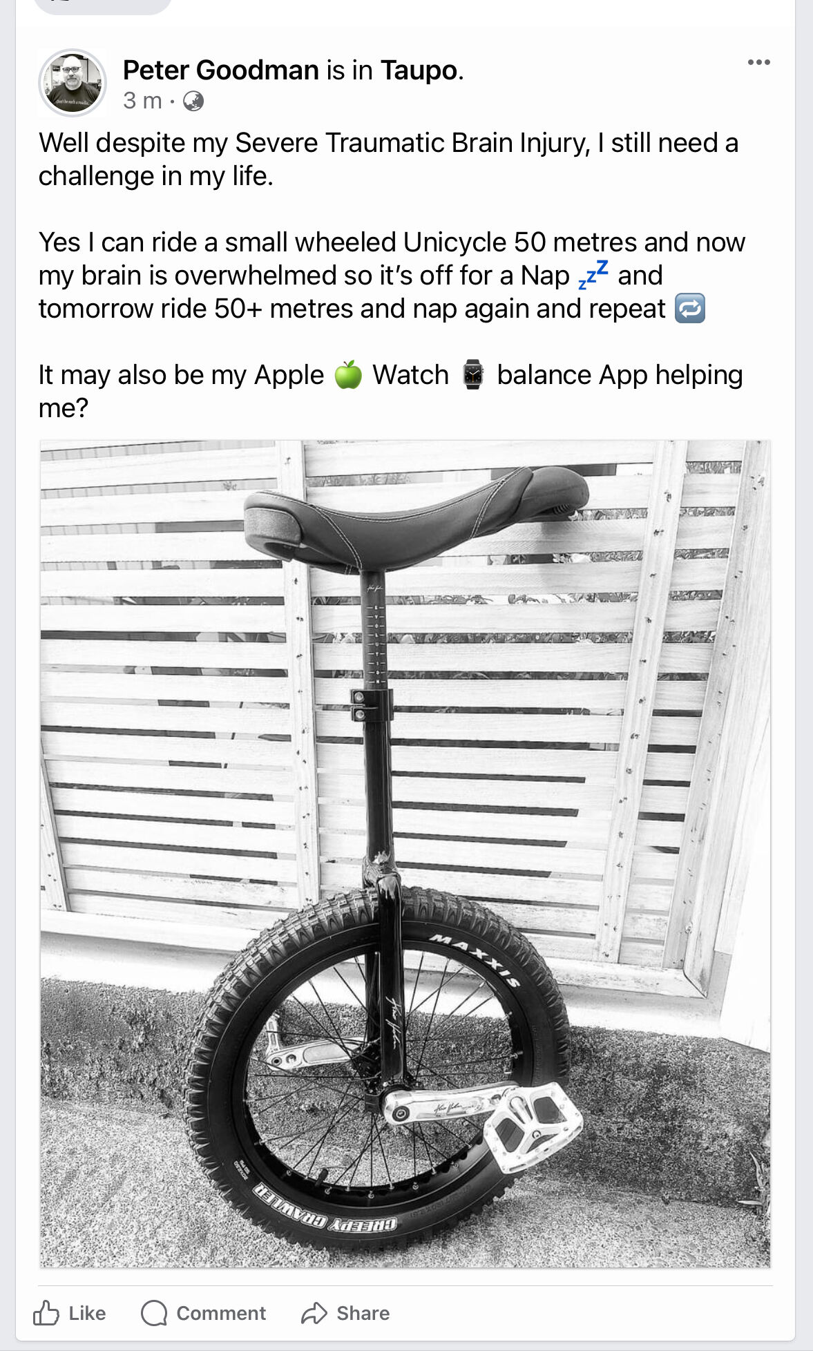

Well after a severe Traumatic Brain Injury, almost 6 years ago and nobility to still work or function normally.
Today I tried successfully to ride 50 m now I’m having to have a rest before I repeat again tomorrow.
I’m never gonna be able to ride 20 to 30 km again like I used to enjoy off-road but just trying to live life in new ways.

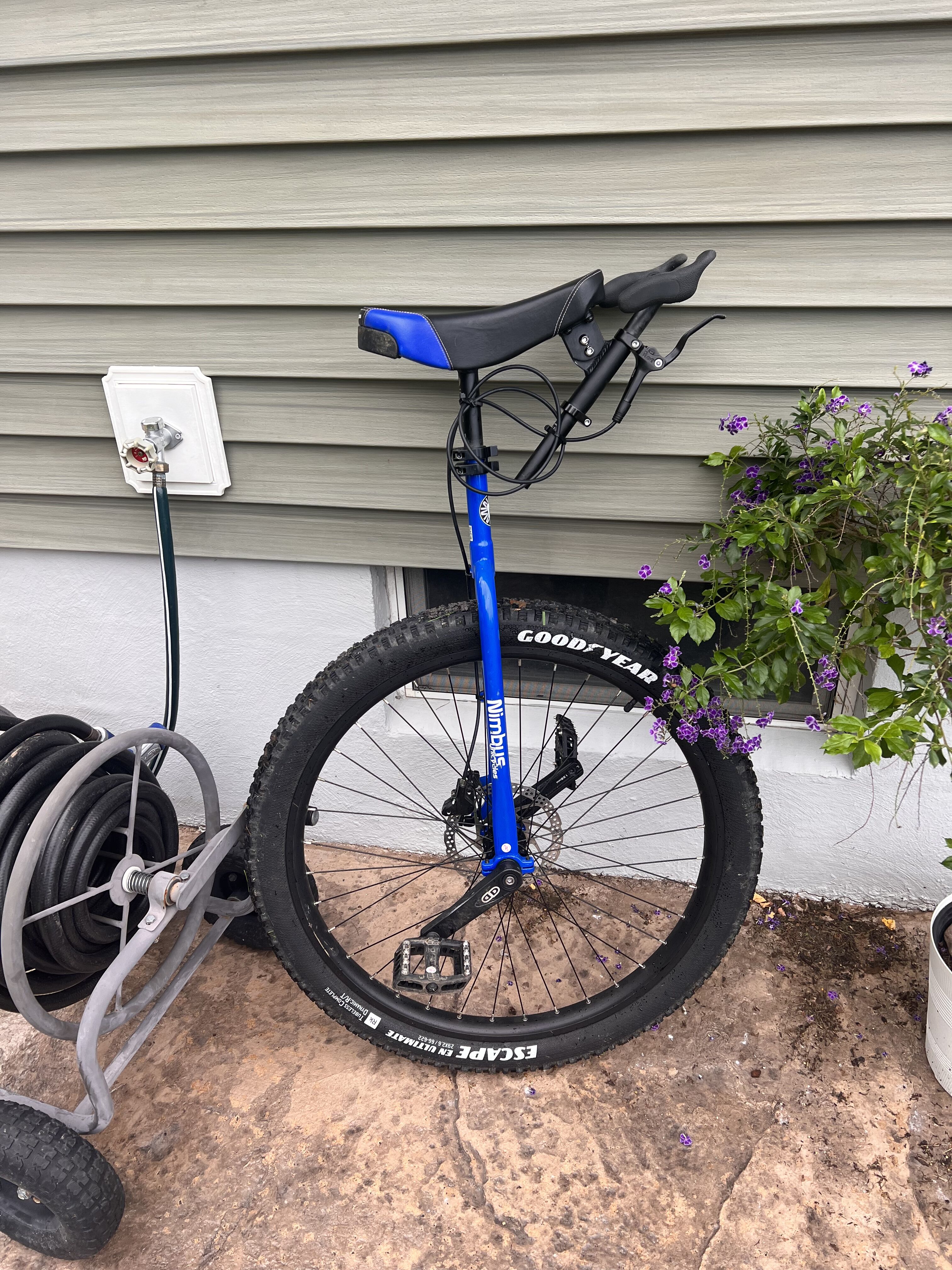

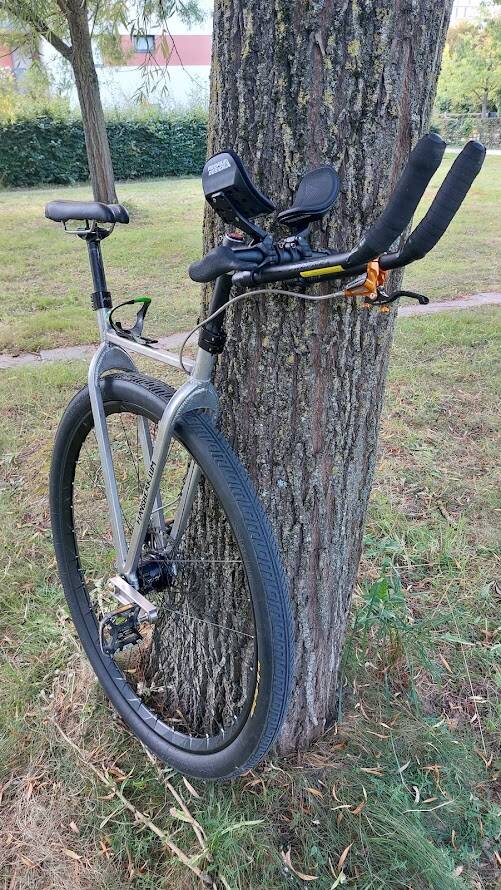

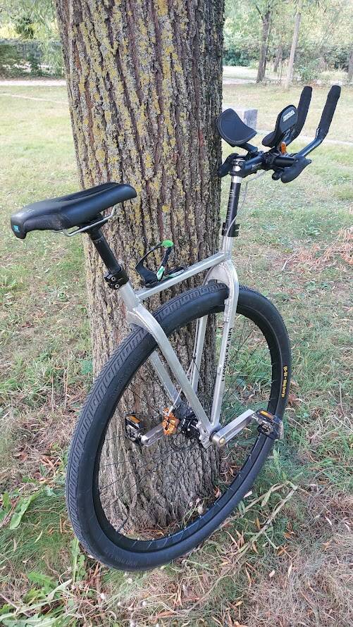

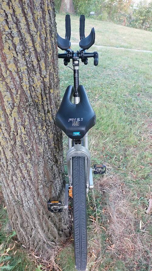

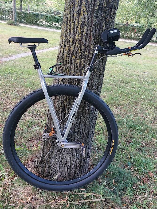

A few photos of my G36 taken yesterday. There’s still some fine-tuning to be done, but it’s already very nice like this :smiling_face_with_three_hearts:
And a short video to see me in action :
Upgrades made:
  • the KH fusion one saddle replaced by an ISM saddle
  • the standard triathlon extender replaced by an “profil design ergo clip” (with spring-loaded elbow rests)
  • thanks to this extender, I’ve been able to shorten the handlebars and use the handlebars under the elbow rests when they’re raised. The bar ends are closer and the position is more ergonomic (I don’t have broken wrists).
  • And just recently, I switched to a TPU inner tube (97g!), which saves a few grams, but also affects wheel tension (and I think it improves tire fit on the rim). Incidentally, the tube change has shifted it slightly off-center, I’ll have to see.
The only weak point I find is the position of the brake lever. Anyway, with a poor-quality disc, it doesn’t make much difference.
I haven’t (yet) switched back to clipless road pedals. I’ve got SM-SH51 cleats with the springs tightened with 2 turns of allen key, and carbon XC shoes, but they make noise. I’m going to want to go back to clipless road pedals :slight_smile:
It weighs 8.9 kg. It’s not really a factor for me, I use it mostly on the flat. And I’ve put on a few pounds this summer… :stuck_out_tongue:
What I like most is the improved comfort. A few weeks ago, when I got back on my G36 after a year’s break, I found the old saddle very uncomfortable. I was afraid to switch to a bike saddle, but I’ve done it and I’m not going back. I’m already doing 1h30 rides without pain. I can’t wait to test myself on a longer ride.

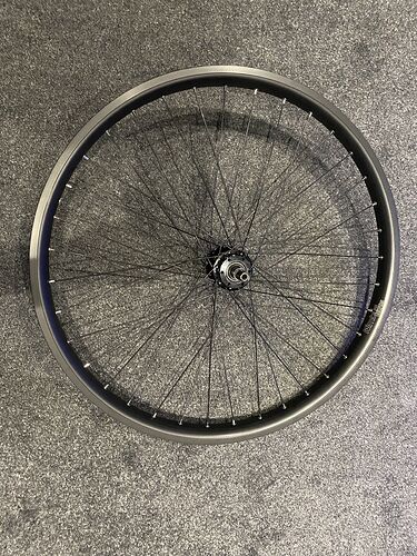

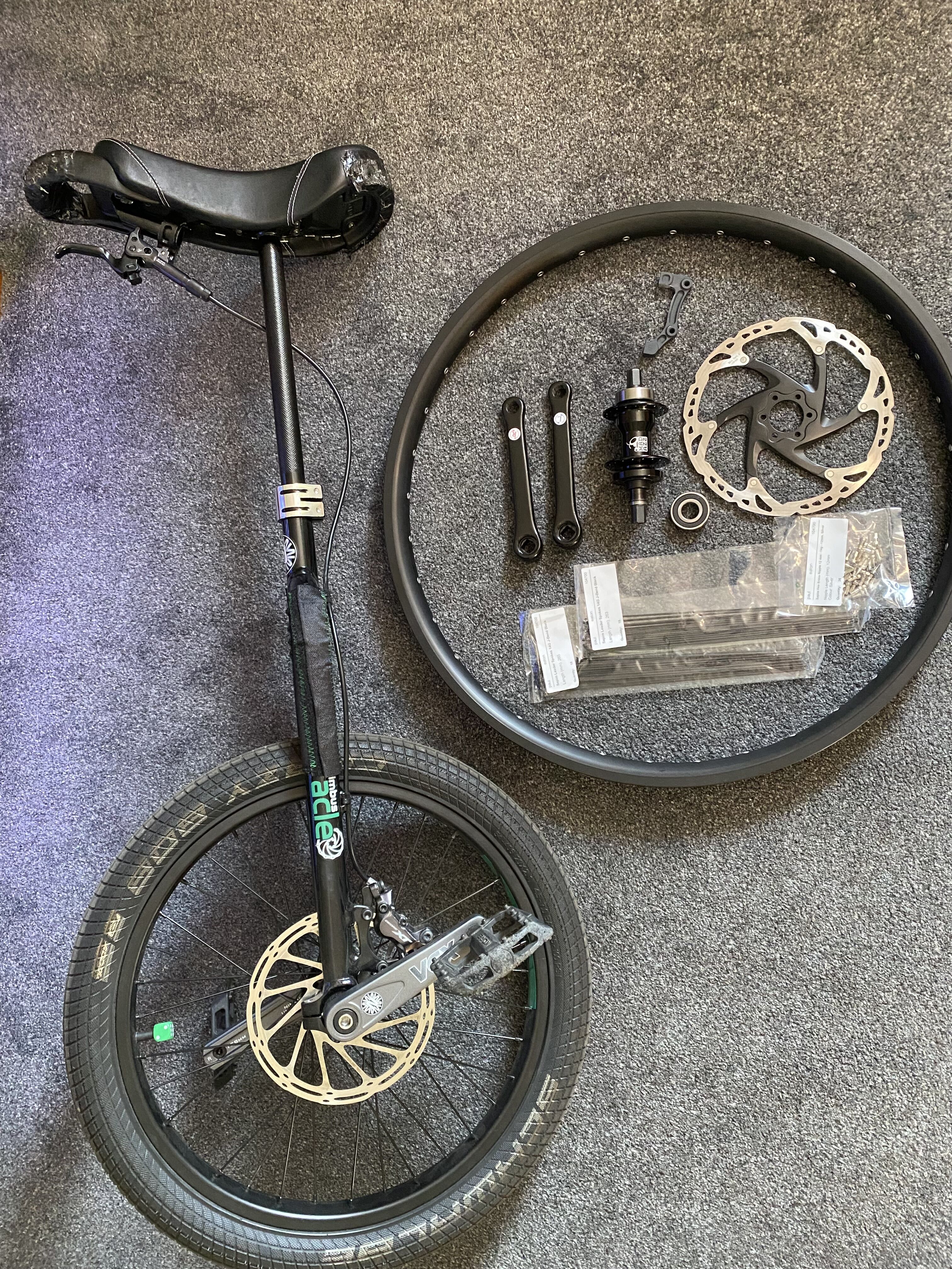

Time for my freewheel to get bigger! current build is a 20” with a bicymple hub and new build is a madazz hub with a nimbus dominator rim 27.5.
I have a week off work in two weeks time so hopefully I can get it built up so I can fall from a greater height :blush:
Mmmm… the seat looks like it has taken a bit of a beating… that decides what is going on my freewheel build for a start, just as well I don’t throw anything out :slight_smile:

Seat possibly looks worse than it is as I put gaffer tape layers on the bumpers, I find it prevents sharp edges appearing on the plastic and I just replace tape when needed.
You will find that a freewheel is going to get dropped lots more than a fixed wheel so it’s possibly not worth building it up to such a high standard to start with as I’ve noticed your builds are very pretty.
I managed to get the wheel laced up tonight with spokes looking right for tightening and trueing up tomorrow or in the week :blush:
Thank you.
You re absolutely right, I will put the Nimbus saddle and pedals that were on my 24" Nimbus that I learned on onto it – they have already bounced off the ground more that I care to think and have pretty much proved themselves as ‘worthy.’

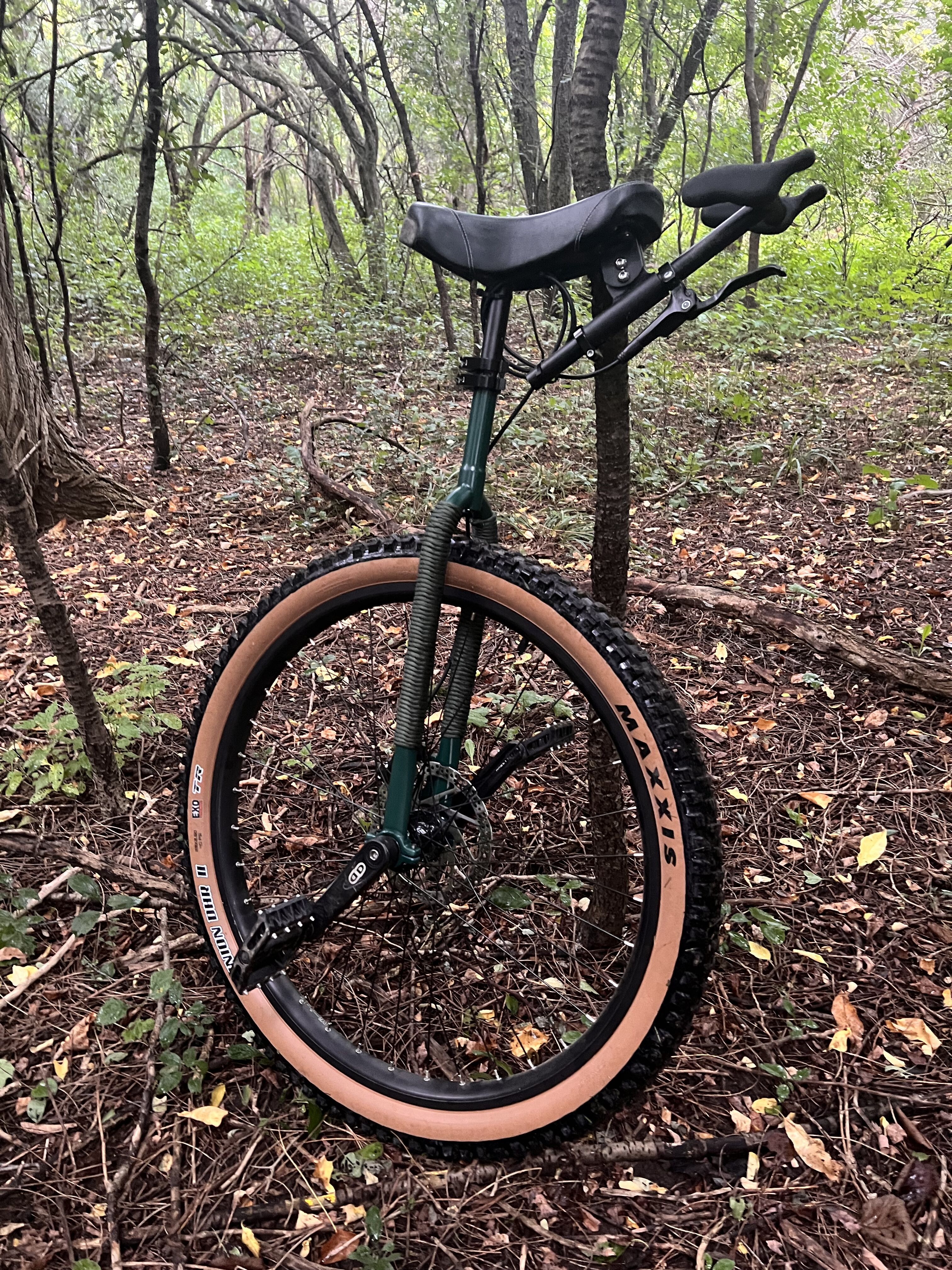

Here is my current 29” Muni and a before and after picture of it. I repainted to green, switched out the saddle to a black one from my first Muni, put a maxxis Dhr 29x2.6 tire on and wrapped the part of the frame most susceptible to scratches in paracord.
Nice work! And I’m a sucker for a tan sidewall; really makes it pop!
Thank you! The tan wall just gives it so much personality, I think.
