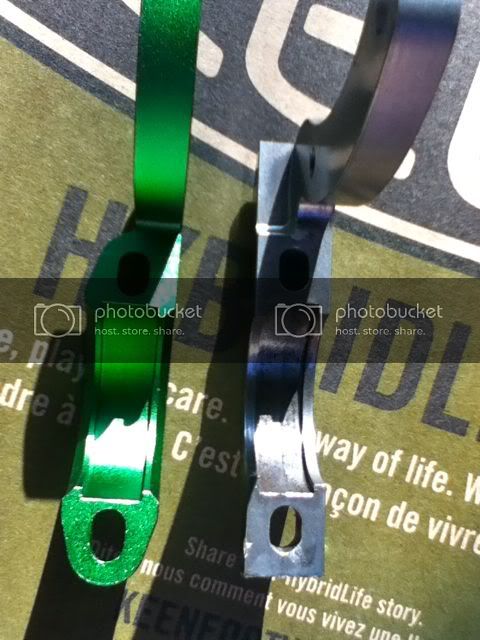

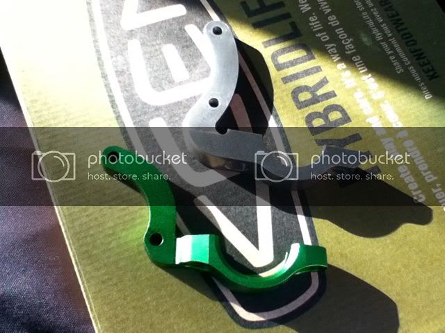

I recently purchased a Nimbus D’brake brake mount to use on my KH36 with existing MU disk brake system. UDC/Nimbus have never stated that the brake mount would work for an outboard disk, and when asked they seem to dodge the question by stating that they were designed to be used in conjunction with their disk hubs.
The reason I wanted to try the D’brake is: I have to take the calliper off the mount every time I remove the wheel with the UCM. Not a major problem but annoying for someone who changes tires/wheels a lot.
Here is the differences I found between the UCM and D’brake mount
Mountain Uni UCM
:)slightly thinner, no clearance problems, mine would just barely work with a schlumpf.
Tighter fit on bearing, less chance of movement
taller brake mount arm,
  • :)places calliper closer to the frame and makes the brake line go strait up.
  • :(caliper needs to be removed when removing wheel
Nimbus D’brake mount
:(wider, would not work with a schlumpf without additional grinding/machining. less than 1mm clearance to spokes (nimbus hub, standard spacers)
looser fit on bearing, easier to remove
shorter brake arm.
  • :(caliper is further from frame and hydro line angles out, could get snagged.
  • :)caliper does not need to be removed when removing the wheel.
I am actually not sure which one I will end up leaving on the unicycle. I can’t feel any difference braking and they both seem to have about the same amount of flex. Basically the UCM tucks things away a bit nicer but adds a step in removing a wheel.
oh and the bolt holes are about 2mm deeper on the D’brake meaning you need slightly shorter bolts. The 18mm(?) bots that come with it are a bit too long. I replaced them with some 16mm socket head bolts.

Eric aus Chemnitz brings up a good point. The MU UCM has a flat top compared to the D’brake’s staggered surfaces. Where the D’brake is tightened on the side with the arm first then snugged up on the other side the UCM would be installed like a normal bearing holder.
I still use both UCM and D’brake with both styles of outboard disk (KH and MU). I now use a washer under the arm side of the UCM to transfer the force to the frame like the D’brake does and both need to be shimmed out to work with the KH cranks as the Spirit cranks place the disk a bit further from the frame than bike cranks with a MU disk would.
I had brought up the spacing issue with Roger when touring in Uzbekistan and he said that the KH cranks with a 6mm spacer puts the disk about 1.5mm further over than the bike standard. Presumably this was done for clearance reasons at the bearing holders.
I did not know, that the UCM does not provide this staggered shape. So thats plus for the d’Brake. It’ll make no sense to tighten the bearing holder with a defined torque for not deforming and so damaging the bearing and on the other side let the whole brake force go radial right into the bearing just to deform it to egg shape.
I wonder if riders with the UCM therefore do have damaged bearings a bit more often. Did anyone have issues with that?
Before I got the D’brake I used the UCM without a spacer, it was like that for at least half a year and I had no issues. These adaptors really should have a firm surface to push on though.
