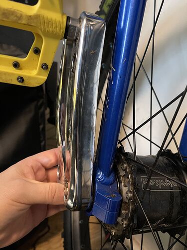

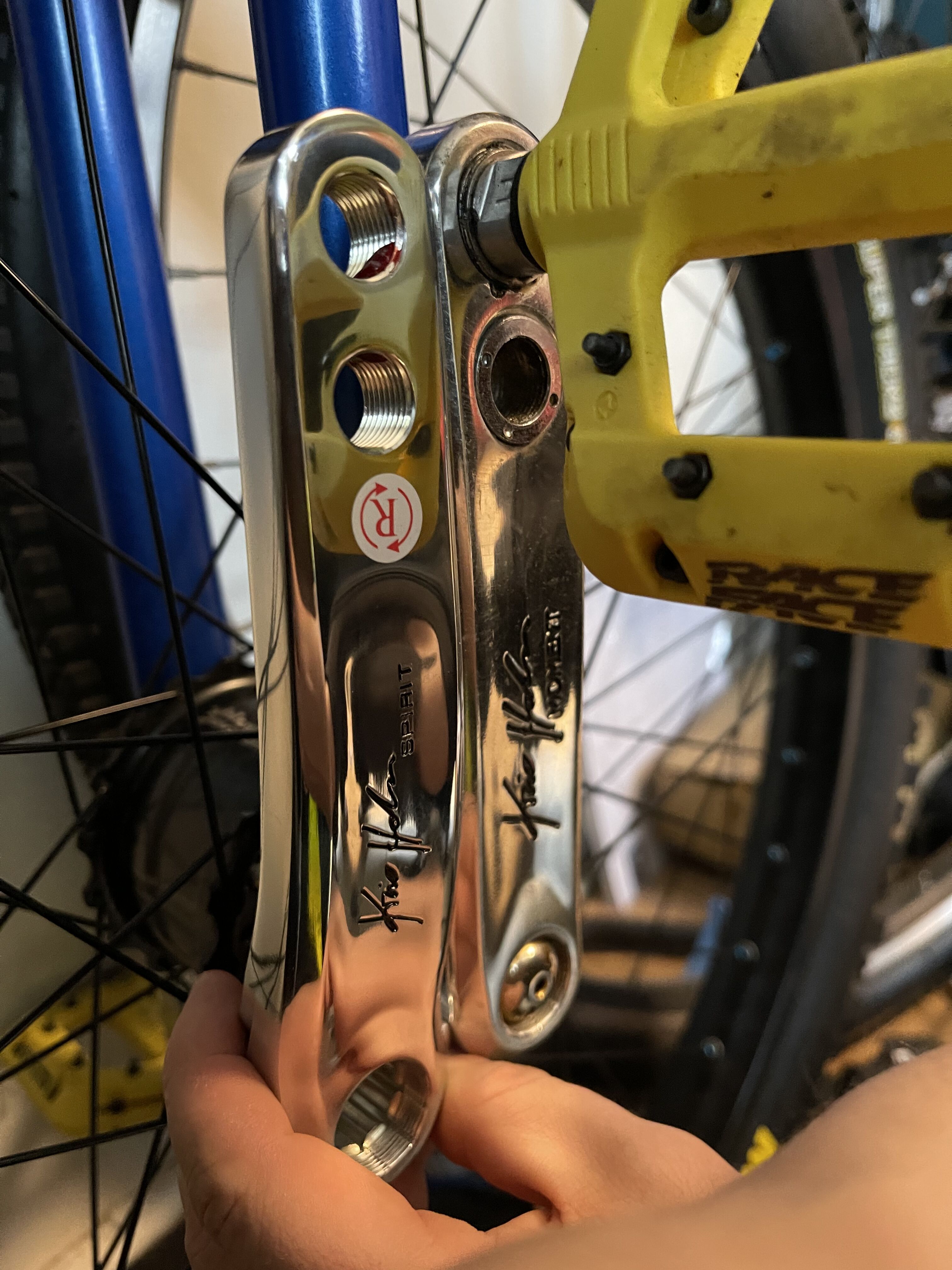

I think Moments could be easier as from what I can see the Q factor seems less and the angle is more in a line rather than with the swoop of the Spirits.
I think this could mean that accidental downshifts are more likely with Moments and that Spirits are where they (Kris and Florian) worked to make a crank that was good for shifting - when you want it, but not when you don’t.

Maybe they have Schlumpf in mind when designing it, but I think the Spirits cranks are designed like such so it makes clearance for the brake caliper. I definitely love the design, on my other (Nimbus) unis I occasionally hit the crank shoulders when pedaling, that’s a good UDP formula!

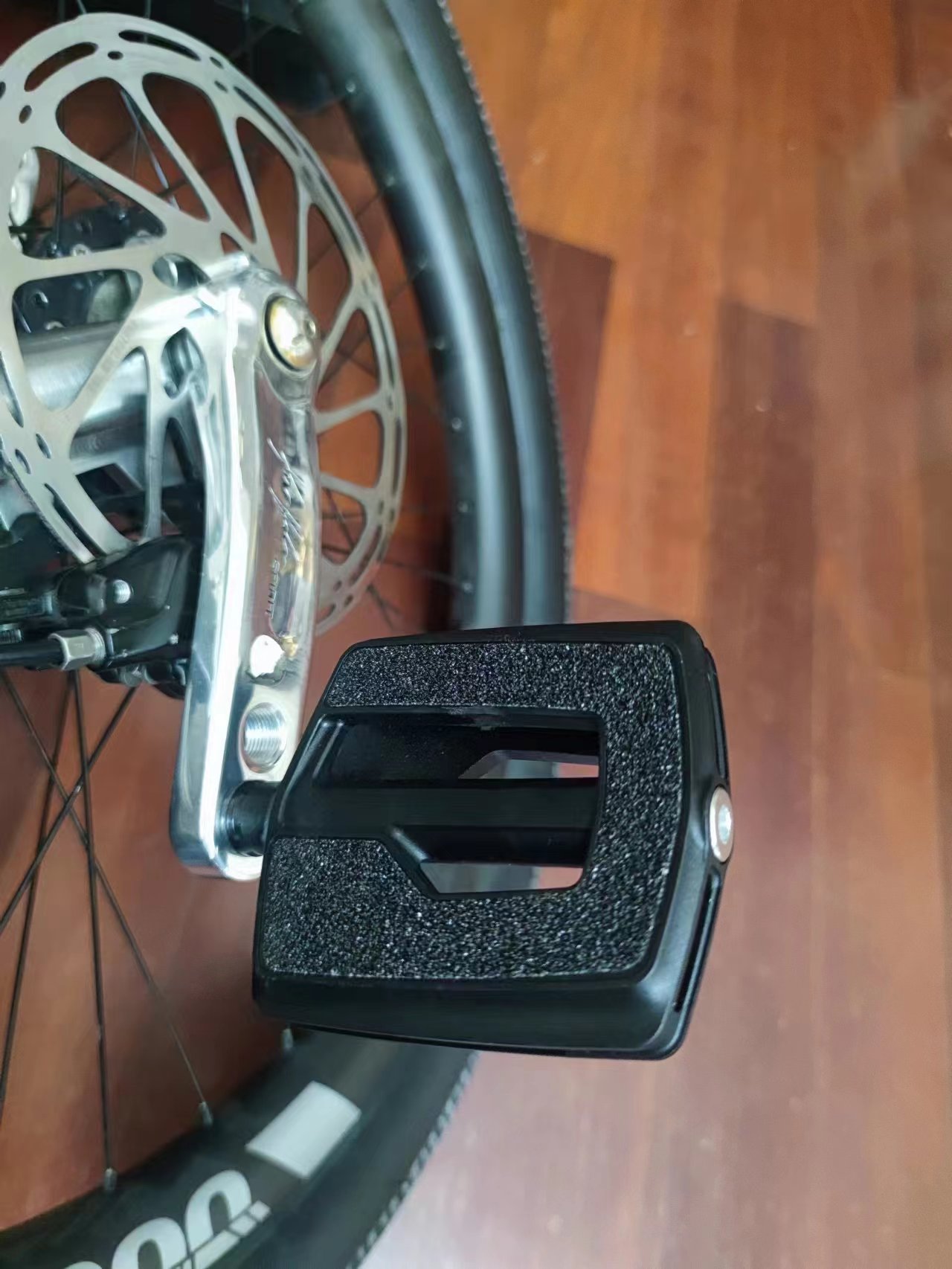

This pair of cheap pedals instantly become a game changer. Although they provide much less grip than those with pins, and I did slip one time or two when pedaling hard, I take it as the price because now I can reposition my feet at will, and the shifting is much easier.

Shoes with hard soles such as fiveten help a lot with gear shifting.
And it’s also harder to shift with a pedal that doesn’t grip well.
Several times I thought I had a problem with my hub, but it was the pedals that weren’t gripping.
I started this thread on non pinned pedals and info on some I have tried. It didn’t really get much attention but I think it can help any rider struggling with getting their feet situated after mounting. I like the grippy rubber aposed to sand paper. Good luck.
