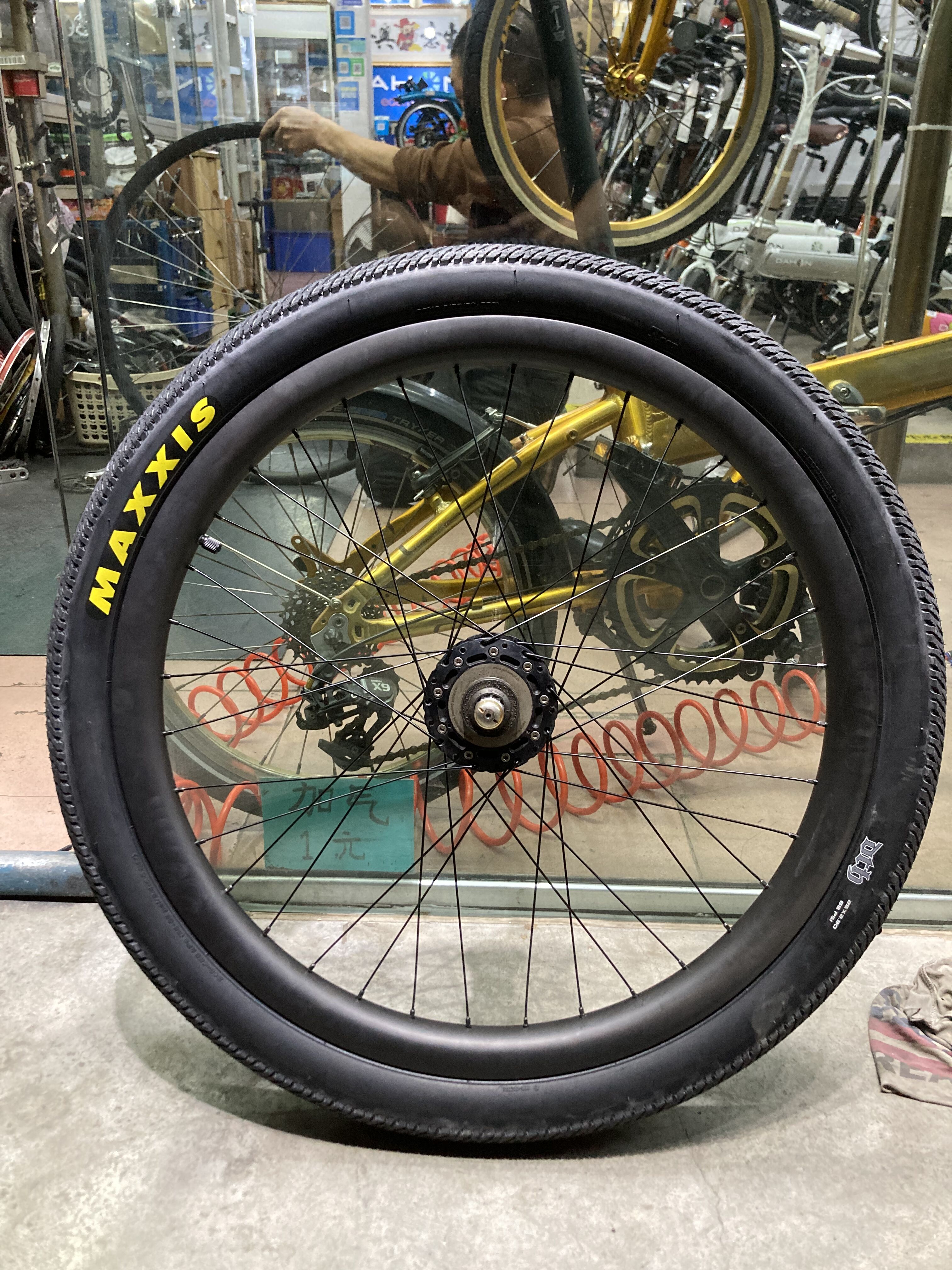

The wheel is built, can’t wait to ride on it!

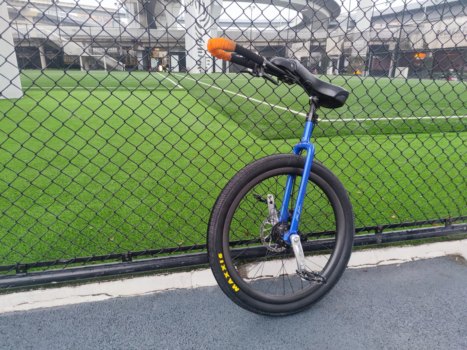

Here it is!
First ride today, the high gear feels pretty funky, still need (a lot of) time to get used to it.
Just a quick question, is it normal to have a slight click feeling at the hub with every rotation, no matter on low or high gear?
That looks rad.
My hub does that when I am pushing it along. After much listening and trying to work out what it actually is - I have decided I’m hearing the play in the cranks as they roll round and gravity tugs them down on each roll round.
When riding I don’t hear any click but the play (forwards and backwards) is 100% normal.
Only other thing to check click wise and I check pretty much every other ride - is that the shifting buttons aren’t too loose - and that they’re not too tightly wound into their spaces or too proud. You want each button to be slightly spongy/springy when that button is engaged in.
If tight I suspect it could cause some kind of click.
And re your new ride: wot Ryan said - very nice set up! :gear::star_struck:
