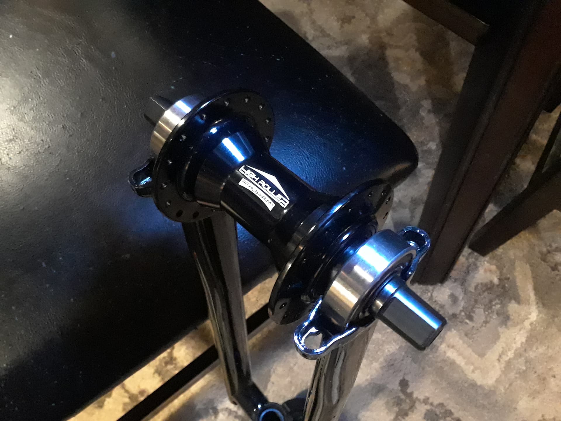

The High Roller hub came in today… And it fits like a glove!

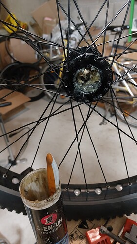

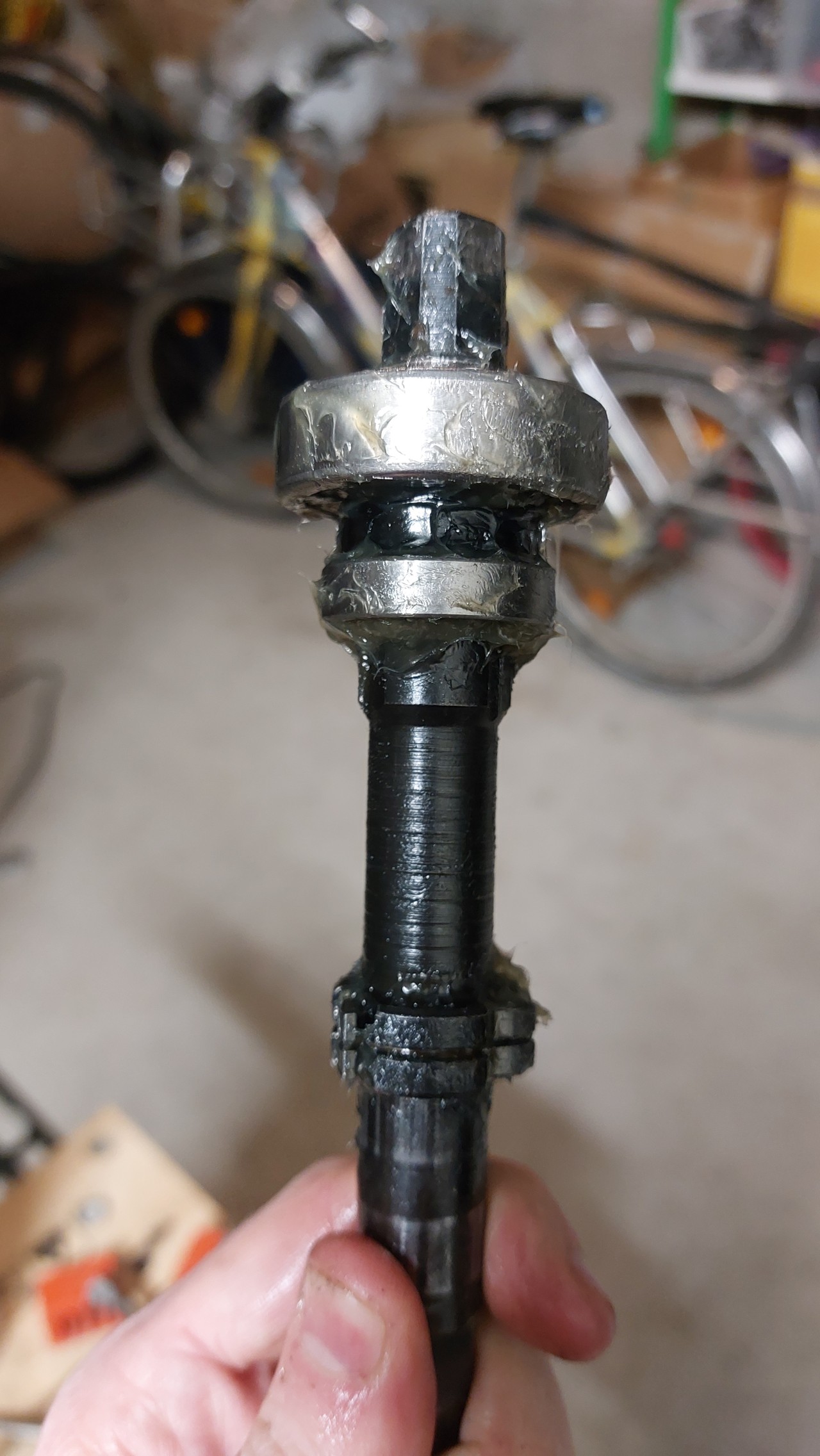

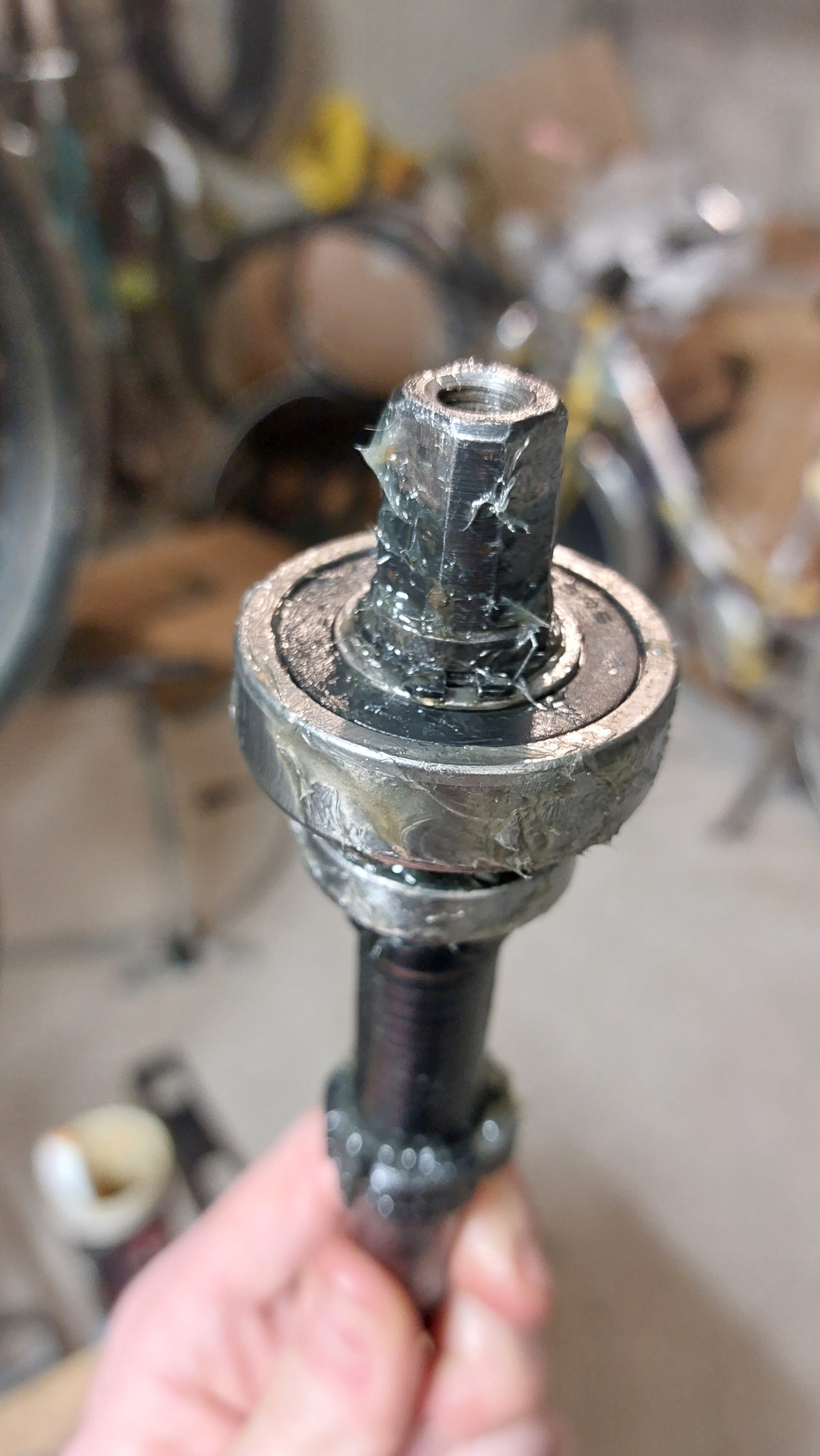

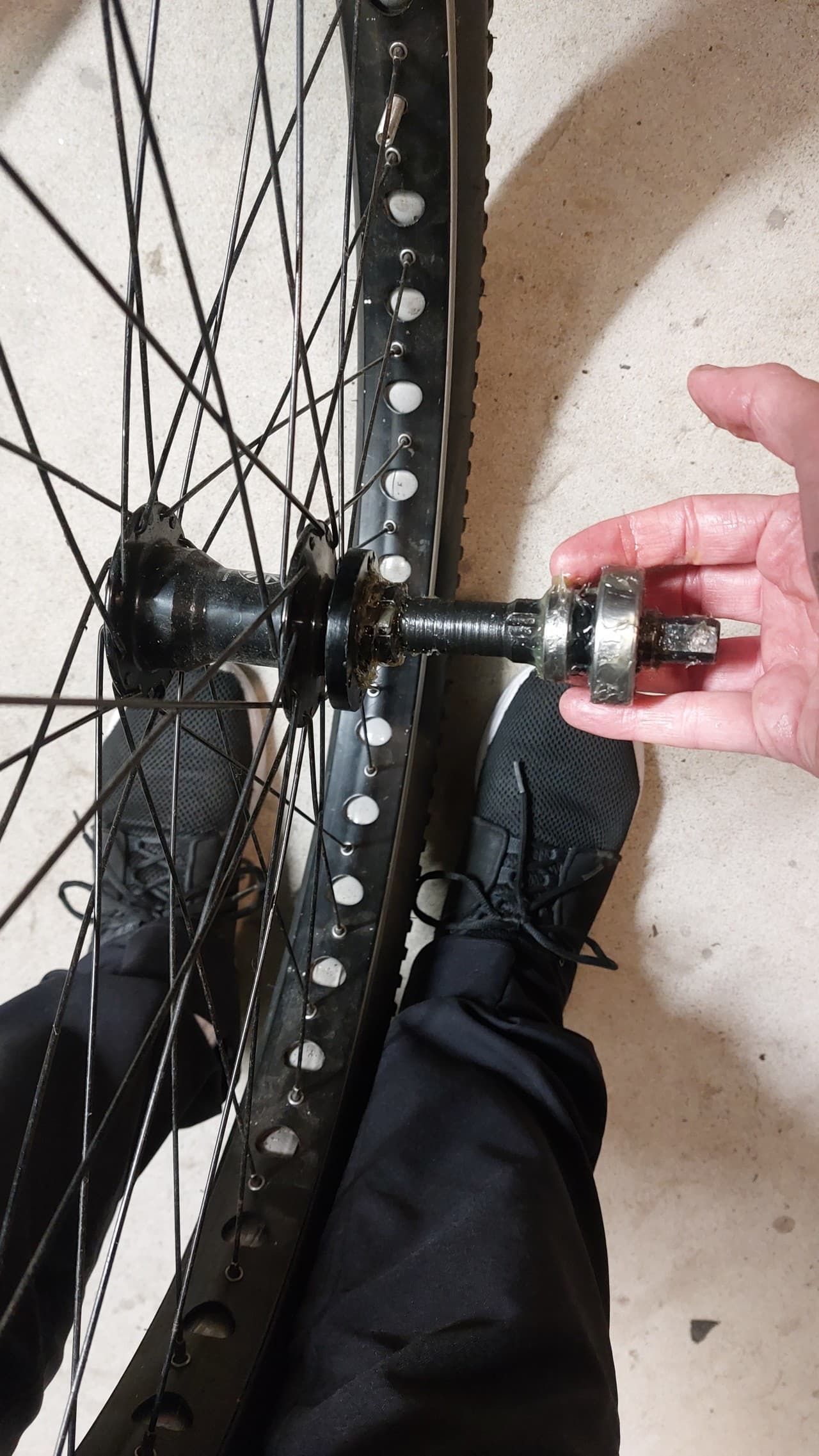

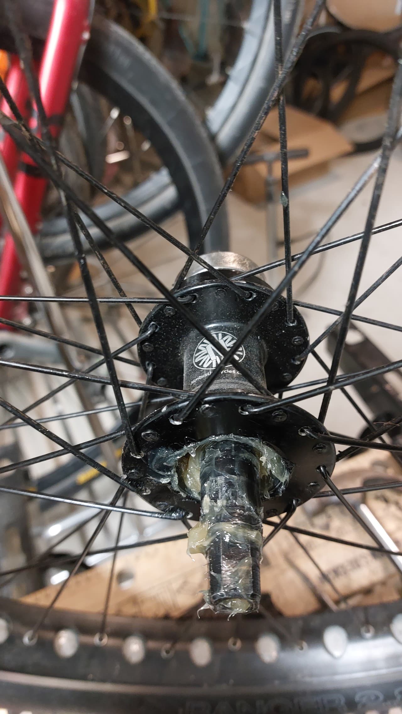

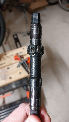

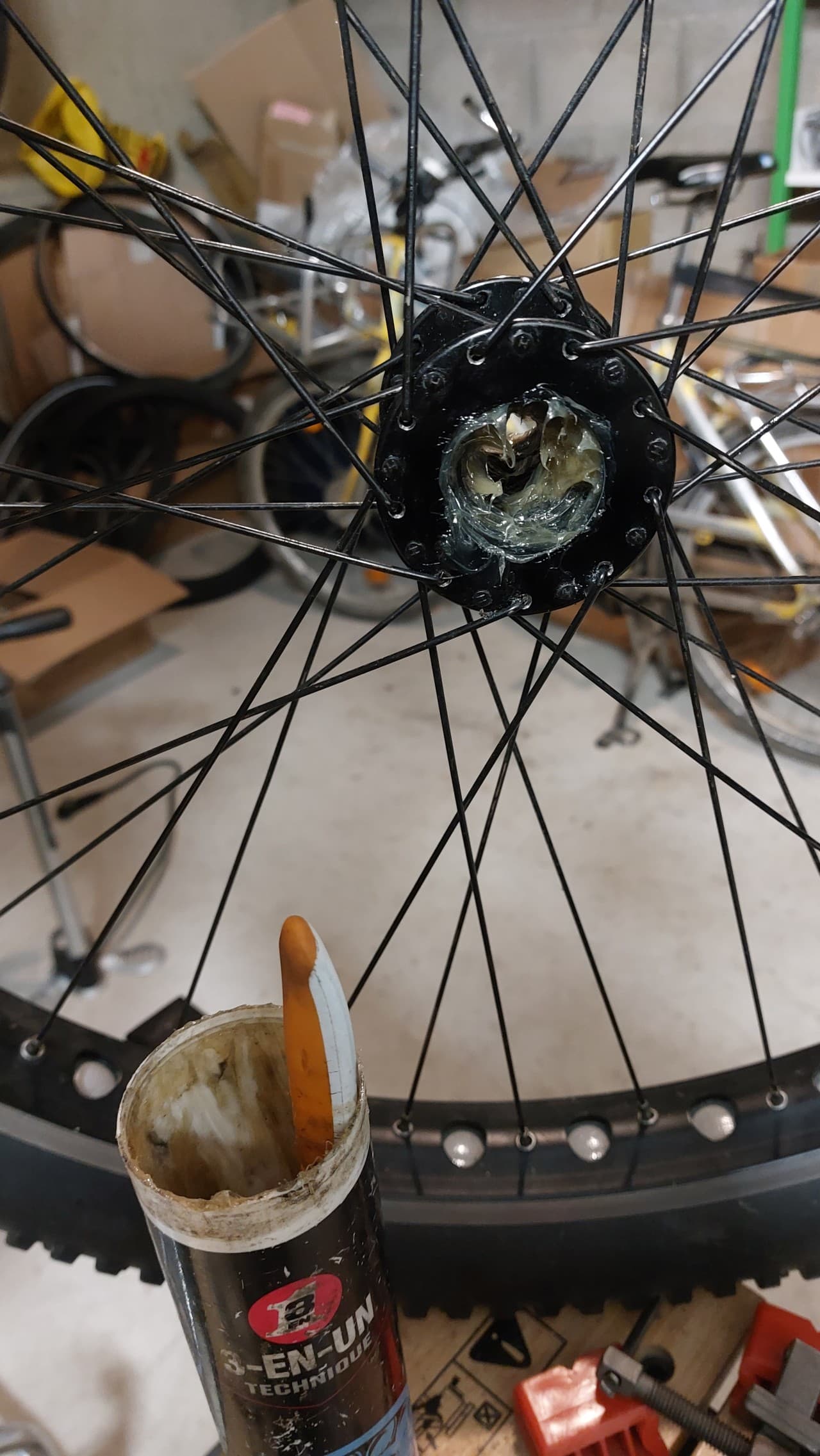

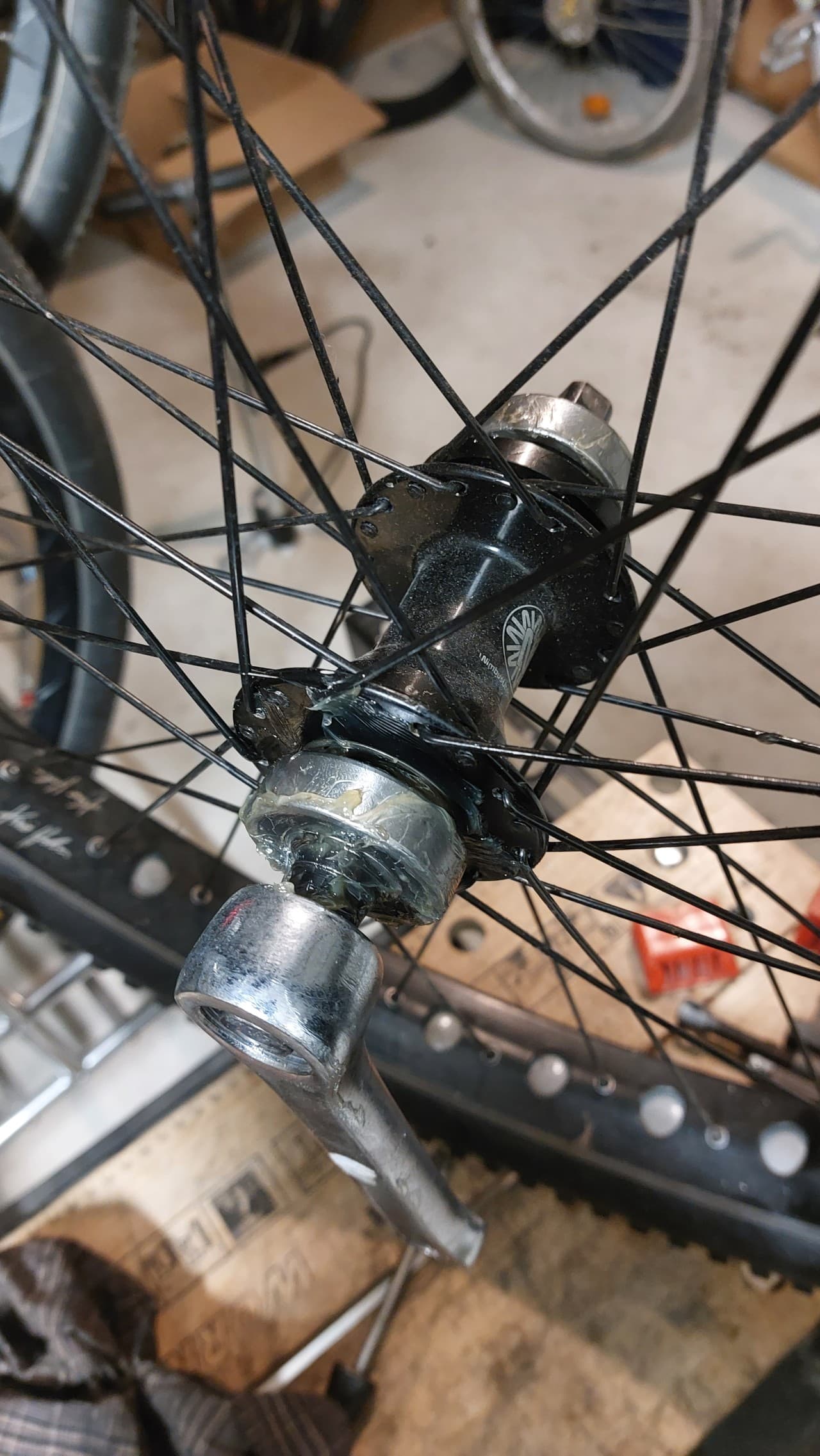

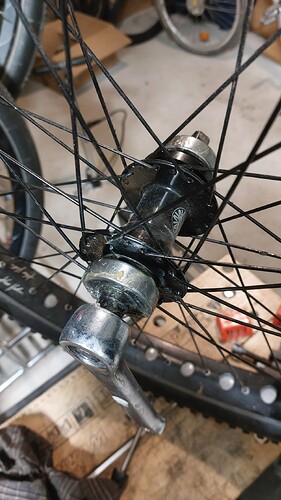

Okay! That’s it! I’ve changed the pawls, the spring and greased the hub thoroughly.
I proceeded according to the method I had been thinking about. I took step-by-step photos so that others could use them.
The tools you need :
- 22.2mm tube
- hammer
- bearing extractor
- circlip pliers
1/ I first disassembled the 4 bearings.
2/ It is absolutely necessary to remove the 2 inner bearings from the hub, otherwise it will not be possible to fit the pawls.
3/ I fitted the pawls, the spring and mounted the bearings on the axle opposite the pawls. I preferred to mount the outer bearing and the circlip to ensure that the inner bearing don’t move on the axle during assembly.
I didn’t go easy on the grease. In fact, I got it all over me, including my phone… but it makes assembly much easier, and it’s not bad for bearings, which don’t have an unlimited lifespan.
4/ Then comes the most important step: folding the pawls into place.
I tried to push them in by turning in the direction of the freewheel, but it didn’t work, so I simply used my fingers to fold them over and insert them from the opposite side, passing them through the hub.
5/ Once the pawls are folded, simply push by hand and finish by using the 22.2mm tube and hammer to insert the inner bearing into the hub. Of course, when installing the bearings, the other end of the axle must be placed on a hard surface. I put the axle on my workbench.
6/ I added more grease to the pawls, and then installed the pawl-side bearings and the crank.
To fit a disc, you have to remove the external bearing fitted at the start, but fitting it seems to me to make things much easier later on.
I can’t see any other way of doing it, but it’s great if others can do it differently. In any case, I’m very happy to have finally done it. ![]()
