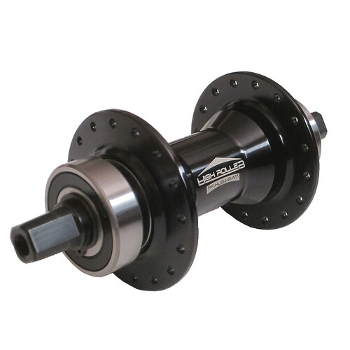

In the comments he also refers to high roller trikes. They seem to have hubs available to order at $129.99 USD. I don’t recall mention of these trikes and hubs on here. They have cartridge bearings on them and look pretty much like a unicycle hub (again I haven’t seen anything about spacing). So if you want to actually build something with a new, cheap, freewheel hub that might fit an existing frame, this might be a better option, or at least ask them what the spacing and bearing size is.

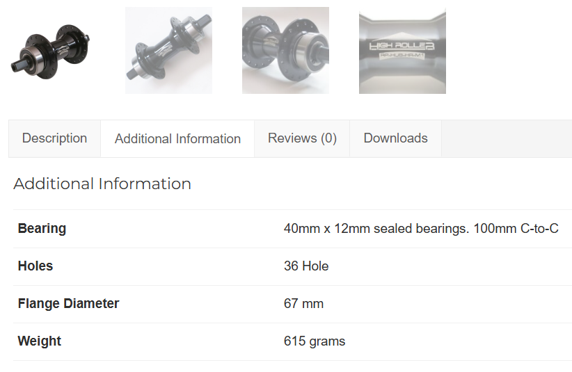

Well, well, well… :flushed: Assuming those are the actual specs (Apart from the spoke hole count… Says 32H at the top and 36H in the Additional Info tab), it might just about be an inexpensive plug-n-'play freewheel unicycle hub. The flange diameter is even pretty close to the 100mm UDC hub on my 26" Club :face_with_monocle: If there was an option for a 36H hub I wonder if it would be possible to swap hubs without needing new spokes… If I wanted to be cheap
I didn’t notice the 100mm centre-to-centre – that’s good. Some shims for the 40mm bearings and you should be done – you’d probably be best with a frame and rim that can take a rim brake, I don’t know if your Club frame has that, but nevertheless, it seems like something worth a try :slight_smile:
Problem not! I’ve had great success with my 3D printed rim brake mount. And my next iteration will be glorious.
Please tell me you are going to build a 16" freewheeled unicycle. :star_struck:
…wait. Does this mean I could simply put one of these 16" freewheeled wheels on my 16" unicycle with 40 mm bearing houses 100 mm apart and brakes already fitted, and have myself a freewheeled unicycle? :open_mouth:
That looks identical to the Nimbus brakeless freewheel hub so I’m sure it’ll be fine.
You’ll be able to do a direct swap into most wheels without changing the spokes.
I occasionally do the calculations for swapping hubs but very often it’s close enough so if they look similar by eye, I just go for it.
