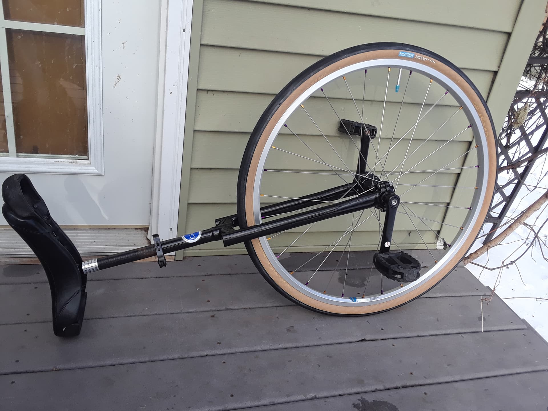

…And so a freewheel unicycle joins my collection of wheels and frames :face_with_monocle:
I had to steal some crank bolts and pedals off of another wheel lying around, though now I can say I have a complete-ish freewheel unicycle to learn on when the time comes around! :tada:
The complete specs as it stands now,
  • Club 26" frame, seatpost, saddle
  • Velocity Atlas 650b rim
  • Sapim Race spokes
  • High Roller Drift Trike Hub (No disc mount unfortunately)
  • Rene Herse Loup Loup Pass 650bx38 tire
  • Rene Herse TPU tube
Although I do plan on learning to ride without a brake installed, I do want to add a brake at some point in the future after I feel like I can graduate from riding on mostly flat ground. I’ve been thinking about it since before the rim was built, and part of the reason why I decided to opt for 650b is that I can move the rim closer to the top of the fork than a 26" rim (to hopefully widen the selection of potential rim brake options) but still have some tire volume compared to a 700c rim.
Off the top of my head, the two most attractive options for adding a brake are
  • Getting my hands on a Dia-Compe Clamp-On brake caliper and hoping it can fit. This would be my preferred solution since it doesn’t involve making any modifications to the frame, although I’m not 100% positive that it would fit. I did a quick measurement of the brake reach I would need and I think it might work… Hopefully.
  • The other option is drilling the fork and adding a side-pull brake that way. I know others have fitted brakes this way and has worked fine, but I’d like to avoid modifying the frame more than absolutely necessary
Anyways, I’m excited to give it a try when the weather lightens up a bit. :relieved:
