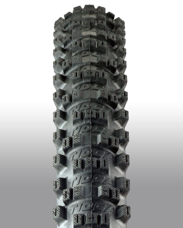

Well can I make a suggestion - why don’t we simple start or use this thread as a tyre review thread specifically for 26" muni tyres? I have recently bought 3 new tyres because as you say Eric, the bike reviews are only so helpful.Plus good tyres are expensive! So my suggestion is:
Tyre name: E.G. Tioga white Tiger
Profile: see attached picture
Cost: NZ$80 from LBS
Size: 26" x 2.5
Weight: 1300g - folding bead (also available in wire bead)
Specs: Non directional, slow rebound rubber, slits cut into knobs to improve traction.
Conditions ridden in: Gravel and loose rock, mud, pine needled forest, sand, road, limestone
Opinion: I like this tyre very much as it is light but still gives amazing traction. Not exceptionally good in hardcore mud as the profile is not very aggressive. Corners well in dry conditions and even on the road. Very fast in dry conditions. Handles gravel and rock no problem.Perfect for XC racing.
Overall rating: 4/5

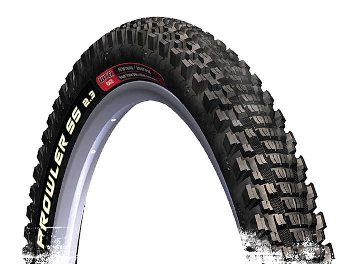

So, I looked for a compromise and got a good deal on a WTB prowler race 2.3 folding. It was cheap (£10 delivered) & light (much lighter than the Hookworm or Wildlife and smaller inner tube saved even more weight). So far, as a compromise it works really off road and is good on tarmac. The lighter weight means that I can happily do most trails with the shorter cranks.
Tyre name: WTB Prowler race
Cost: £10 - delivered
Size: 26" x 2.3
Weight: 835g - folding bead
