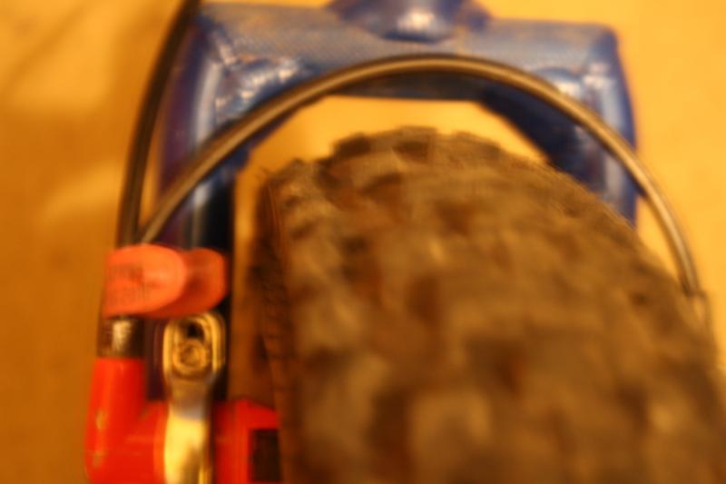

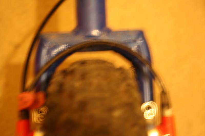

I un-accuratly measured my:
Nokian Gazzaloddi 24x3.0 to be ~2.9’’ (only like 10km of use so far).
This was a pritty in-accurate measure though. Its on a Nimbus muni rim (which is either 40mm or 42mm, I have read these different widths from UDC). It fits in my KH frame fine with about 4mm clearance on the sides.
Sorry about the blurry pics.
