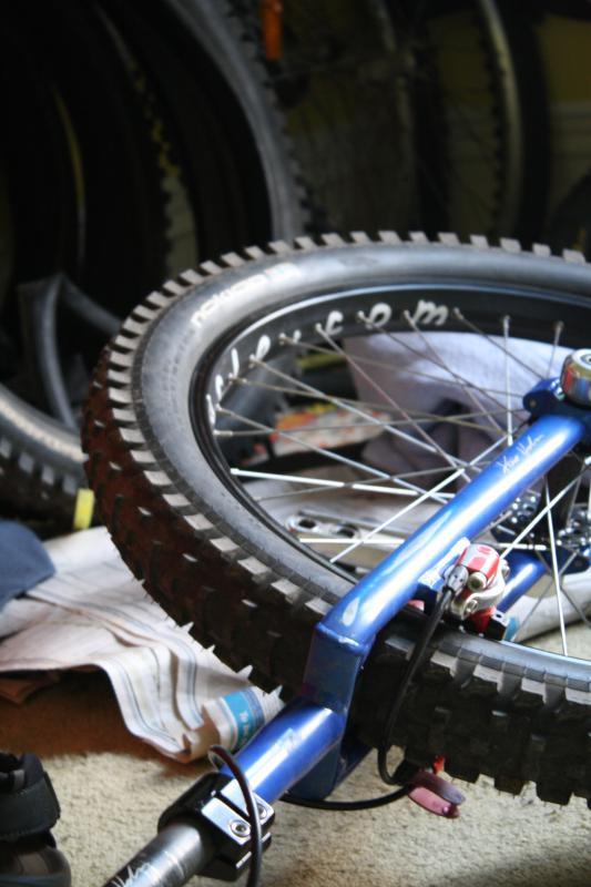

I have built up a collection of tires here and inspired by a thread in the fat bike forum I decided to mount, inflate and measure them all. It could help us all if you did the same and also post your results so we know the true widths of tires on the wider rims we use for unicycling.
Please indicate the width of rim you are measuring on as well as the amount of use the tire has had as they tend to stretch over time.
measurements are casing/tread or casing only if it is the widest part of the tire.
Schwalbe Racing Ralph 2.4 (new) = 2.48
Intense System 29 (new) = 2.36
WTB Prowler SL (50km use) = 2.32
