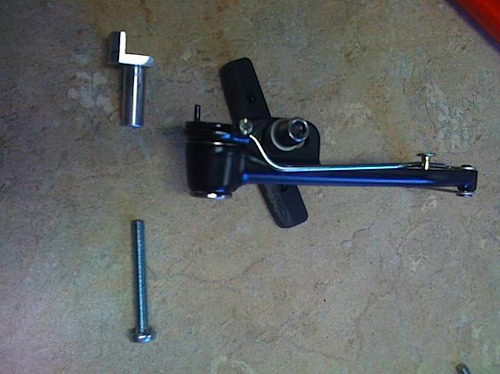

I’ve been trolling around on the Observed Trials forum for a while, and someone put up a way to mount a brake directly to the Magura bosses. I went to the hardware store and about $4.00 later I had everything I needed to put my v-brakes onto my Nightrider.
Here are some pix but the idea is to get 30mm bolts that thread into the existing mounts. I put aluminum spacers in to take up the space between the bolt and the brass bushing in the caliper, and I made a plate that holds the spring out of some aluminum angle I had laying around. For more pix go to my gallery.

What use does the aluminum angel piece serve? Is there a spacing problem?
My V-Brakes have a small pin that keeps tension on the return springs. That pin needs to be held in a static position in order to work, and that is what the angle does (the little hole is where the pin goes). I know that there are brakes that don’t have a pin, and would work without the plate, but I would probably use a washer anyway just so that there is a clean surface for the spring mechanism to sit against.

Question: does the aluminum bracket rub against the side of your frame, and have you put any buffer in between to avoid scratching the paint? Also, would this work to support the spring if you just used a flat piece of aluminum or a washer with an extra little hole, rather than the L bracket?
the angle does touch the frame, and it wouldn’t be a bad idea to pad it with a little bit of old inner tube or something. It really doesn’t move once it’s all tightened down though so not rubbing.
A flat washer may work if you can tighten the bolt enough so that it doesn’t move. Some v brakes have an adjustable nut that the spring attaches to, and doesn’t require the hole for the pin. In that case you certainly wouldn’t need more than a washer.

tholub, are you indicating there is a benefit of the commercial adapters over jtrops’ hardware store solution? The simplicity - and cheapness - of jtrops’ idea is quite attractive to me.
The one advantage of the commercial setup is that you’re using both frame bolts, which will increase the stiffness of the braking system. Using just one bolt, the aluminum adapter will tend to want to rotate/flex with braking forces. But it probably works well enough for our needs; our braking forces are pretty minor, it’s not like we’re trying to stop a downhill bike.
That’s exactly what I was thinking. I found the original beta on the observedtrials.net forum, and someone was using this basic setup for a trials rear brake with a booster. I think in that capacity you would want a much more solid connection, but for a uni it seems to work fine.
