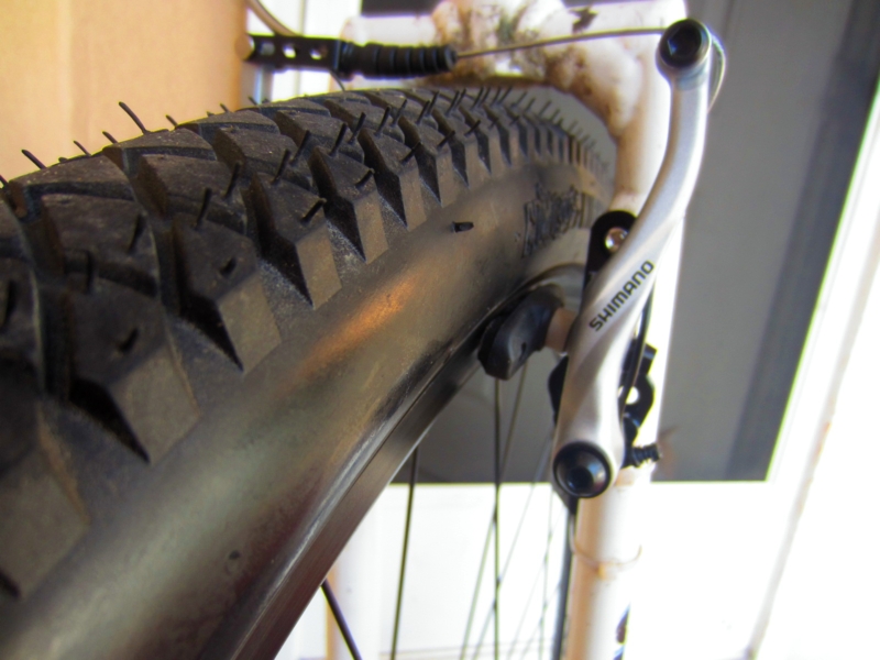

    Here’s my setup. Used the Onza adapters that fit on the magura brake bosses, allowing you to run the V-brakes. They have plenty of braking power, are a fraction of the cost of Maggies ($19.95 for Shimano V-brake!) and set up and adjustment is FAR easier and faster than dealing with hydraulics.
    No bleeding, no leaks, and customizing or changing cable length is a piece of cake. Also MUCH easier and faster to remove wheel by simply disengaging brake cable. You can also run the brake pads farther from the rim than maggies, and not lose any stopping power. This also prevents the pads from rubbing on the rim if it’s less than true.
    Nice brake. Were you having problems with the Magura pads touching the rim with wheel/frame flex?
    How is the knee clearance with the V brakes compared to the hydraulics?
    No knee clearance issue. And I got these because I didn’t have any extra maggies to use on the 36er. But these V-brakes are so much easier and practical than maggies in every respect, not the least of which is the ability to adjust the pads in/out/up/down and any angle for optimum performance. And because they don’t need to be so close to the rim like maggies, any wheel/frame flex will not cause unintended pad contact with the rim. Oh, and at just $19.95, they are much, MUCH less $$ than maggies rim/disc brakes!

    Will Shimano V brakes on the Onza adapters work on my Nimbus 26" muni w/3" wide tire? I too am looking for a less costly option.
    Yeah that’s the setup I have and it works fine. The Shimano brakes are pretty good.
    Forgot to mention that I got my brakes second hand too and they still work fine so if you get them new then that should be even better.
