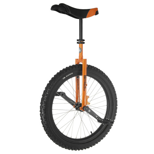

The Nimbus frames that are steel (the Muni and road range) have a billet bearings housings (sometimes called a machined bearing housings), not pressed ones. So there is absolutely no problem in fitting the d’brake to them. In fact this was the main market for this product.

Correct me if i’m wrong but i see three configurations.. the club version with stamped housings, a machined version with no brake mount and the MUni version with brake mount
The Nimbus II is not a MUni or Road unicycle, they are freestyle… but they also make great universal unicycles which is why I guess you are looking at it. It is unlikely they will ever have a brake mount fitted on to them as standard.
The d’brake should work well on it. Especially the latest version which comes with an antivibration bar as standard.
https://www.unicycle.co.uk/d-brake-disc-mount.html
This is the frame i am hoping to buy. If not this one then i will get the version without disc mount and use the d-brake
I will be using it to complete my 24” freewheel
Ah, that one… they just don’t have the latest one. Next production run it will have the mounts on it. :slight_smile:
