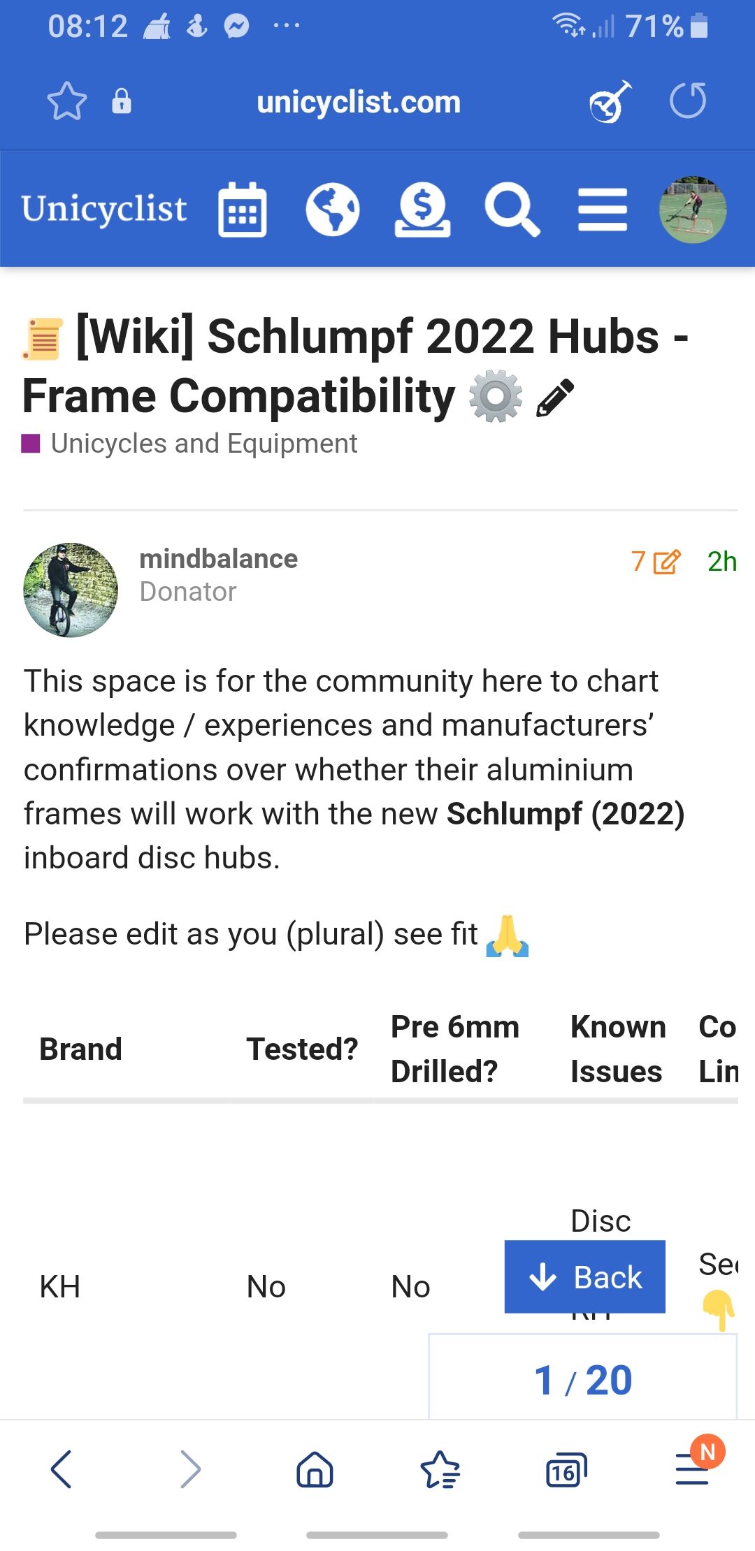

This space is for the community here to chart knowledge / experiences and manufacturers’ confirmations over whether their frames will work with the new Schlumpf (2022) inboard disc hubs.
Please edit as you (plural) see fit :folded_hands:

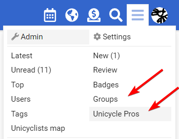

If you want to notify the whole group, use @Unicycle_Business
If you want the list of users from this group: Unicycle business - Unicyclist.com
Ah I was hunting for a group tag. Thanks for clearly that one up.
Everyone has already been tagged right?
Not sure how you view a group tag container :thinking:
Edit. You’ve updated to show me how. Thanks
No, I set the tag between backticks to prevent that, but you can tag them by yourself. :slight_smile: (note that it doesn’t work if you tag them in a post edit, I think)
