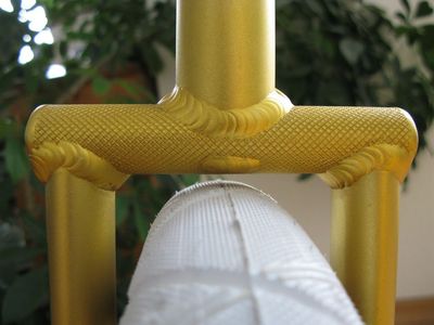

I just got notice that apparently the Eclipse frame is NOT compatible with 2.1" freestyle tires.
That is very disappointing. ![]()
@Roger: Can you comment on that? Is this a manufacturing error or an oversight in the frame specifications? Or do you not care? That would surprise me, because many freestyle riders like the larger tires.
It blows my mind that someone would put so much effort into creating such a great freestyle unicycle, and then fail at such a basic detail. For me this renders the frame almost useless. The difference to a 1.95" tire isn’t that dramatic but certainly noticeable, and I simply hate the idea of spending money on a “downgrade”.
The frame is designed to fitting the 1.95 tyre with a 10mm clearance, this should gives 4mm clearance with the 2.1 tyres on the same rim.
The problem is that both the rim and the tyre batch changes the tyre width and height. The frame was tested with the Nimbus rim and Primo Wall 2.1 and it fits. What combination of tyre and rim are you having problems with?
Roger
Thanks for the quick reply, your answer gives me hope. ![]()
I didn’t test it personally, but Roland tried it today. I’ll ask him about the combination.
Personally I now prefer the Gusset Pimp over the Primo. When I switched from the Primo to the Gusset I didn’t notice any change in frame clearance, so I hope the Gusset would work with the Nimbus rim as well. In my current wheelset, I have the Sun BFG rim.

To follow up on my earlier post: Roland tried it with the new Nimbus wheelset and the Gusset tire (at 5.5 bar, which is a pretty reasonable value for freestyle, I usually ride at 5.0 bar).
So it could be the difference between the Primo and Gusset tires or some variations in the frames. Maybe Roger can sheed some more light on this?
I’ve put my purchase on hold ![]()
@Roger: Any updates on the tire issue? It would be really nice to know which tires the frame is compatible with.

I finally got the Eclipse.
The frame is really nice. It’s comforatable to stand on, and the reinforced construction of the crown seems very trustworthy. It also looks great.
Due to the clearance issue I went with the 1.95" Kenda Karumba tire. It’s to early for a verdict, but the reduction in size compared to a 2.1" tire is noticeable. I’ll probably get used to it, but I’d still prefer the bigger one. Clearance with this tire is excellent (see picture). My older frame has about the same clearance with the 2.1" Gusset Pimp, and that frame is about 5mm higher.
The cranks look nice and beefy (my previous Japanese Al cranks were thinner and got slightly bent). They are also great to stand on. Now I’m curious how robust the wheelset will turn out.
If no robustness issues show up over time then this is in my opinion the best freestyle unicycle on the market. The reduced weight makes it wonderful to ride. Excellent work ![]()
