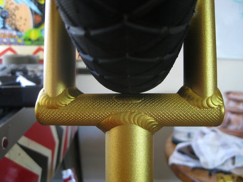

Thanks for the picture of the crown. I was disappointed there wasn’t a better shot of it available on the websites.

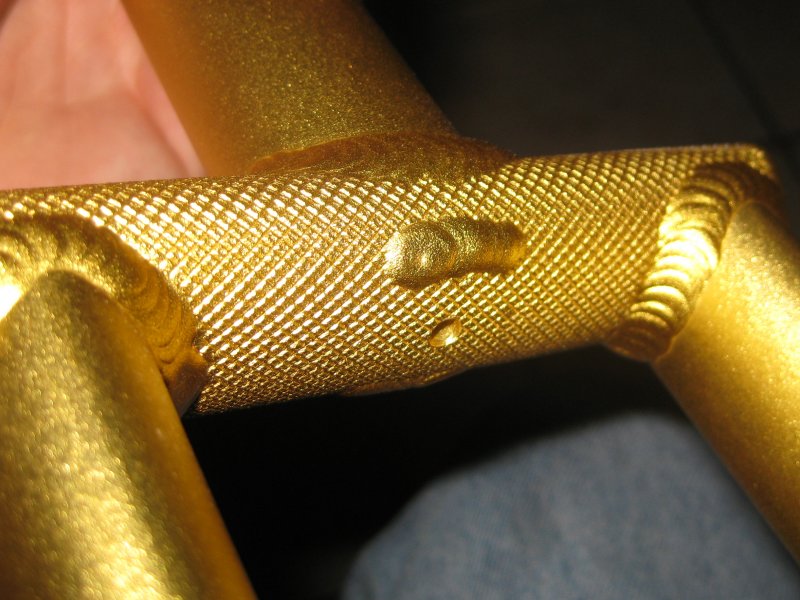

Thanks for posting the frame picture, Niko!
From pictures on the UDC it looked like the seatpost tube dropped all the way through the crown and was welded on the bottom as well as the top, but after you posted that picture it doesn’t look like it goes all the way through. Does anyone know how the crown is constructed? Is the seatpost tube just welded to the top of the crown? What’s the bead on the bottom for?
My previous freestyle unicycle also had a narrow hub, so I can’t directly compare it (and my trials uni is too different). But I’d say that it’s an advantage, just one more nice little detail.
It looks like the seatpost tube indeed drops through the crown and ends at the lower welds. These smaller welds are present on both sides. I think I also saw an inner reinforcement tube in the frame section (maybe only the reinforcement tube sticks through?).

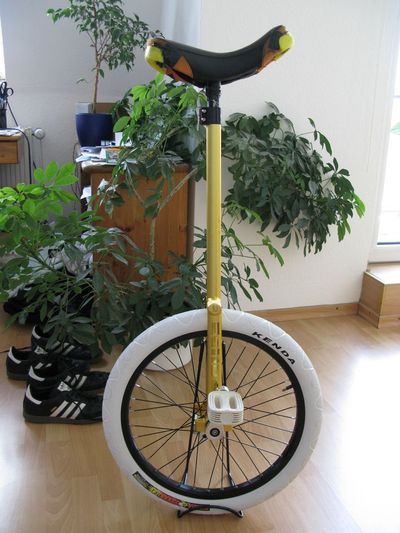

niko can you please post a pic of the full uni please?
thanks

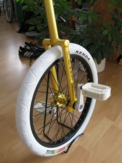

Sure, here it is. There are some component changes compared to the standard Eclipse:
  • my old seat with a unicycle.com CF basis, KH foam and cover, and Qu-ax bumpers
  • KH reinforced seatpost
  • 89mm cranks (instead of the standard 100mm)
  • Kenda Karumba tire
  • Miyata freestyle pedals
Note that there are also pictures available at municycle.com (and here).
