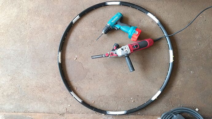

The rim was self-made of two 28" rims here: Build your own rim

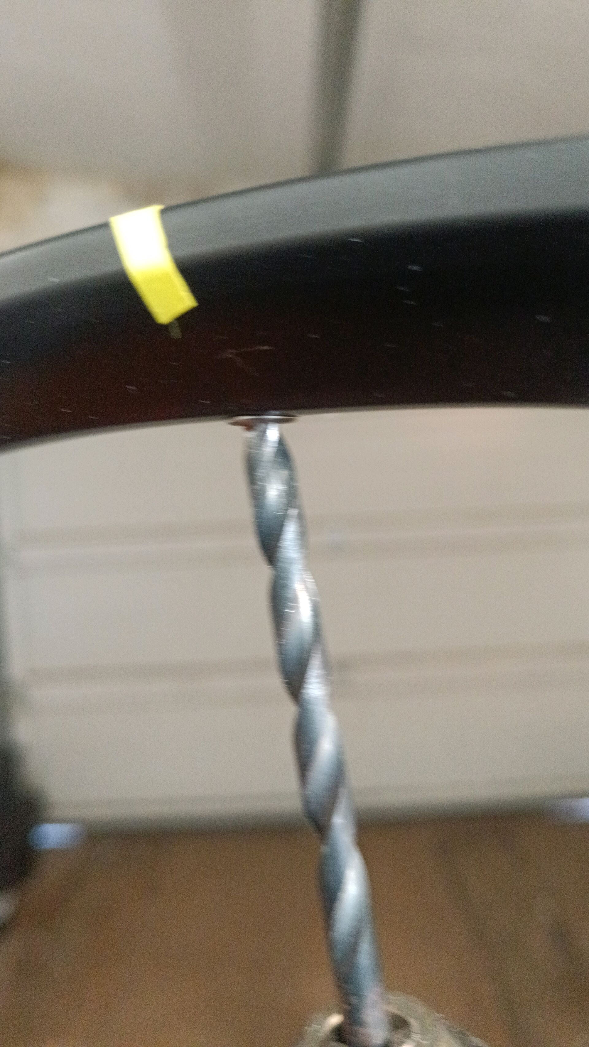

Crossing out a 36" DT swiss 533D rim, what creates a UW=Useless Wheel. I have to destroy a perfect and new rim…:
Drilling out some eyelets which would interfear with the profiles:

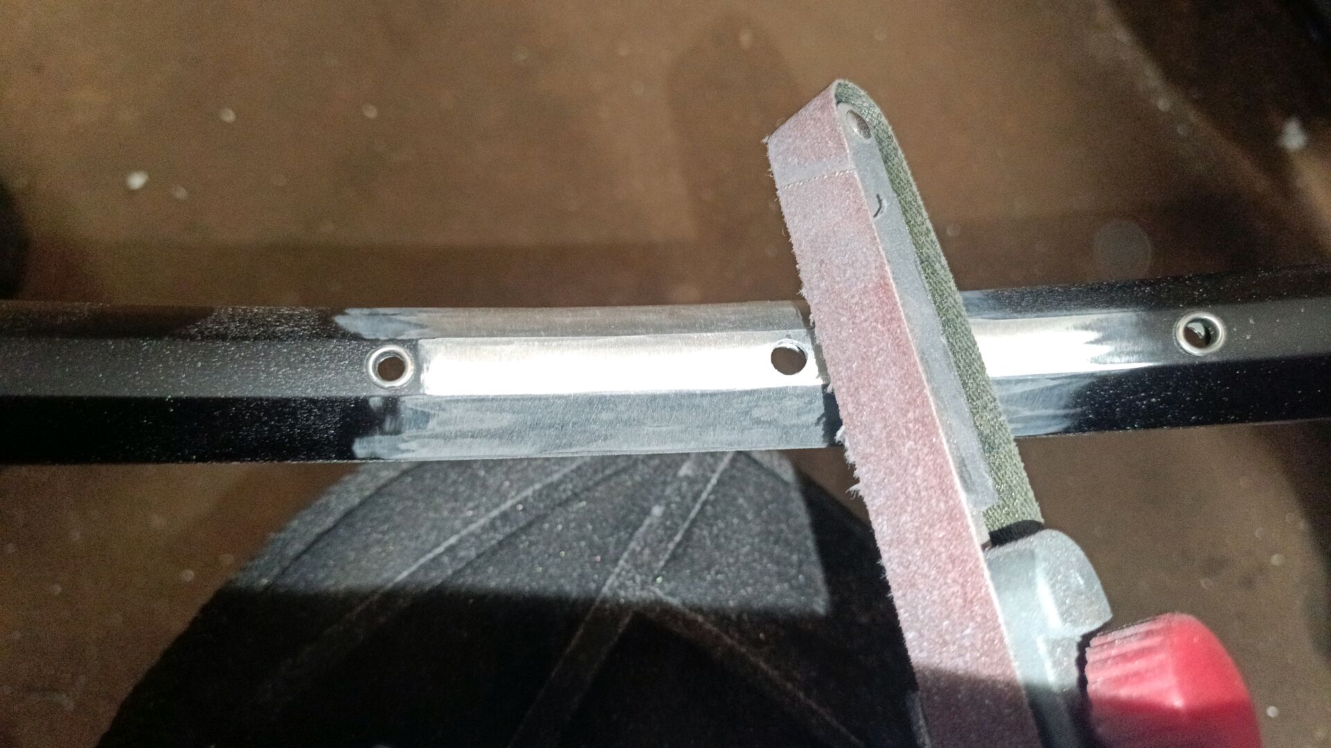

Preparing the aluminium rim for welding hopefully without removing too much material:

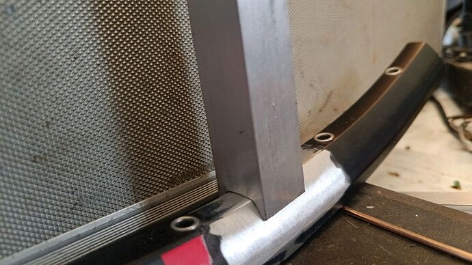

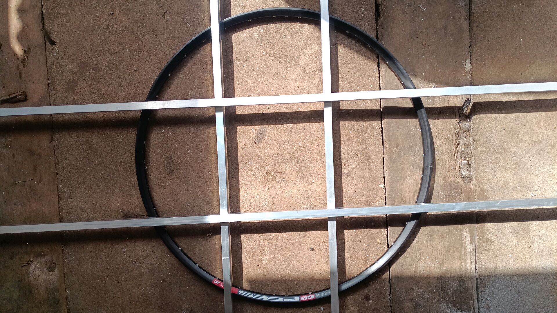

Fitting the profiles to the rim:

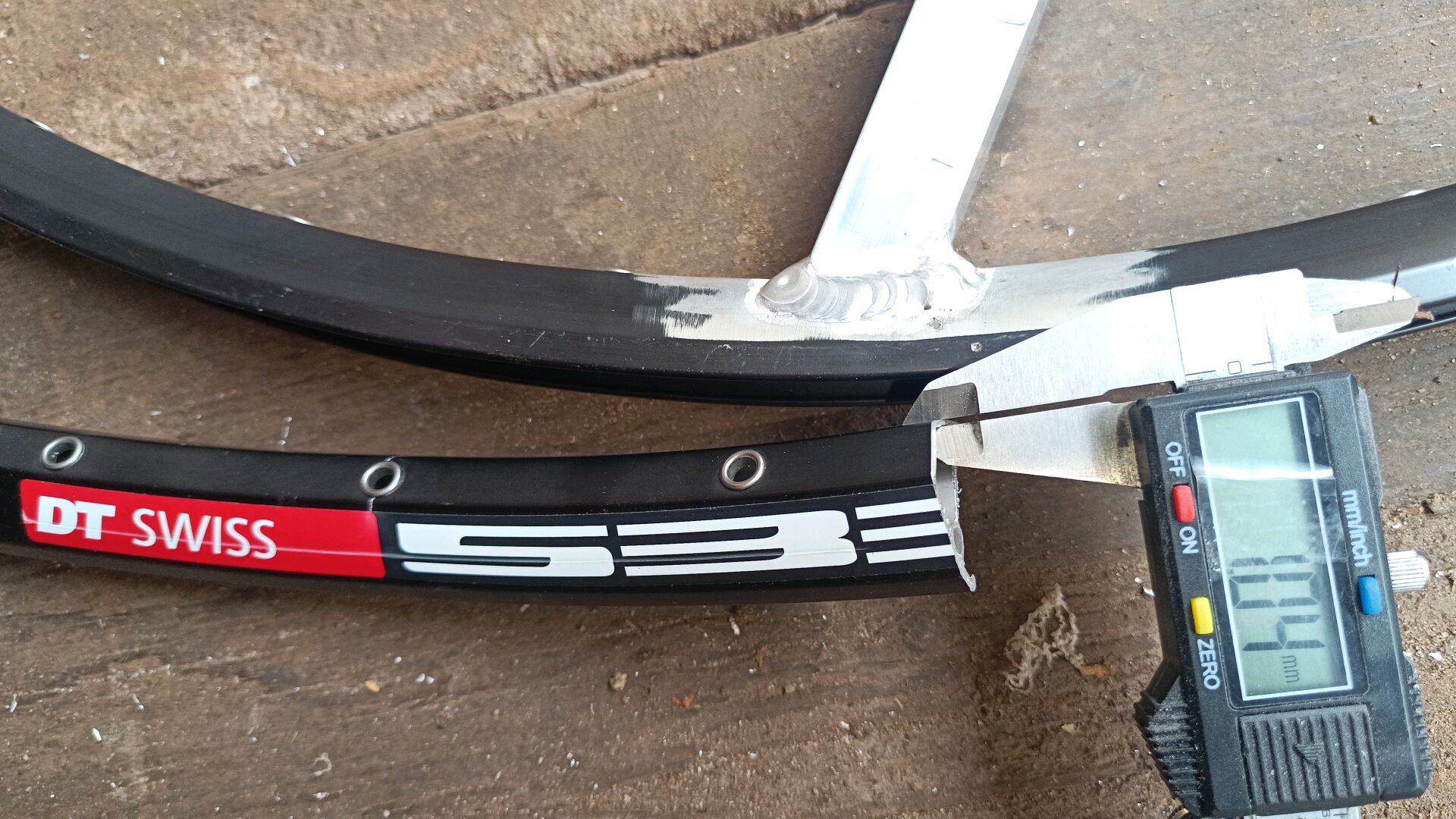

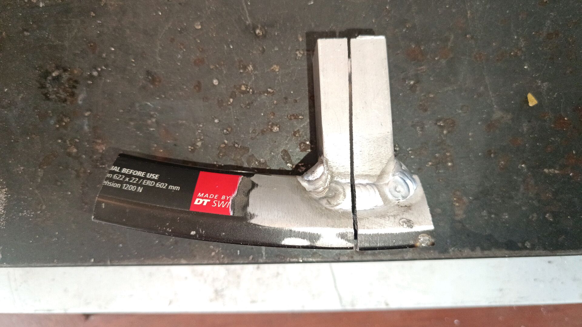

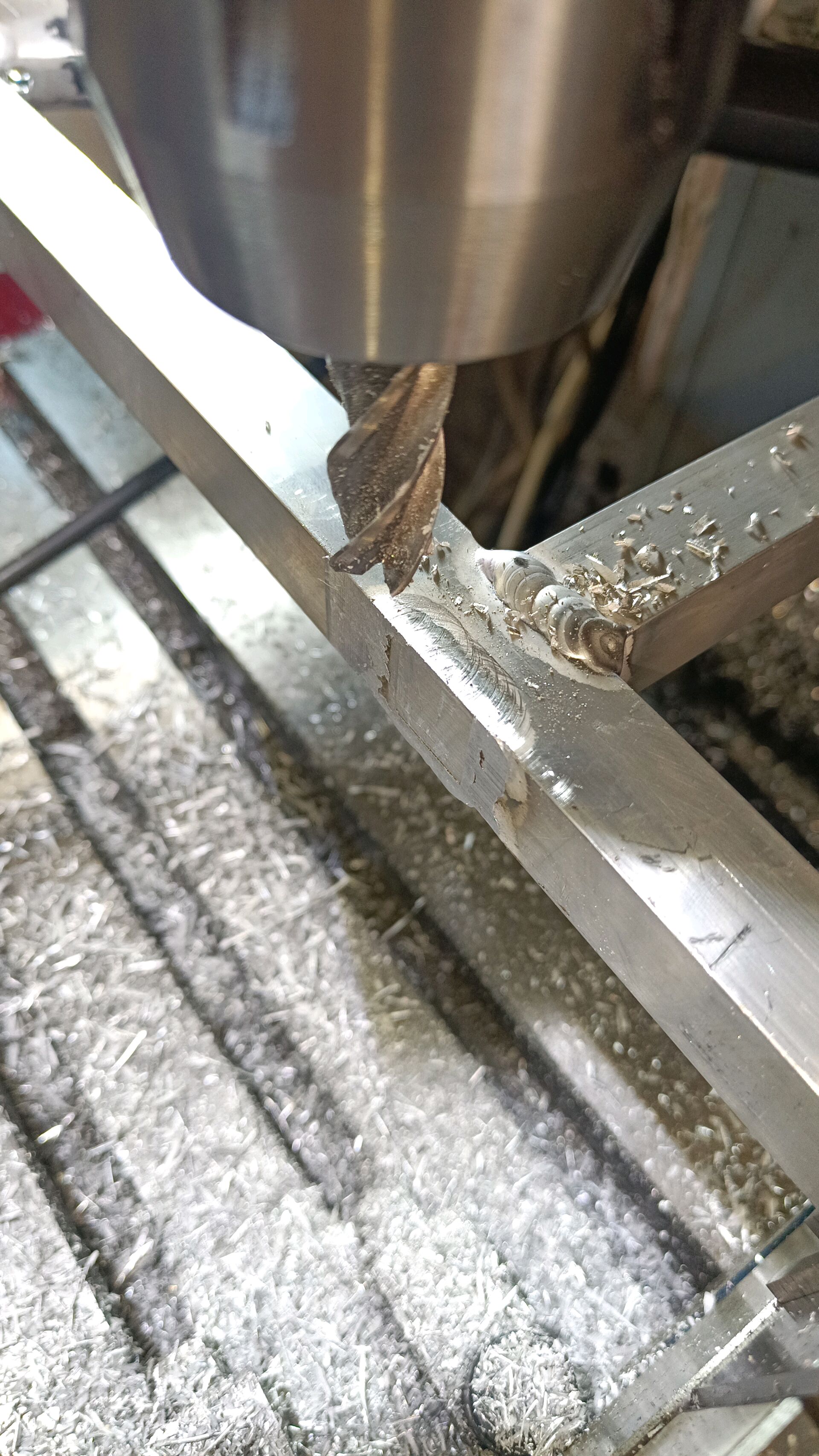

Test weld:

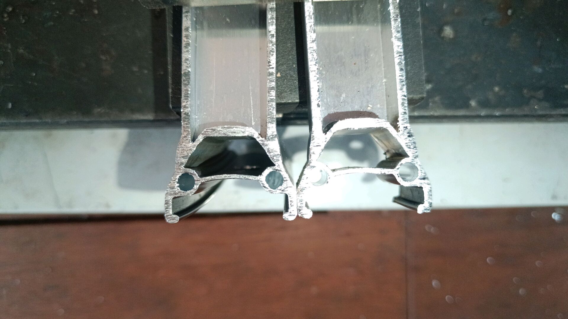

Cross section:

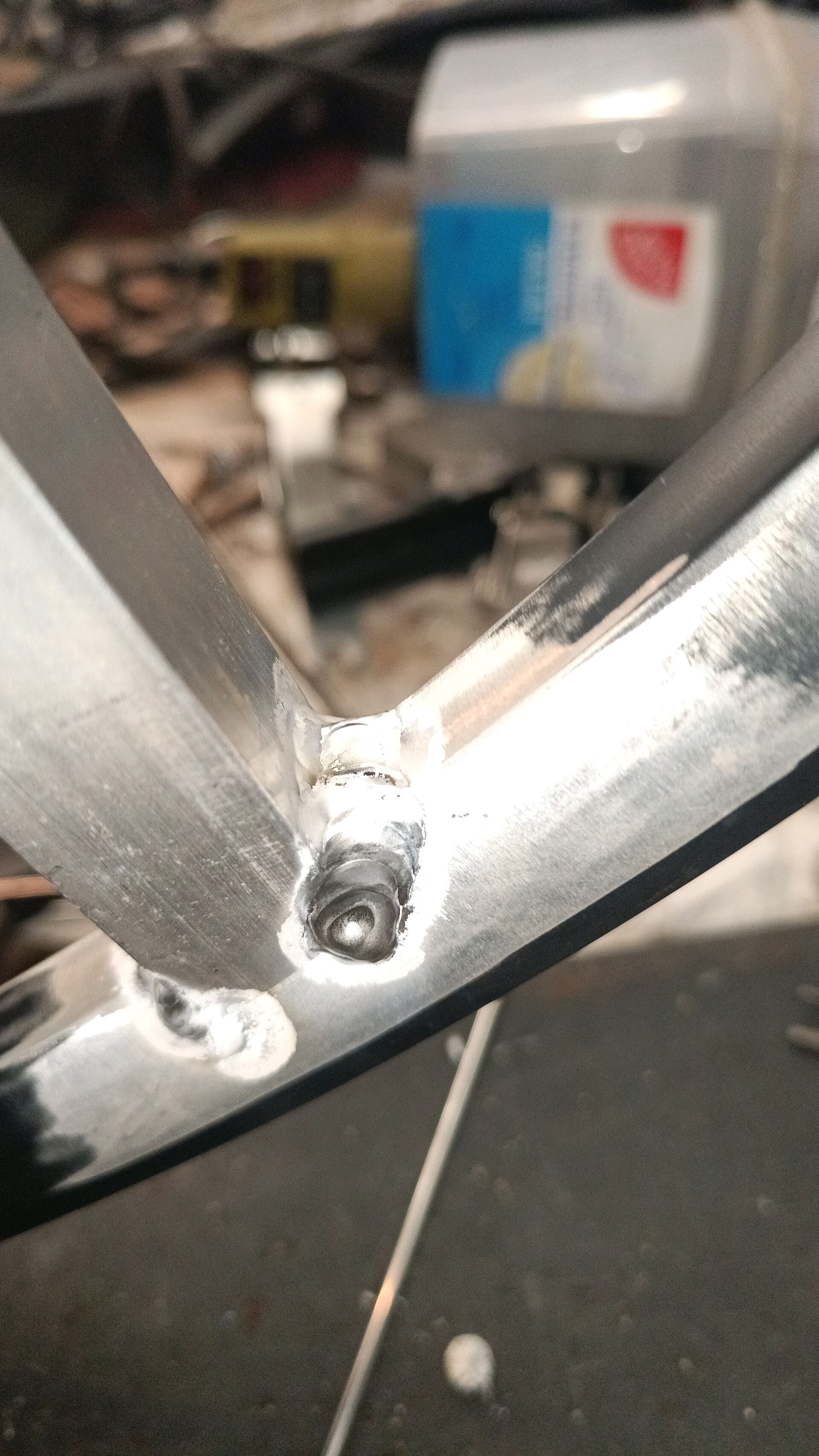

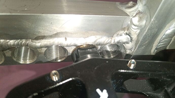

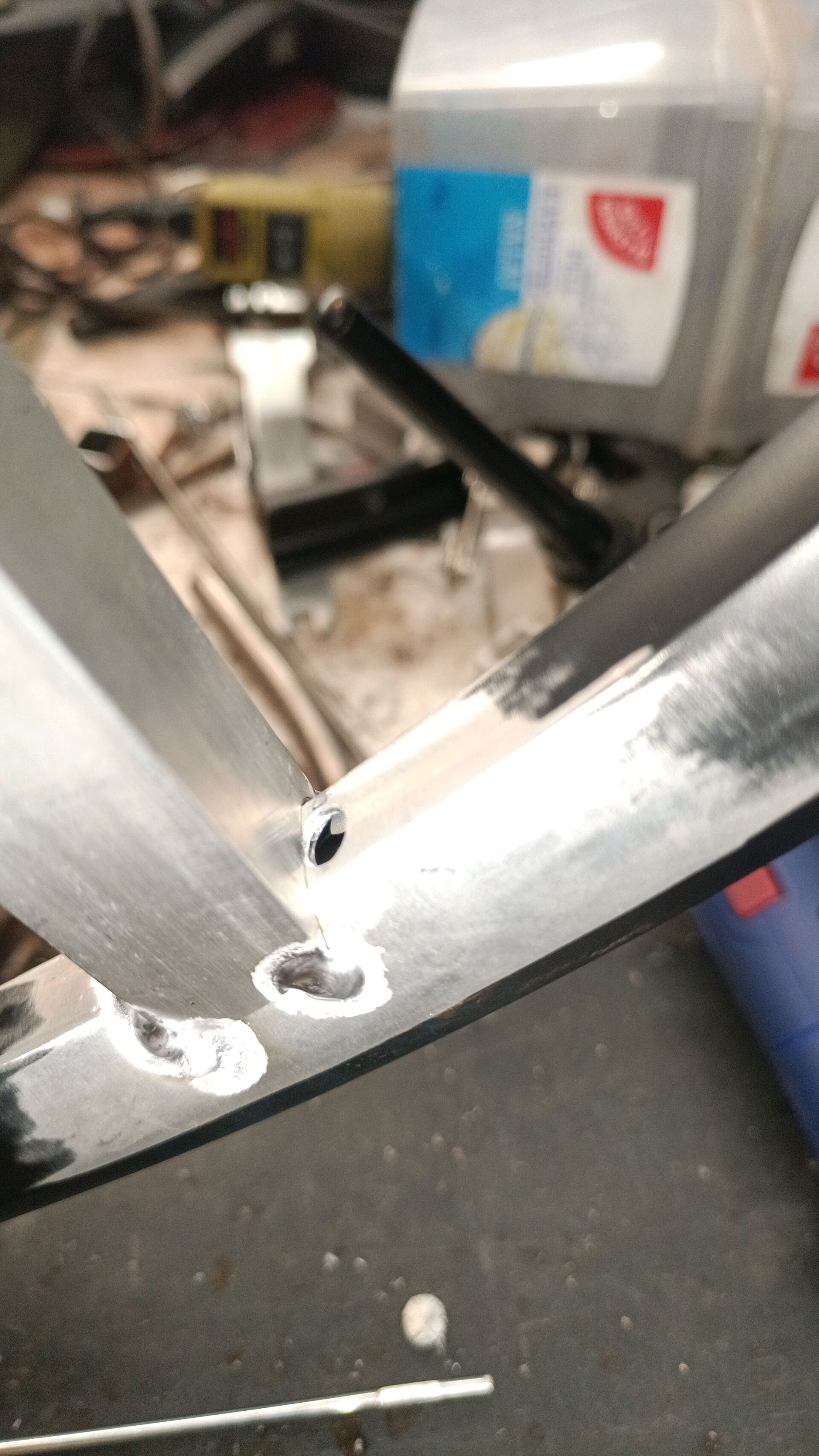

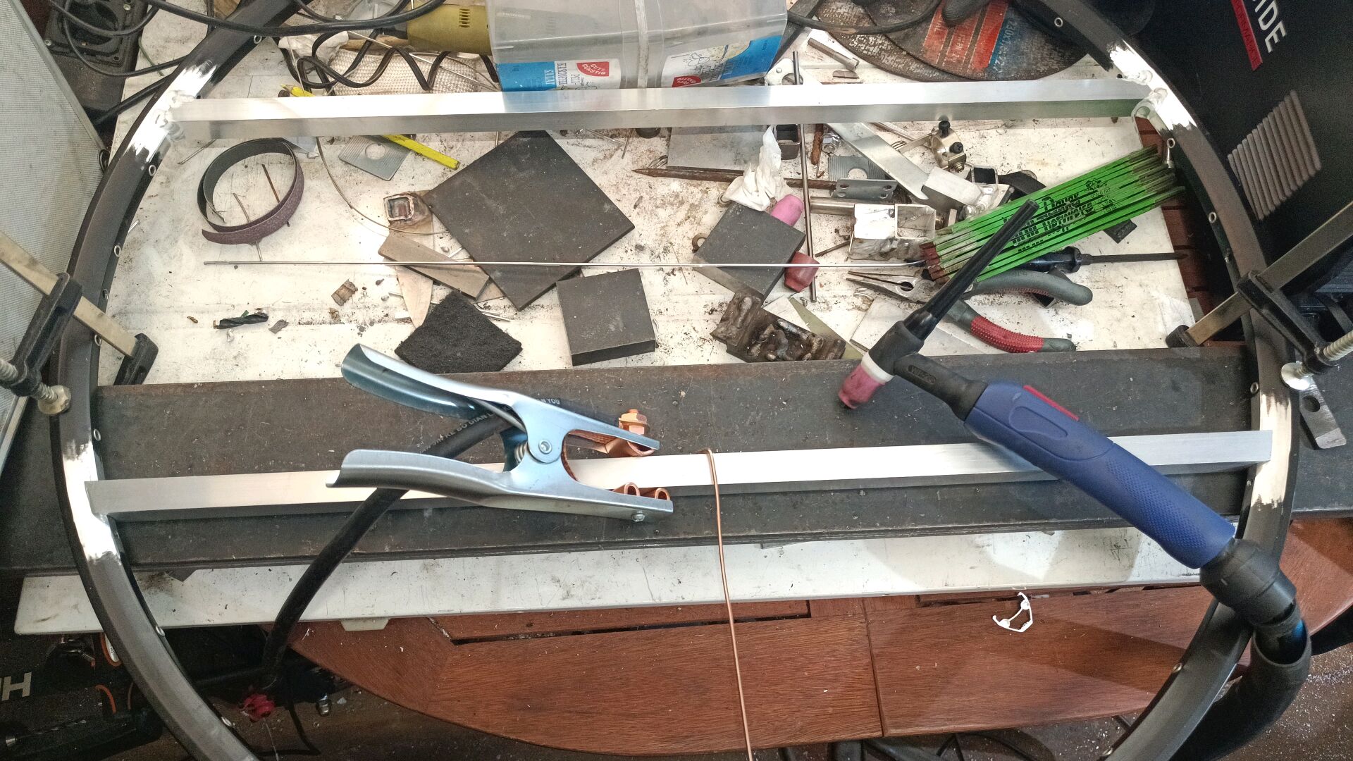

I didn’t have problems, but welding 1mm is on the thin side:
First welds were by far not as easy as the test welds. Later I noticed that the larger piece required 10% higher current, ofcourse:
Closing eyelet holes didn’t create major problems.

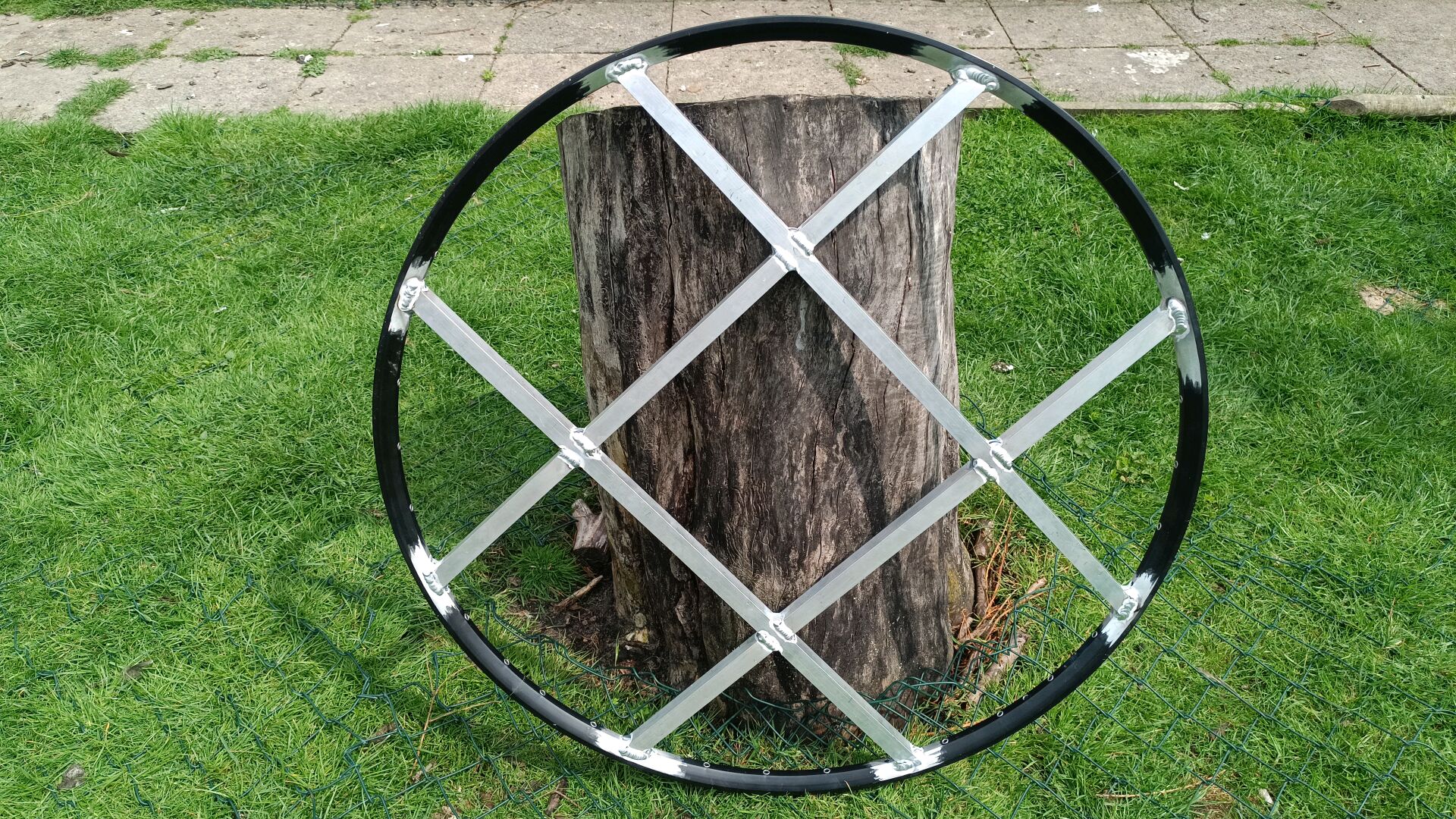

Definitely not a 42mm stealth II rim:
The Useless Wheel:

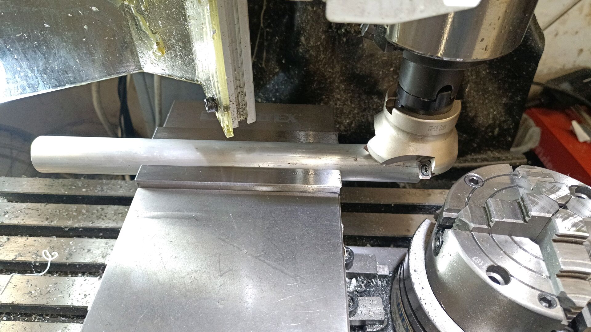

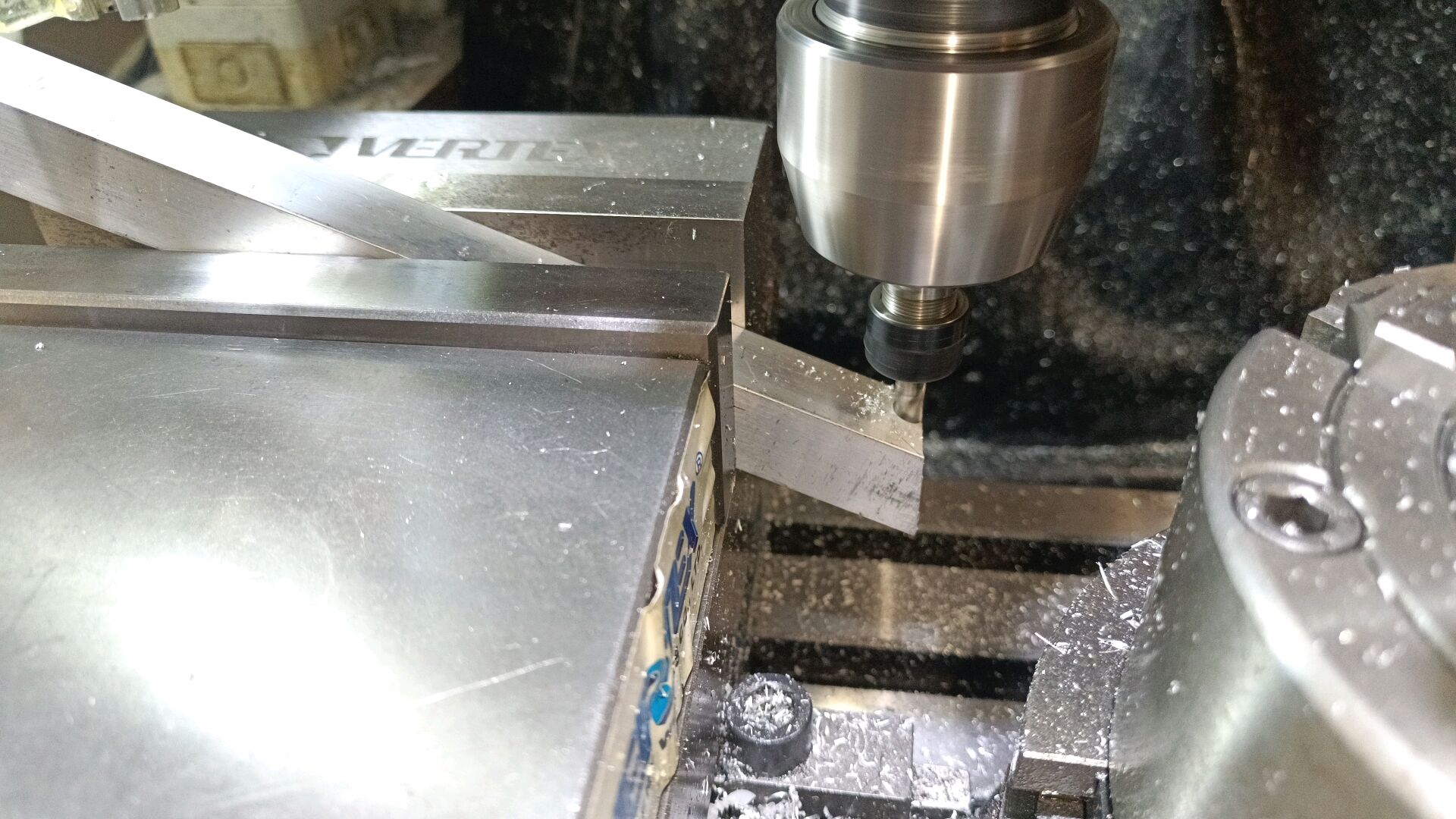

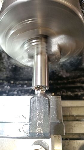

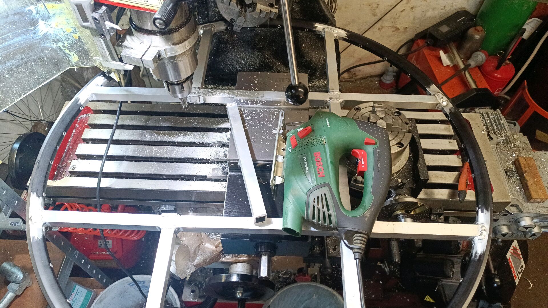

Create the crank selection bar. Mill a d= 30mm round aluminium rod to get the square pedal bar:
The chips are hot on my uncovered arms.
Shiny 20mm x 20mm bar:

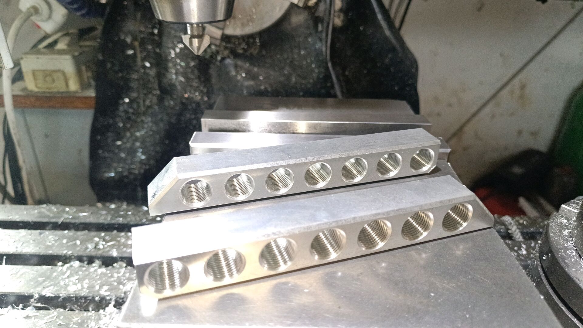

Right and left handed pedal threads for the 2 bars. I use the black lever and turn manually:
Completed bars with chamfered edges also for larger welding surface.
Just weld and you’re finished.

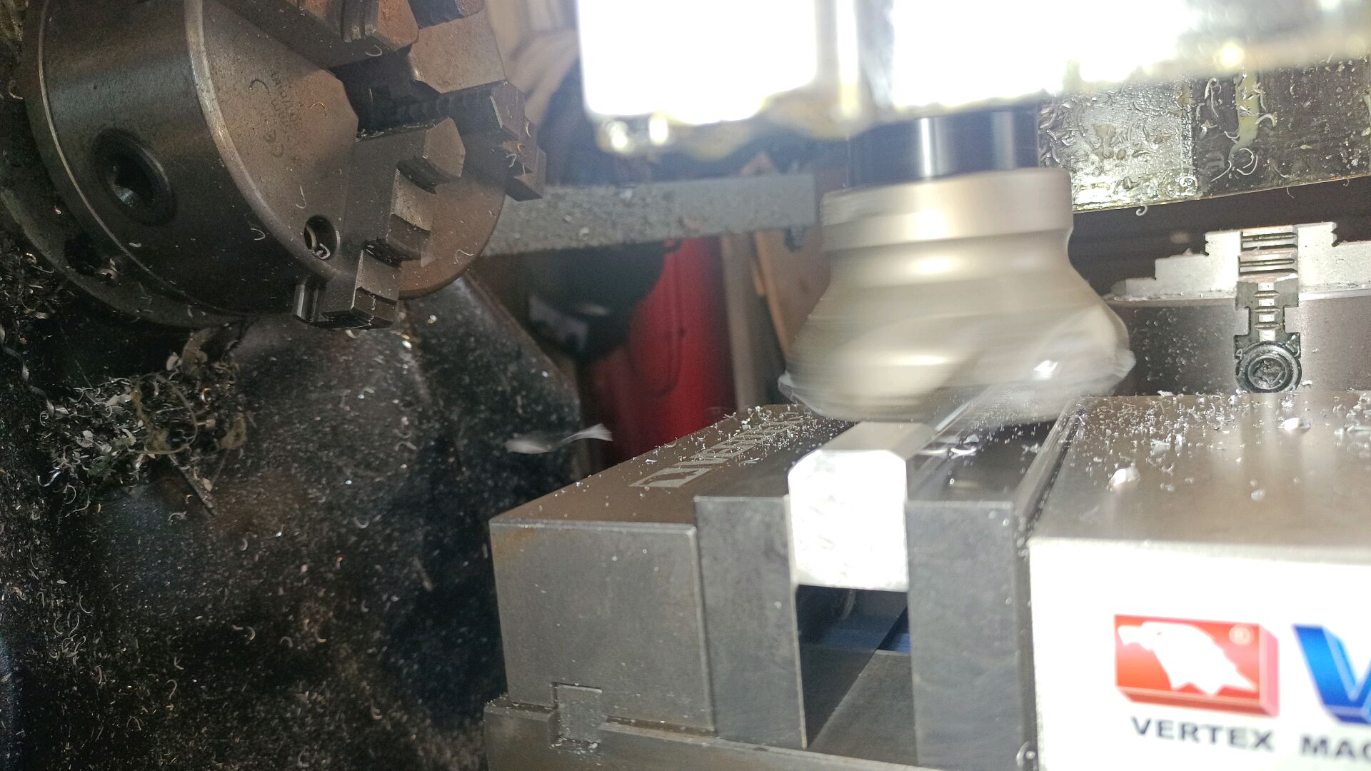

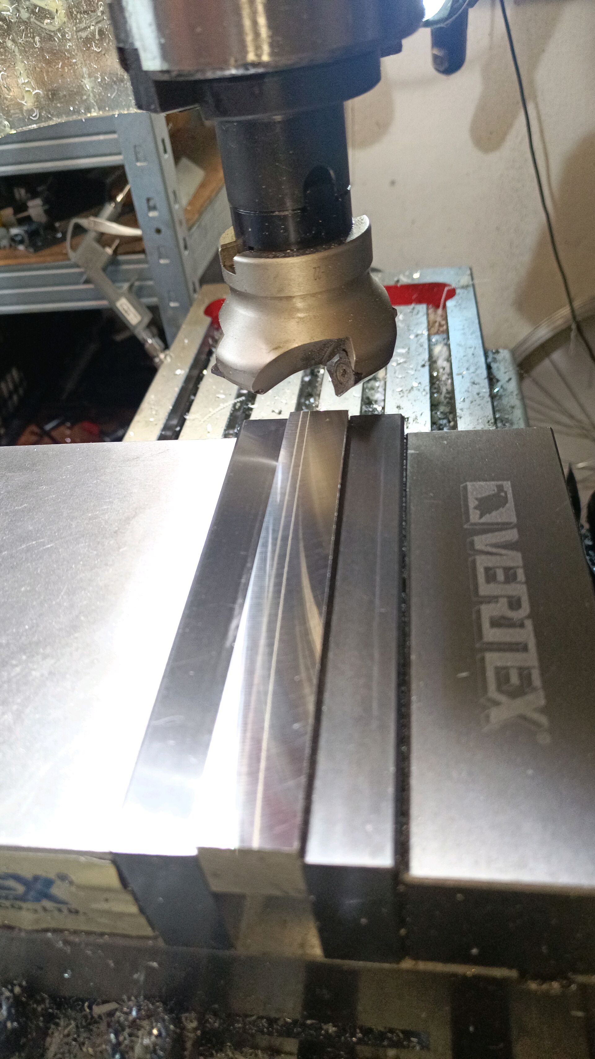

The mill creates a smooth surface again:

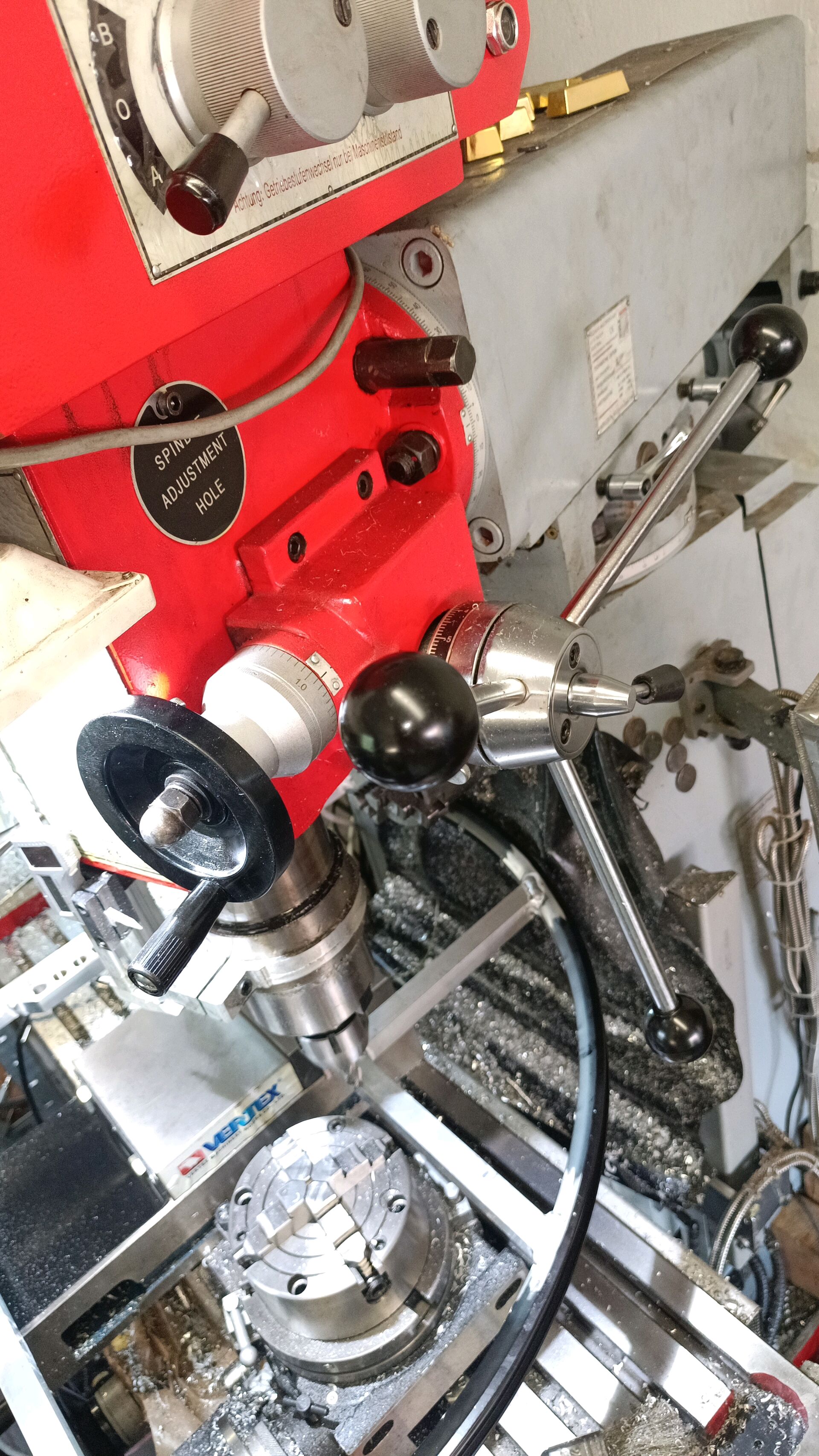

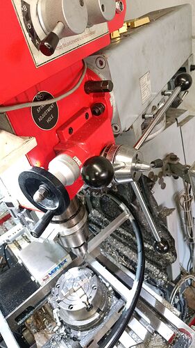

Luckily the upper traverse of the mill can be tilted and shifted to access everything.

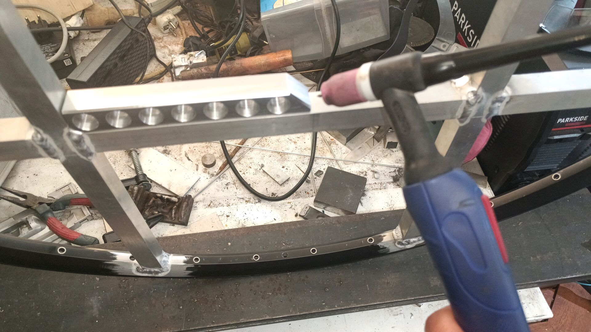

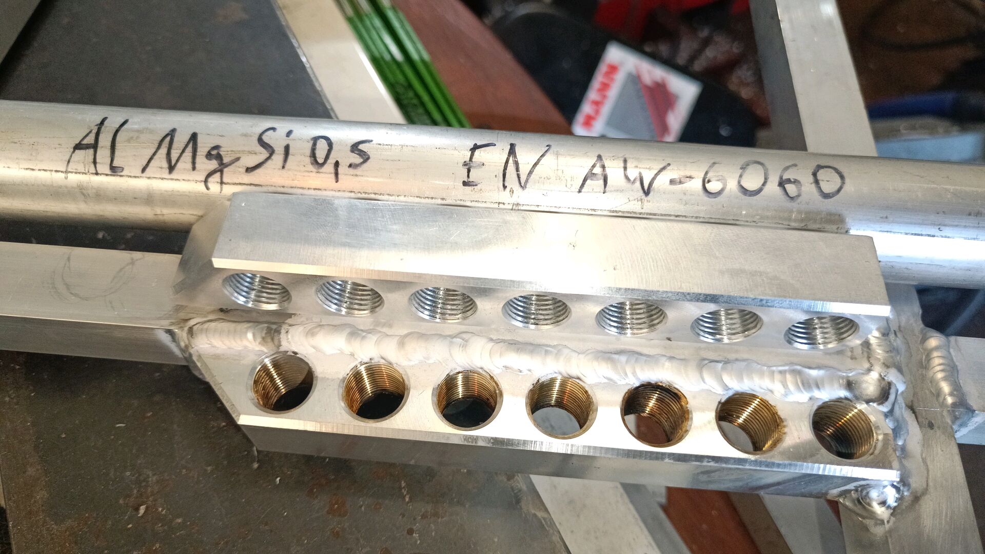

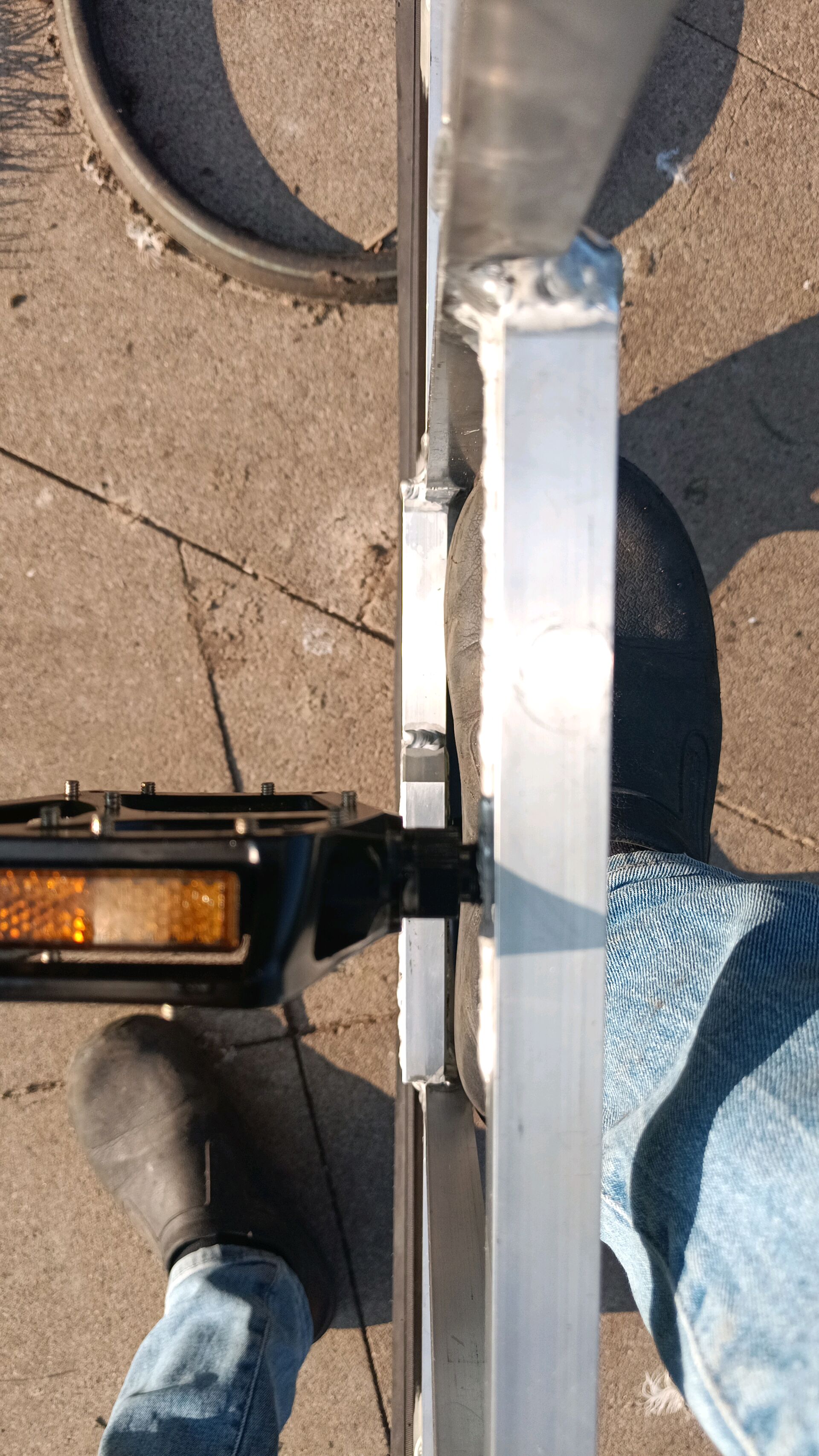

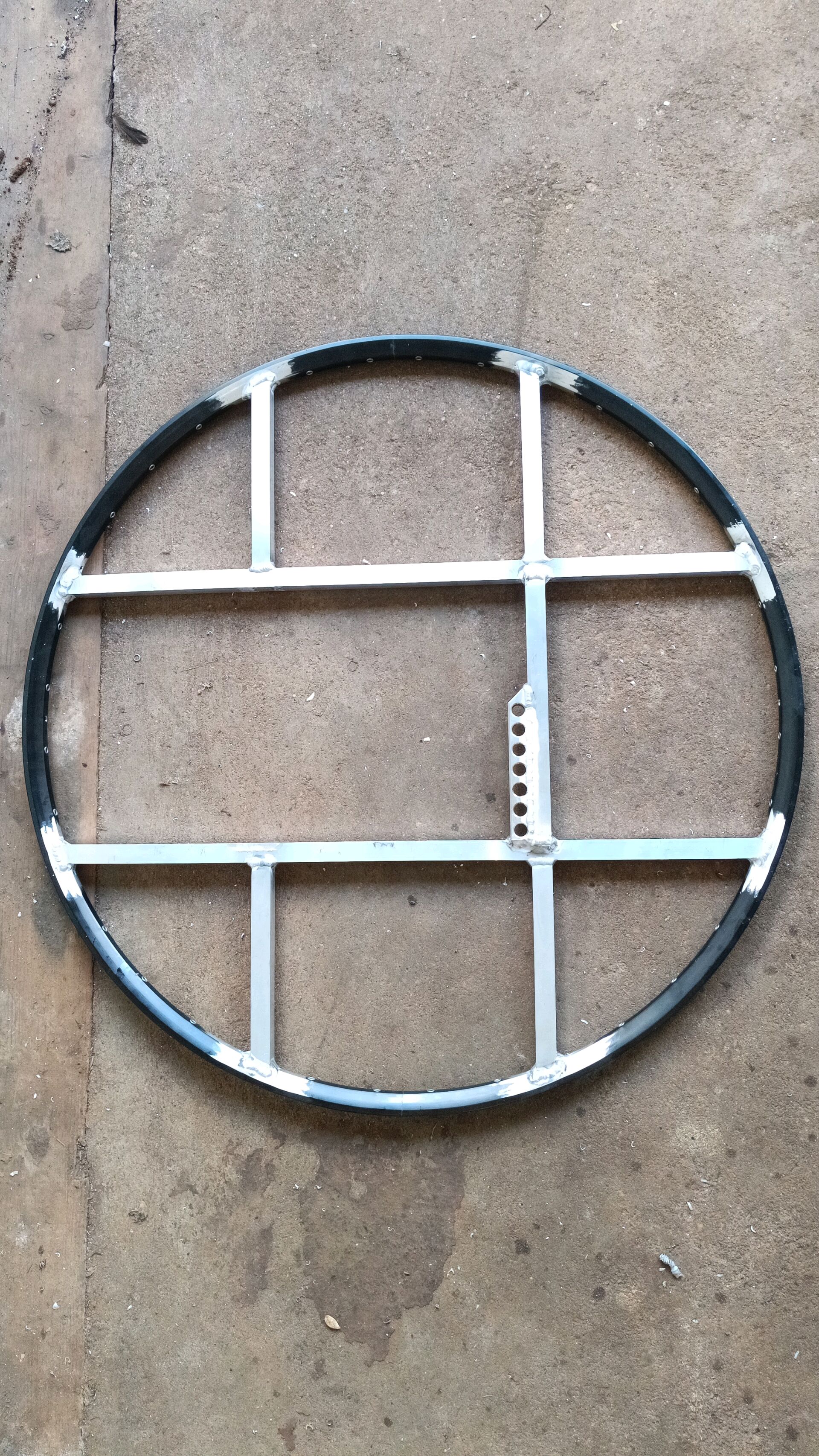

I lifted the pedal bar by 10mm. Therefore the below mounted pedal starts directly on the center of the ultimate wheel UW. So this UW has a Q factor of zero, what was the reason for this major change.

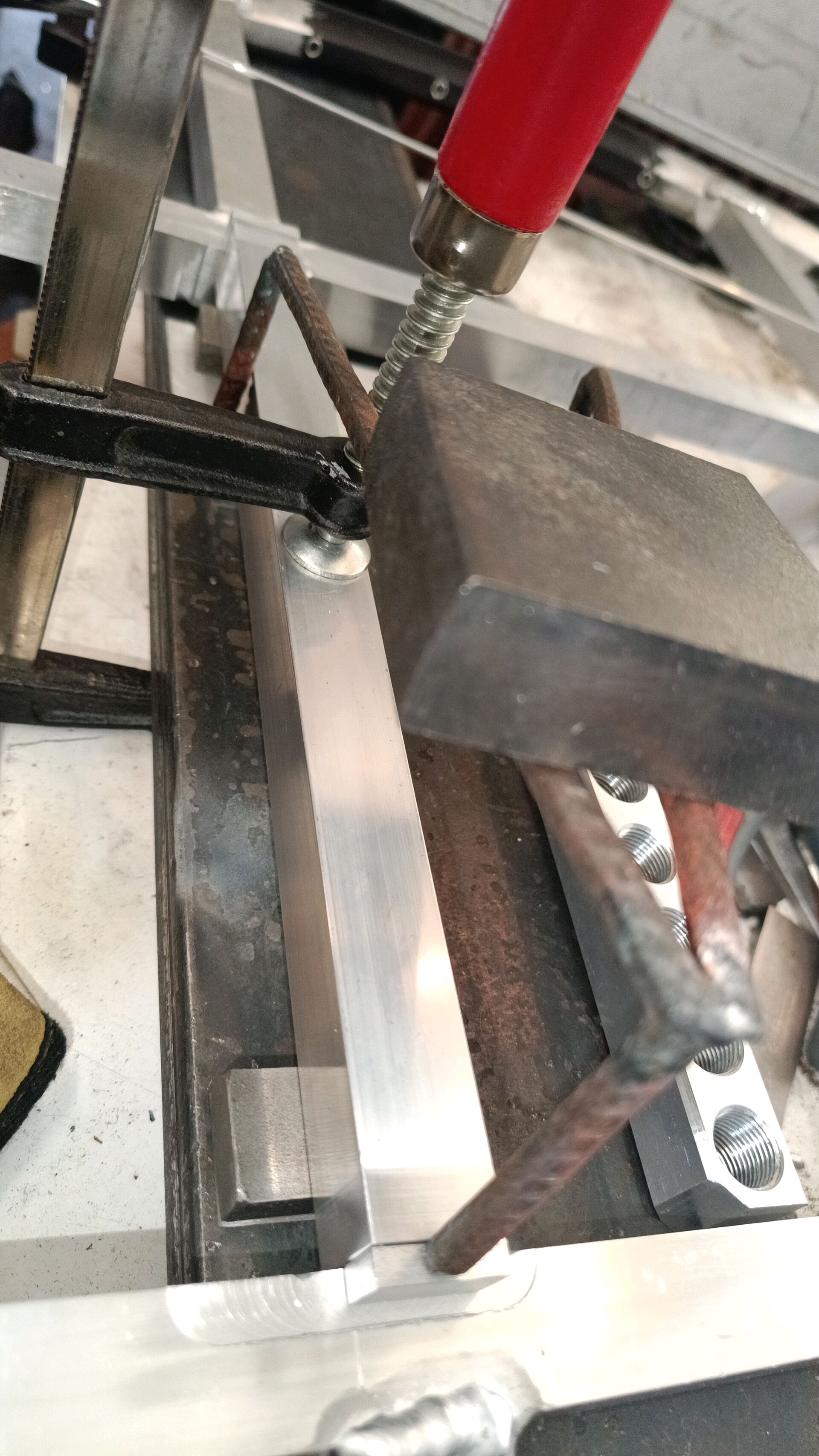

I had to close the end with a small piece of aluminium:

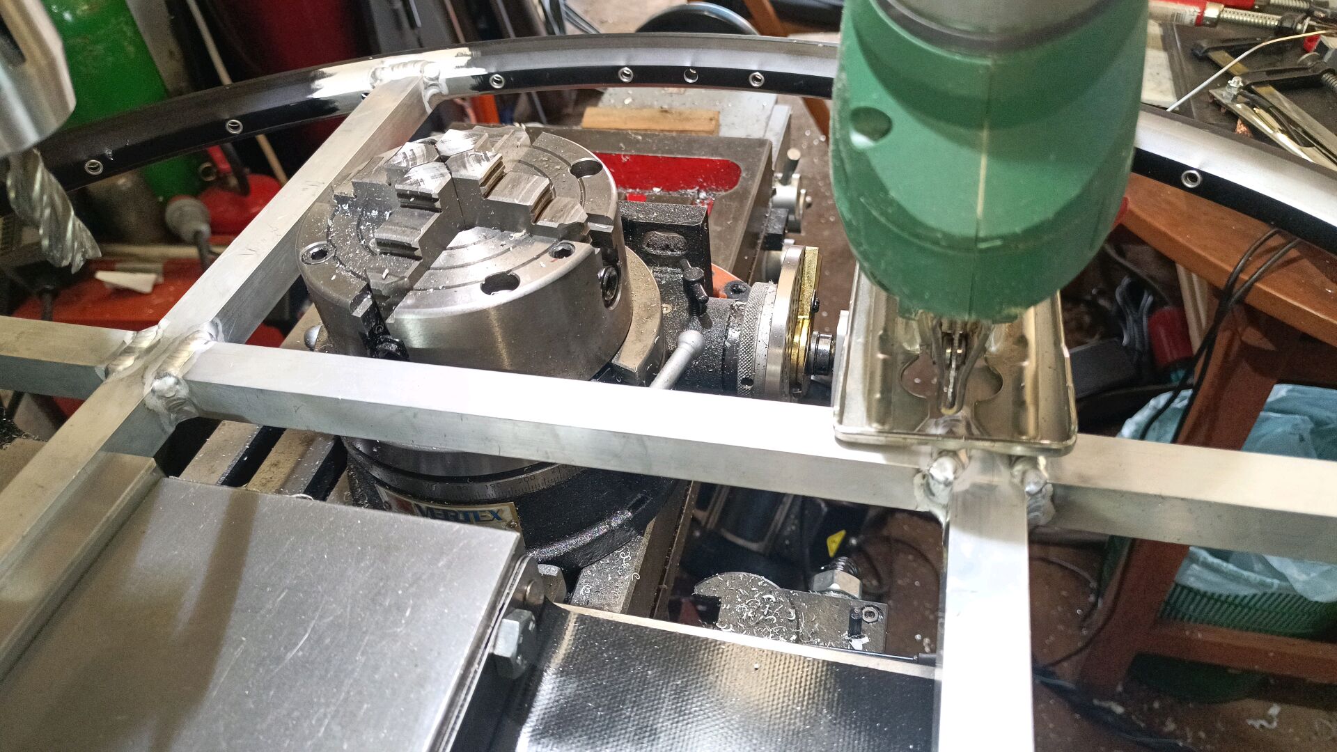

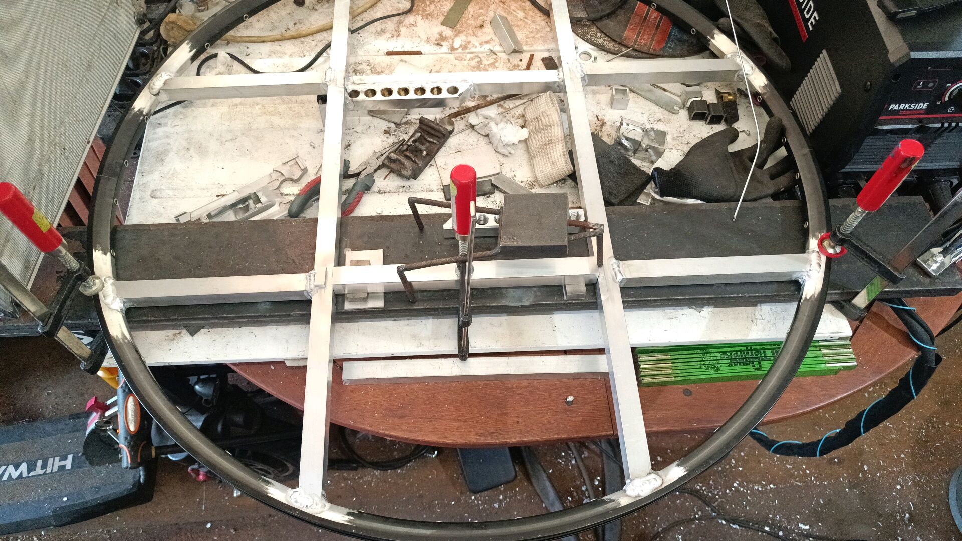

Everything clamped. Ready to weld:
Evolution of soft 6060 aluminium: round → square → zero Q pedal bar:

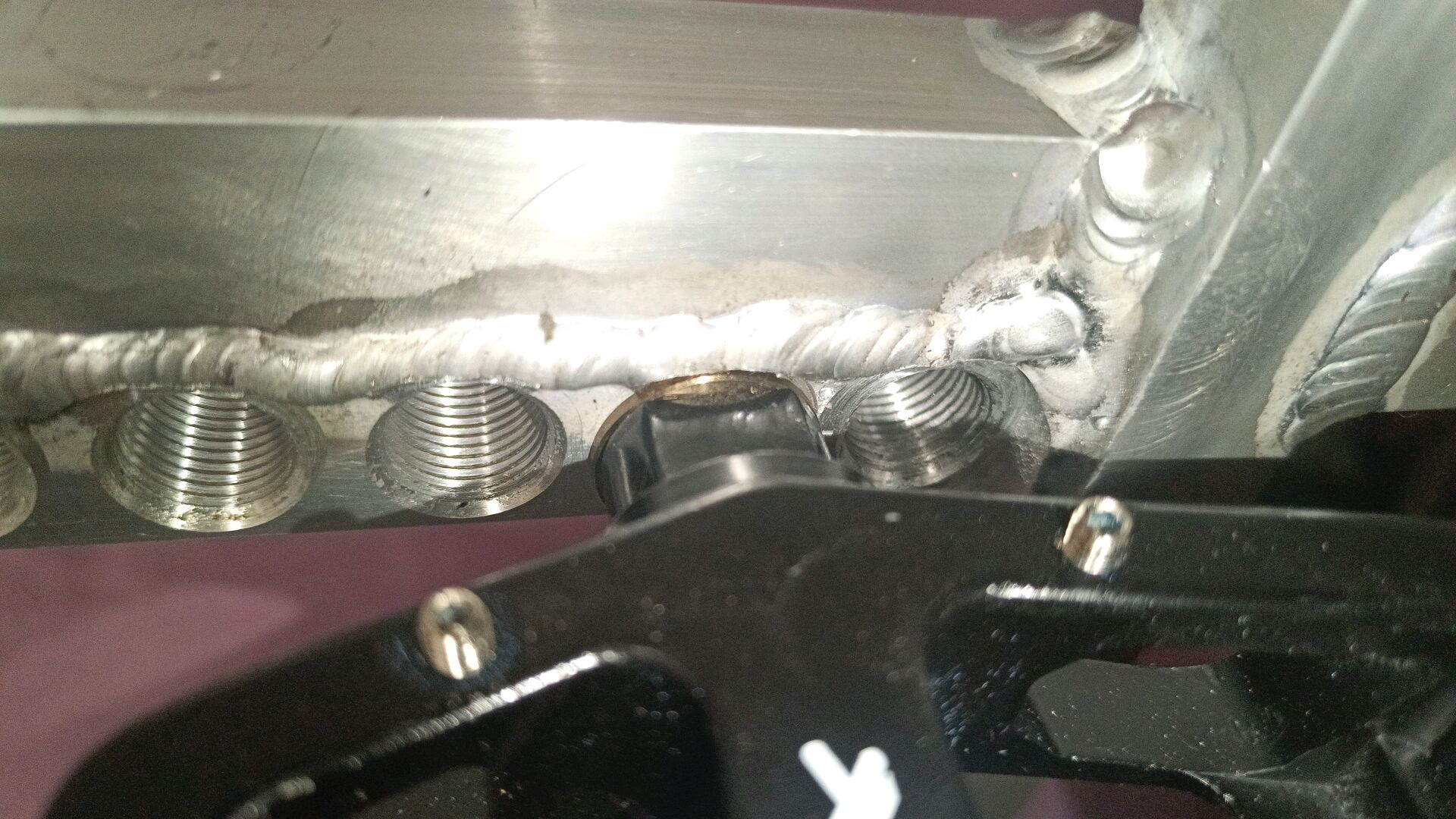

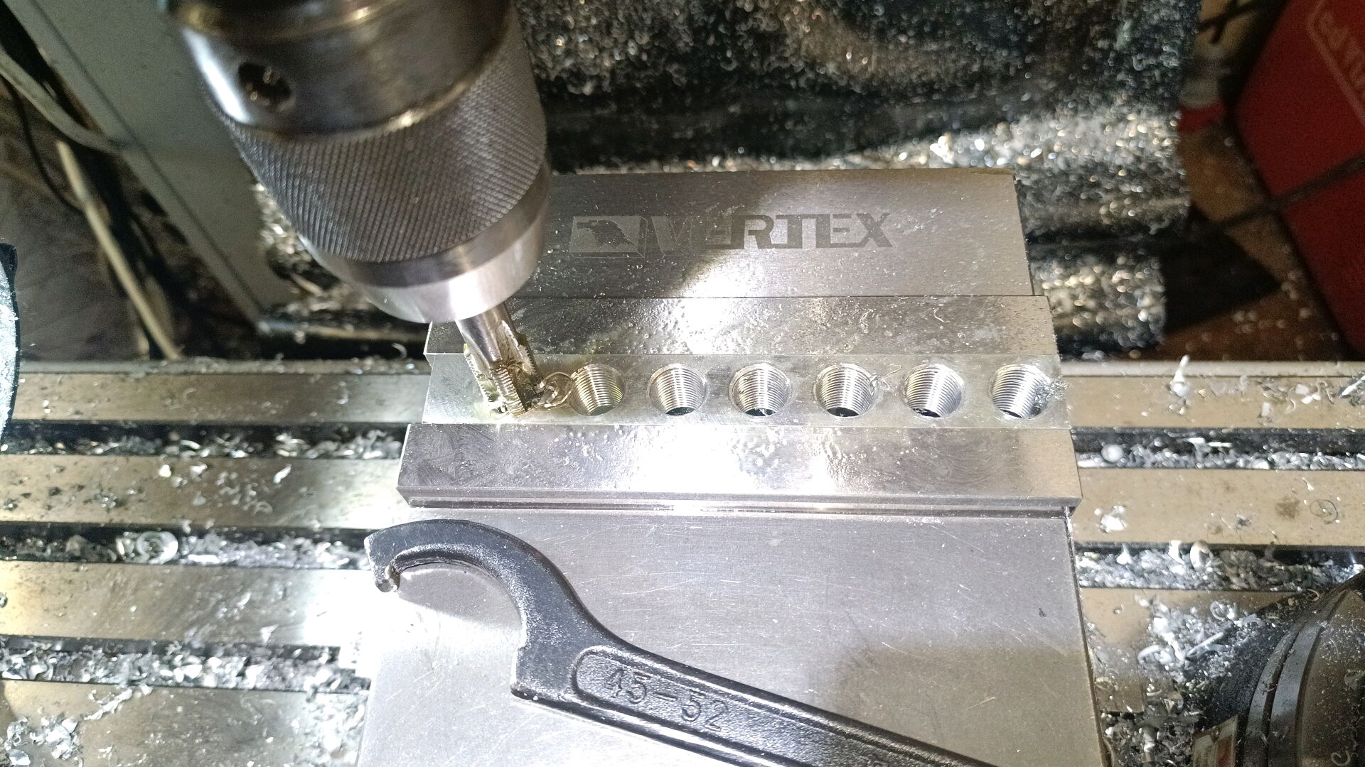

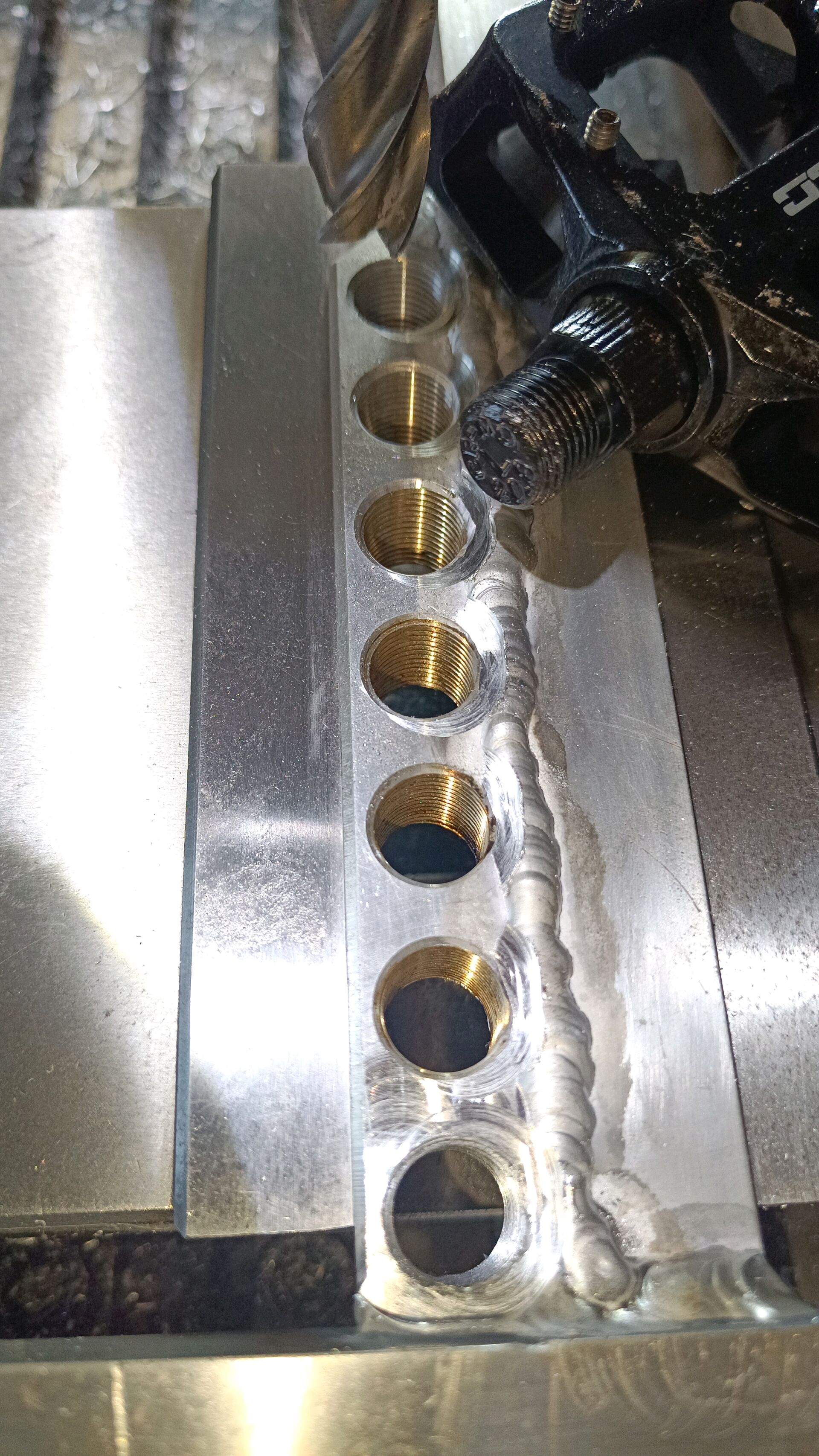

Milling a flat surface for the pedal and recutting threads:

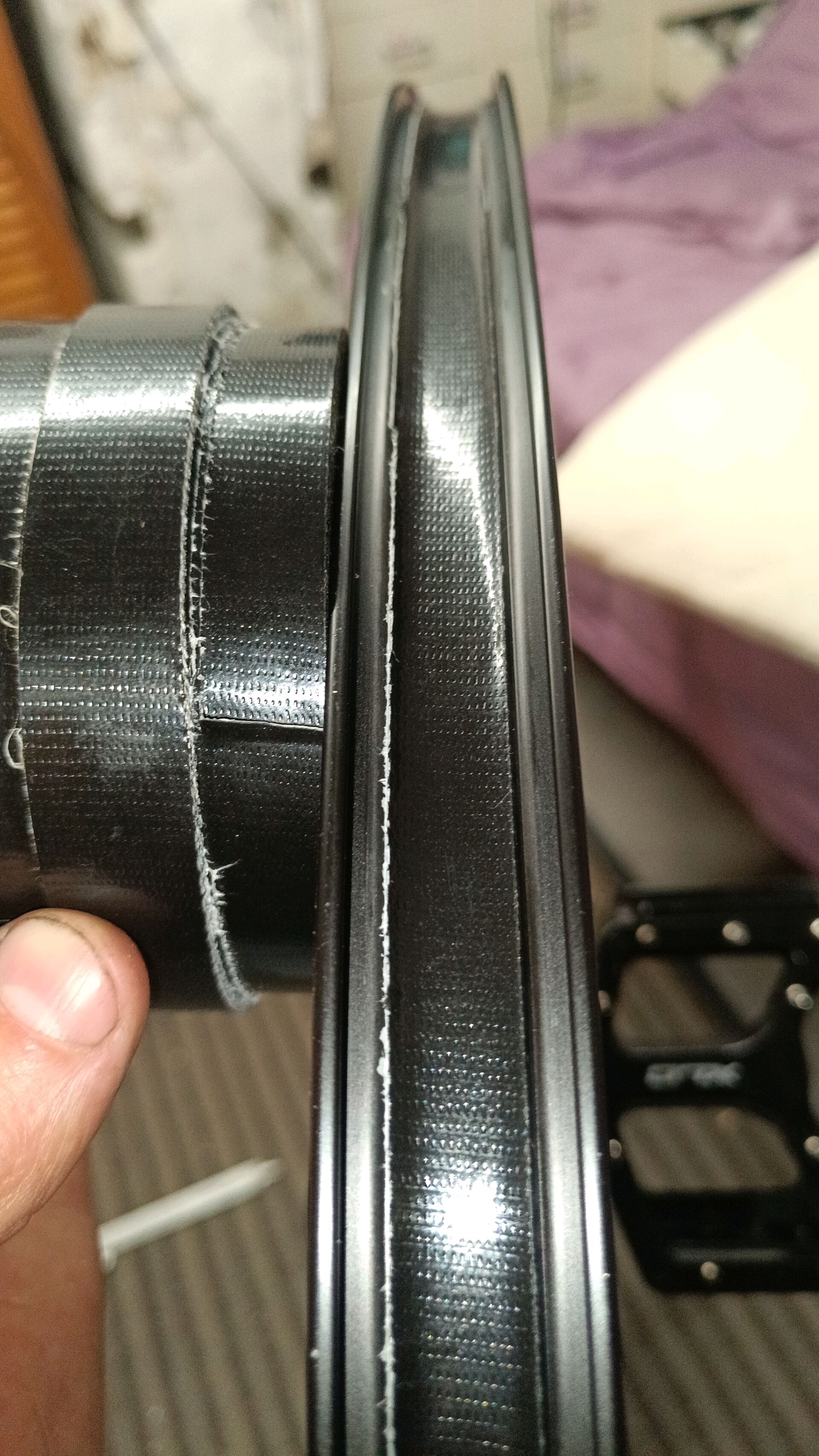

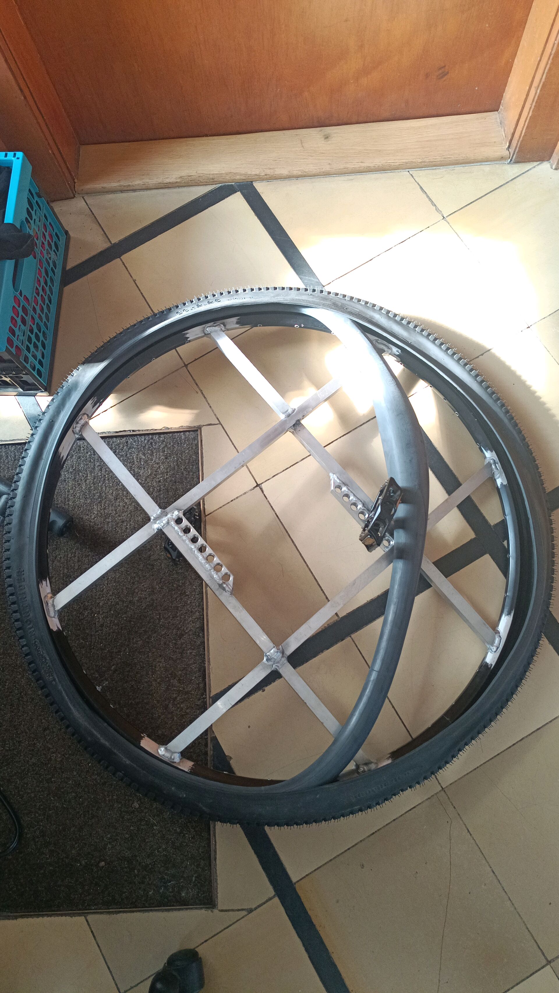

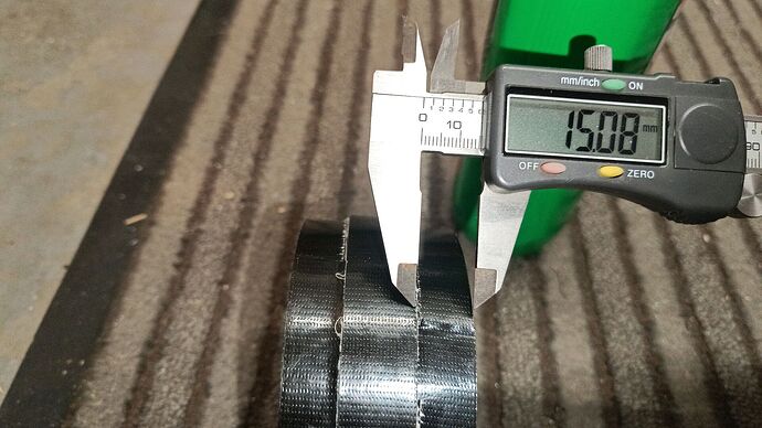

Cutting rim tape for 1 layer:

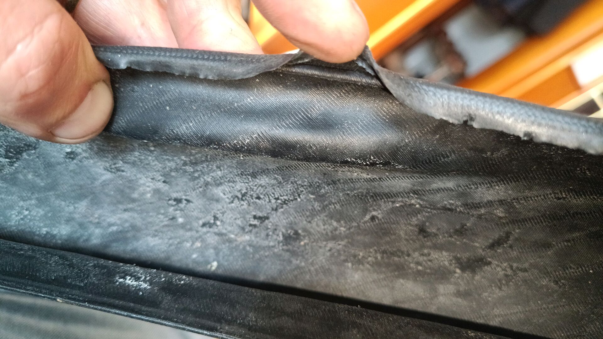

I bought the tire right after the first light Nightriders were produced. Dismounting the tire easily damages the edge, anyhow it should work:
The extra lightweight Schwalbe SV 19A tube will be installed. The valve directly fits into the rim.
Easy mounting: Last time I inflated the 29" tire until it was 36":
This tire creates a bubble, so I had to decrease the pressure and pull it in place. No problem, just takes some minutes longer.

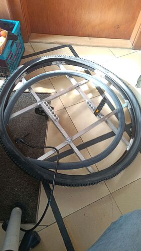

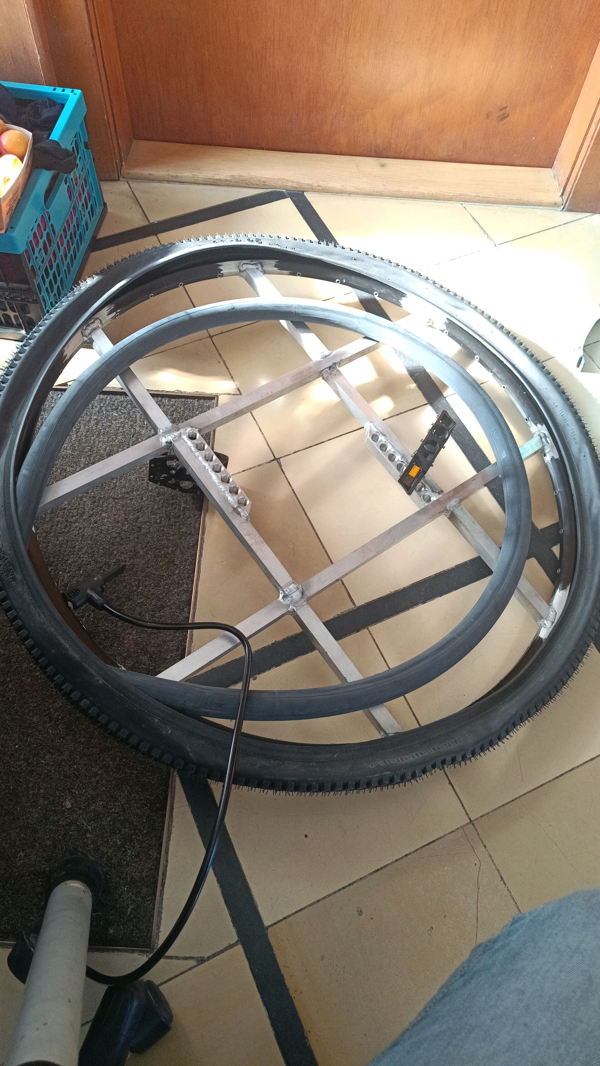

The raw 0QUW:
A closer look at zero Q.
Stainless steel pedal washers:

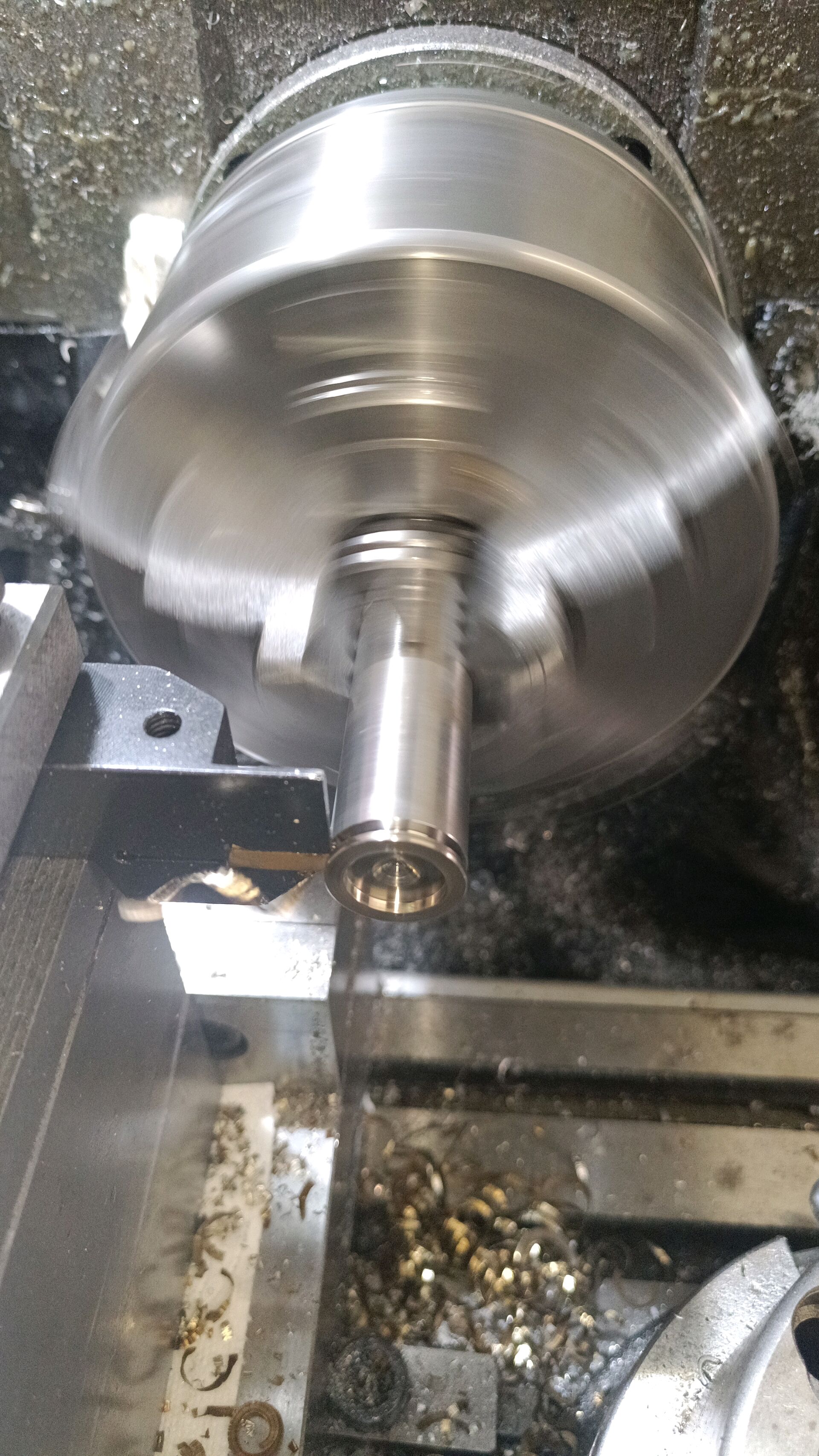

Cutting off is always a nightmare for machinists. The machine was running in reverse and the cutting iron was upside down. That way it didn’t crash, because in case something goes slightly wrong, it can lift the tool including the whole table and release forces. Play in the machine, like every machine has, can be positive.
20mm x 1.5mm washers:
The washers fit on the milled surface:

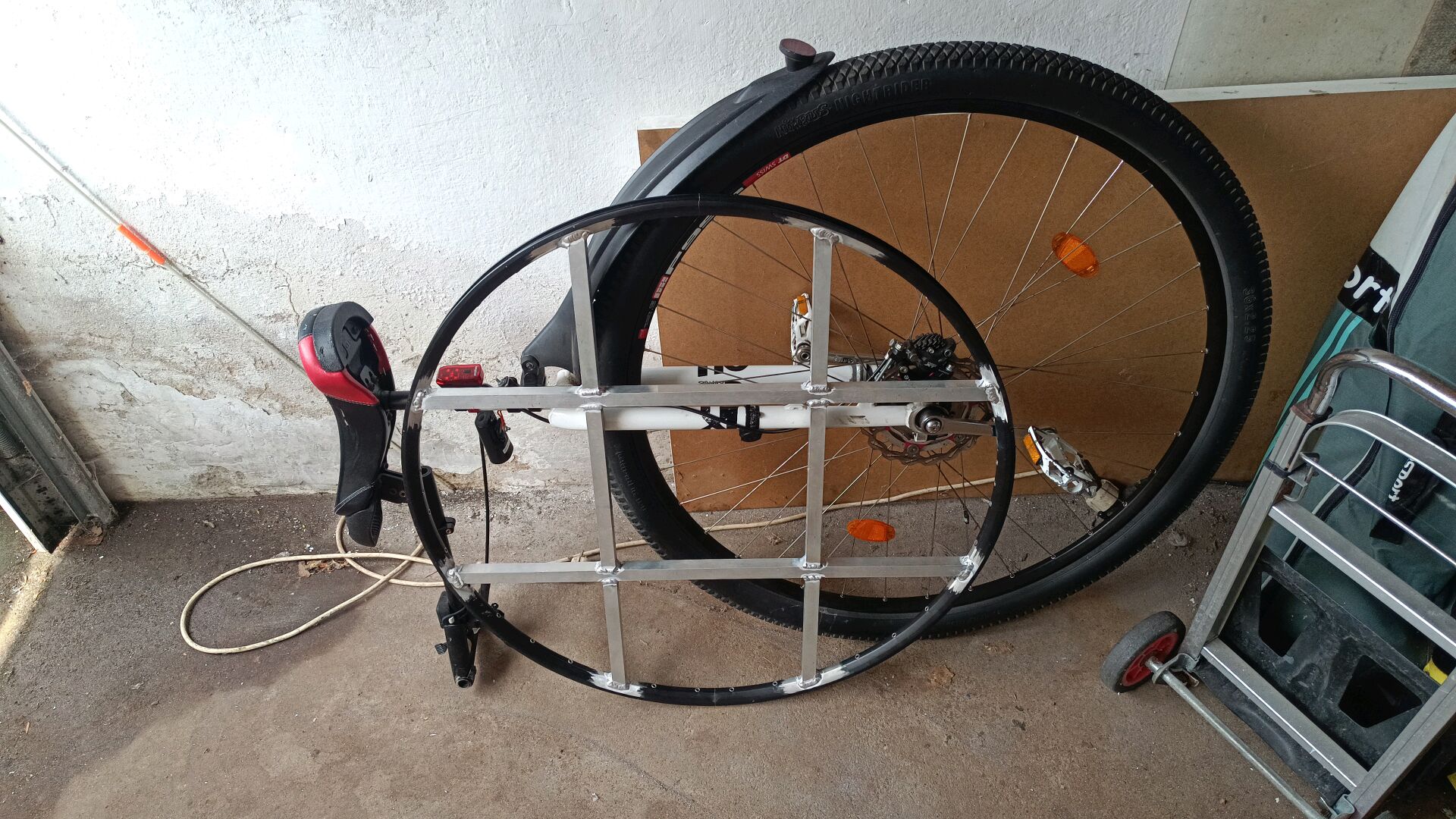

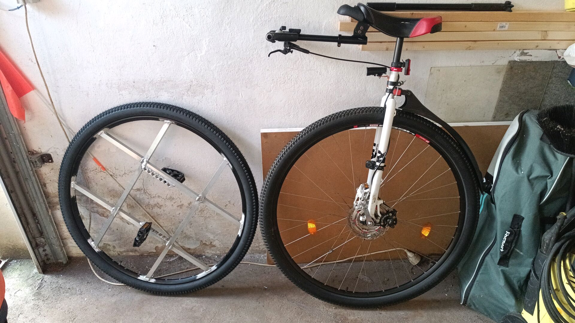

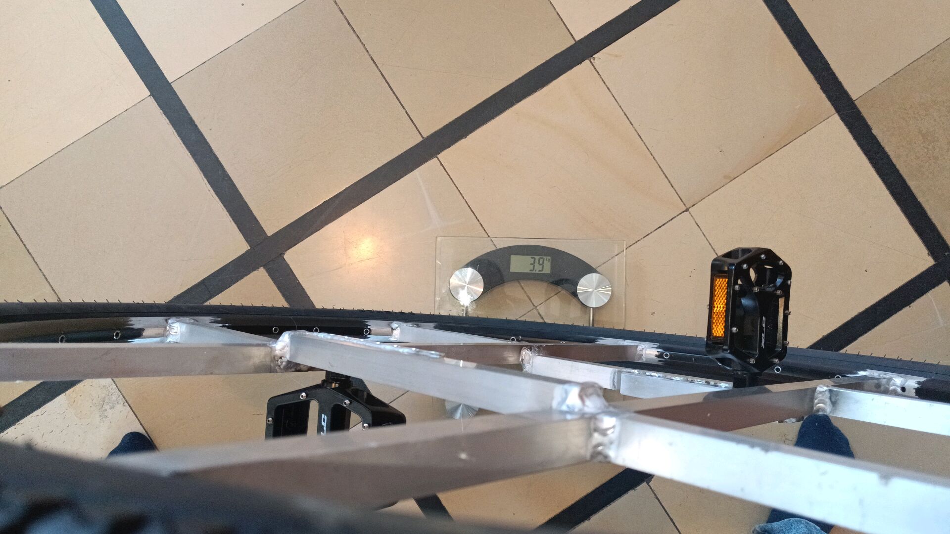

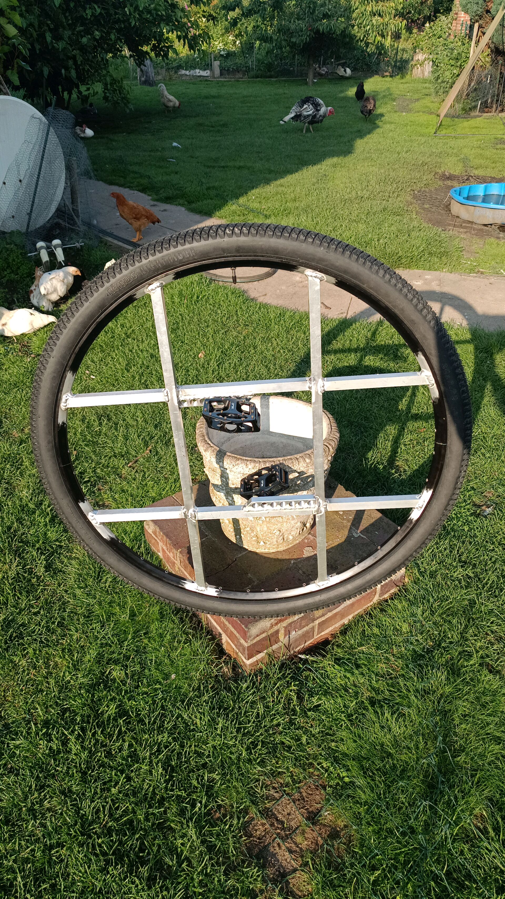

It’s my second 36" with a self made DT swiss rim:
The weight is 3.9Kg, the steel version was about 8.1Kg. Carrying is much better. Concerning the weight difference, riding is about the same. It could be even lighter. The square tubes were 2mm thick and could be reduced to 1mm as the rim has 1mm.
The first ride started right at zero, holding on to a wall. I immediately noticed that the real drawback is the Nightrider tire which is not forgiving when the tire rubbs against the legs. So it requires practice and more skill. The TA tire was much better. There was no problem with 0Q, It should be easier to ride. I noticed that my feet didn’t have to touch the square tubes. So the mount onto the pedal doesn’t have to be that precise.

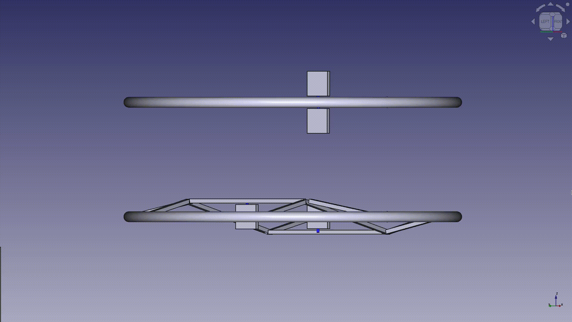

For curiosity I drew two versions of a no wobble UW, one kangaroo style (better known as @Setonix style) and one with centered feet:
noWobbleUW
why are the pedals of the top on side by side. I’d like to see you ride that.
For a no-wobble version, I wobble quite a lot.
No problem to ride that if your bowlegs leave enough room :wink: (for those who can ride an UW at all, that is).
Heh, the kangaroo style on the top actually eliminates all wobble issues indeed due to symmetry! Well, at least certain kinds of wobble. :joy:
How do you actually turn on either one? I see no other way than twisting, or maybe intentionally rubbing your leg on the tire. I can see absolutely no practical way to turn on the kangaroo style one, in fact.
Has anyone ridden a kangaroo style UW, or even one with the “cranks” at an angle other than 180? Or done kangaroo SIF? :sweat_smile: You should have thought about this when making @Setonix his 36" UW and mirrored the pedal hole selection bars on both sides.

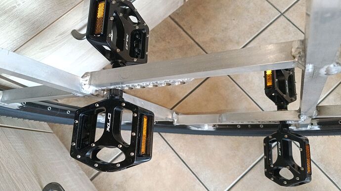

Convert @Setonix UW to kangaroo/botanic Setonix Wheel (Swheel SW): I.e. you can screw two right pedals on the left and on the right side of one hole and you have it!
This one would be for dogs riding UW:
ur aware that the dog will end up upside down…
But it is nice to switch pedals along the way, as long as you keep your knees out with every rotation. I leave that honour to you to show how to do that :stuck_out_tongue:

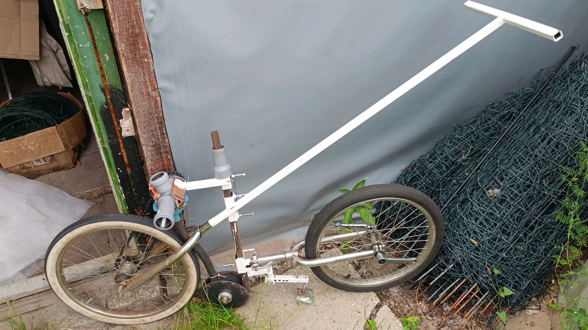

I recycled the rear wheel of my seeding machine to get my training uni back:
