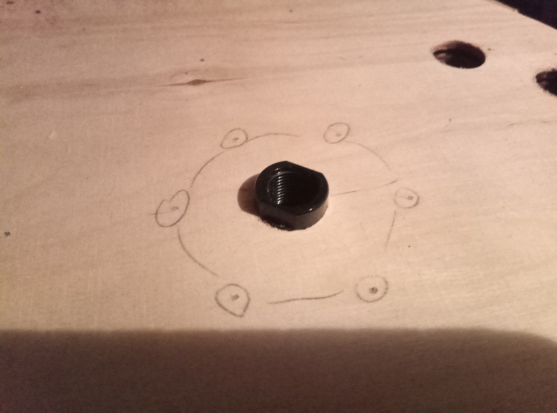

9/16” nuts are hard to find in reverse thread. If you use 1/2” pedals the nuts are easy to find at the hardware store. I had this idea for pedal mounts when I stumbled across 1/2x20 left nuts at the local Ace. With tee nuts, and fender washers I don’t think I spent more than a few dollars on all of the hardware for both pedals. I already had the pedals in my parts bin (it’s a popular BMX size).

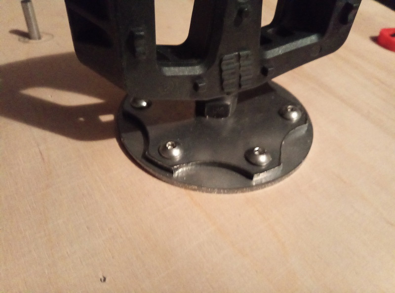

Pedal mounts
While I still have no clue when I might find the time to do the wood work (next to full time job, baby and the unicycle group I train), the metal parts already look fine (disregarding painting).
I used 9/16"-20 UNF to 1/2"-20 UNF adapters, 1/2"-20 nuts, big washers and two laser cut steel plates, 3 mm each. The one with the slot locks the adapter against twisting.
That is a great way of doing it. I have seen inexpensive “universal” pedals that come with the adapters like you are using.

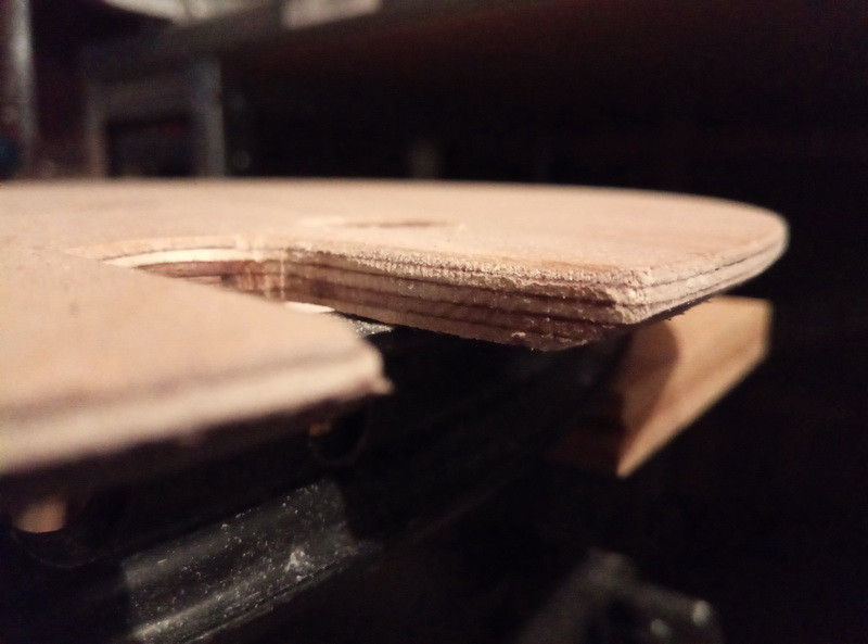

Now I finally found the time to timber.
I decided that I’m not able to cut the plates with my jigsaw accurate enough to guarantee true running of the wheel and ordered three NC-milled plates (6.5 / 12 / 6.5 mm) from a company nearby.
I printed stencils from my CAD construction to mark all holes. As the middle plate has exactly the inner diameter of the rim, I had to file grooves for all nipple eylets
It perfectly fits the rim.
As you can see, the outer plates are larger than the middle one to provide a snug fit. All three plates are full surface glued and then screwed together. The middle plate is screwed with the rim through every spoke hole.

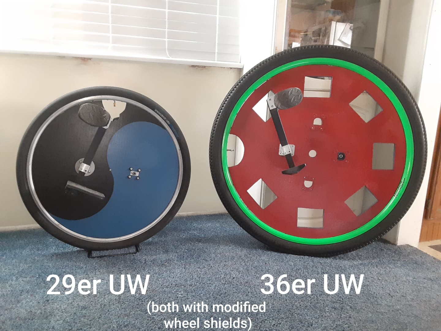

These are mine. The the custom modified wheel shields make tire rubbing a thing of the past. Truly a joy to ride these.
