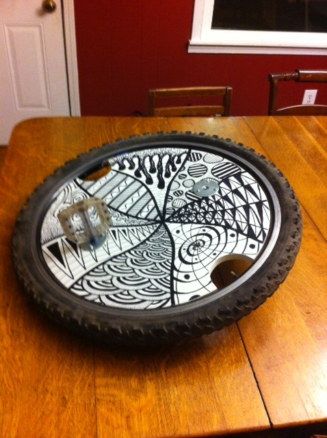

So, every year at STOMP Munifest I mess around in a open field with one of the ultimate wheels someone has brought along. Then after STOMP I rush to unicycle.com because I have to have one. Then I see the price, and another year goes by. I just can’t pay that much for something I am not even sure I can ride or if it will be something I use or just look at in a closet.
So, this year, I start wondering about making one. Thanks to UNIGEEZER, there are options out there. So, I grab an old 26 aluminum mountain rim and start cutting spokes. I get a pair of old cranks and cut them down and find some really strong large fender washers, and with the help of some sharpies, I even make the cheaper plywood I got look pretty good.
I thought I would share my saga, for several reasons. First, others might want to see if $30 is a way they want to try themselves with an ultimate wheel before investing in a light professionally made one. Second, and most importantly, it will help to keep me focused on learning and adapting as I continue this adventure.
Stay tuned…more to come…

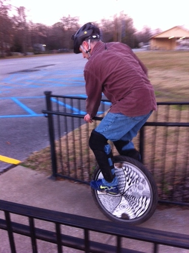

Here are 2 pics–one with me practicing just balancing on it and the other was taken while moving “forward”–I use that term loosely!
(After 20 minutes of saving and spinning and re-saving–NO CLUE why they are coming through sideways???)
Nice Work! I should get out on mine too. How is the leg rub?
When I got a set of inline hockey knee/shin pads with plastic that wraps around the side of the leg it made my learning progress much faster.
The KH leg armor works great if you spin the slick section inward. I am definitely going to have to get another tire, though. The knobby mountain one was what I had on the rim. The knobs love to try and grab the armor. It does look good though with the mountain tire. Working at a bike shop, I should have no problem getting someone’s cast off-slick. That would make learning easier.

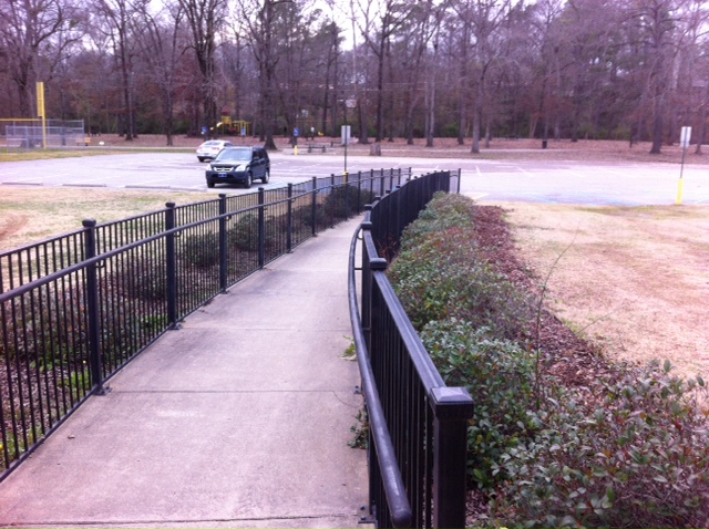

Day 2
Ok, We rode Muni this morning (7.5 miles) on a wet pretty technical trail, but since I still had good weather (finally) I had to get in some more practice on the Ultimate this afternoon. -about 45 minutes (then I was pretty worn and regressing)
Few things:
-Learned that if you can’t keep it exactly straight, lean the top of the wheel towards the opposite side of the foot that is coming over the top of the revolution. Then you are coming up on the side it hits and so because it is lower on your leg, it doesn’t grab you. (hope that makes sense?)
-Was able to do most of my practicing holding on with only one hand today.
-1st day my best was 3 revolutions in a row. Day 2, I set out to make it all the way down the rail (see pic) without stopping. Didn’t make that–about 2/3rds of the way. Still much improved.
Overall, having taught many people to ride unicycle, I see now in myself about the same progress I hope for in those I teach. That is VERY EXCITING!!

Day 3
Ok, You have to understand, I am one of those who learned to ride unicycle when I was 10, then 6 months later I took it apart to customize it, and didn’t put it back together for 30 years. It was, however, like riding a bike, and in less than 30 minutes I was riding again like I was 10. Sooooo, I have taught lots of other people and improved my skills, but I haven’t had to “learn to ride a new thing” in over 40 years now (if you are doing the math, yes, I turned 50 this year) I was very curious if my brain would adapt quickly, slowly, or not at all???
All that to say, any improvement each day would make me happy. I have been PLEASANTLY surprised. Each day (though only 3) has shown marked improvement. Today I made it the full length of the rail (see pic from last post) without stopping, only holding on with one hand, and did it 5 times. (not necessarily consecutively)

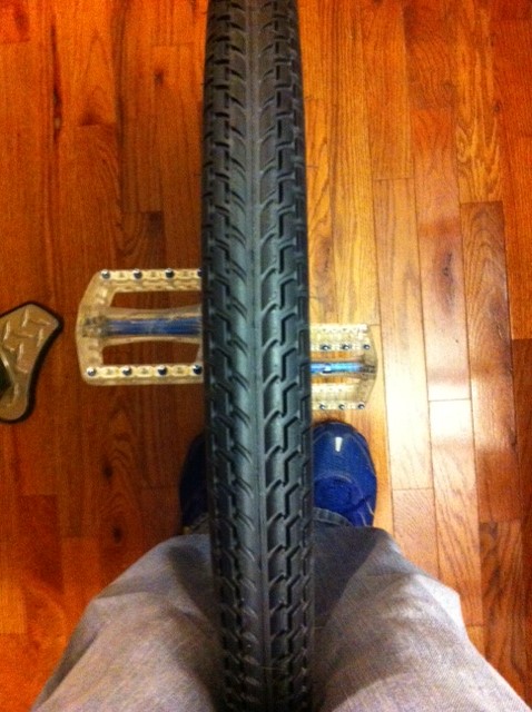

Tire Change
Been really cold, BUT a friend hooked me up with a new tire that he had for a mountain bike trainer setup. Excited to see if it moves the learning curve along faster.
Will let you know
Before and after pic below–Yes, flipped sides–One side black and white, other side colored–that way I know which is right and left. :slight_smile:
Day 5
Well, let’s start with the positive. The new tire is skinnier than the rim, so leg armor was pretty much optional. No rubbing or dragging or snagging of the armor. That was SWEET! The wheel is also lighter-don’t think that really effected learning, but walking back up the path to start down again, and again, carrying it, was easier. That about wraps up the positive…
Ok, a tire that skinny is extremely hard to stay balanced on top of!! Huge difference-which equated to a huge step backwards. Now maybe once I have it down, I could handle and appreciate the smaller profile, but for now, it set me way back. It looked much more like circus riding with me teetering back and forth from rubbing one leg to the other. NOT PRETTY!! I also decided to attempt going up hill on the incline to see how that did–pretty much impossible at this juncture. I did take a little air out of the tire and that helped a little–leading me to…
–Conclusion: I need a “townie” style tire. Wider than my rim but without all the “mud knobs”. That would offer enough of a surface to balance on, without grabbing my armor or legs.

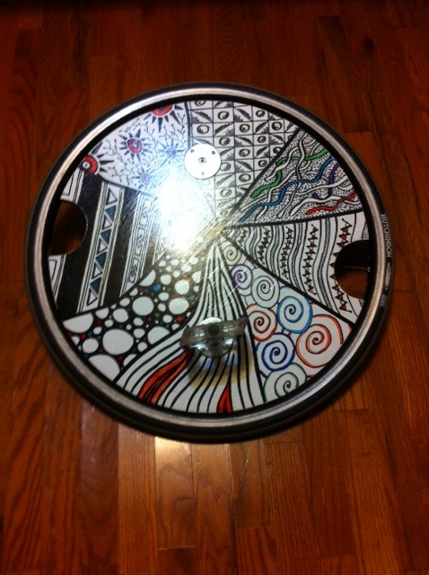

So, as I let everyone know about my 3rd tire, I am reminded of the story and questioning in my own mind if the tire is an excuse. Or is it like Goldie Locks and one was really too hard, one too soft and this is it. Well, hopefully soon we will know the answer. New Tire installed today!! Looking at it, I am optimistic, but that describes this whole process.
–First tire–mountain bike Knobby Kenda 26 x 2.10
–Second tire–street slick (other extreme) 26 x 1
–Third tire–(hopefully last) Good Year townie 26 x 2.125
Here are pics of #2 and #3

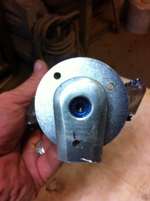

Are the cranks only held in place by one of the three screws or are they kind of clamped between pedal and crank?
I used a Dremel tool to notch the plywood so the crank fit inside snugly and flush to the front. It did not go all the way through. You are right, only 1 of the bolts goes through the crank. There is a large fender washer on both sides of the plywood sandwiching the crank and the other 2 bolts help pinch the washers together and keep them from shifting. They are only 1/4 inch diameter bolts. Has been very strong so far. I had to do it that way since I checked several places and could not find a reverse threaded nut or even one right hand threaded that had the same thread count as the pedals. Friend had old cranks and they are aluminum so they weren’t hard to cut.
