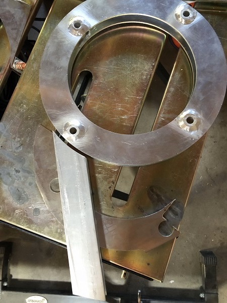

Building a 36" Ultimate Wheel

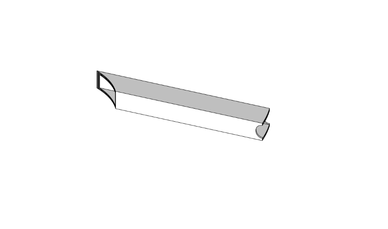

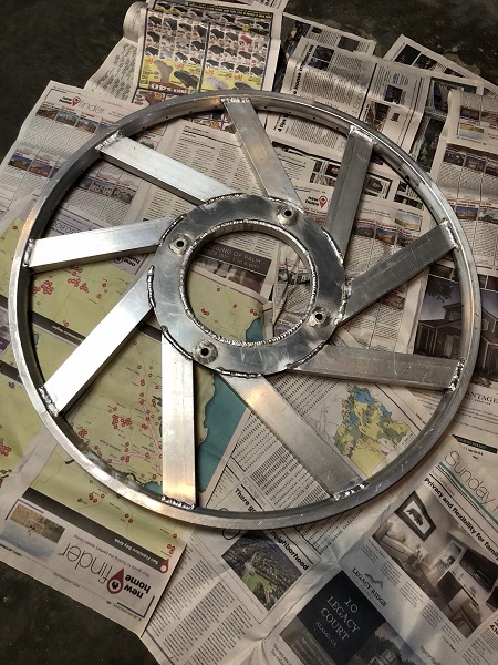

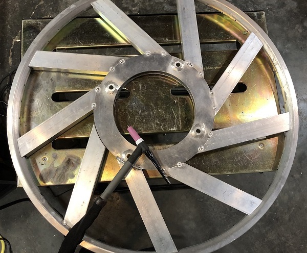

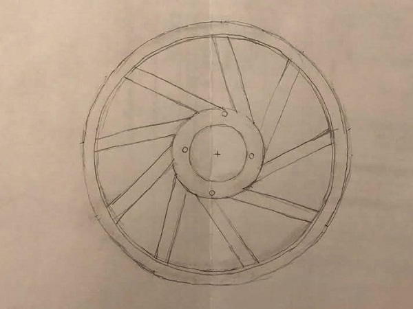

I have a 24" Nimbus Ultimate Wheel, but wanted to have a 36" one. Modeled after the wrinkles of drag racing car tire, the spokes are laser cut from 6061 aluminum rectangular tubing. To overbuild, both hub (also laser cut 6061) and spokes have a wall thickness of 1/8". The rim is donated from a Coker wheel.
I originally tried to hire a welder to weld them together for me but after two welders failed me I learned welding aluminum and did it myself.
Two pairs of pedal threads have effective crank arm lengths of 150mm and 137mm respectively.

Nice job on the UW. It is good that you have the spokes angles as a dragster wheel so you know what direction to ride it. Other wise you’d have to label or mark it in some way so the pedals would not be tuning backwards.
What kind of welder did you use?
Yes, we need photos/video of it in action.
Jim
I used a Lincoln Electric Square Wave TIG 200.

WOW 3d cutting laser great!
Thanks lobbybopser! Actually your suspension unicycles are a real inspiration to me (and thanks for answering my questions). I am planning on copycatting you suspension uni and are currently collecting parts :wink:
WRT the 3D laser cut parts, I initially tried to manually cut it myself but the lack of skill/tool made shoddy parts.

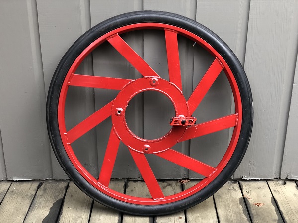

Here is mine:
I enjoy it tremendously, much more fun than the 24"

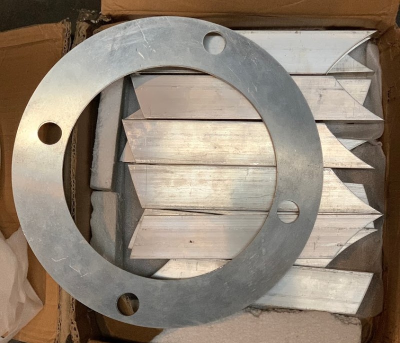

UW parts for sale
I ordered enough parts for two UWs and now the leftovers are up for sale:
  1. 11 spokes (3D laser cut from 1"x2" 6061 aluminum tubing, 1/8" wall)
  2. 2 piece hub ( laser cut from 1/8" thick 6061 aluminum plate)
$330 OBO.
Additional parts needed to build a 36" UW:
  1. a 36" rim (the parts fit Coker aluminum rim perfectly)
  2. 1" OD aluminum tubing cut to ~1-1/4" long (need 4) to fit in the holes of the hub pieces for pedal thread
