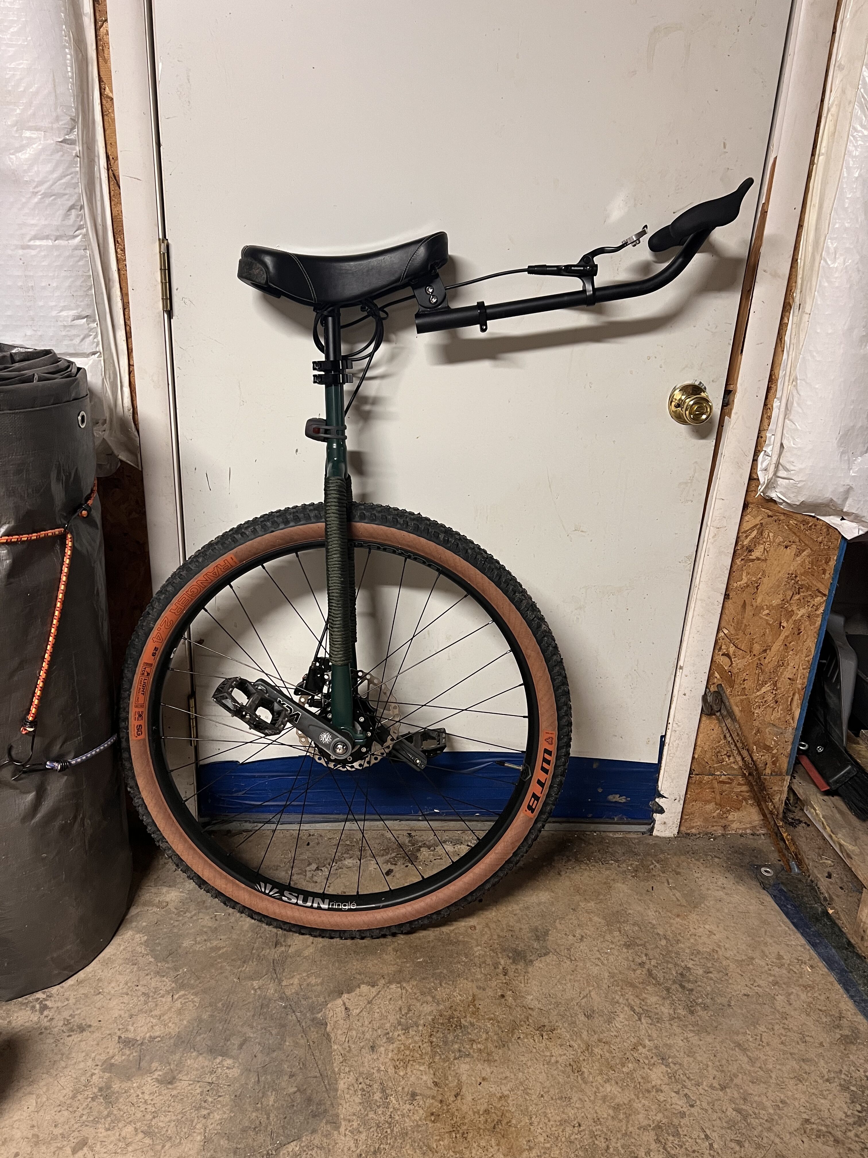

So as someone who was looking at the same thing I got some advice from Jakob. V is for sprinting like a time trial bike, and P frame are good for having a handle you can put some bags on.
I currently have a 4kg 29" build I use for Unipacking. It’s not anything custom but I found the smaller handle has made me really lose interest in making a custom frame due to weight at the end of the day. My KH frame is 680g and I really notice the weight difference coming down from a stock unicycle that might be 40-50% heavier.
For trips too I’ve put my money I would have spent on a frame on fancy backpacking gear, got a 450g Gossamer Gear Kumo 36 and the bag itself weighs as much as a single bike rack and can comfortably carry up to 25 lbs or so. Just a consideration as you decide where to put your money
@Rebekka (I think I have the right account) just did the European divide trail and I think they’d have a good perspective though.
I’d say go with the frame that reduce how upright you sit on the uni, drag/air resistance will have a bigger effect on your speed as I find you tend to get adjusted to the weight of your equipment. The more you ride the easier a heavy build gets to push.

I have a very simple and not too expensive solution I would say. I just got a bike seatpost rack and a version of a KH t-bar made out of steel by Jakob with standard T-piece.
For the front I designed a square bag and my mum did the sewing. For bags in the front in general it has to be taken in account that they can’t be too wide because you legs will be in the way. Moving your legs outwards will most likely result in knee pain.
What I like about my setup is:
  • it offers a huge varion on handle bar angles
  • it packs down very small (good for flying)
  • it is stable enough for unipacking (but if you want a aero bar, I would recommend a P or V frame)
  • it is light
  • the uni can be used with way shorter handles for other purposes
  • a seatpost rack can be found in lots of bike stores in case it brakes (my first showed cracks after 7000 km of in multiple trips, but replacement on the road was easy)
But this set up definitely needs a unicycle seat.

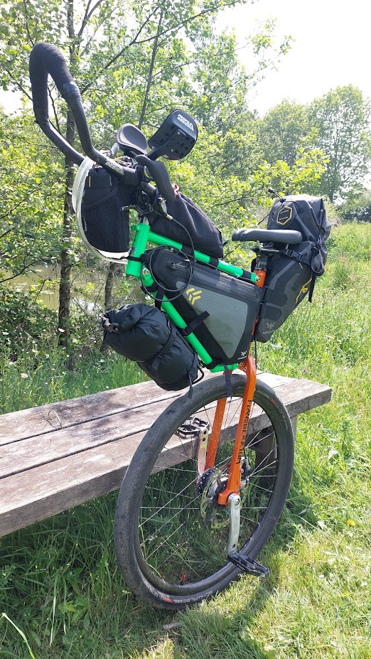

Hi PJ! Here I’m posting the answers I gave you in PM before opening your topic.
My 36 V-frame was made for speed, for racing. It’s not very practical for touring. I used it as inspiration for my 29" touring frame. Which is really good for touring. In particular, it allows you to use a frame bag and have rigid handlebars (and a bike saddle). This optimizes load distribution on the unicycle, and greatly improves comfort.
I’m currently hesitating to remake a 36" version of this frame, but I wanted to make a compromise between touring and speed. But if I were to make a 36" frame again, it would be more of a speed frame, an improvement on my first 36" V-frame.
You can use a V frame for touring, but you’d need a different design, with a higher horizontal top tube to mount the frame bag. And you’d need a custom-made frame bag.
For touring, I much prefer the P frame design :grinning:
In my opinion, the P frame has nothing but advantages over the V frame. The frame’s rigidity is very good, and it’s easy to attach lots of standard bike panniers.
It seems to me that this is in line with other opinions expressed here.
I think a V-frame allows a lot of possible adjustments, but if I were to make a version 2 of my 36" V-frame, it would be a P-frame.
For a P-frame, it’s the position of the horizontal tube that’s crucial. The higher the tube, the more space there is between it and the tire. But you don’t want to risk ending up with your toes on the pedals and the handlebars too high…
The P-frame allows you to have a central frame bag and panniers all around:
For rear luggage, you can also use a seatpost carrier or any other system for attaching panniers. I wanted to use only bikepacking packs.
The only drawback I find with my uni is the side wind resistance of the central pack. I could have opted for a slightly smaller frame bag.
Otherwise, the improvements I could make: pump and multi-tool integrated into the head tube and handlebars.
