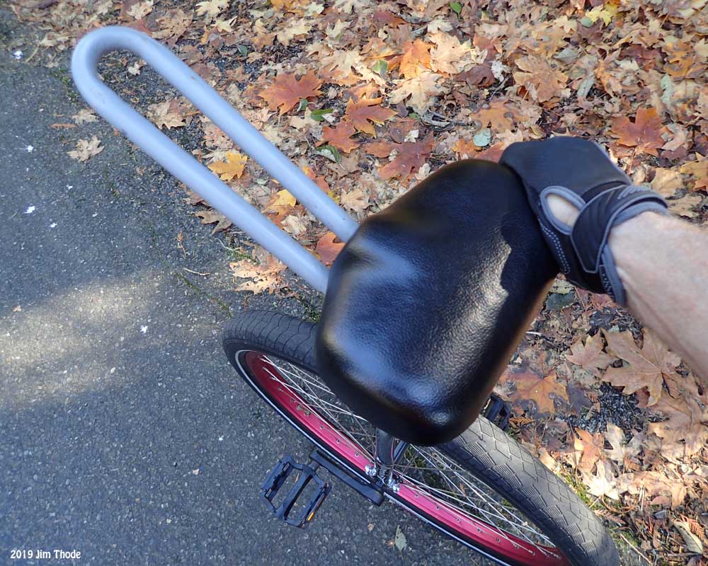

I have had a noseless saddle on my bike for ages and just for the fun of it I mounted it on a unicycle. The saddle is an ERGO The SEAT® by Lycra Gel Saddle
I first tried it with only a handlebar and it was very comfortable on the butt however it required quite a bit of force pushing back on the handlebar to stay on the seat. Overall on a 2 mile road test it was not that comfortable to ride because of the strength required to stay in position.

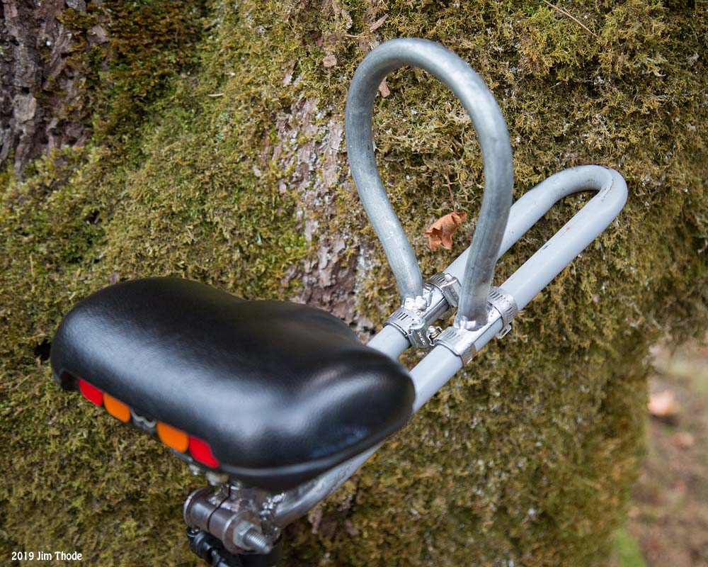

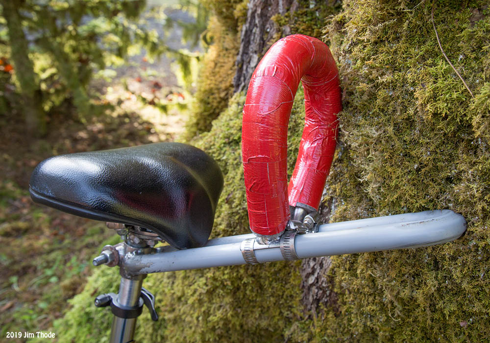

Next I added a “Groin Support Bar” to hold me back on the saddle. I rode about a mile with no padding on the groin support and is worked quite well. I then added some padding on the groin support and adjusted some so it fits correctly. On an 8 mile road test on the 29" uni it preformed very well with no adverse effects and no need to “rest” my butt as needed on my normal unicycle saddle. (Actually my normal saddle on my 36er is quite comfortable but just have to take a minute or two break or peddle standing up for awhile ever few miles on longer rides.)
It is a little cumbersome to free mount the noseless saddle because I have to get the uni vertical, swing over the wide seat and work vertically down between the saddle and groin support. I’m not that good at mounting smaller unicycles anyway but not a big problem either. It is quite secure once in and dismounts off the front or back don’t seem to be a problem. At first I wondered if I’d be locked in the thing but that does not seem to be the case.

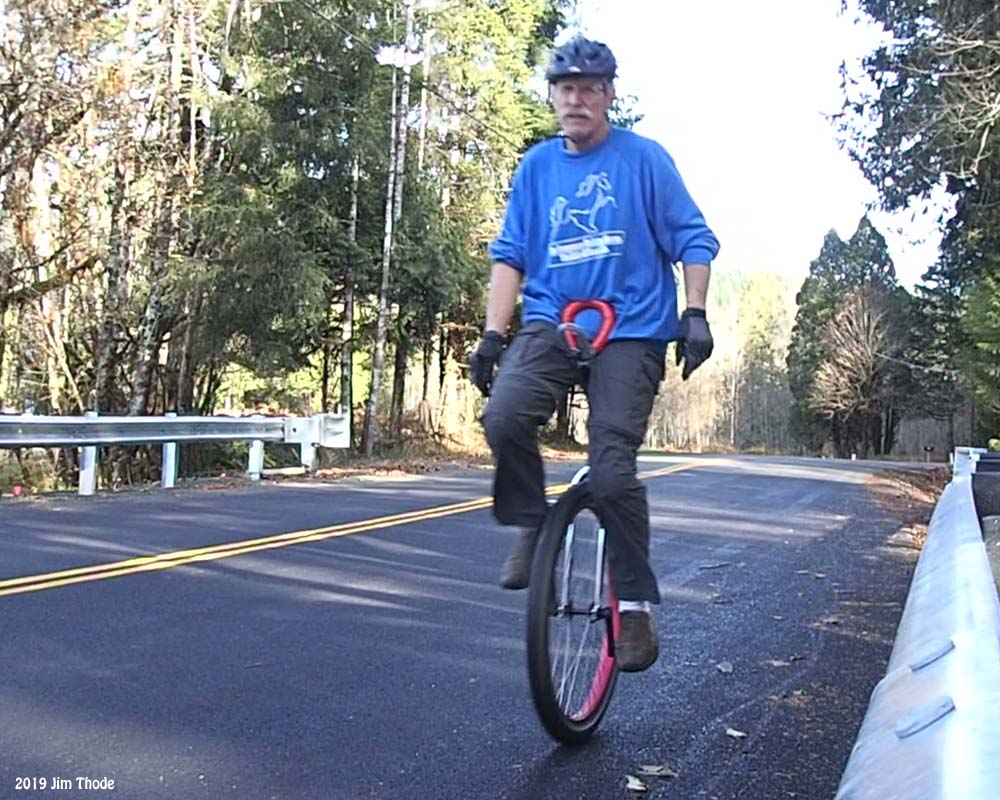

First Road Test:
With Groin Support Bar:
8 Mile Road Test on 29":

The rider connection between the seat and uni is more secure/fixed then a normal uni seat. I can not move as much independent of the noseless saddle as I can on a normal saddle. I don’t know if that is good or bad. It is easy to ride but may not be able to do a really tight turnback as a normal saddle.
The saddle surface kind of looks like it is tipped forward but the base where I sit is really tipped back a little. There are also cups in the base where my sit bones fit in the saddle. Without holding back with a handlebar or the groin support bar I don’t believe this noseless saddle could be ridden on a unicycle no matter how the seat is adjusted. I can adjust the tilt just as a normal 4 bolt saddle by adding shims if needed.
The gray tubing on the handlebar was from some recycled refrigerator tubing and already shaped like that. The “Groin Support Bar” was shaped out of some 1/2" electrical metal tubing using a makeshift bending mandrel like this:

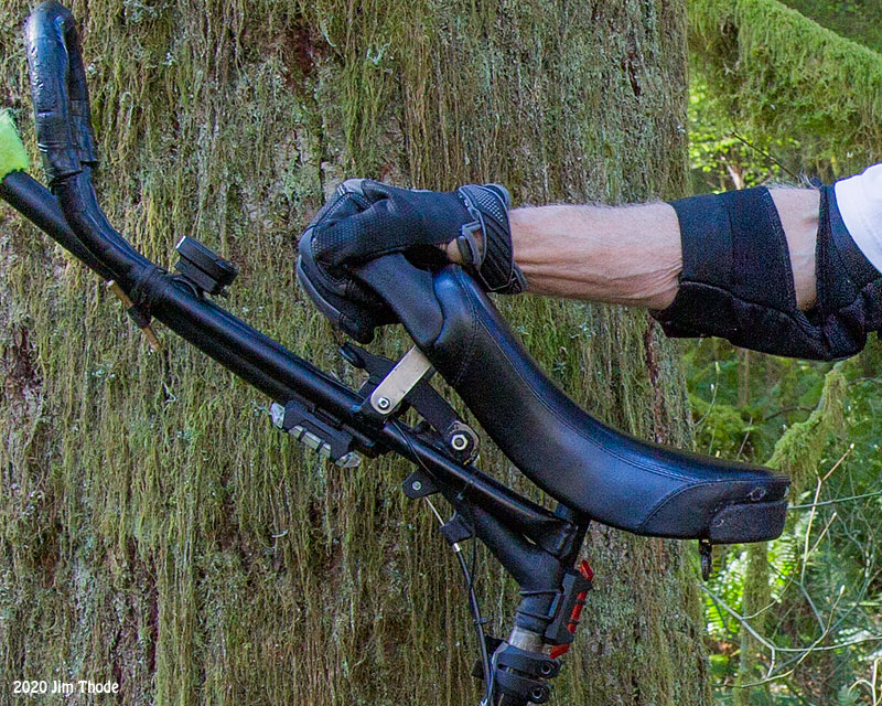

An update, I installed the noseless saddle/handlebar on my 36” Coker. I’ve put about 20 miles on it with 14 miles in one setting. In general it seems to be about three times less annoying then a normal uni saddle. I can go about three times longer before I want to take a short break. On a normal saddle I normally go about 3 or 4 miles before taking a short break, mostly to give the butt a break but it also gives the legs a break. On the noseless saddle I can go much longer distances before the sit bones start to annoy me. The down side of that is that my legs do not get a rest every so often and at the end of a comparable distance my legs would be more fatigued with the noseless saddle. The other thing that affects the legs is the seat height. Because of the necessary lower saddle setting my legs get more of as workout on the noseless saddle. No, I’ve not committed to change all my uni’s to noseless saddles yet.
One disadvantage of using bike saddles on unicycles is that there are no bumpers on bike saddles. A few drops could do quite a bit of damage to a bike saddle. I added a tuff HDPE rear bumper on the noseless saddle and that also serves as a “kick stand”. I also added a front bumper (the tennis ball thingy) on the handlebar so it will take a beating without any damage.
I alos added a loop hand grip on the handle bar but it is too close to my body. I need to add a longer hand grip and see if that works better for road riding.
Rear bumper as a kickstand:
Front bumper:

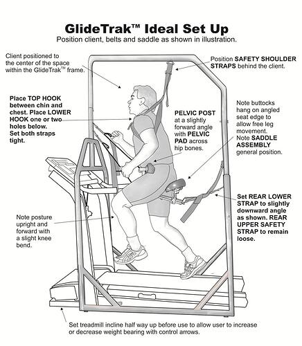

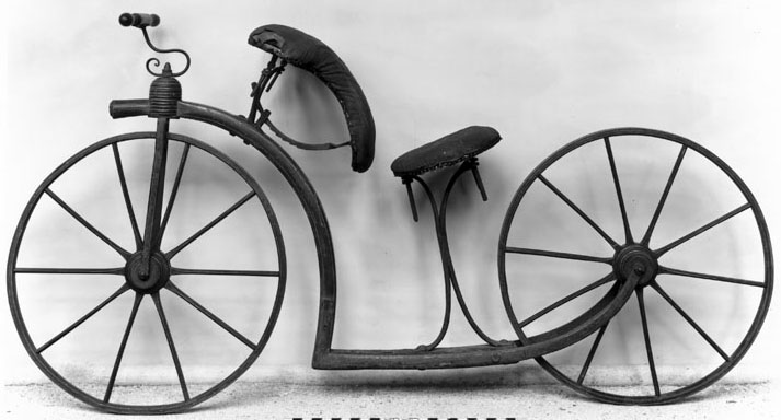

I’m still thinking of alternate ways to put more pressure on the front that would allow more free movement of the legs. Early bicycles that had free motion of the legs had a quite large front support.

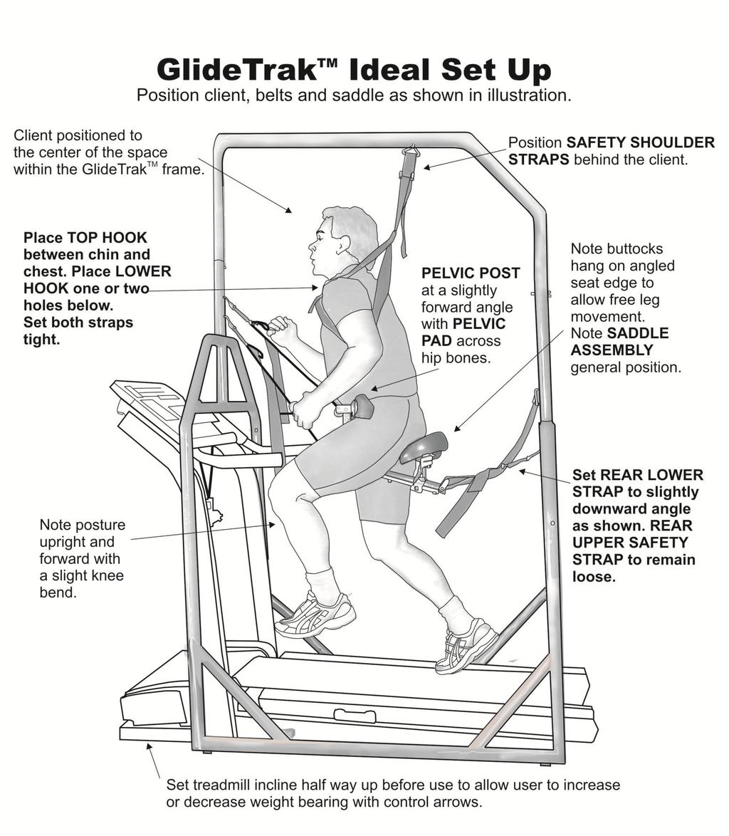

A more modern idea but along the same lines in a GlideTrak tm support system it has a larger front/pelvic pad support then my noseless groin support and allows free leg moment.
The bottom line is that you need some kind of front support to hold you back on the saddle and sit bones. That may be push back from a handlebar, a normal uni saddle with some weight on the crotch, a groin support as on my noseless saddle, a pelvic pad as on the GlidTrak or a full belly support as on the first bicycles.
