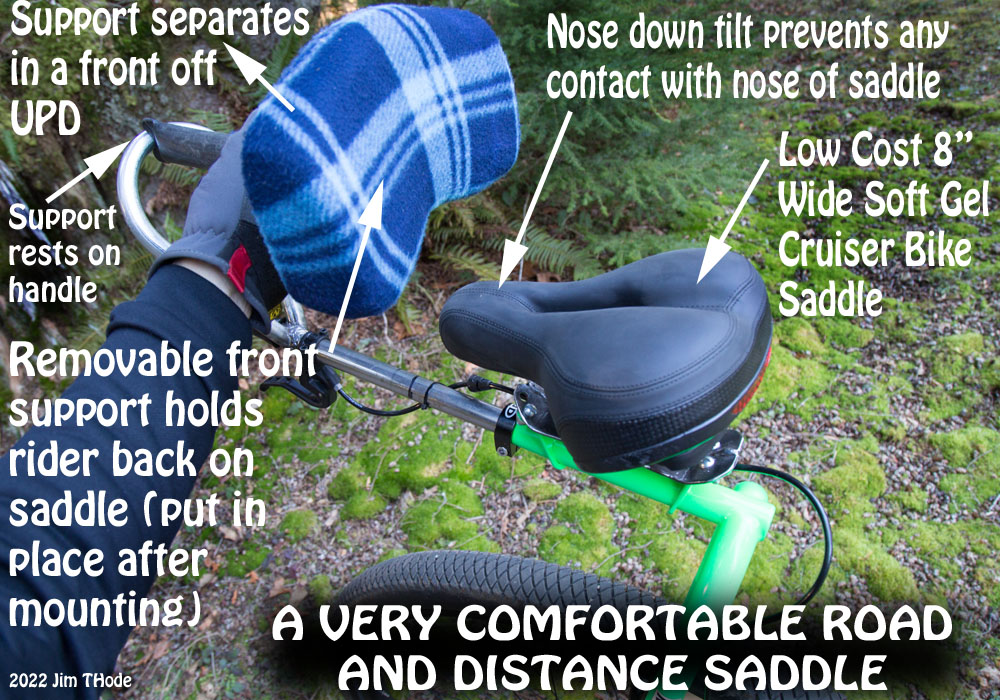

What is it like riding with your hands off of the handlebars on a bike saddle?
I would assume it’d be hard to stay grounded and you couldn’t really make adjustments as easily.
I ride regular bike saddles on my Unis and while riding hands free is doable in general I avoid doing it as it does not feel safe as you lack some control.
My saddles are also setup with an angle that is optimal for a riding position that is bent forward - kind of how you would ride a regular hybrid/city/sports bike so if I balance my unicycle in a upright position I slide forward on the saddle. Maybe it is different when the unicycle is loaded with camping gear?
If you practice and make the proper adjustments I’m sure you could master riding hands free on a bike saddle to relax your hands but I would rather focus on a handlebar setup with two different comfortable positions.
You can ride with hands off the handlebars if the bike saddle is adjusted with a nose up angle but that is not advisable because the whole idea of a bike saddle is to eliminate the pressure on the front and put all the load on the back (sit bones). The nose really needs to tilt down a little and that requires hands on handlebars or some other support to hold you back.
By this I mean that I found myself able to let my hands off the handlebars without feeling like I was struggling or sliding off the saddle.
When you’ve got all your weight behind you, even with a unicycle saddle, if you take your hands off the handlebars, it’s almost impossible to stay on the unicycle.

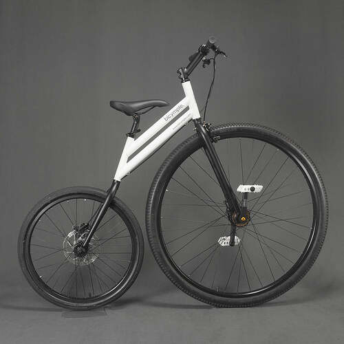

BISYMPLE has a design I like, so something like this with adjustable saddle height but also doing a 29/20 instead of a 36/24, the Hopley 29" isn’t super monstrous from what I’ve seen but in def going to have to come up with some drawings and designs for it and do some reading on the physics involved
Or something like a pframe but having the 20" wheel in the front to give some stability and let met lean forward with some support
Practically it might just end up being a P frame for reduced weight and cost.

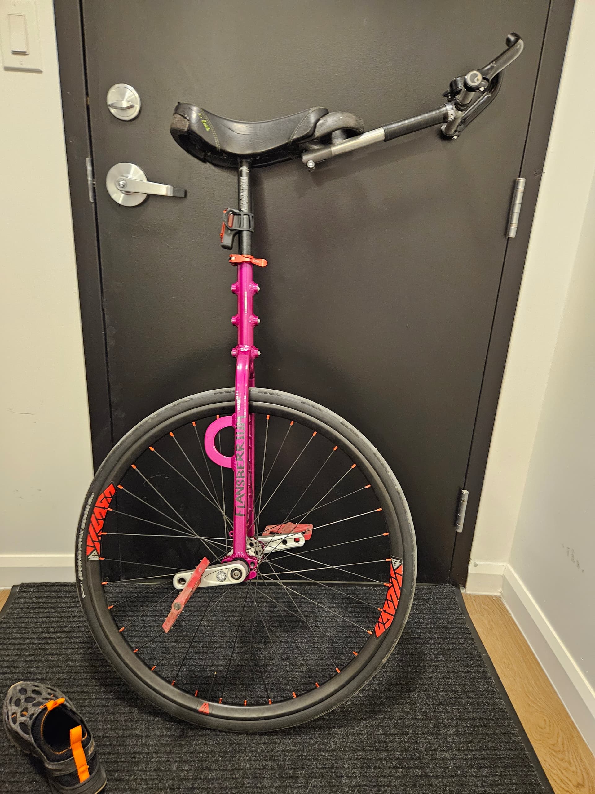

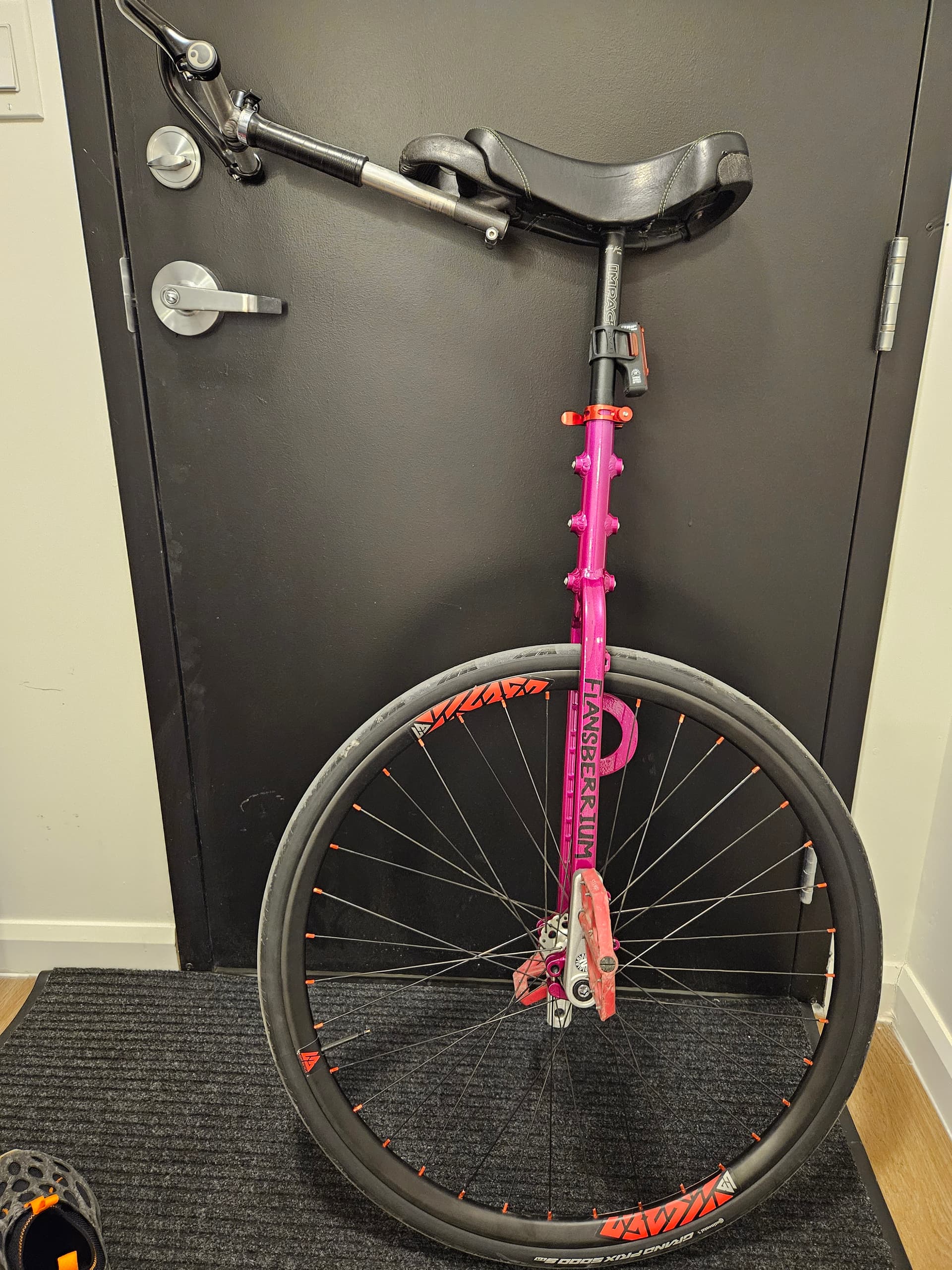

Reviving the thread because my build came in.
But an alternative for touring, handlebar and cargo cage mounts. This whole build is under 10lbs/4.5kg, and even with a gravel tire it would still be a reasonable weight. If it’s too squirly you can always just add weight to the frame to increase stability.
I have long legs so this build works very well for me, shorter riders may have a harder time but I think it’s doable for most people who don’t ride 100/75mm on a 700c lol.
If you want/need to increase the stability add weight to the wheel rather then the frame. A heavier wheel is more stable and less twitchy.

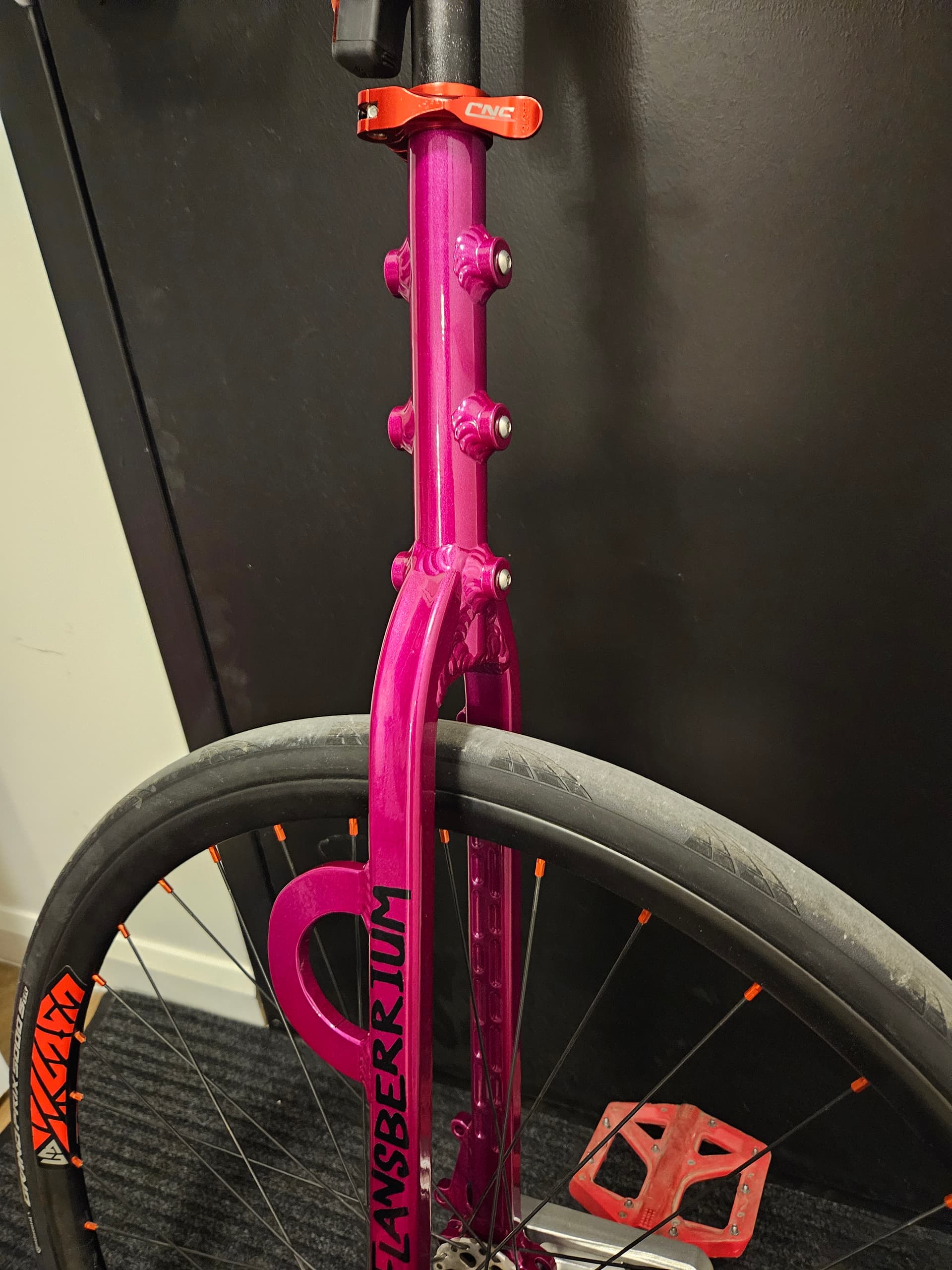

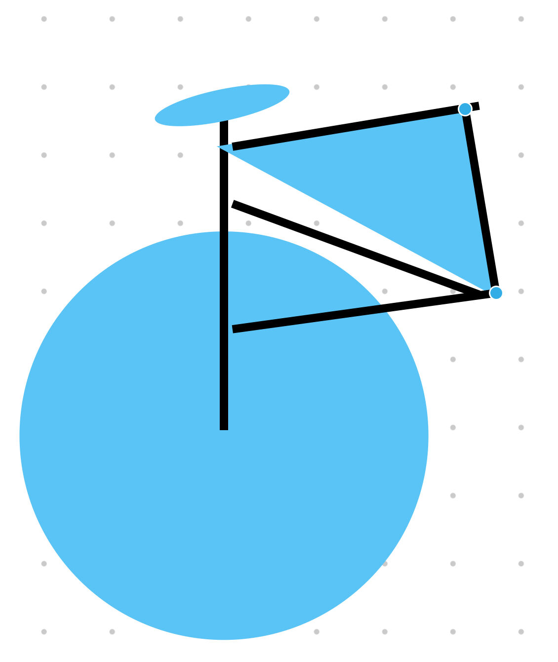

Here’s my early days work on a P-frame or…. should I call it the B-frame… in fact I’ve currently dubbed it The Flans Flag Frame :canada: :switzerland:
And here’s my childish drawing for you all to have a good laugh at!
I literally did this in 10 mins so better ideas will come up - more to scale as that wheel is meant to be a 700c but it looks more 36er ish.
Here’s the linking to the rim and tyre debate that’s been annoying picking Simon’s brain and past work in this space:

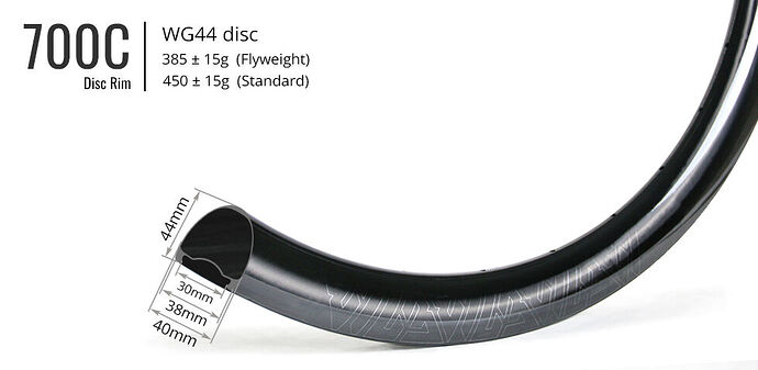

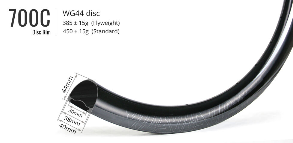

I think my soul is saying get the WG44 as I learned from reading the French forum I can ask LB to drill spoke holes off centre to get a faux asymmetrical rim set up and my spoke tensions on a 32h Schlumpf hub would be 100%/53% which is more acceptable for me.
WG44 Disc Carbon Gravel Rim - Light Bicycle
WG44 - 700c carbon ultra-wide gravel rims of 30 wide int 38 wide ext 44 deep. For (tubeless) tires of 32c-70c. Made for big elevation and off-road pursuits. Light as 385g.
  • It’s a gravel rim
  • 30mm inside width
  • Hybrid Hooks
  • 700c
  • Tyres 38-70c - so in other words “fat” wide gravel
  • They even quote decently high PSI for 38c
So the boxes ticked by the WG44 pretty cover all I want as I’m after a tough, stiff and gravel focused touring wheel where I’m not super focused on it being the lightest wheel.
I also think any downsides of the rims aero nature - will be minimal as the bags and my body will be the biggest wind catch that can’t be taken away. And perhaps (I will have to see) I’ll get more power transfer from the somewhat deep rim.
I have also asked Jakob to what design he’d come up with if this was his P/B frame as I’m willing to entertain the idea of getting bags made. However being the copy cat I am I’d prefer to use the bags from the P frame used again by toutestbon :gear:
There is a possibility I may merge the childish design you see above with this fantastic frame from @Aurelien
In some kind of Flag + MiniFlag type imbalanced affair :joy::gear:

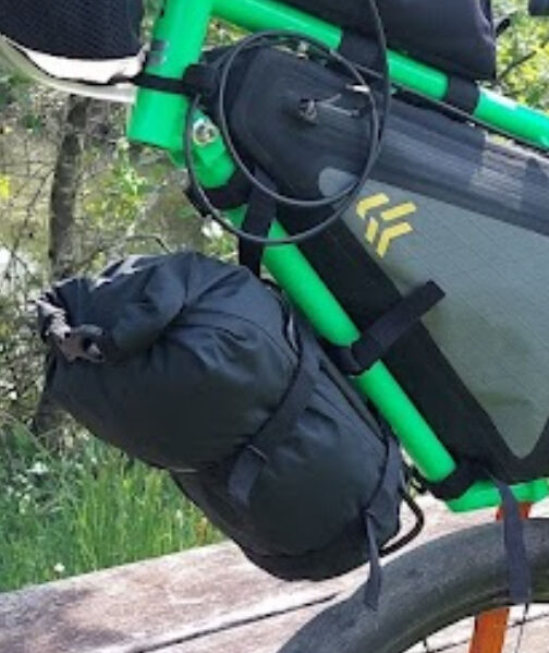

Is the bag you have shown here - attached via a rack / cage that goes on via bosses?
(And incidentally what bag is that?)
I am 99% going to kit my build out with Restrap’s Race line of bags as they seem very light weight, a good balance between capacity and minimalism - where at a pinch I’ll be able to take a small tent and light weight camping gear should I wish to.
With Restrap’s custom frame bag design service the main bag can be designed to fit the frame - which makes the designing of the frame easier as it is being made according to my height and general desires, rather than to fit one bag.
