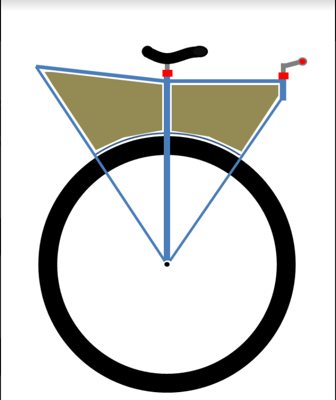

At the same time, I saw the @toutestbon custom uni, and after a bit of thinking I drew that:
The idea was to have two “triangles” in order to put bags in each one, with a handelbar in front.

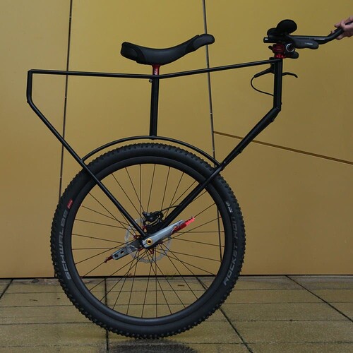

I also contacted a french frame maker (menhir cycles) wich was able to make similar prices than Jacob ones including delivering from Canada to France. After quite a bit of discussion and a meeting, he made that wonderful frame with a few advices from Jacob.

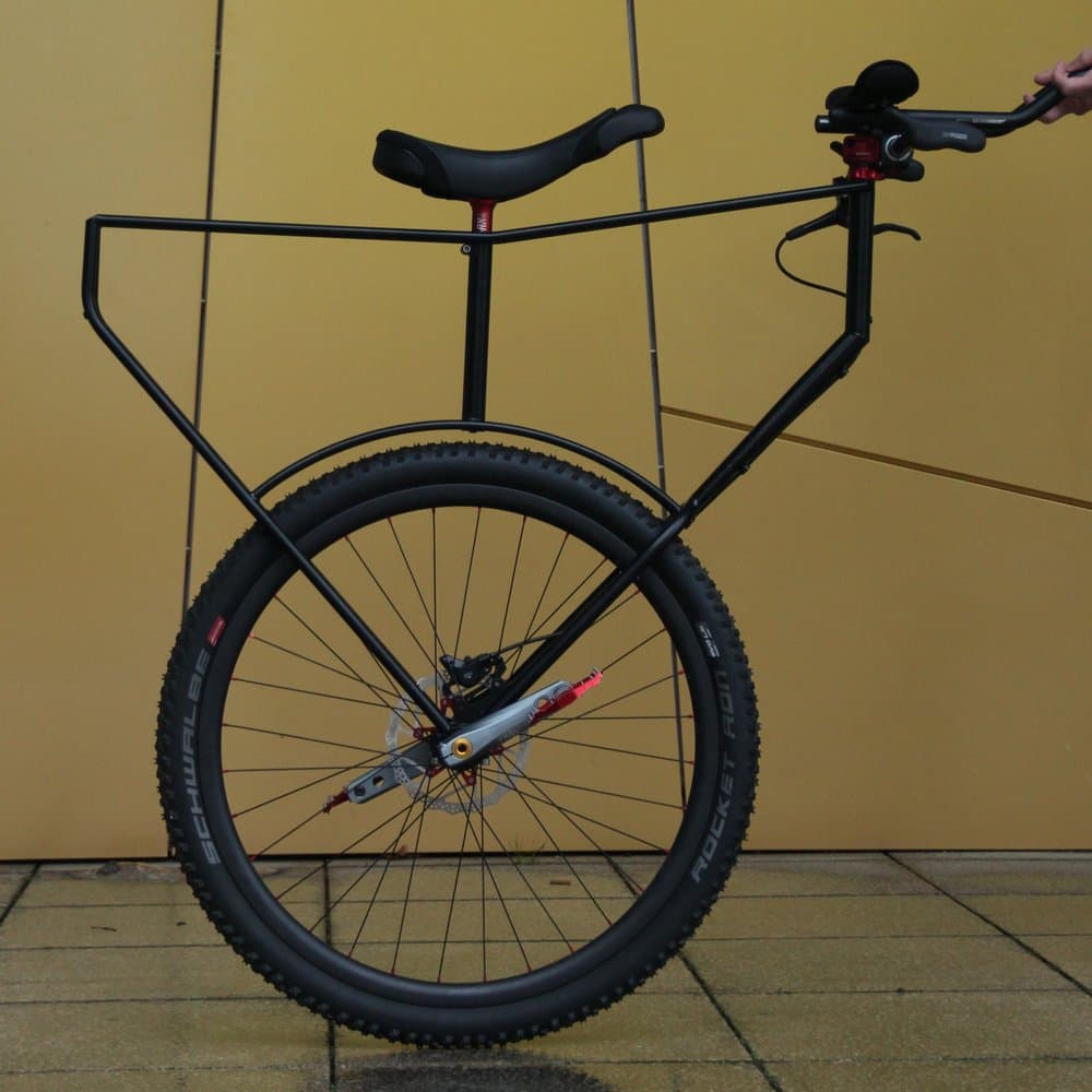

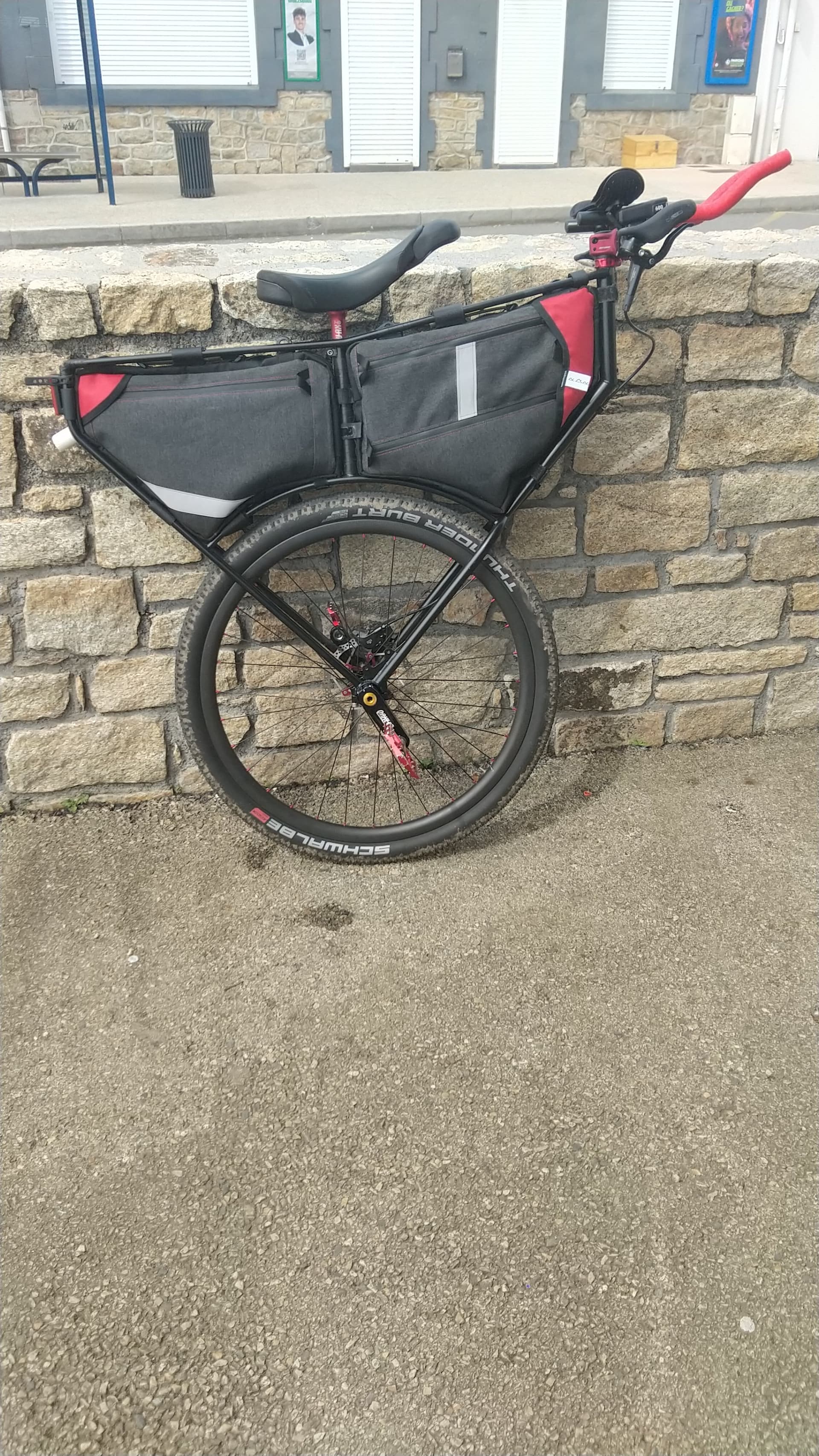

And around christmas, I received this wonderful uni:

And I have to say that this uni is just wonderful, very stable, not too heavy, really comfortable (even if the saddle is a bit firm for really long rides), and I can carry quite a lot of stuff (gaz bottle, stove, a few clothes, a hamac and a sleeping bag) without having weight on my back (just a camelback with cereal bars, water and a spare inner tube.

Are the stripes on the rear of the frame painted or cordage or wire? Looking at your first picture I initially thought you had used rebar to construct that part of the frame, which didn’t make a lot of sense to me. Glad that isn’t the case.
Edit: Never mind. It appears to be some sort of optical distortion on my tablet. When I open the image and expand it the lines go away. When I expand it within the thread the rear section appears to have stripes.
That is a thing of beauty!

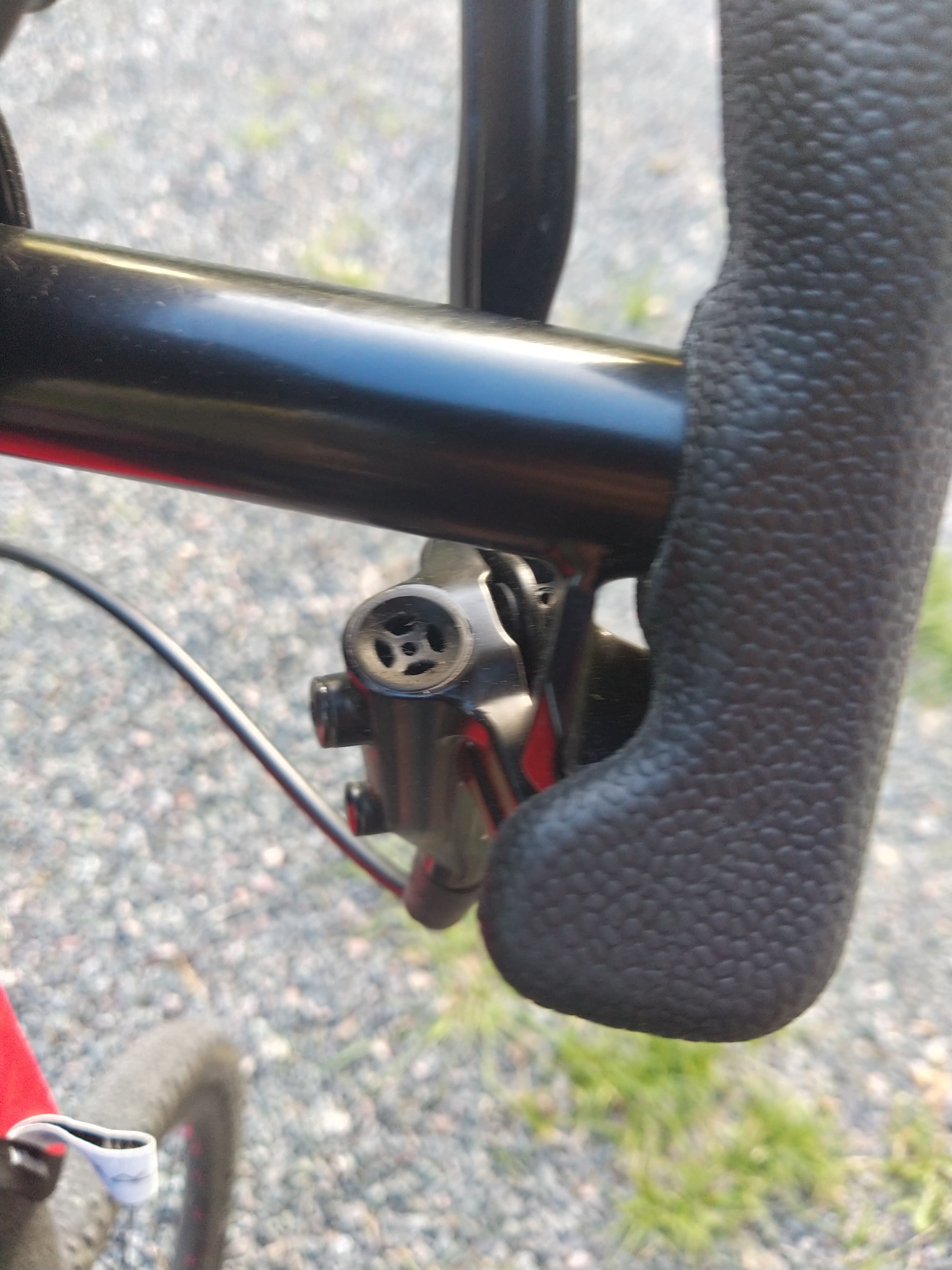

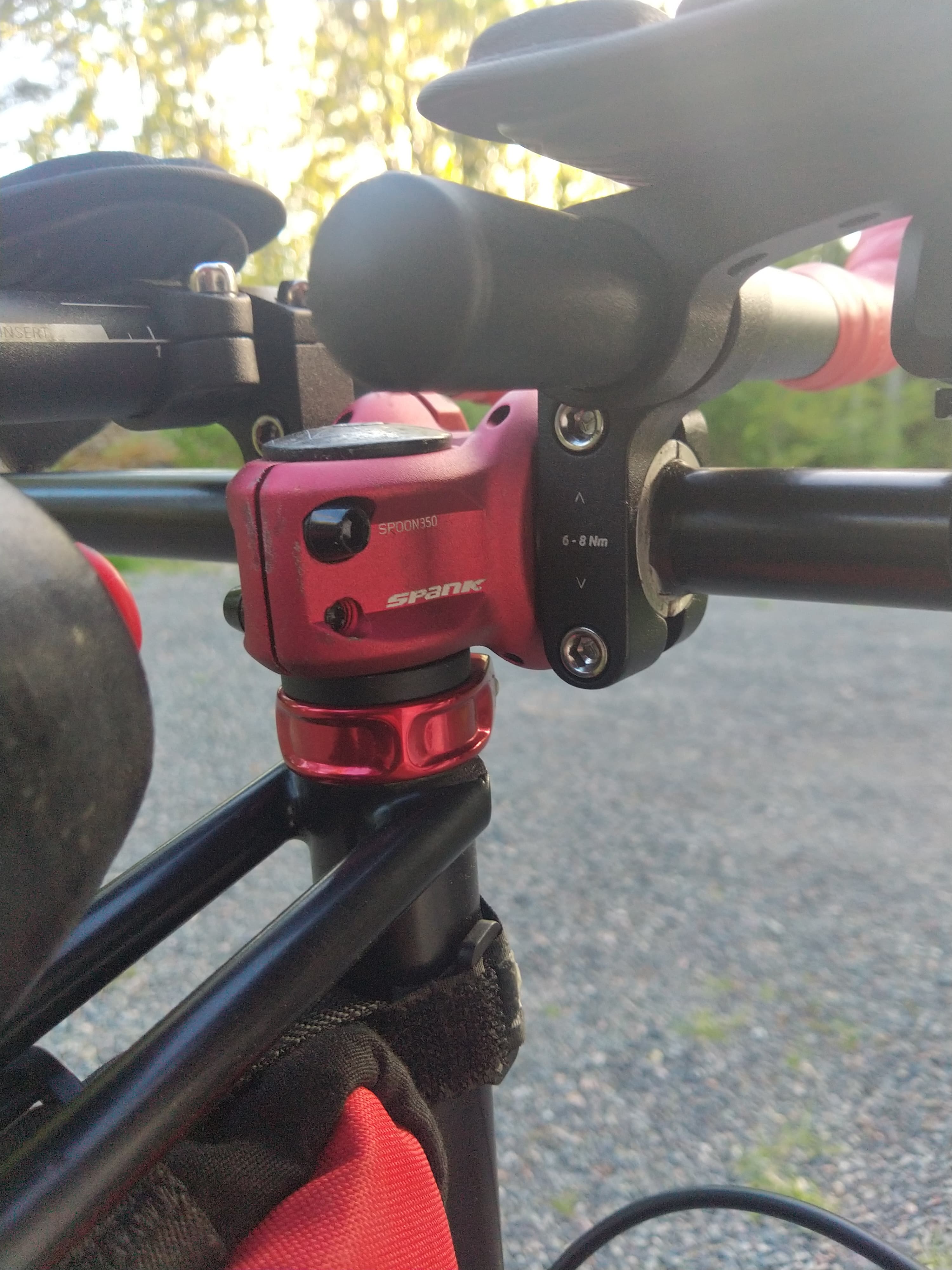

Any chance of a close up of the handle?
There you go:

Wow! That is impressive. The arc frame piece in place of the traditional forks looks so ingenious. For me, I like the aero bar setup with the handles protecting the elbow pads.
Yes it is really a wonderful uni, with nearly no downsides. The single problem might be that it is quite tricky to mount on because of the weight of the frame, but all the rest is a dream.

I presume this is all with steel? And it looks very ridged - no flex at all?

Yes, it is all steel, but there is a very little bit of flex (not really sure, but it might be possible).

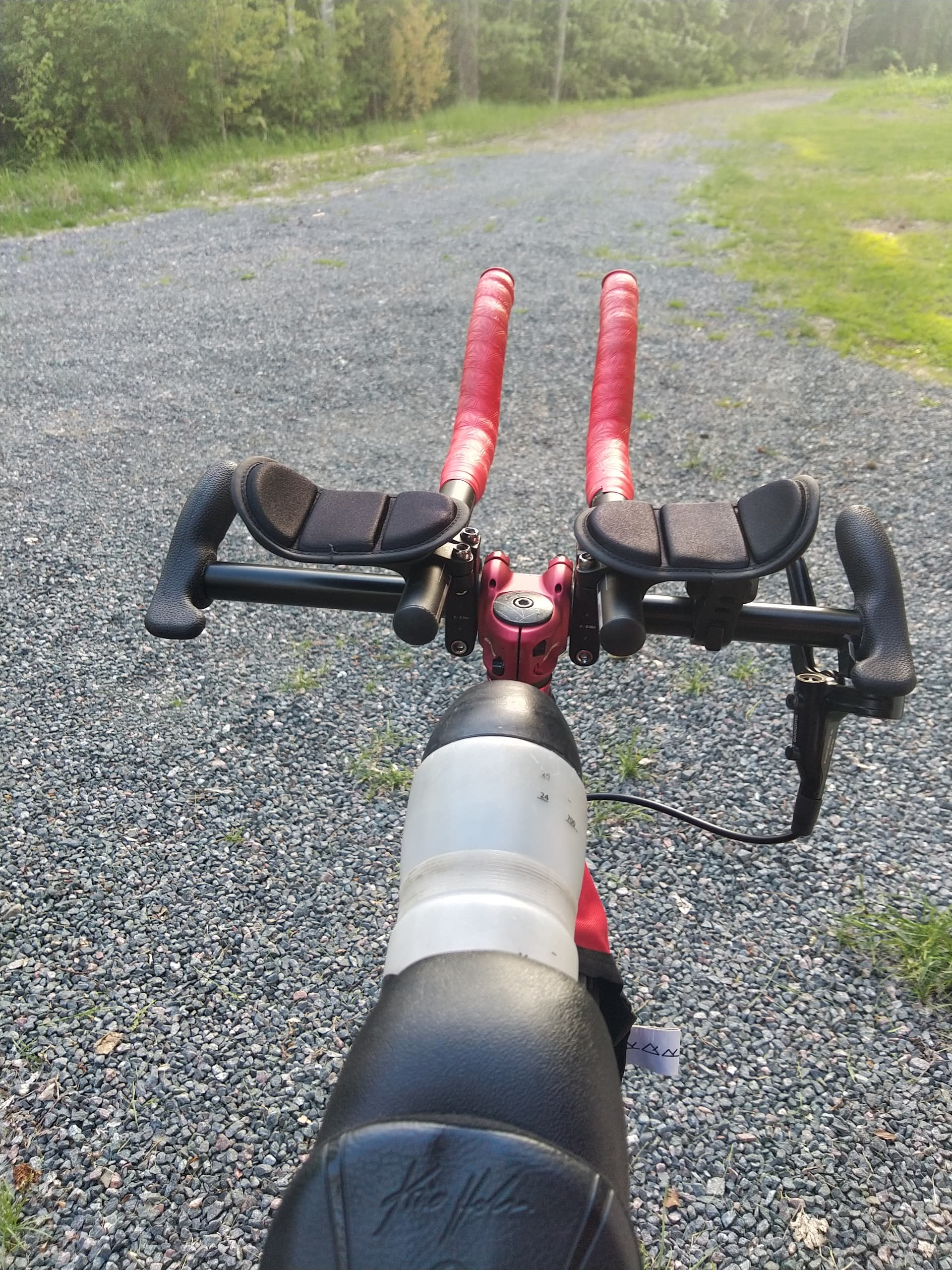

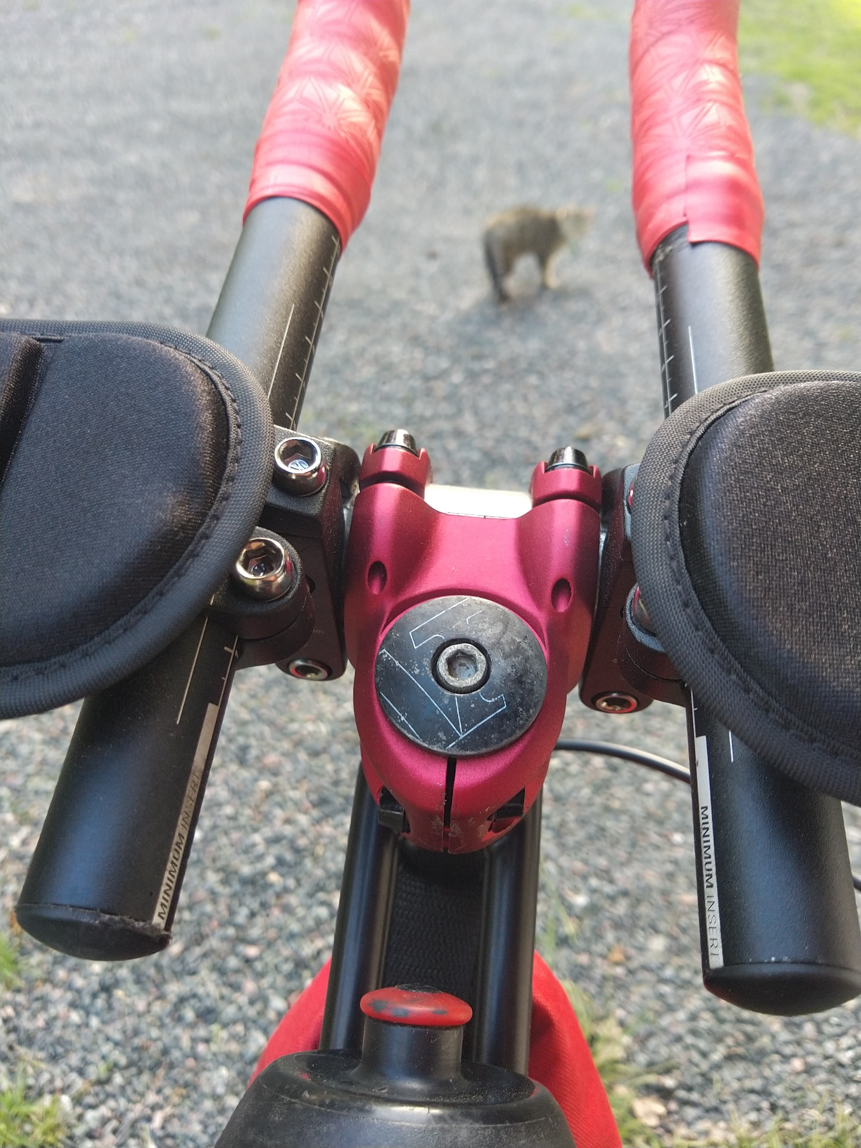

Oh, I just remembered a funny thing. When I received my uni, the handlebar was reversered, so I had the brake far and on my left hand, and I was quite disappointed. And I had a feeling that it was really very large. I figured out quite fast that I could reverse the bar to have a brake really easy to access and on my right hand, but the large bar felt really awkward. After a few hours riding it however, I discovered that a larger bar allows to control a lot better the lateral torque, which is just wonderful when turning. Due to that, when I have to to turn, I go from my aerobars to my handlebars, and back to the aerobars right after. It also allows me to fight lateral wind way more effectively.
I like the idea of this frame, I think the idea of building something to meet the need is better then trying to modify something. I have two questions.
  1. Looking at the configuration of the frame and how it supports the riders weight I would expect there could be some vertical flex in the seat post when loaded with the full riders weight. I would think that a little flex here would be a good thing and help to smooth out the bumps in the road. Of course too much flex could cause problems with permanent frame defection, frame fatigue and in the worst case causing the bottom of the seat post to contact the tire. Have you measured the flex with the full riders weight?
  2. Looking at the relatively wide width of the handlebar I’d be concerned about catching a leg during a front off UPD. How many off the front UPD’s have you done and if any, does the handlebar width cause any problems?
I think that there might be some flex, but I haven’t ever measured it, and it must be really very low. The seat post is held in place by four tubes (2 on top and 2 at the bottom), so it is quite stiff.
For the width of the bar, I have done something like 3 UPDs since I’ve got this uni, and my legs never touched the bar. I think that it is because the uni goes toward the floor, so I must go over.

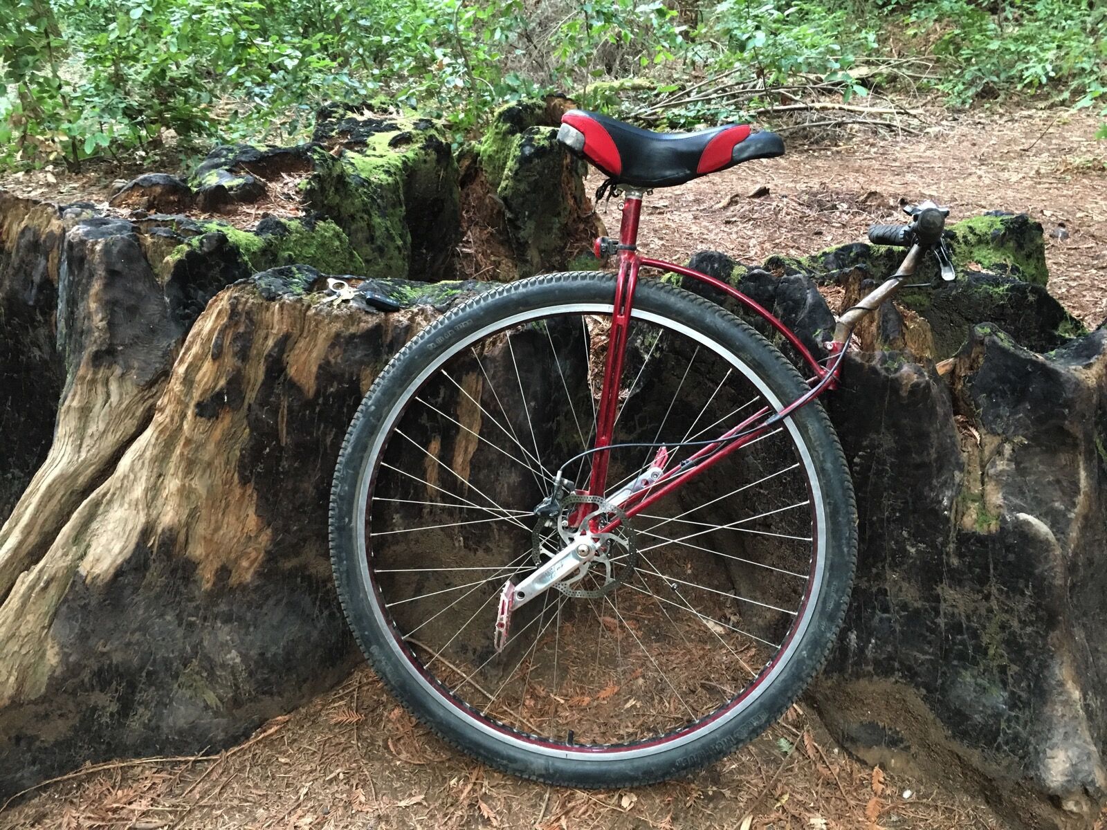

Sweet! Do you get any flex on the middle part? I’ve been thinking about a “half moon” frame for touring for some time. I just don’t ride uni’s all that much anymore.
Did you see my old V-36 frame? It is still riding solid.
Corbin
The great thing about this type of design is that you can pretty easily weld up a new version. I went through several before I settled on my favorite design.
