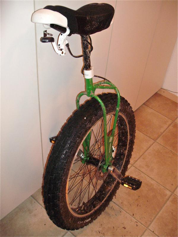

I’m sorry to say that my Oregon frame has passed away yesterday at the very tender age of only 2 months and 3 weeks.
As you can see on the pics it broke through at the end of the crown right by the little hole. There is a large crack on the opposite side at the same height too, which would have broken through simultaneously if I had been doing a drop or a jump or stairs.
I had taped the front legs of the fork in order to keep the paint unharmed by my legs so I couldn’t see the cracks before it broke.
What I did notice was a creaking sound while going uphill and downhill. I thought it was something to do with the bearings or the cranks…
So if you have an Oregon that makes a creaking sound be sure to examine the frame for cracks in that area.
Needless to say I am very disappointed that this frame has obviously not been properly tested on technical DH trails, which is what it should be used for as Roger and others confirmed before I ordered mine. So once again I have been sold something very promising and great looking that is still in the beta stage and flawed to say the very least.
Now I’m sure it is under warranty and I could get a replacement from UDC but there is no way that I could trust this frame design for the mildly technical riding I’m doing ever again. So what can I do? This is the only frame that fits this wheelset with the LM, Larry and disc brake. I don’t have the money to get a Triton frame and Mountainuni disc set either. So it seems I threw that money out the window unless there will come an improved frame as a replacement from Nimbus.
By the way the Oregon came with a 160mm disc which didn’t fit properly so I had to remove the left bearing to be able to remove that disc and replace it with a 180mm one. Of course I also had to file off the edges that were left on the brake pads from the too small disc. And I could go on and on about my attempts of bleeding the brake and all that but who cares. I spent way too much time and money on this piece of crap now and I am now left with a broken frame and no good options in sight.
One thing is clear though: This frame is NOT fit for actual muni riding as I understand it. It should be pulled from the UDCs and redesigned with stronger and thicker tubing. The way it is now it is very dangerous and way underbuilt.

The thing is I don’t know how this could be a manufacturing fault rather than a design problem? So how could a new frame with the same materials and proportions be any different from this one? I would be very worried about it breaking in the middle of a great muni ride. This could be very harmful to someone else in other circumstances (which is why I am posting this on the forums right away rather than sending e-mails back and forth with UDC and MDC).
My own conclusion is that the front legs must be too thin to withstand the strong forces that come into play on rocky muni rides with occasional drops (less than 1m in my case) and UPDs. The little holes probably are where the crack started and worked itself outwards until it broke all the way as the crack on the other leg shows. Maybe if the holes weren’ there it would be less prone to breaking? One more thing that is different on this frame than the nightrider is that it is much wider at the crown, so that might explain something here.
I actually remember now when it started creaking and it was on the steeper uphills rather than the downhills. So it must have something to do with the strong forces involved when you pull on the seat and stand up cranking up the hill at full force. This may put more pressure on those little holes in the crown than going downhill.
So once again I’m sorry if I have caused any hard feelings but I really mean to help getting this problem solved and prevent people from getting hurt in an accident with this frame.
Currently I can not be sure why they have failed. lets see what the manufacturer says about it. It may be the holes and it could be the width… or a combination. The tubing should be strong enough, the nightrider should be rougher on the frame than the Oregan.

I am wondering if those vent holes are even necessary if there are ones down by the bearing caps? Could be a pretty easy design fix for the next batch if they don’t need to be there.
Yes maybe the ones by the bearing holders would be sufficient. But beefing up the tubing would be a good idea too, I think. The added weight wouldn’t matter that much. Strength is a lot more important IMHO.

I took a look at Munirocks picture of the broken Oregon frame and compared it to my Oregon’s frame. The break seems to be at or very near the vents (if that is what they are). The holes seem to be placed in an odd place in regards to structural integrity. I am not a structural engineer, but it does seem strange that they were placed at that point.
Are these “vents” designed to allow condensation to escape? If so, then wouldn’t the top of the seat post allow for this as well?
If the vents placement can cause possible frame failure, couldn’t a welded and vented plated be placed over them? In this way, the vent would be intact and structural integrity would be improved.

the holes are there so that when the frame is hardend it dosnt blow the welds. if it were a seald tube the air inside would heat up and cause the parts to deform and / or rupture which isnt good the holes let the air escape when it expands
thats my understanding of it anyway so correct me if you think its somthing else
