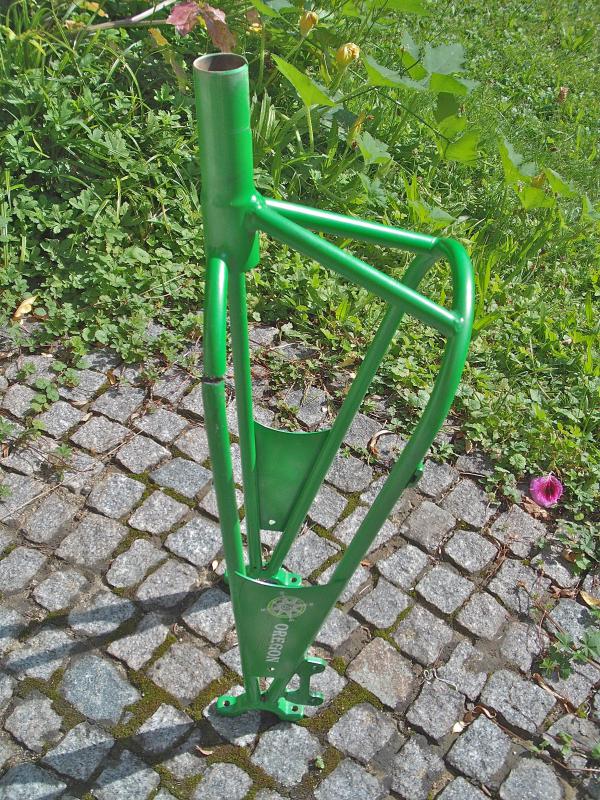

I’m sorry to say that my Oregon frame has passed away yesterday at the very tender age of only 2 months and 3 weeks.

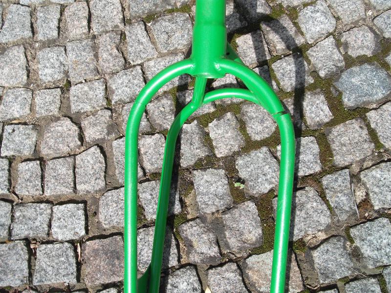

As you can see on the pics it broke through at the end of the crown right by the little hole. There is a large crack on the opposite side at the same height too, which would have broken through simultaneously if I had been doing a drop or a jump or stairs.
I had taped the front legs of the fork in order to keep the paint unharmed by my legs so I couldn’t see the cracks before it broke.
What I did notice was a creaking sound while going uphill and downhill. I thought it was something to do with the bearings or the cranks…
So if you have an Oregon that makes a creaking sound be sure to examine the frame for cracks in that area.
