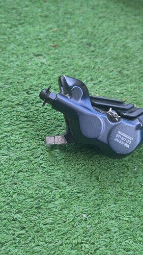

On my G36, I had a Shimano SLX 7120 brake. These last days, I have done a few cols (Col de la Chambotte going to and coming back from the lake). During the downhill parts on the road, I have felt the brake was having a strange behavior. Once I came back home, I have had a look at it, and…
I had to file it for working on my BrakeFast. I apparently put too much effort on it and it finally broke :frowning:
As I need this uni for my next challenges (training for the Mont Ventoux Unicycle Challenge on Saturday and going for a week of uni-packing on Monday), I instantly ordered a new brake. As I have felt the SLX 7120 to be too weak for such a fast wheel, I went for a Shimano Saint brake. When I tried to install the latest, it seemed to me I had to file it, too. It may be due to the geometry of the brake. The piece that is screwed to the caliper adapter is really next to the pistons and the brake pads. On the Hope Tech4 V4, this piece is a bit offset, so that there is more clearance with the disc. See below picture (I may add a Hope Tech4 V4 picture later on, so you can compare both).
So, I was in the following situation:
  • a G36 with a brake that doesn’t fit because the offset was too big;
  • a G29 with a brake that doesn’t fit because the offset was too small.
So… I switched both brakes and they now work great! :grin:

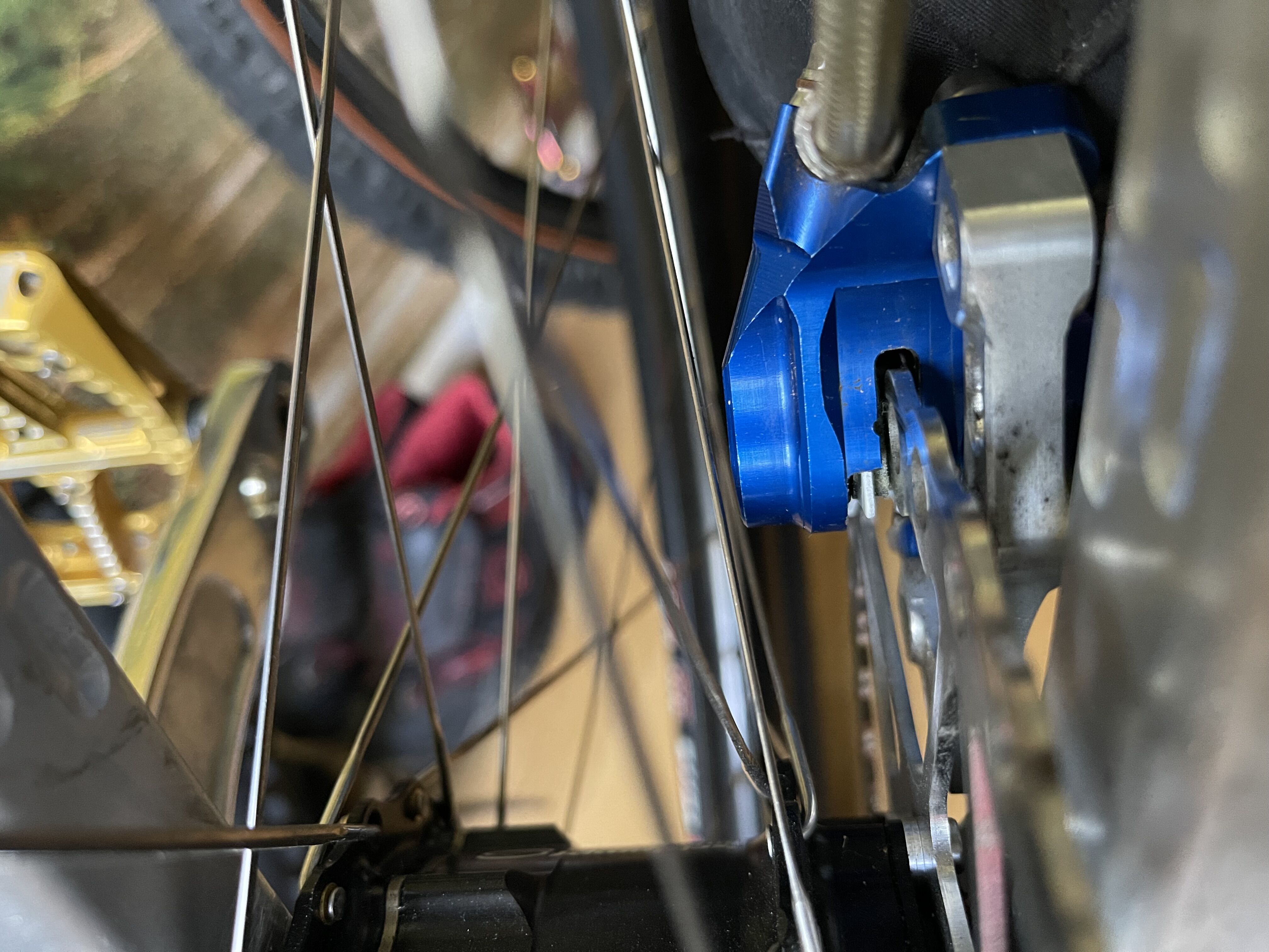

I just tested a Tech3 V4 on my G29er set up and it has a decent amount of clearance. Using 2 x spacers and CX Rays and the rim has an off set.
But still very curious to understand how the jump to a 36” wheel with the Braus rim makes this not work… unless on the newly “fixed” hubs you can only use 1 x spacers and don’t have the option for more.
Curious….
Very hard to photograph but the space feels decent and with this wheel I could go to 3 x spacers to get more room but I’d need the countersunk rotors and bolts for that.
But it’s an (3mm?) offset rim right? The Braus is symmetrical (and obviously larger diameter)
The “fixed” hub is delivered with a single set of spacers, so we don’t really have the option anymore. Here, the issue probably lies in “how vertical the spokes are”. On small and medium wheels, the spokes are less vertical than on big wheels.
The symmetrical rims may also present more issues, as noted by @Hammer.
Thanks both!
Totally - and I do get that the bigger wheels spokes are going to be trickier to get clearance from.
It’s probably more that the clearance looks on par with my E4 which seems to be a smaller caliper so it got me wondering more on “why”… but I guess even an E4 brake may not clear on a Braus G36er….
