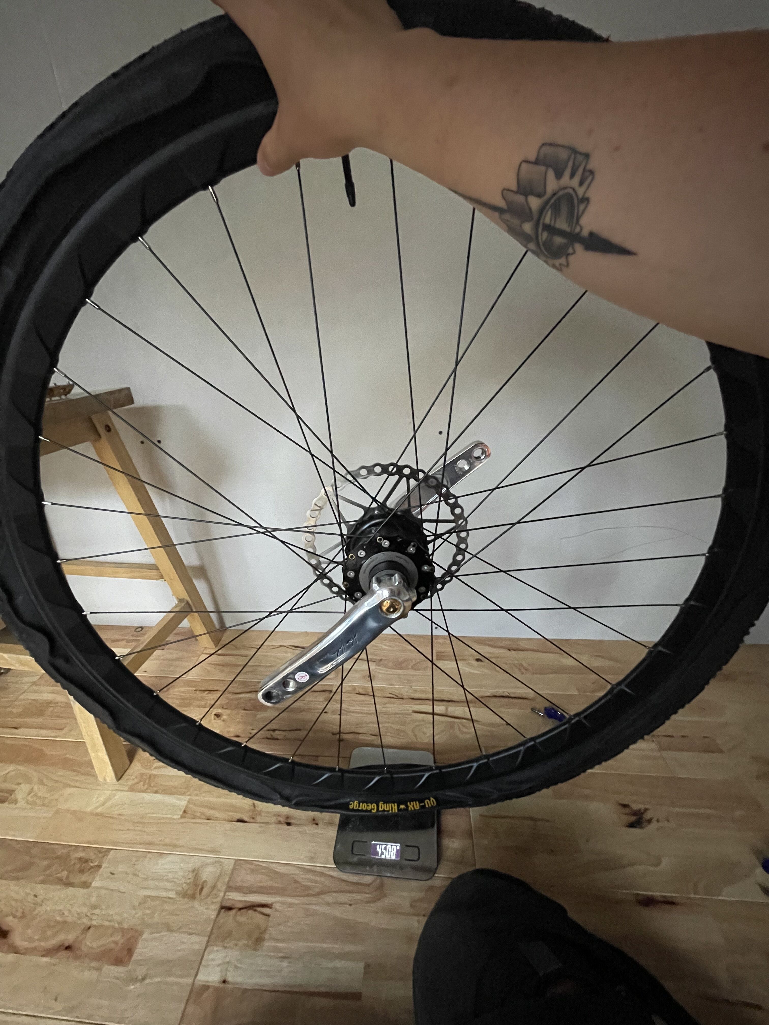

I weighed the wheel yesterday. Sans pedals so just KH 150/127 cranks:
So this is 100mm 32h, Braus Rim - TPU inner tube and King George Ultimate = 4500g~
I did this as I wanted to change the tyre to the Vee Rubber T-monster to see if it gets rid of the camber twist I’ve been wrestling with.
The KG Ultimate is a nice and light tyre. Lighter by around 200grams to the Vee tyre so I was a bit disappointed to make the call to remove it as this wheel was aimed at being speedy and road focused. I may go back to it one day. But I needed to check why I couldn’t ride an off camber section and see if it was solely the tyre causing this.

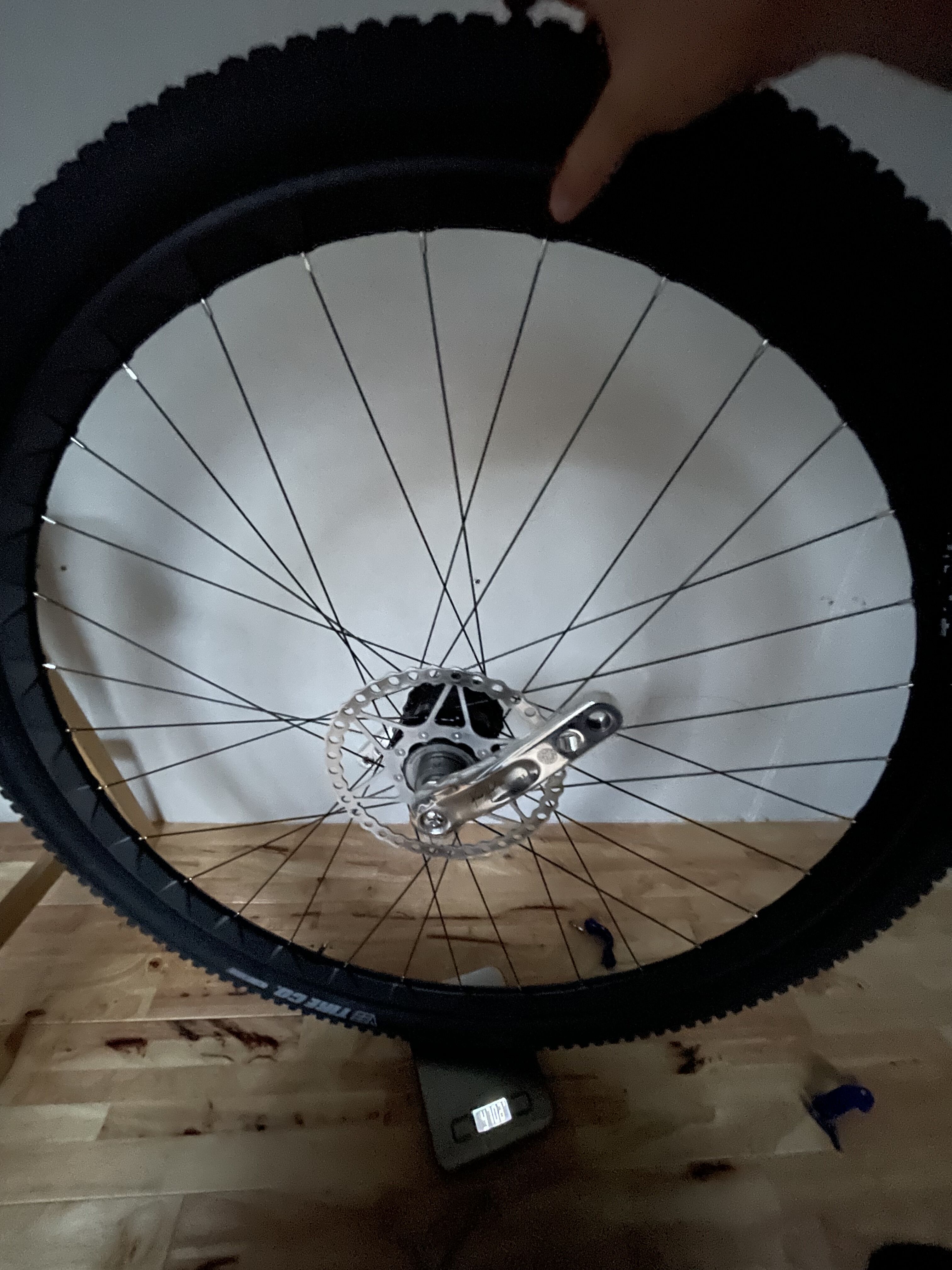

The wheel now weighs:
4700g~
So a bit of a bump but it’ll still be a lot lighter than the Dominator2 set up.
