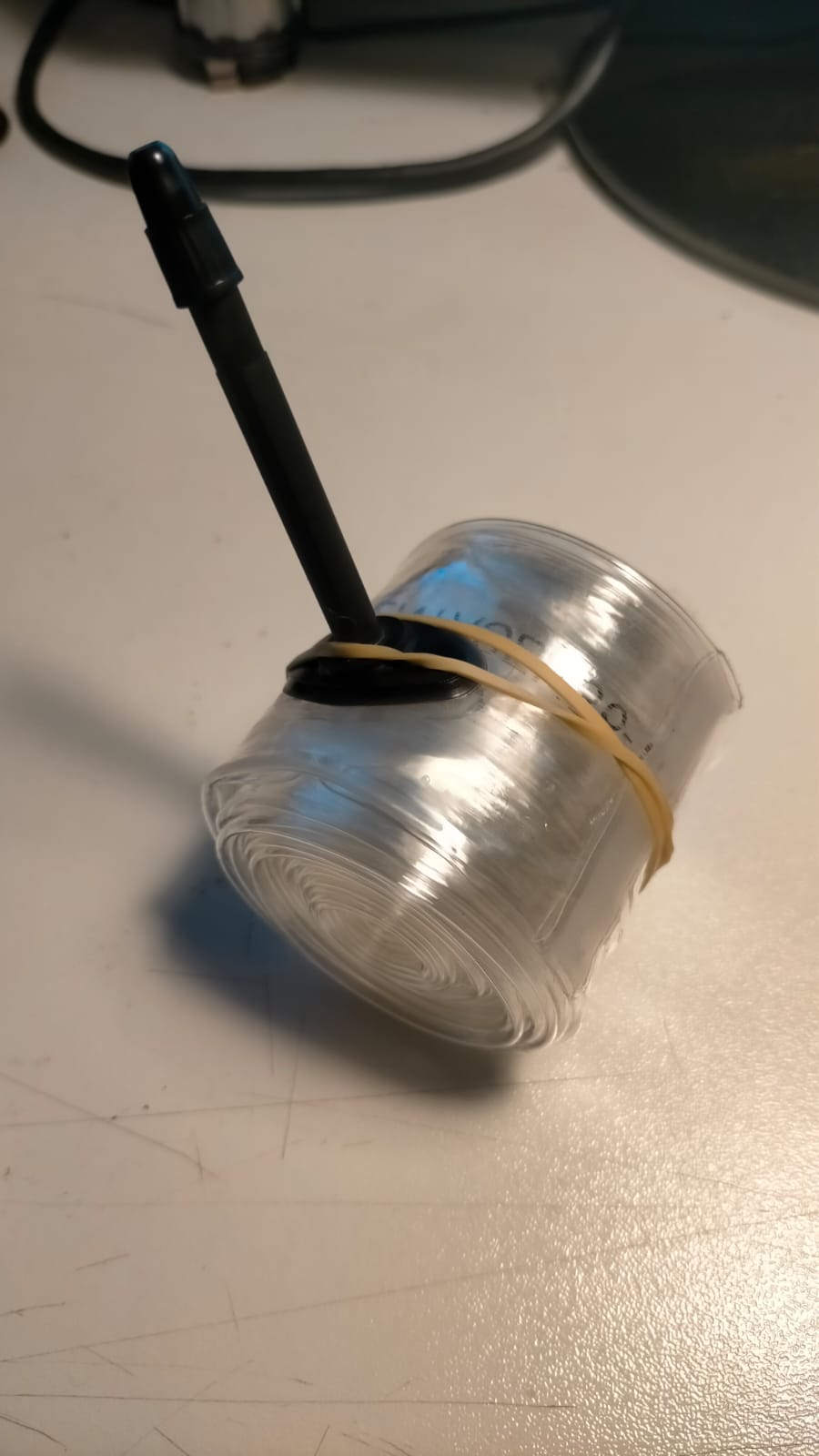

36er TPU tubes!
I received today the first test of a TPU 36er tube as a Xmas present!
Production will start in January and within a few days I’ll rebuild my 36er to test it and review it! Get it touch with Luca at 36pollici.it if you are interested. I hope he’ll surprise us all maybe with other tyre ideas :wink:

I finally tested it today. I had a few weeks struggling with wife and unicycle, one need more care than the other…
However, I’m unfit so cannot really spoke about performance, I can speak about experience. I’m riding a Carbon 36" rim, a KG ultimate tire , a TPU tube from Barbieri at 30 PSI. I was able to slow down and even start pedalling again like I was riding a good light 29er.
On the road it is really fast accelerating and fast slowing down making a town ride full of intersection and traffic light more pleasant and enjoyable. On the road I can feel the unexistance of the flywheel effect. Seems like the mix of the TPU tube (which is stiffer than any butyl tube) and low PSI makes a low rolling resistance effect, like a butyl tube at higher PSI, but without that hateful bumping tire which makes a poth hole a big danger at high speed (unless you ride clipless).
I tested it also on a frozen field filled with gaps and potholes. I experienced a lot of UPDs, but it was able to slow down and hop and start riding again till the next UPD. It seems like a good choice for a 36er road or XC. For a Muni 36er maybe I will prefer a tubeless+sealant+Vee-tire (due to Sealant+Trax Monster being a bombproof setup versus stings and punctures).
Edit: I’m also riding special spokes! I can feel the difference from butyl/TPU. I am not able right now to compare steel spokes to fiber spokes due to not willing to build another unicycle. So keep in mind that spokes also allowed me to ride more “cushioned”
