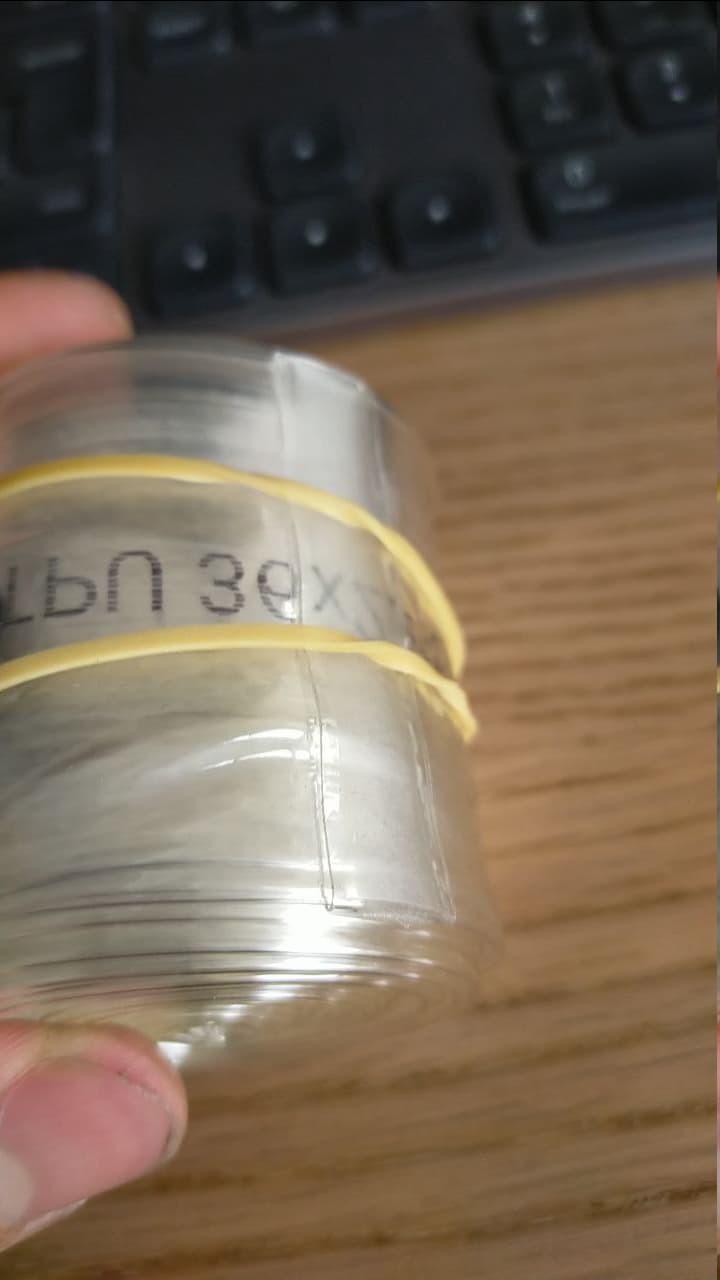

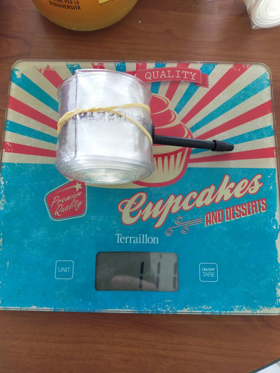

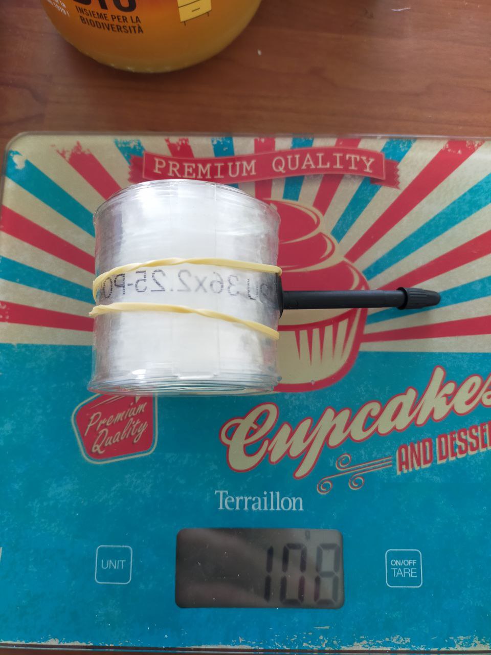

I have received my 2 tubes two days ago. First good point, the mass is similar to what was announced: 108g ± 5g
Just finished the setup on my Braus Alchemist carbon rim, with NR Lite tire. Second good point, it was easier to set up than with a stretched 29er tube. We don’t have to bother with stretch the tube, which saves some troubles.
The bad point now. The tubes are glued together in a strange way. On below picture, you can observe that:
When inflating the tube, it looks like this gluing prevents the tube to inflate correctly. The tire does not inflate homogeneously. Not sure how it feels when riding it, but I’m a bit afraid. I’ll have to give it a try this week-end.
However, this point may “go away” as the tube may correctly stretch when it will have been inflated for a few hours. It’s been less than one hour since I’ve inflated it. So let’s wait a bit before any conclusion :slight_smile:
