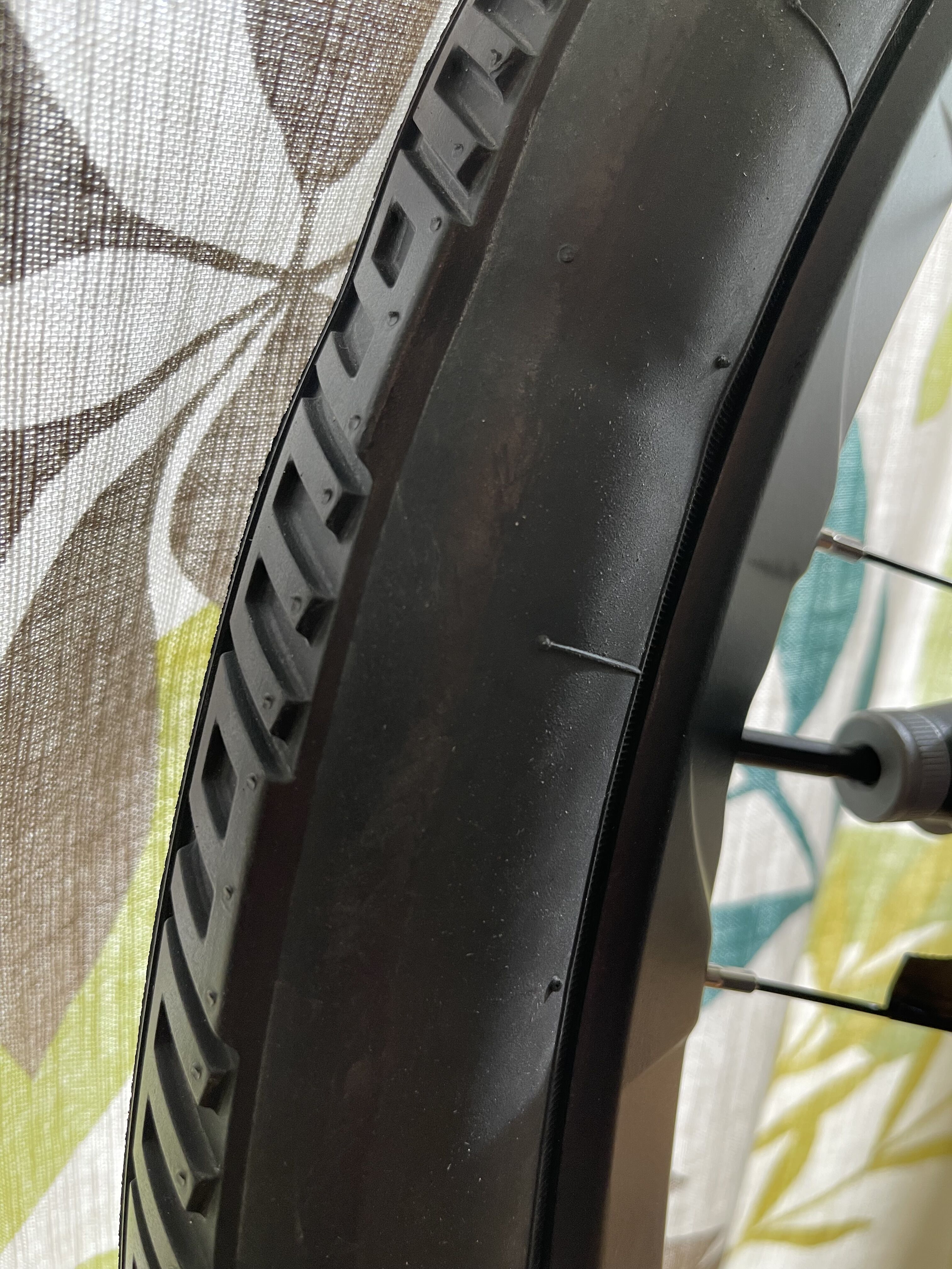

Installing the TPU tube. Was worried I’d not get it in rim/tyre as it seems to behave very differently to normal tubes.
I wasn’t sure but did put a small amount of air in tube before trying to evenly place it in tyre. I think I got it evenly inside but wasn’t sure if it twisted - although it doesn’t seem like it can twist much. Nothing was trapped under tyre edge or the like and it is pumping up nicely - barring one area I didn’t really understand.
Just right to the valve stem I can feel a narrower section - With the part before and after feeling fatter, or as far as the rest of the tube in the tyre.
Is this where the glued join section is? Is this normal for this kind of tube?
The photos shows the less inflated patch - up from value directly opposite to spoke.
Hope this is normal :crossed_fingers:
It is. I have the same behavior on my own 36er TPU tube but it doesn’t seem to be an issue. I was worried at first, but you can’t feel it when riding :slight_smile:
Phew!
Thanks @Maxence - I saw when I scrolled back up that you’d highlighted this before.
I have to say barring the weirdness to how it installs this was so easy compared to how I pictured getting a tyre on the Braus rim and these TPU tubes seem the best thing in the equation.
