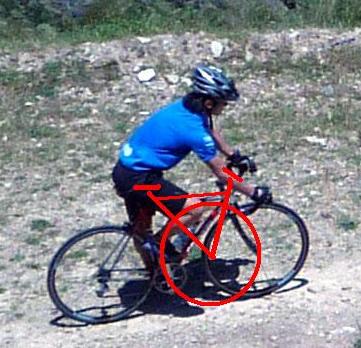

What’s the difference between a bicycle and unicycle? A bike distributes weight evenly between the handlebar and the seat, and the seat does not curve upwards to wedge against your crotch. The handlebar keeps you from sliding off the front of the bike seat. Unicycles are far too upright. All the weight is on your crotch.
A lower position also gives greater stability by lowering your centre of gravity.
There have been various attempts at handlebars on unicycles, but I have yet to see a production bar that stretches you out like on a bike. The closest thing is probably the T7 handlebar, but it is far too upright and much too short.

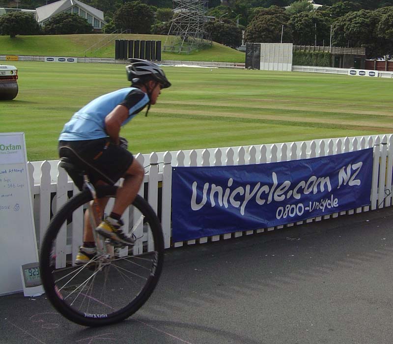

If you look at photos of people riding the T7 ((there are nice ones of Chuck Edwall pg 17 and also of Jan Longeman pg 31 in the current Issue 7 Unicycle Magazine Dec08/Jan09), you’ll see that the T7 is up against their chest. It is like riding the Graeme Obree style Hour Record Time Trial position. Very aerodynamic, but with your elbow flexed at more than 90 degrees not that great for control or comfort.
Having a more stretched position is NOT about getting a Time-trial like position either. What I’m advocating is a position that has your back fairly straight, about 45 degrees, elbows slightly bent with arms relaxed. If you imagine superimposing someone riding a bike on a unicycle; that is the position I’m talking about.

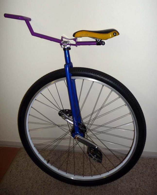

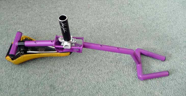

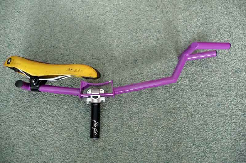

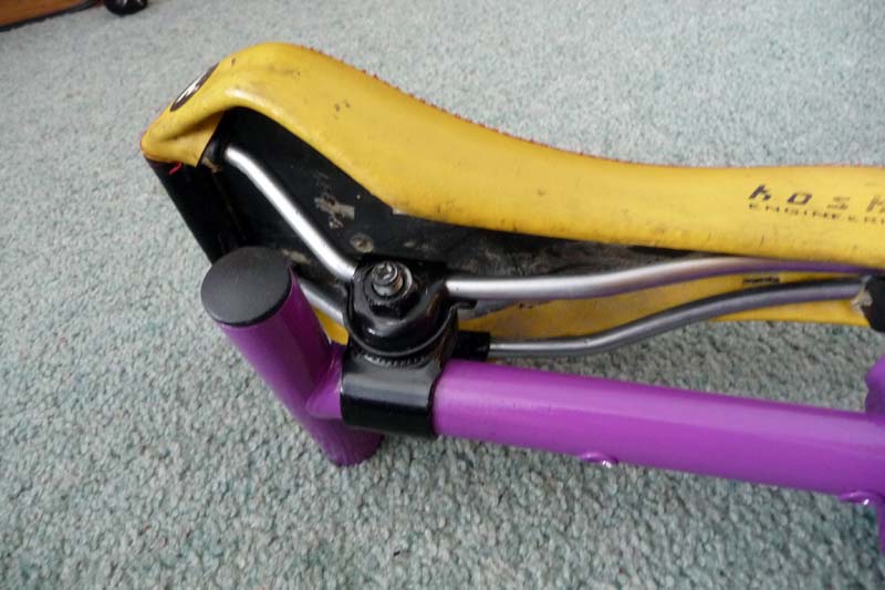

With this in mind, I set about modifying my T-7. Conveniently, it has a T-bar at the back. I have never been able to figure out what it was for, until I realised that it was designed to allow you to mount the seat further back!
This allows a more stretched out position without actually overextending the handlebar, which would weaken the design.
I have used a bike seat, with a BMX clamp. But I’m sure with some creative bolting, it would be possible to put a regular unicycle seat in there. The bar was also wrapped in regular road bike grip tape (not shown).
The test:
I took the unicycle out for a spin. First off it was interesting to mount as the seat is positioned much further back from the handle. It didnt’ take too long to get used to it however and I was off.
The first thing I noticed was how comfortable it was straight away. My weight was evenly distributed between my hands and the seat. With this set-up, I felt like I could ride it all day, just like my bike. It’s still not quite long enough or low enough to be a bike position though. It felt cramped compared with a bike, but was a vast improvement. It’s kind of like riding a bike with a short top-tube and an upright handlebar (A plea to Mr Nimbus: please get rid of that rise in the T7…it’s horrible!).
However, it was vast improvement on just about any other bar I’ve ridden on a unicycle. It felt very natural and bike-like to the point where I was craving for a set of drop bars and hoods!
The main problem I encountered was nothing to do with the T7 at all. It was caused by the wide KH36" frame consistently whacking against my knees when using this position. The square corners are particularly painful! It took a fair amount of adjustment of the seat (mainly pushing it back on the rails and angling the whole thing upwards) to try and minimise this, but I still ended up riding with a somewhat bow legged position.
Other issues were to do with slowing down, but I didn’t get a chance to test it on any hills. I suspect that the braking power would be somewhat limited, not by having a stretched out handlebar, but by how upright the T7 is. There is not much leverage to pull up as your elbows are already quite flexed from the upright T7. Again, if the T7 was lower (hence elbows less bent), that would improve the pulling power. It may be that you would need also to run brakes and ride this more like a bike anyway (ie use your brakes to slow down rather than leg backpressure).
Turning was interesting because of the bike seat. There is much less material to push against with your thighs. It was more dependent on leaning your body and handlebar. Again, not too dissimilar to riding a bike.
In summary, I think the more stretched out bike like position works great on a road unicycle. The T7 can be modified to get closer to that position, but it’s still too upright and too cramped to be directly comparable.

eenwieler-sander: I used a bike seat because I had all the bracket attachments for it. I haven’t tried it with a unicycle seat, but I think a bicycle seat is actually better for this kind of setup- there is no reason for a curved seat that is three times as thick as it should be (ie unicycle seat).
scoope: good point about fork rake, but I had no trouble steering it. I haven’t used it in any tight cornering and haven’t had enough experience on it to give you a firm opinion yet. However, there are many riders who use long extension handles and seem to steer ok (Sam Wakeling and Dustin Schaap spring to mind).

I basically tilted the seat up and pushed the rails as far back as possible. Although it’s angled upwards it actually self corrects when you ride it (ie the fork legs tilt forwards and the bar/seat are relatively flat). In the photo I’ve tilted the unicycle forwards to show this. It doesn’t rub my legs as much on the frame, but I can’t ride with my knees pointing inwards and close to the midline like I normally do.

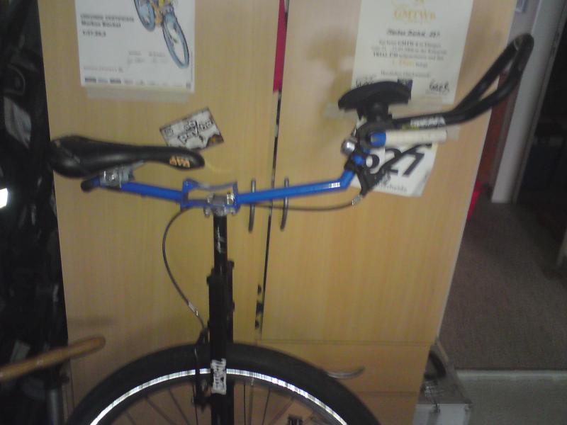

Good stuff Ken. I did a bit of experimenting with a bike seat this fall and will definitely have a bike seat and long handle on my next 36er.
Here is a bit more discussion on bike seats on 36ers.
Cool…looks like you have a similar idea with your set-up. I’m not the only one who thinks the T7 is too upright!
You could extend the reach without getting a super long handle by sticking out another post from the back also, and mounting the seat on it. Much like what I’ve done with the T7.

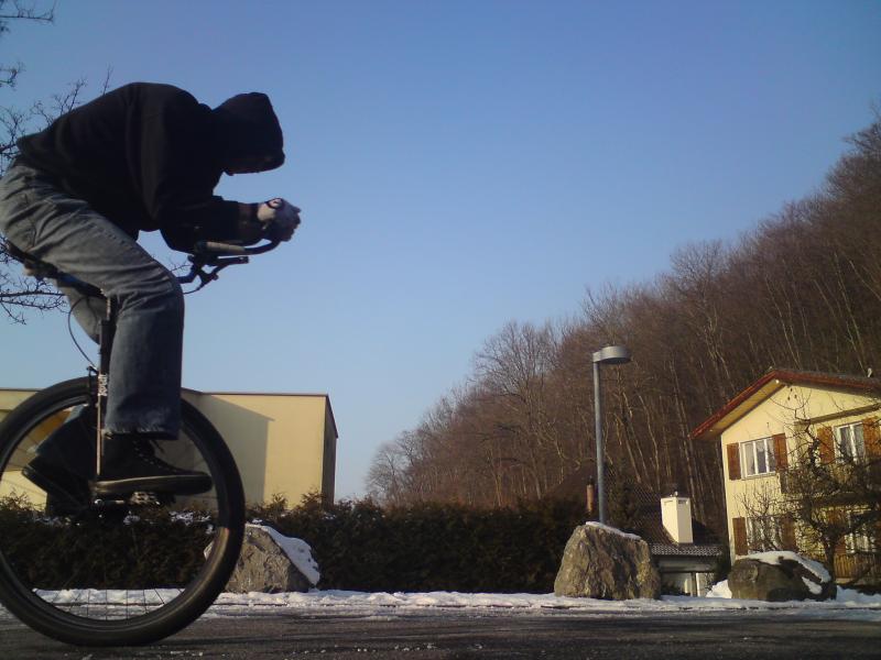

i’m not really a road rider… i prefer muni…but today i was bored and i still have my 29" schlumpf…and i thought your idea is worth to try it… it feels good, there is way less weight on my bottom…but it is still a little to short and the angles could be better… and i need shorter cranks :wink: .. i could only ride it for a short distance…hope i can try it really soon. thanks for the great idea!!
