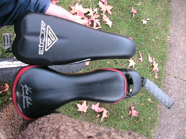

Azonic Love seat
John: I was hopeful about this idea so I got a hold of an Azonic Love seat and tried it out yesterday - OMG, what a truly horrible unicycle saddle. Way too hard for distance comfort, but the most troubling bit was the width in the center was too much, making it really uncomfortable to pedal - unless your pelvis is bovine-wide. The brief ride I took made me feel as though someone had slipped concrete into my bike shorts. I returned the seat and will keep searching.
See picture
B
haha, wow that seat is massive. The seat that I used was a pretty normal looking one. I can’t imagine anyone riding that thing on a bike where they are sitting on it for long periods of time.
Also were you using the single handle that is under your seat in the picture? My handle is quite long and I felt that I would benefit from a longer one giving me an almost bike like position.
Yes, not my brightest idea, but worth trying out. Yes the handle seen in the pic is one of the off-road “black cock” unihandles I’ve made for a while now. I’m with you on the desired bike riding position bit for long distance rides. See pic of the general riding positon I’m using on my KH36 now.
For the saddle test, I just tried it out by its self on a rail type seat post on my 29er - with no handlebar, just around the block and it so completely and fully failed the comfort test in this state that I didn’t even go on to trying to fit it on a proper handlebar set-up.
