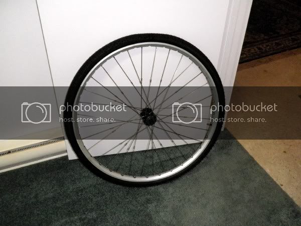

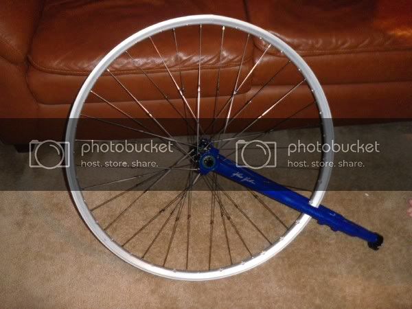

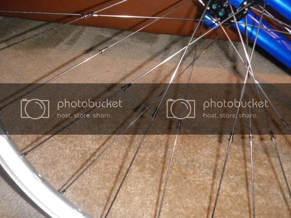

And now (finally) I modified the rim, pinned it together and built the wheel. I needed spokes longer than what were commercially available so ordered so got some short double threaded sections to stick on the end of a trials length spoke with a nipple as a connecter.
Here are a few pics of the wheel
the nipples

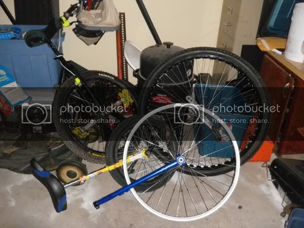

comparing to a trials, 26, and 36"

Before I cut the rim I pried the seam open and got the pins out so I could re-use them before cutting out the damaged section. I tried using the old pins to put it back together and it was just too hard, I eded up grinding the ridges off the old pin for one side and found a random chunk of round brass rod that fit perfectly for the other side. There was a gap at the seam until I built up the wheel and the spoke tension pulled it shut.
Before I built the wheel the rim was almost an inch out of round but now the seam is the only part more than 1 or 2mm out, I guess I could have pounded it down a bit, theoretically I still can. you can see the bump at the seam in the first photo, it’s at the top of the rim in that picture.

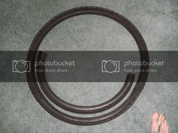

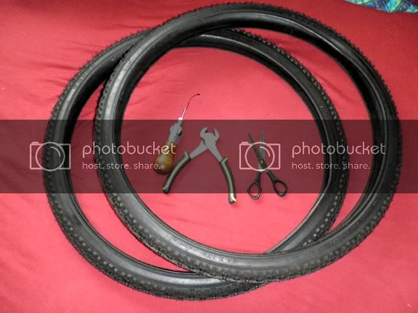

I started out with a couple cheep 24x1.75" tires from Canadian Tire and a couple tools. Below are the tires and the tools I started with; end cutters, scissors, and a sewing awl.

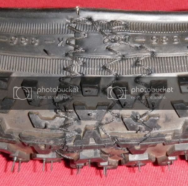

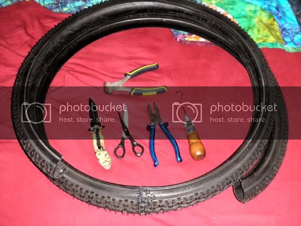

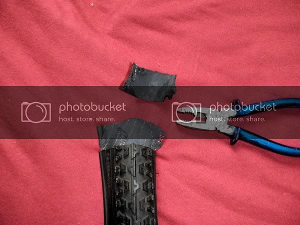

First step was to cut both the tires and peel off a section of the tread rubber to leave only the casing to overlap (underlap?) the other tire.
Then sewed the two tires together with the sew-all. I used a zig-zag stitch to allow the tire to expand with air pressure, more on that later.
This is what it looks like at this point

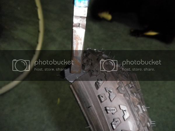

Mounted it up and inflated it on the rim. It was really tight and I actually had to use a tire lever to get it all the way on. I was a bit surprised to find that bead did not want to seat at the joints and there is a bit of a dip at each one. but all and all the joints look good.

Did you glue the overlap at all?
The tyres that I have cut up for this purpose haven’t had any obvious way to ‘peel’ off the tread rubber. It’s more of a painstaking process with a razor blade to cut back into the rubber.
Does the wheel roll or do the joins dip to make it bump? I think the difference in tread-to-bead ratios between different tyre sizes cause this problem (larger tyres would have bead length closer to the same length as the tread than on smaller diameter tyres). The joins may need to be cut at an angle?

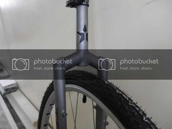

It was snowing today but most of the ice is off the highway so I decided to take a quick rip and test out the wheel.
I am not really used to the big wheel with small cranks anymore but quickly got into the rhythm again.
I did not feel the thump thump thump of where I connected the tire but I did feel all the lumps and bumps in the pavement. Went about a mile, hopped around a bit to see if anything would break and turned around and went home.
I tried going through the deep slush ibefore the driveway but came off the front, I guess it was still too firm for the skinny wheel to cut through, I am sure the fat (29x3.2) wheel would have just floated over.
Gave the wheel a spin and it seemed to be a bit out of true but not real bad, all the spokes were intact though. I will have a better look at it tonight and touch up the true.
The unicycle weighs 5.9kg/13lbs as shown.
Hey Sam. When I made that test tire a couple years ago I was doing that painstakingly slow process of trying to cut the rubber off the casing without cutting the casing before I just pulled on it and low and behold it grudgingly peeled back without the need for a knife.
What I do now is just carefully cut into the rubber almost down to the casing, fold it and carefully cut just a bit more until I see the rubber change colour and I know I am through the tread rubber and into the casing rubber. I then use some pliers to peel a bit up at the edge then peel it back. It seems to peel better when you pull perpendicular with the threads of the casing.
I didn’t feel the bumps (or in my case dips) in the tire on my quick ride but our roads are quite rough and I was only using 40 PSI. I think that If I made the tire just a tad bigger to match the rim better I would not have so much of a dip at the seam
