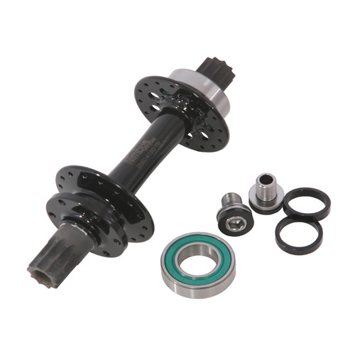

Anyone know if is there a version of the 125mm disc hub that is 32 hole?
I currently have the 36 hole version on a Large Marge and would love to just have two wheels I could swap out.
I could set the 2xl wheel up with some spirit cranks and the disc on the outside but then I believe I would have to redo the brake every time I switched wheels.
Maybe there is a 36 hole 100mm or 80mm rim out there?
udc us
Hi,
They sell 125mm disc hubs but only in US unicycle.com I think…
Edit:
Yep I was right
