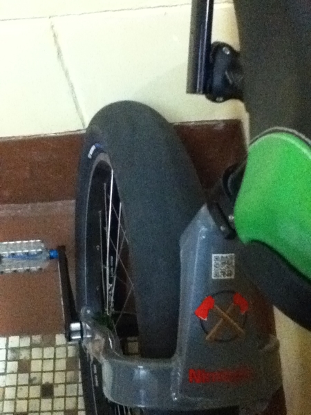

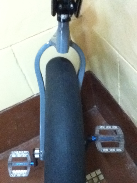

Nice looking hatchet there vee. I can’t believe how much clearance you have with the apache at high psi. Makes me feel a bit better about my 27.5x4.5 build… (still waiting on my nextie rim to arrive) what crank length are you using?
The amount of clearance on the Hatchet frame is ridiculous. My next wheel for it will be a 100mm Clownshoe with a VeeRubber Snowshow XL. I am also planning a 32" in the near future as well.

It would be fun if you could picture the clearance in the Hatchet frame :stuck_out_tongue:
