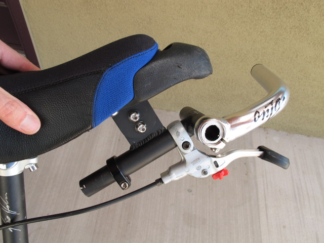

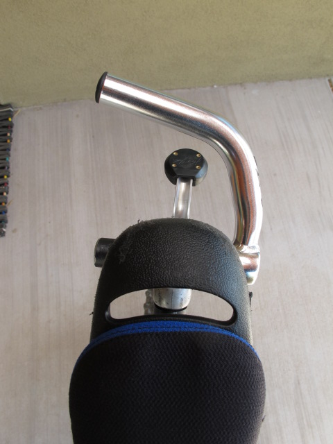

Here is my current set-up. The handle is nice in high gear. For low, I still use the seat handle. My set up is for one hand. The trails I ride are pretty rocky. If I were riding smoother terrain, I might want to use both hands.

Don’t you have a problem with your brake handle taking the blow if you upd? From the pic it seems to stick out further than the handlebar.

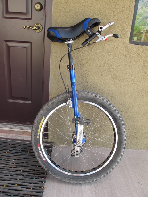

Look at the handlebar and brake on mine:
it is even more extreme and out there. I haven’t broken it yet. It sometimes hits the ground and bents back (downward). I run it a little loose intentionally to allow this. However, this is due to my brake adapter design; with it directly on the T bar it won’t be able to bend downwards, and might be more prone to breaking.
corbin
I made some minor adjustments and the handle hits first. I keep the brake mount screw loose enough that the brake handle moves if it does hit something. So far no problem.

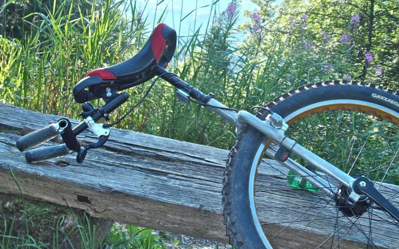

Hey, I have a modified KH T-bar on my 26" Guni too. I’m very satisfied with it the way it is now.
I shortened it slightly but I left enough to be able to put the brake lever on in such a way that it can be grabbed while holding the bar single handedly between the bar ends (which I swapped out for ones that would allow me to put some beefy rubber grips on). The braking is now a little more like when it’s under the saddle, which I still prefer somehow. But I got used to this handle bar setup and can ride most technical things with it.
The rubber grips are about 2 cm longer than the bar ends themselves by the way, so that acts as a bumper.
The part between the bar ends is covered with foam grips for more comfort. They also cover the area that you often bump into in a upd.
