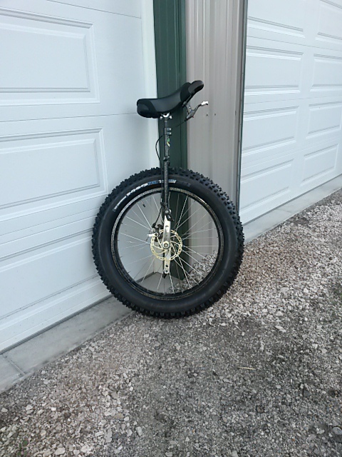

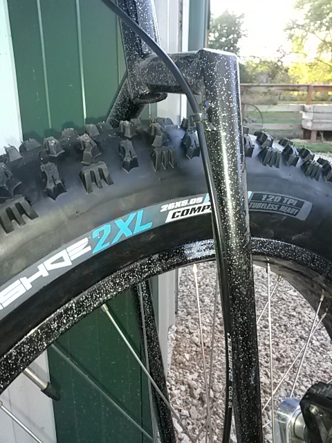

So anyways, long story short, here is the Vee Snowshoe 2XL 5.05" tire in the only unicycle frame that will fit it currently.
Since Jakob wasn’t making frames at the time, I asked Walt Wehner form Waltworks to build it and he did a smokin’ job (I’m sorry Jakob! I couldn’t wait!)
Anyway I love it.

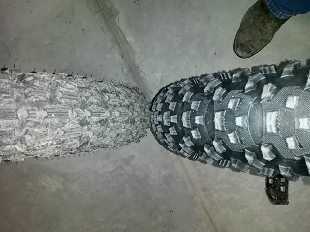

Last picture is compared to a Bud.

Oh, and about the Bud…
That was Fugsworth’s idea. Seems like everybody is riding on a Lou (on unicycles) and the Bud is way underrated. The lateral tread blocks seemed like they should want to roll straight and boy did they.
For a 4.8" tire, it was amazing and nearly kept me from getting the snowshoe. It really was fantastic.
So if you have an Oregon (Chet) get a Bud for it.

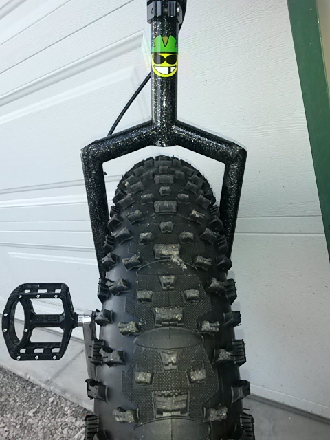

How is the clearance around the knee? The conundrum is really comfy to ride, but it’s tight. The 100mm spacing (actually smaller) and the fat tire, combined with the low q factor ventures, and I’ve hit the back of my knee a few times.

Knee clearance is definitely tight. Typically when I’m riding the frame sit’s behind the leg and the backs of my knees tend to rub fairly regularly, but never hit hard. If the trail is smooth, I can ride without any rubbing at all as I just bow my legs a bit. I am riding with a 125mm hub.

Specs are as follows:
Walt Works frame
Weinmann 3" (75mm) rim, double wall from ChoppersUS (excellent customer service)
DT Swiss spokes
Nimbus super wide ISIS hub (non-disk)
KH 137/165 spirit’s
TRP Spyre brake
Wellgo MG-1 pedals
KH Adjustable seatpost
KH double bolt seat clamp
KH Freeride seat un flattened
Starfighter

Looks like the rim is powdered coated to match the frame? Are you running tubeless?
The rim was powder coated to match. It’s not tubeless at the moment but the snowshoe fit very tightly and I will be going tubeless.
