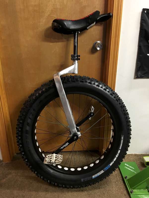

My build is coming along. Most parts are in. I went with an 80mm rim to give me more tire flexibility. Rim laced on one side; waiting for spokes for other side. Waiting for disk brake and macaroni 'n cheese duct tape for rim strip. Then, all I’ll need is a frame!
I tried straddling the tire – wow, is it wide. I think I’m going to be bow-legged.
Killian, looks like you have a fairly pronounced upward saddle angle. That seems to be recommended for the KH Fusion Zero. You find it comfortable for the Freeride?
Yeah I crank it up as far as it’ll go. Feels the most comfortable to me.
Tried this. Not bad. But I broke a spoke. Clearly, shifting the seat position breaks spokes!
Actually, it’s the upper side of the legs that seem to get irritated. Broken spoke is good excuse for time to carve some foam out of the sides of the saddle.
Checked the mailbox 3 times today for spokes. Nada. Can’t wait to finish the wheel and mount the 2XL.
Curiously, what’s the secret and advantages to having saddle pointing way up? On road, 36er, I have it very slightly angled up, but on muni, I ride pretty low and I’m leaning forward. Even though it feels like better control, but if I have the saddle pointing up, my nuts eventually pay a huge price when I inevitability boink..
Hmmmm..I’m just presuming you eventually get used to the angle and your body naturally avoids the boink. Just as I UPD with my 36er handlebar, now I never bash my legs as I once used to..:wink:
