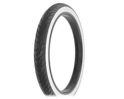

Super brick in white wall
In brown
Black was here but is sold out
https://classic-cycle.de/alle/2952/reifen-super-brick-26-x-3.0?c=366
