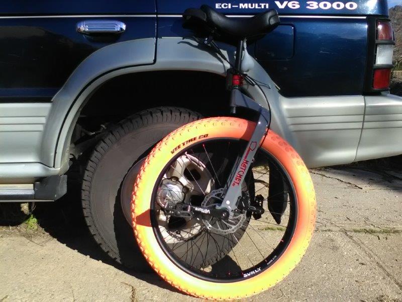

I replaced my Surly Nate with a Vee Mission Command 26x4 in the hopes it would have less clunk-clunk on hard surfaces.
The Mission Command is quieter than the Nate, but the auto-steer is much more noticeable and you have to lean a lot more to turn.
I got it in bright orange to help search & rescue find me after I fall off, and because I don’t get enough clown comments.

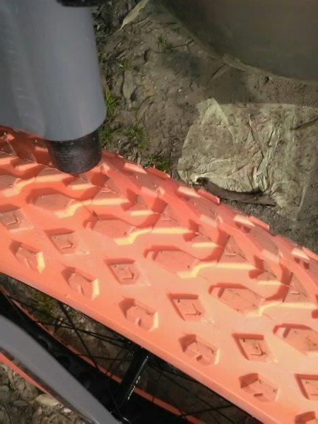

As requested. :slight_smile:
Not on the topic of tires, although that is an awesome tire; how do you like the hatchet frame?
I love it, a 26 fatty is so smooth.
I wavered a bit over the decision because it is a sizeable chunk of cash, but figured this is possibly the last frame I would ever need to buy. Except for a 36 for road use, and I’d like to build a 20" fatty giraffe, and maybe …

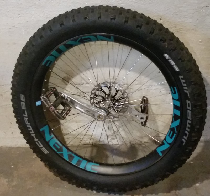

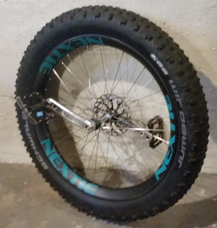

Schwalbe Jumbo Jim 4.0 SnakeSkin
Hi everybody,
took the opportunity of a winter tire change to snap a few pics for a long overdue review :slight_smile:
My go-to tire for riding year-around (short of very funky cases): the Schwalbe Jumbo Jim 26x4.0. In order to keep things not too flimsy, it took the Snake Skin version for just 100g more (still under 1100g) :stuck_out_tongue:
Big disclaimer: if you are a low-pressure-style rider, this is not a tire for you. I am 69 kg / 152 lbs and I am running it somewhere between 1.5 to 2 bars (22 to 30 psi). It feels as easy to pedal offroad as you would do on a bike path (short of the usual challenges) but with the tread and volume :stuck_out_tongue:
I am not a climber and I started to enjoy climbing a bit :wink:
The tread is not very deep but it is sufficient for the most common rides.
And on the plus side, it folds well when take off the wheel.
The pics are taken on a 65mm rim (no measurements mounted but there are plenty on the internet).
Stay tuned for the winter tire…

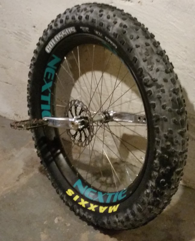

This will not be a review as I just have installed it and still waiting for the proper snowfall to put it through its paces (or just a dry day to try it in the forest :D).

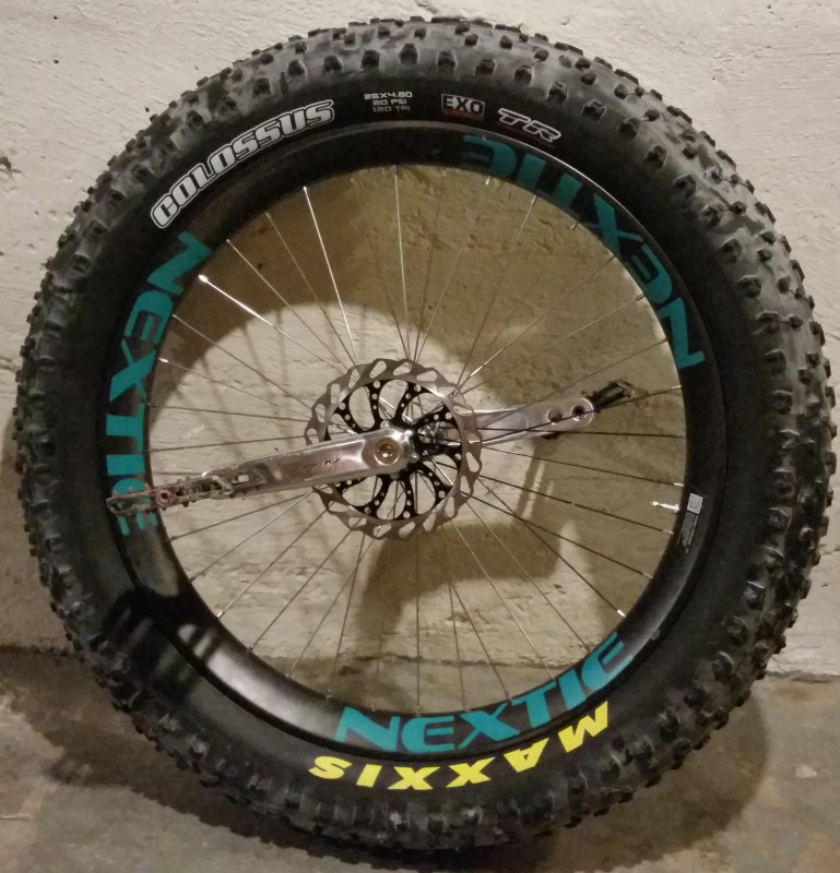

For this year, I wanted a big volume tire for the snow conditions (and other sloatation situations). I managed to find a reasonnably priced Maxxis Colossus 26x4.8.
Seems to be around the same lines in volume and weight as our good friend the Surly Lou.
It is another beast making the Jumbo Jim looking medium-sized.
As usual, there are plenty of reviews on the internet for more tech details and review.
I will post an update after a ride or two to give more feedback on how it is on a unicycle.
And in the meantime, have fun rides ! :slight_smile:
Note: I installed this baby tubeless as my first tubeless on a uni and it seems to hold its own (the rim is very grabby so it won’t go anywhere and should not burp short of the rim splitting in two). This will have to be accounted also for the future comments as a small tube stretched should feel differently than a tubeless setup. We will see…
And yes, the discoloration was there when I received the tire but does not seem to affect the tire (and most probably will disapear in favor of smow/mud/insert-sticky-surface-here.
Looks sweet! The discoloration comes on all the Maxxis Fat tires, it comes off after a few rides. That wheel must be super fun to ride! Now show us what it looks in your frame! :stuck_out_tongue:

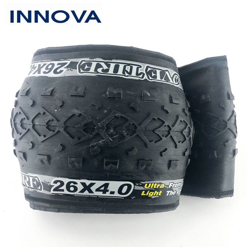

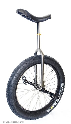

Today I tested the Innova LV1005 Fatbike tire 26x 4.0 (950g).
Wow! It goes off like a rocket. It drives easily and quickly. The low weight can be clearly felt. Ideally, the tire is combined with the 159g light Revoloop Fatty Tube. I drove tar and forest roads and finally through a 500m long road construction site with sand, many bumps and large stones. Everything went smoothly, although the tire has little profile depth.
Which is also positive that the tire has less Autosteer compared to other models. Only fast and tight curves are not going well, but that’s actually the case with all models.
This tire combines the driving experience of fast 27.5+ tires with the comfort of a fatty tire.
This will probably be my summer tire until I pick up Nate 3.8 again in winter
950g for a fat tire is wicked low. I have a 29 x 2.6" at 800g and it’s one of the lowest weight for that size for comparison.
I’d expect theses tire to be 1.2kg minimum, so nice!

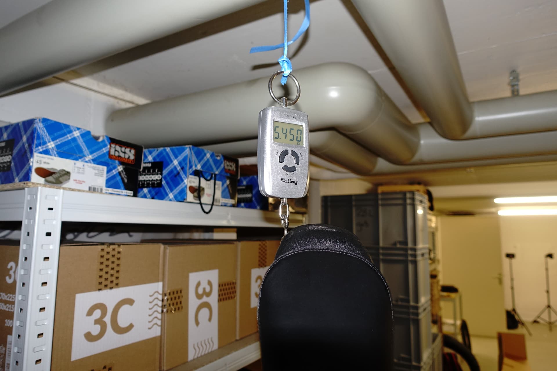

My goal is to eventually build a Fatty under 5kg. Actually I’m looking for the Juggernaut Pro 26 x 4.0 tire. It weighs another 100g less, i.e. around 850g. But I have no chance to order it from the Kenda importer. They don’t stock it or make an extra order for me.
What the current low weight record for you?
I’m currently around 5.7kg (I’ll have to weigh it when I assemble the new combo). But there is still a lot of potential. But I want to use serial parts. And carbon rims are out of the question, it should be a unicycle that has a “normal” price. There is potential for savings, for example at the fork (approx. 500g), pedals 100g, saddle
5.45 kg
(The seat post is shortened, it is without mounted brake, with carbon pedals.)
With a usable and cheap nylon fiber pedal with metal pins it is +200g
That looks nice!
Really??? Looks like unicycle suicide to me. :wink:
