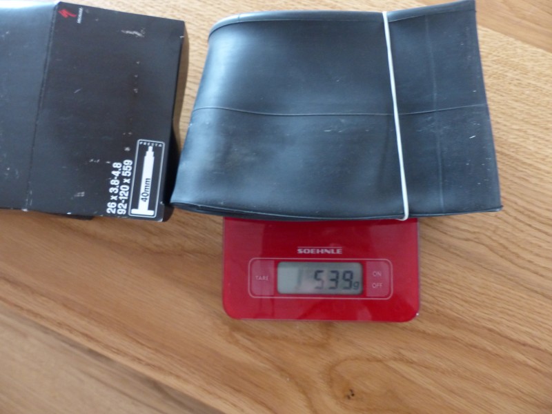

I was in need of a big tube for a presta rim and ended up buying a Specialized Fat tube (Presta) at my LBS…
I searched the web for information about it and was not able to find the weight anywhere.
So here is the interstellar exclusive buzz (insert-trendy-adjective-here): it is an anchor (539g) !
On the upside, it can fill any tire on the market without any stretching ![]()
Why don’t you go tubeless?
I am too lazy for tubeless and it seems too messy for my taste. I am more of a light tube + slime sealant kind of guy.
I got this tube to have a working wheel. I could not drill for shradder (no drill available) and the LBS had no freeride tube for sale ![]()
I will replace it whenever I have an opportunity and it still makes a nice emergency tube ![]()
I was initially surprise that nobody talks about this tube’s weight (or Google is hiding things from me…
You should go tubeless. When using a carbon rim it’s a bit hard to setup if you dont have a compressor, but when it’s set, it’s set for real. You just need tubeless tape, scellant and you are ready to go! On my carbon rim I even rode the tire without scealant for a while because the bead was so tight.
It’s not messy when you do it the proper way!
I see what you mean ! I removed the tire for some cleaning before installing another one and I thought it will never get off !!! One youtube vid later, it was off the rim but it is a very different technique and I can see how valuable it is for tubeless.
