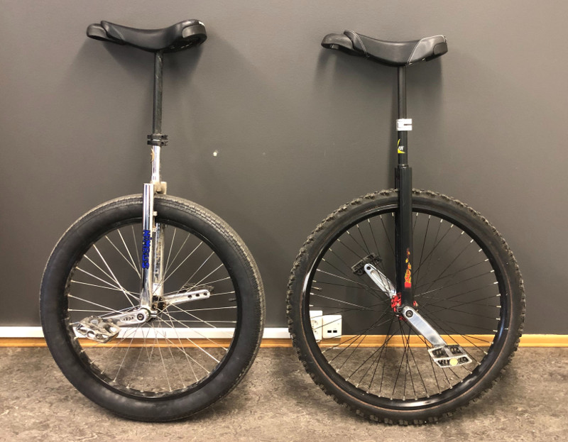

For those curious about the size, it looks very similar in size as the Duro Wildlife (as expected), albeit with very minimal tread (and a 580g drop in weight). Here is my 26" next to UniMyra’s spare 29" (29X2.1/54-622) to give you a rough idea of size and scale:
