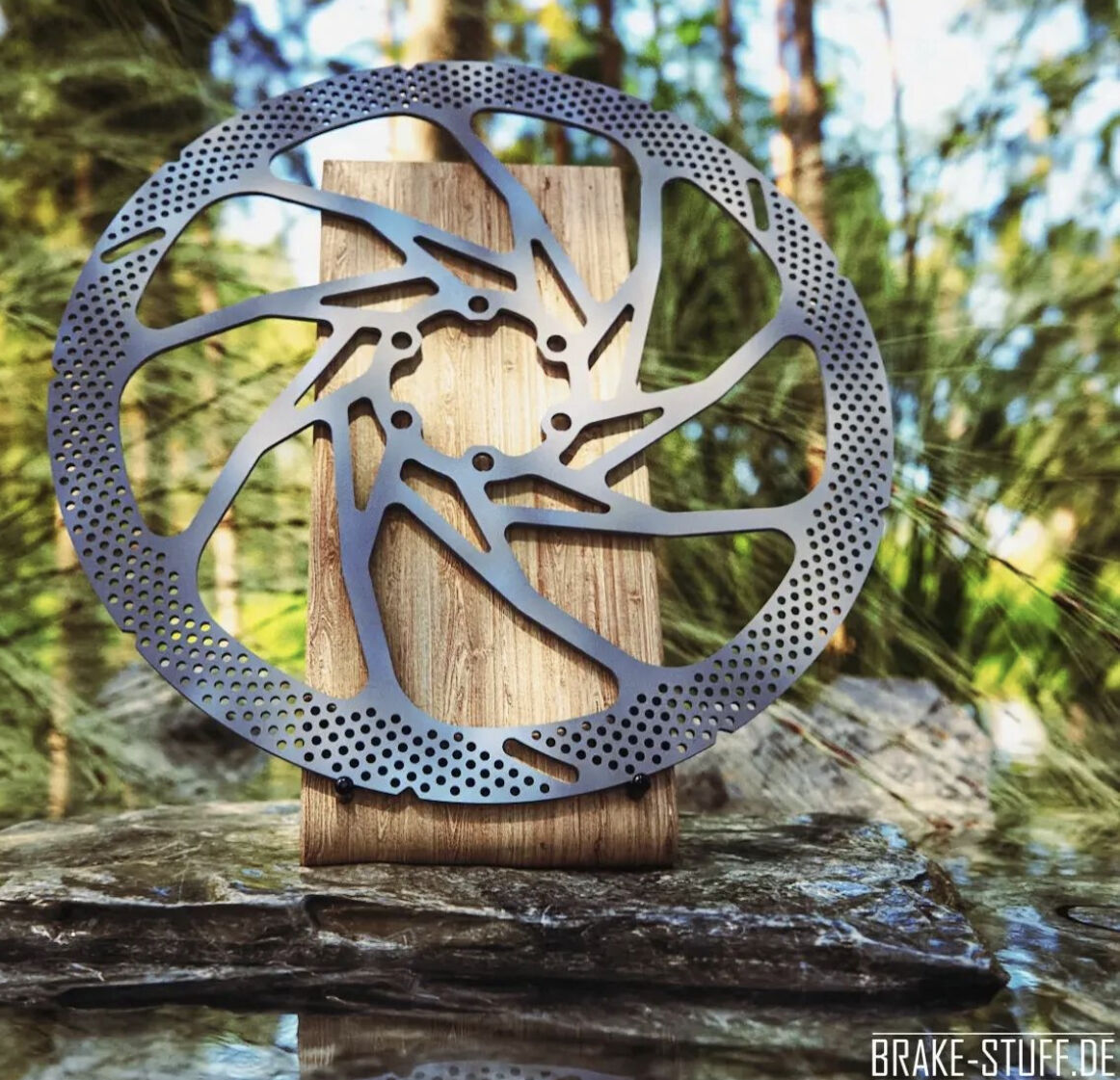

  • A swept rotor arm design
  • 2-2.3mm thinkness
  • Dedicated heat treatment
  • 203mm or possibly even 223 (!) sizing
  • Pinprick hole design on edge section
I see they offer glass bead blasting option to the surface treatment which from what I gather saves braking the brakes in and gives a more even surface when compared to standard rotors.

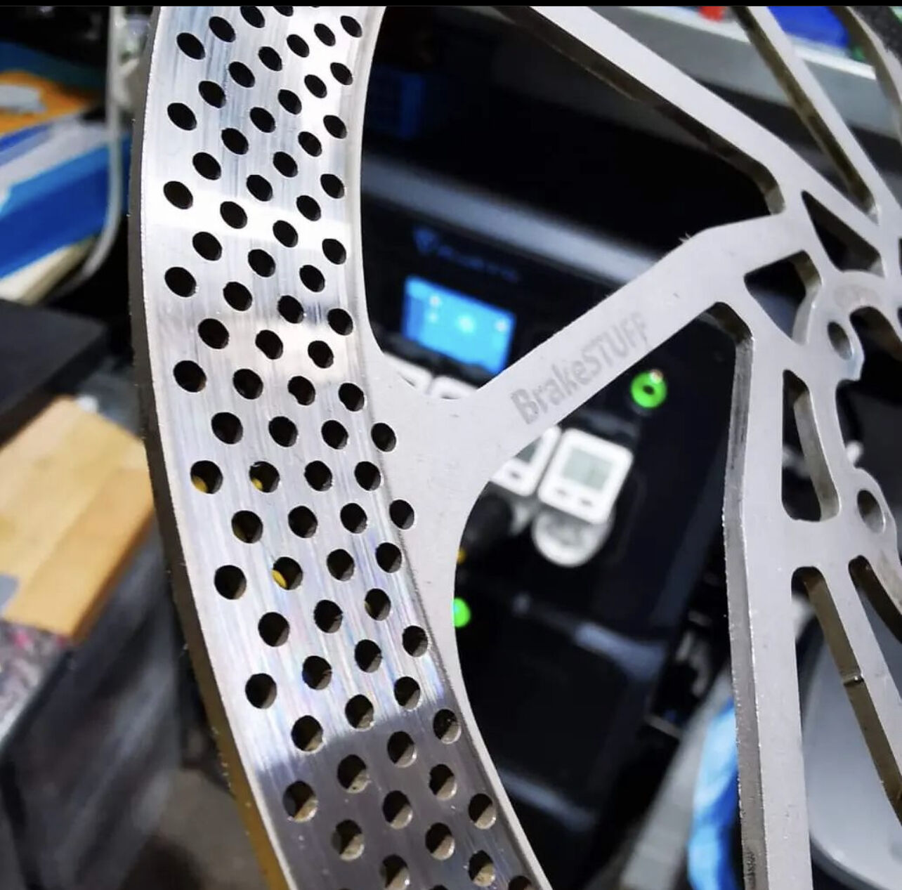

I think I like this one the most so far:
(Naturally it will be with a much larger inner space but the outer section seems very solid)
I am background thinking that this type of thing might get cheaper with a group order and to that end I think we could look to arrive at an amalgamation of all peoples desires - it will end up a bit of a compromise I guess but still a nice mix of all the most popular specs
(Or it could be that just 2-3 people are interested and that kills this project off quite simply :joy:)
Hope this ends up useful to the schlumpfing community and at the very least gives another supplier to the disc rotor areas for these hubs… and those massively skilled riders who can wear out rotors (not really me… but I enjoy tinkering) :gear:
