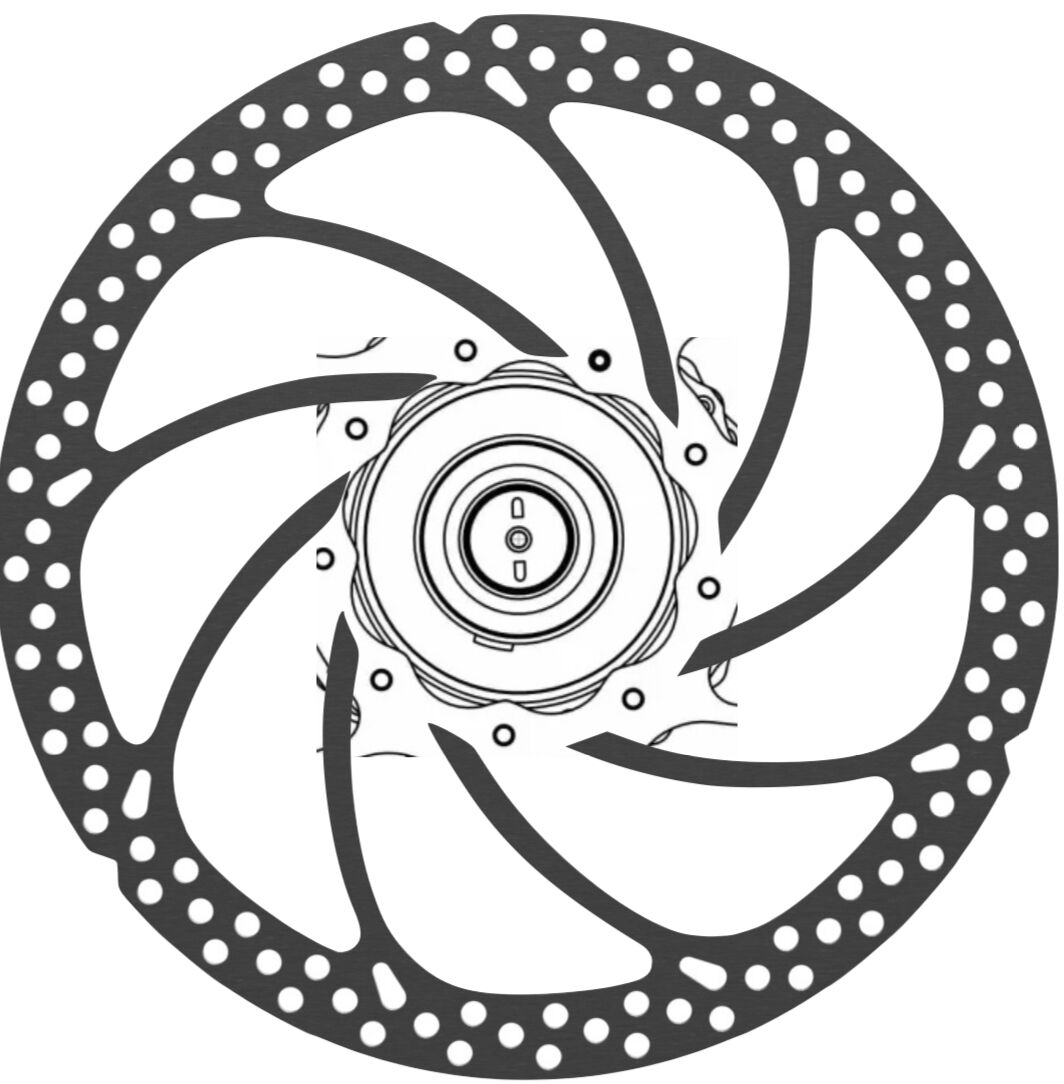

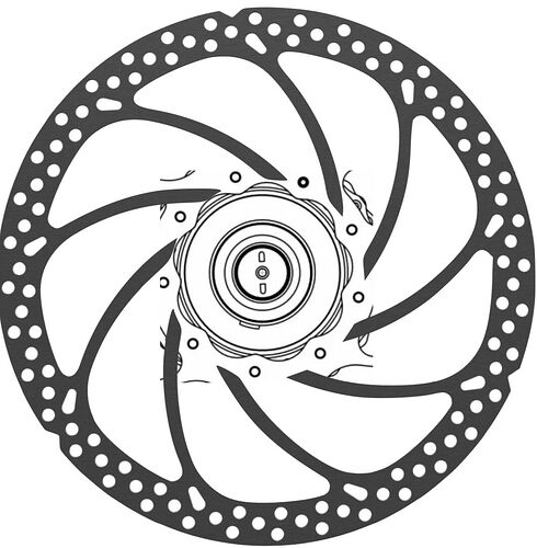

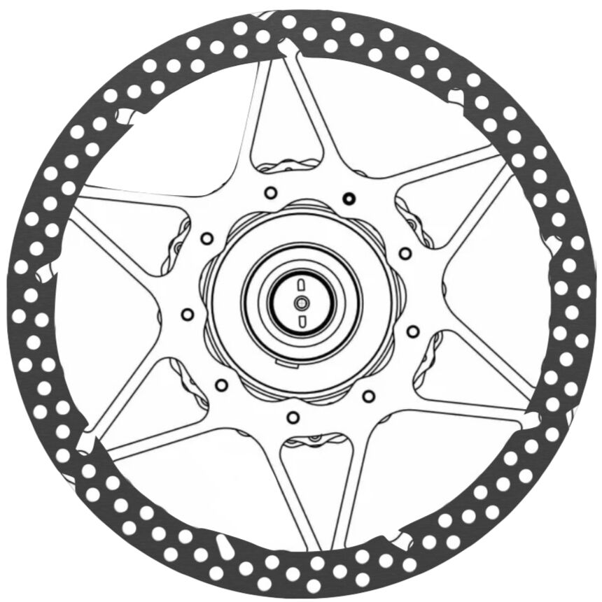

Curious. These are the two concepts / options I have proposed being worked up as a design:
Option 1:
Option 2:
This is very early stages and the photos are just my own hack job at superimposing one rotor design on the official design - a concept rather than anything technical.
Option 1 seems to have the benefit of sticking to how the hub’s creator wanted the rotor to work. So I imagine this is compliant / more compliant with warranty aspects.
Option 2 is more adventurous and more in line with how bike rotors are made - with the sweeping rotor arms (as I understand it) being there for rotational support as the braking force is applied. However it could also be cosmetically pleasing as the design from Florian clearly works in the technical sense - but we’ve just seen it wearing more.
I have heard the metal used isn’t heat treated, and that it cannot be heat treated due to the type and quality of steel used.
I am hoping that which ever option gets the green light for actually being tested / made, we can get 203 and 220mm sizing options.
But it would be great to get any feedback on which option is preferred by those that will order / may order one down the line (should this all work out of course before then!)
I’m wondering whether option 2 may cool down faster than option 1 - or heat up slower. Could there be any effect of the form of the rotor on that point?

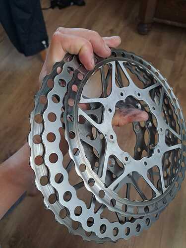

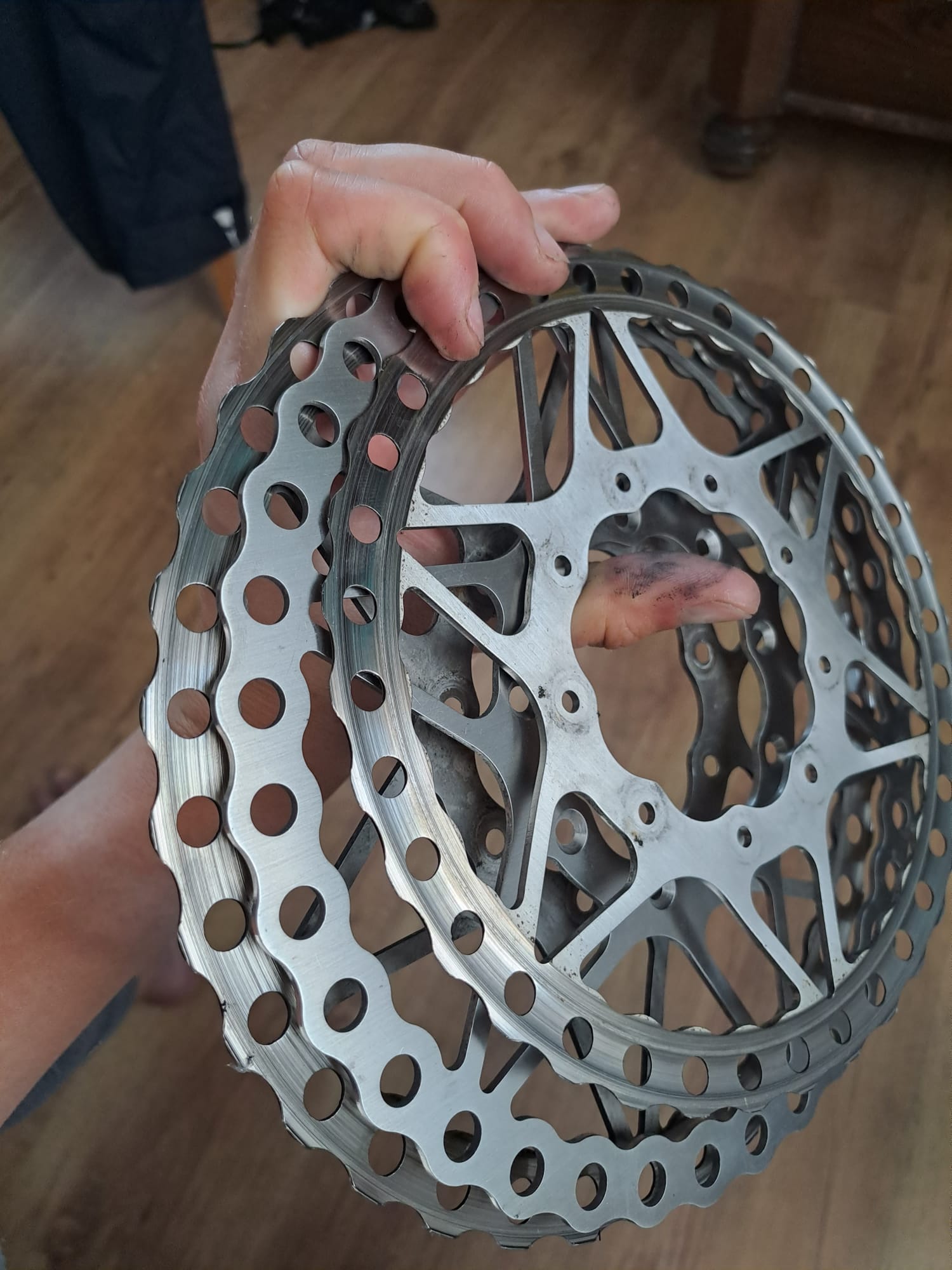

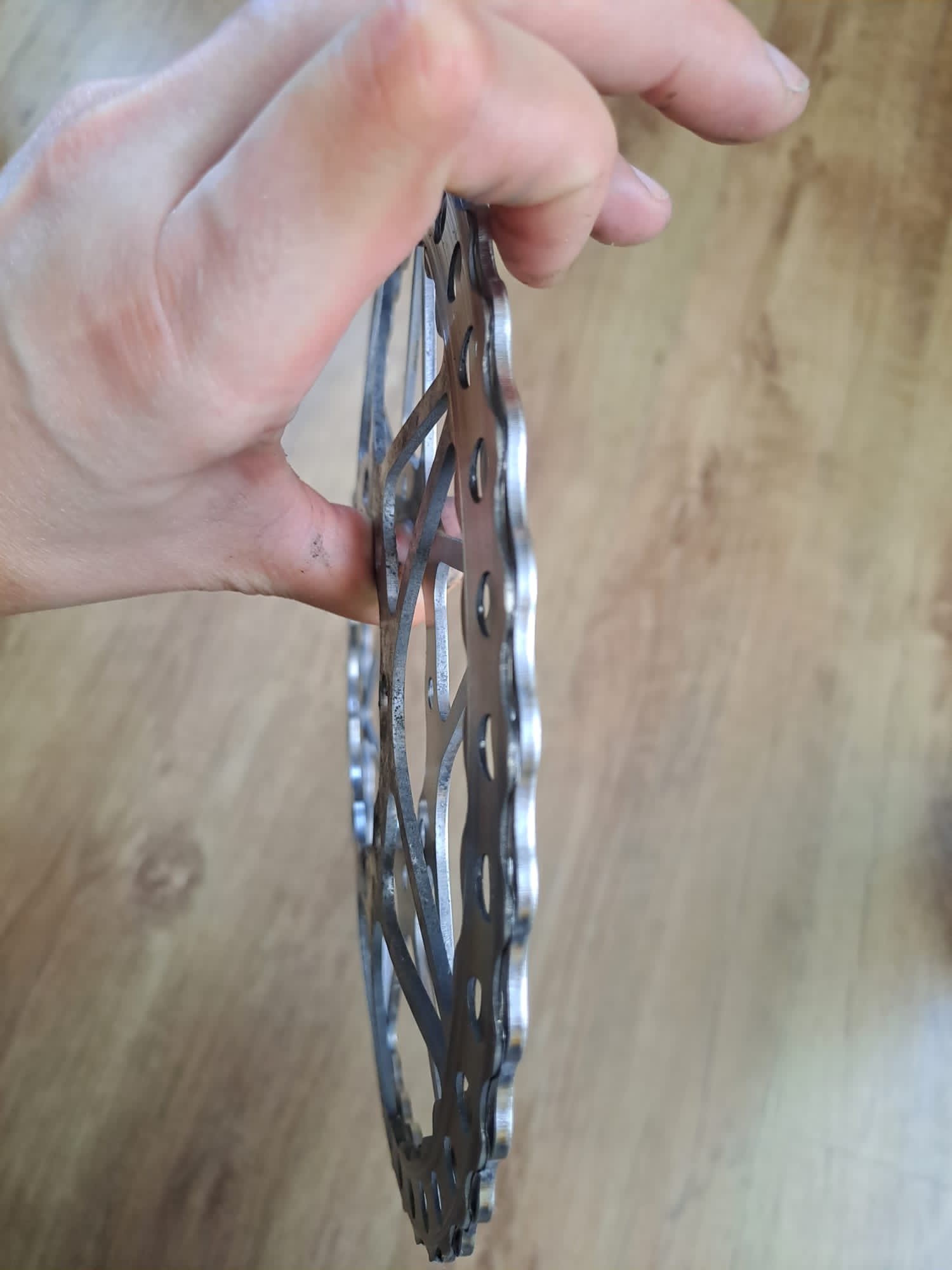

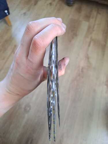

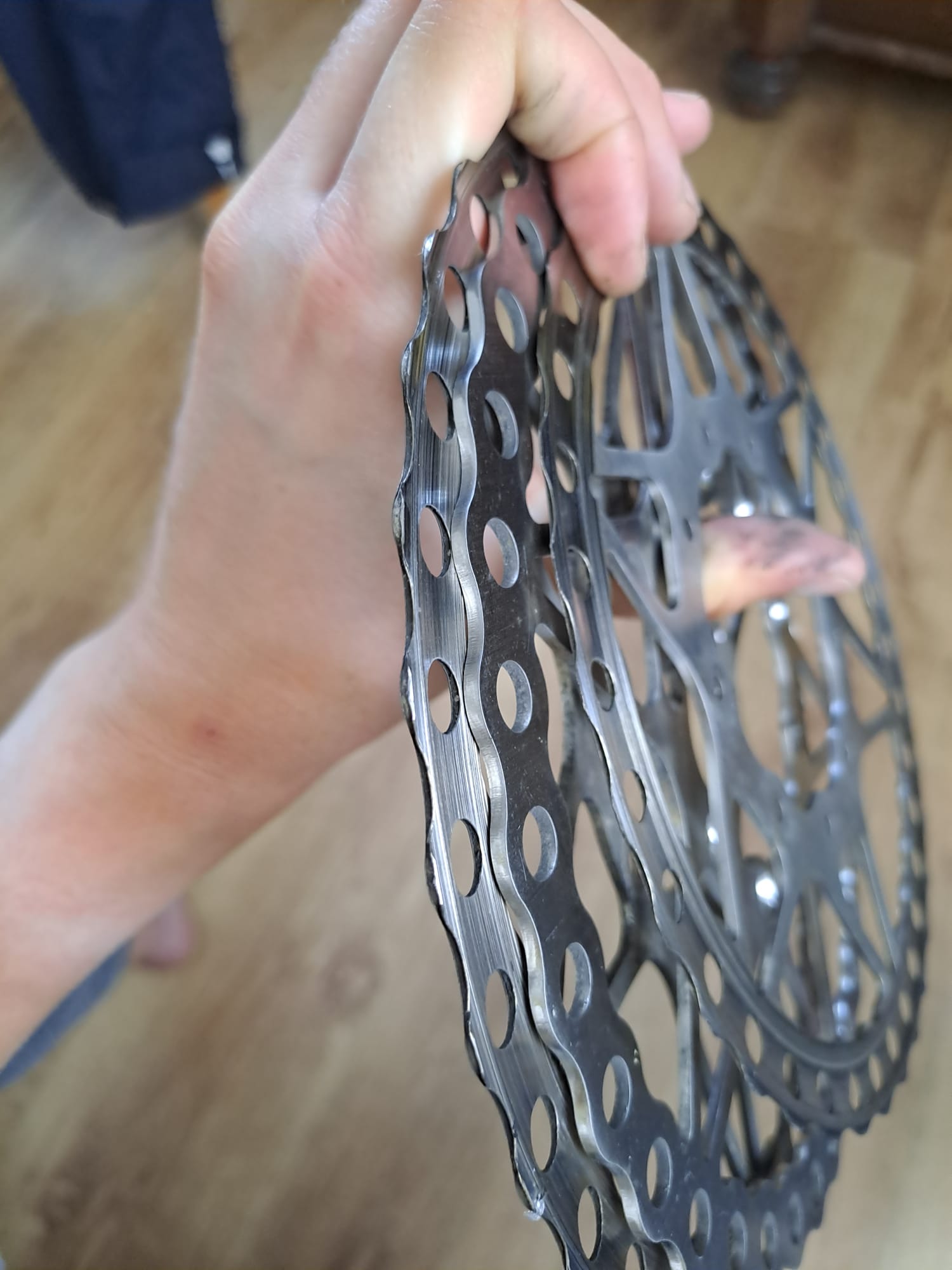

Wanted to cross link this for thread continuity:
But also just share the photos I got (with permission from @Becky98)

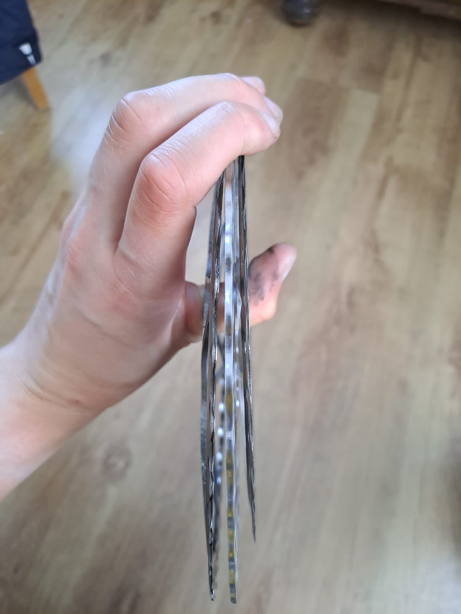

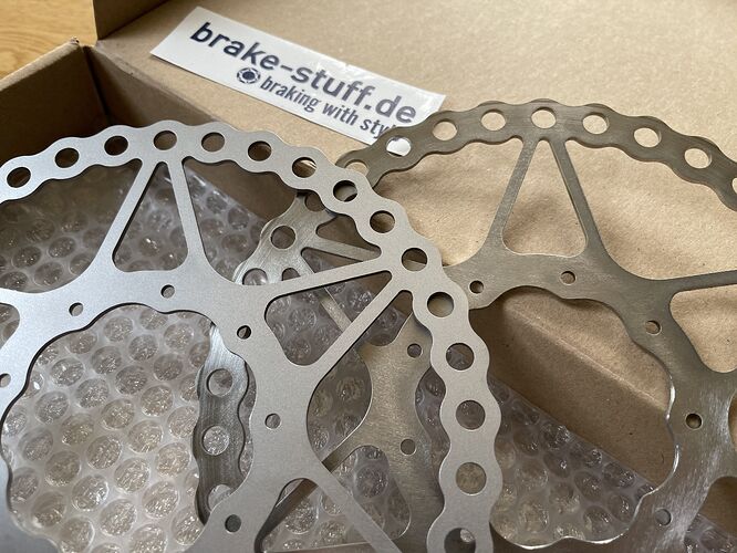

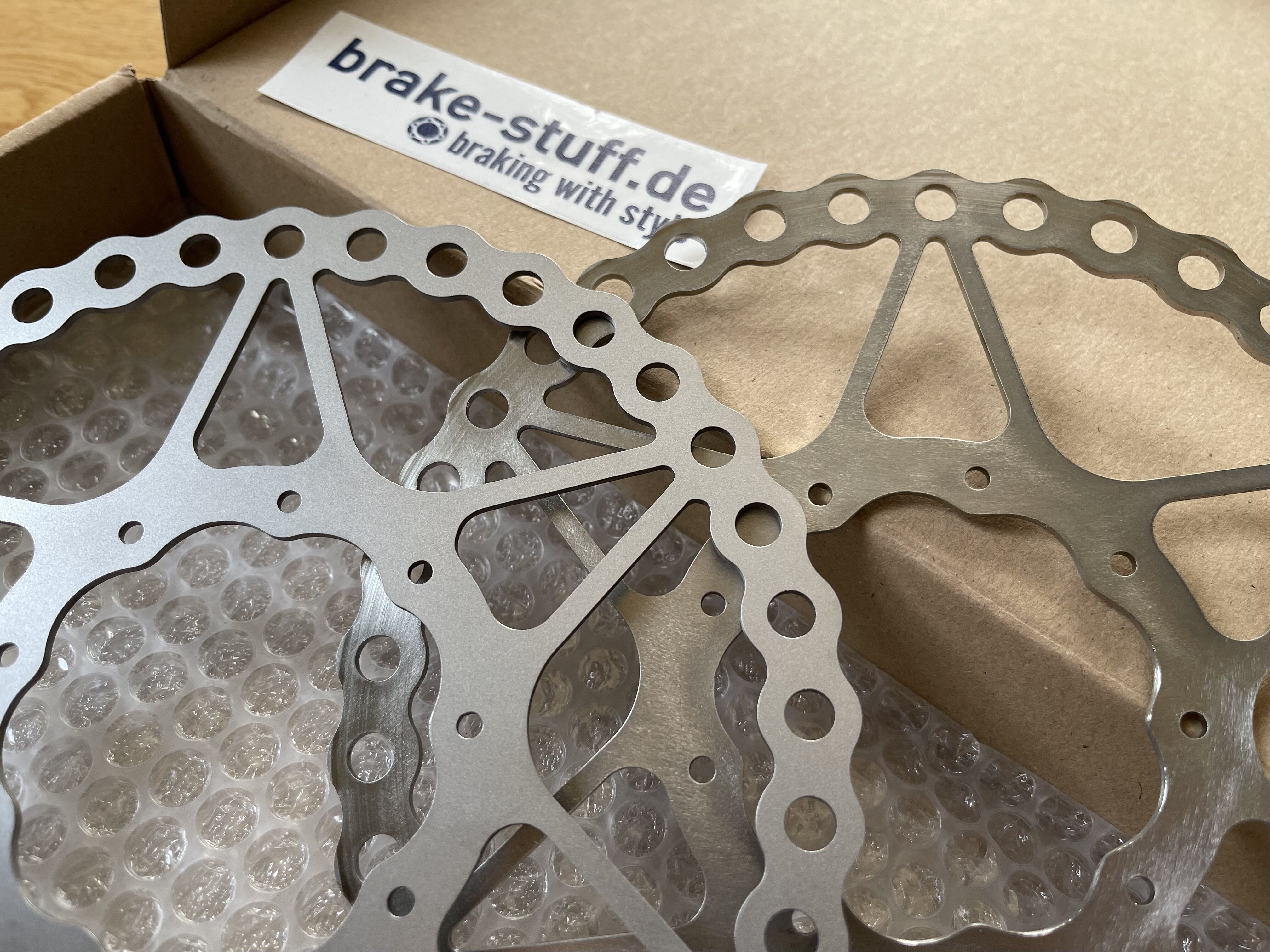

They feature used 203, new 203, used 180.
You’ll be able to see in one of these shots how the 203 has dished and become bowed out.
It is also super clear how thin the metal has gone here!
A litte addition to the post:
Both discs were ridden each about 2000 km with about 25 000 m of downhill.

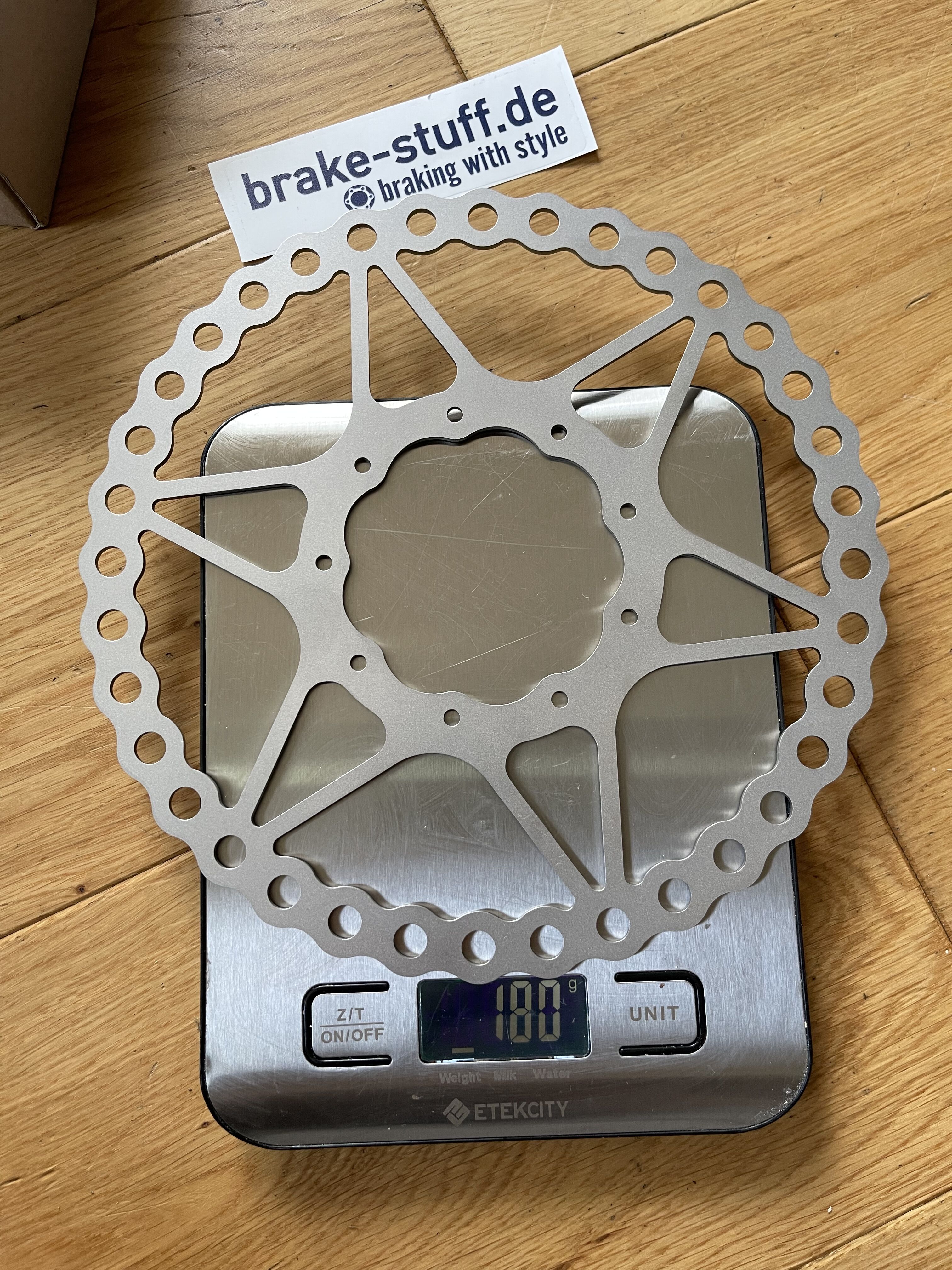

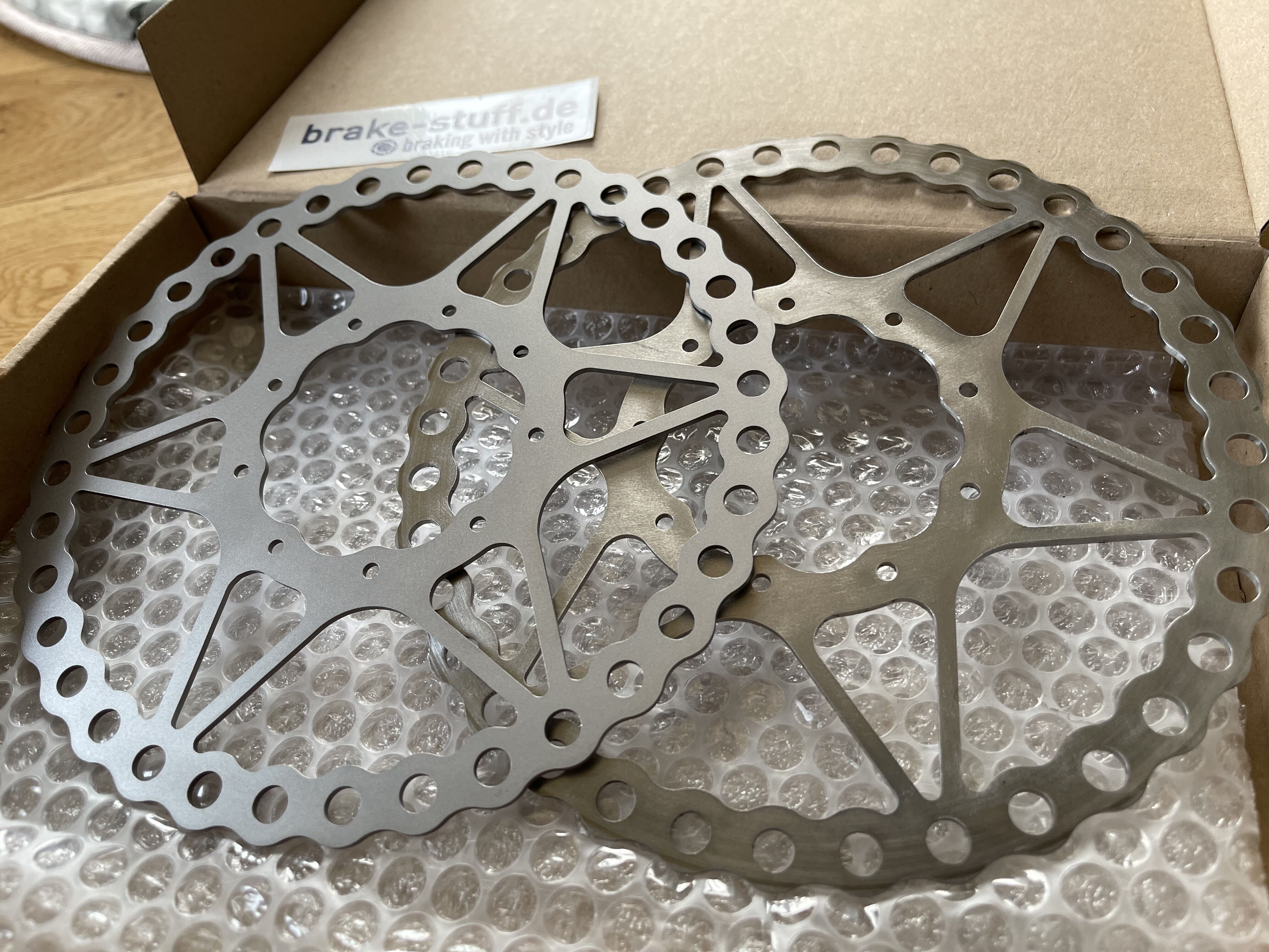

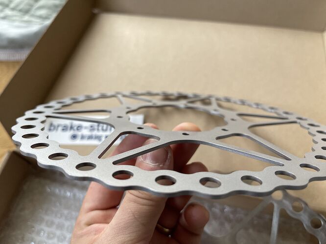

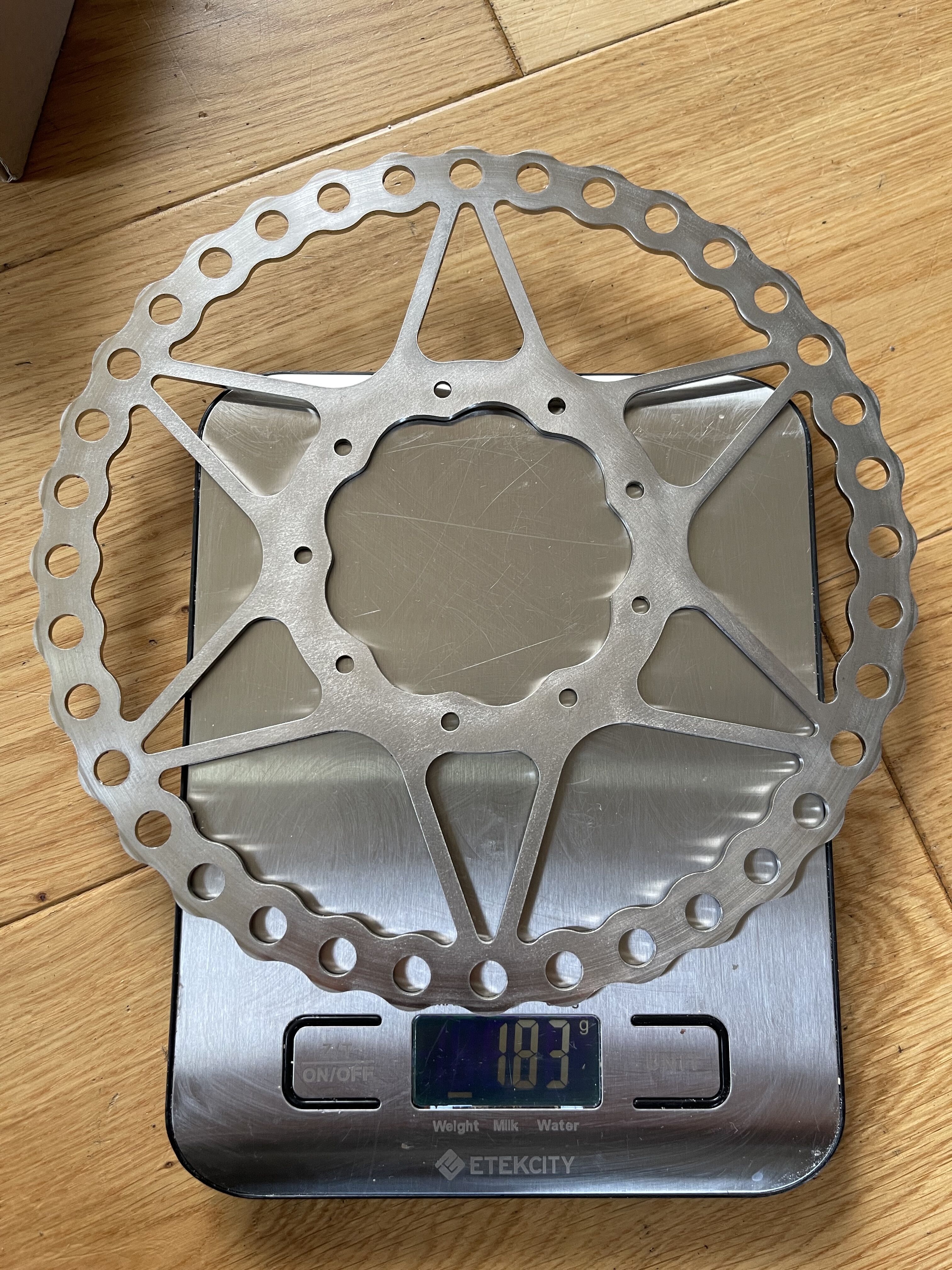

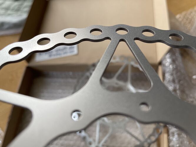

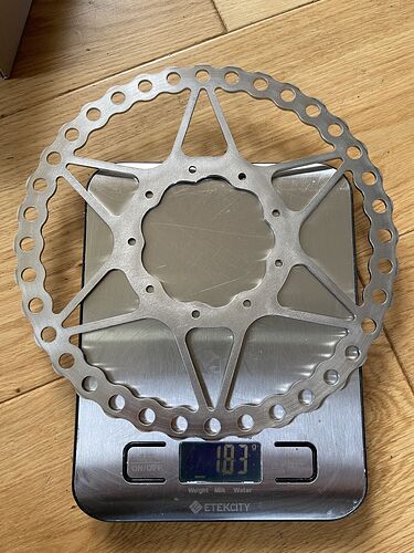

My 203 BrakeSTUFF rotor arrived and I like it. Very hard to say why but it feels different / texture and metal flex and the finish is very, very refined.
As soon as I can I’ll get this on a hub and test it as best I can.
